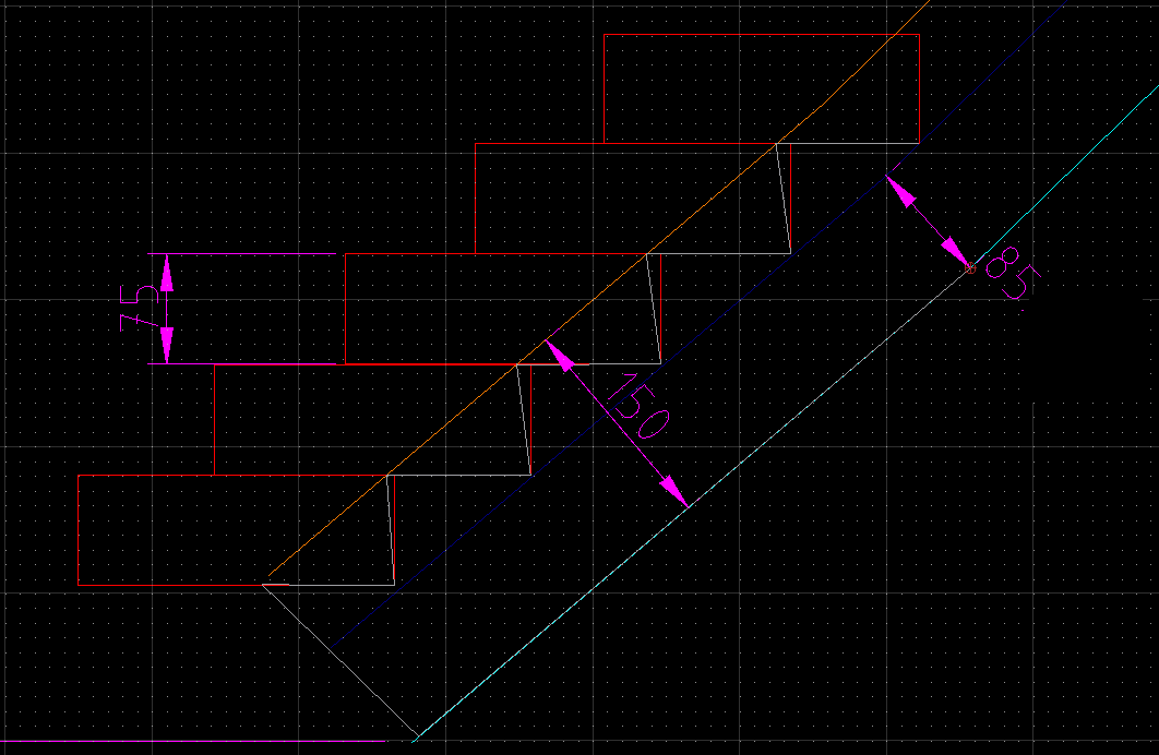

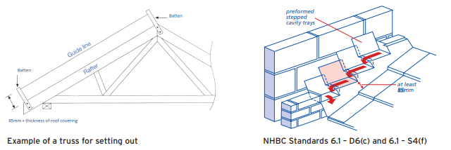

MortarThePoint Posted October 7, 2020 Posted October 7, 2020 I'm trying to work out where the flashing and cavity trays will sit on a roof abutment. I don't have the rafter to put in place and measure off, but I do have a drawing of the bay window roof exterior surface. I need to work all this out so I can get the positions of the stepped cavity trays correct as they get built in to the wall now. Their corners align with the corners of flashing, so it's lead me to try to understand this (excuse the pun). I can see NHBC recommend at least 85mm (some of their docs have 65mm min) between the roof surface and water line which defines the positions of one set of corners of the flashing. What I can't work out is what sets the position of the other set of corners. Is it just set by the height of courses and drawing a line perpendicular to the roof slope? I've seen something that suggests they sit on a line 150mm from the roof slope. I have attempted to draw this below with the lead shown in grey and the reference lines at 85mm from roof slope and 150mm from roof slope. The red rectangles show coursing and would be the positions of stepped cavity trays. Wider lead flashing or moving it off the roof slope slightly (so up the soakers a bit) would create a tighter angle on the 'saw teeth'. I imagine these must never result in the cut line sloping the other way. Is there a minimum amount of overlap on each step? Finally, can you stop when the lead goes past being vertically above the end of roof slope or is there a minimum amount it has to go past the end of roof slope. In the example below, could I have stopped one brick course higher at the bottom? Lots to understand so thank you if you made it this far.
Mr Punter Posted October 7, 2020 Posted October 7, 2020 You may be overthinking this. Make sure the cavity trays are higher than the top of the roof and have a decent weep hole at the end. It is sometimes tricky as you may have the brickwork up a long time before the sloping roof. On existing buildings BC sometimes just allow a coat of silane / siloxane on the brickwork above. Lots of connies get put on existing houses and stepped cavity trays are out of the question. I don't hear too many horror stories. 1

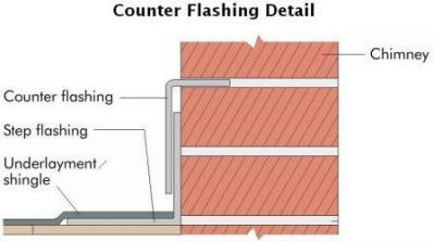

tonyshouse Posted October 8, 2020 Posted October 8, 2020 I don’t like stepped flashings any more , angle grinder cut angled slightly up 85 to 100mm up. Then secret gutter under the tiles with or without cover flashing
MortarThePoint Posted October 8, 2020 Author Posted October 8, 2020 1 hour ago, tonyshouse said: I don’t like stepped flashings any more , angle grinder cut angled slightly up 85 to 100mm up. Then secret gutter under the tiles with or without cover flashing Thanks, do you have a drawing or photo of this as it's difficult for me to get my head around. Do you still do the same thing as in my first post with stepped cavity trays though?
tonyshouse Posted October 8, 2020 Posted October 8, 2020 (edited) For me the lead goes in too far on this detail, 20mm plenty, also should go in slightly uphill to direct any water outward imagine a cut running up at the same angle as the roof but 80mm above the tiles - I call it a cover flashing Edited October 8, 2020 by tonyshouse Missed phrase 2 1

MortarThePoint Posted October 11, 2020 Author Posted October 11, 2020 On 08/10/2020 at 12:43, tonyshouse said: For me the lead goes in too far on this detail, 20mm plenty, also should go in slightly uphill to direct any water outward imagine a cut running up at the same angle as the roof but 80mm above the tiles - I call it a cover flashing So you end up with a constant with band of lead on the wall at the same slope angle as the roof. What's done with the cavity trays then?
tonyshouse Posted October 11, 2020 Posted October 11, 2020 I have never use cavity trays for roof abutments nor had any problems, They can still go in if you want weeping out onto the face of the brickwork.
MortarThePoint Posted October 12, 2020 Author Posted October 12, 2020 13 hours ago, tonyshouse said: I have never use cavity trays for roof abutments nor had any problems, They can still go in if you want weeping out onto the face of the brickwork. Surely you have to over bay windows or any enclosed spaces?
makie Posted October 12, 2020 Posted October 12, 2020 4 hours ago, MortarThePoint said: Surely you have to over bay windows or any enclosed spaces? If you want to do it properly.
tonyshouse Posted October 12, 2020 Posted October 12, 2020 Yes, but very close under a window sill is low risk, to each side of the window above a bay, yes , minimum is to tray the water sidewards And downwards and out to the face of brickwork with a welt at the bottom end
