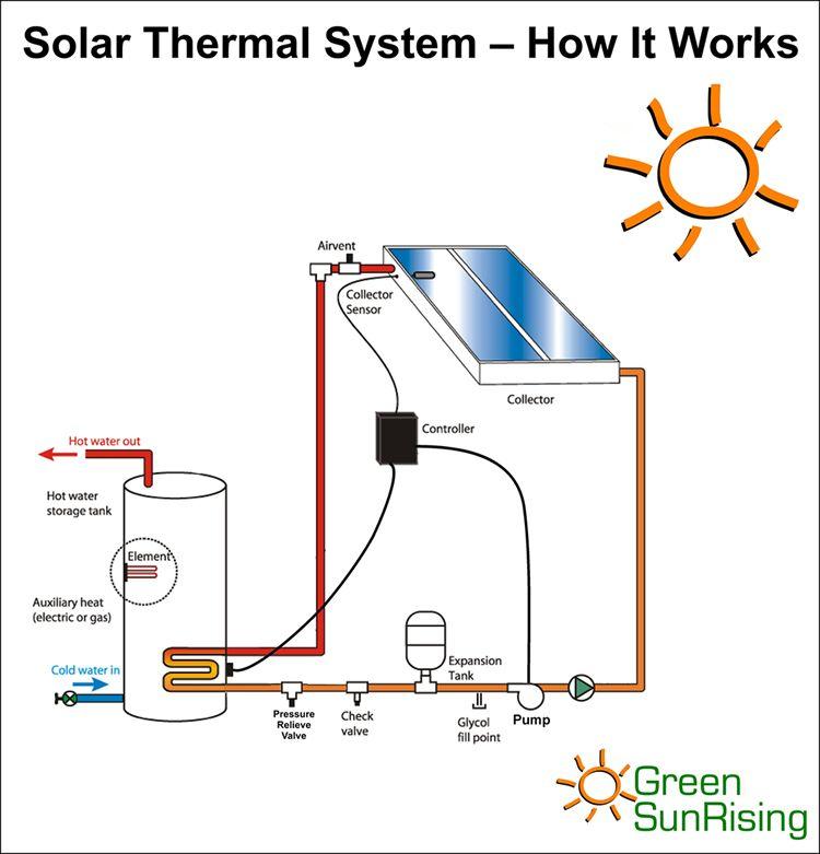

SteamyTea Posted October 13, 2020 Share Posted October 13, 2020 12 minutes ago, andygo said: Since I last posted I've managed to obtain some used solar panels. I assume these are solar thermal, not photovoltaic. Can you send then back or resell them. Failing that, you could plumb them in to supply some energy to your domestic hot water. You will probably need a new hot water cylinder, an expansion tank, lots of compression fittings, some flexible stainless pipe, a controller, antifreeze, service schedule and other things I have forgotten about. But the efficiency is tip top while heating the water, assuming the water is only luke warm to start with. PV is so much better. Link to comment Share on other sites More sharing options...
andygo Posted October 13, 2020 Author Share Posted October 13, 2020 They are solar thermal and were free (because of leaks), no reason to sell on or send back. Since they won't contribute much over the winter in a 277l tank I figured they'd be better of making a more significant contribution to UFH using the little winter sun we get. In summer I'd hook them up to the thermal store and use them as designed. There's also a blending valve between thermal store and UFH....suppose I could incorporate that...but do you really think solar panels get that hot over winter? As mentioned earlier I'd really not have to go to the hassle and expense of getting yet another hot water cylinder when we've got a thermal store. Link to comment Share on other sites More sharing options...

andygo Posted October 13, 2020 Author Share Posted October 13, 2020 The underfloor heating is currently fed from the Thermal Store...which is what is causing the problem and the reason for the original post.... I want to separate the UFH from the Thermal Store for two reasons: 1 Currently the only heat source into the Thermal Store is a solid fuel Rayburn which is coming to the end of its days and a pain to keep running. If I can find another heat source for the UFH then we can possibly live without the Rayburn - or just fire it up on really cold days to power the radiators upstairs. 2 The water which goes into the Thermal Store gets black and sludgy because it's fed from the Rayburn. This same black, sludgy water goes direct from the TH to the UFH - so the UFH gets blocked up and I guess pretty inefficient. It was a poorly designed system from a plumber who has since disappeared... The long term goal is to replace the Rayburn with a better heat source. But in the short term (and fairly urgently as its getting colder) I need a way of ONLY heating the UFH. A Willis Heater heating ONLY the UFH would be cheap to install (and hopefully relatively easy to do) and would give me some solid figures to work with (though I am concerned about how much it might cost to run). Obviously in the long-term I'll add the thermal solar panels I've obtained to the Thermal Store....which will give us DWH in summer - but they're not going to do much to a 277l store in Winter. I'm wondering however if there is a way of taking advantage of the weak winter sun and use a panel or two to pre-warm the relatively small amount of water needed to run the UFH. (It might save us a few quid on electricity.) The question I have is does anyone know a way of doing that? And if so how many pumps would I need. Thanks again Andy Link to comment Share on other sites More sharing options...

Gav_P Posted October 13, 2020 Share Posted October 13, 2020 13 minutes ago, andygo said: I'm wondering however if there is a way of taking advantage of the weak winter sun and use a panel or two to pre-warm the relatively small amount of water needed to run the UFH. (It might save us a few quid on electricity.) The question I have is does anyone know a way of doing that? I’m not sure anyone would recommend a way of doing this as you could end up with some very high temps on a sunny day without even knowing it. Unless you used it to heat the thermal store, then top up the temp if required by electric? Link to comment Share on other sites More sharing options...
Gav_P Posted October 13, 2020 Share Posted October 13, 2020 Link to comment Share on other sites More sharing options...
andygo Posted October 13, 2020 Author Share Posted October 13, 2020 14 minutes ago, Gav_P said: Weird set up that the Rayburn can contaminate the UFH system. I would have assumed they were separated, by the Rayburn heating the store via a coil? Sadly, that's the way mine is set up. Life would be easier if there was a coil for the Rayburn and/or the UFH....but there isn't...they're both direct. 11 minutes ago, Gav_P said: I’m not sure anyone would recommend a way of doing this as you could end up with some very high temps on a sunny day without even knowing it. Unless you used it to heat the thermal store, then top up the temp if required by electric? How about if the panels were connected to both the UFH and Thermal Store via some sort of valve. If the water temp got too hot for UFH it would just be directed into TS instead. We're talking about winter sunlight, how hot do you think they're likely to get? Don't want to overcomplicate it though.... I can live without the panels for now...but I do want to find a way of heating up the UFH independently... Link to comment Share on other sites More sharing options...
SteamyTea Posted October 13, 2020 Share Posted October 13, 2020 You could connect the ST via a plate heat exchange. But start off with getting the UFH fitted with a Willis and see how it goes. Link to comment Share on other sites More sharing options...
