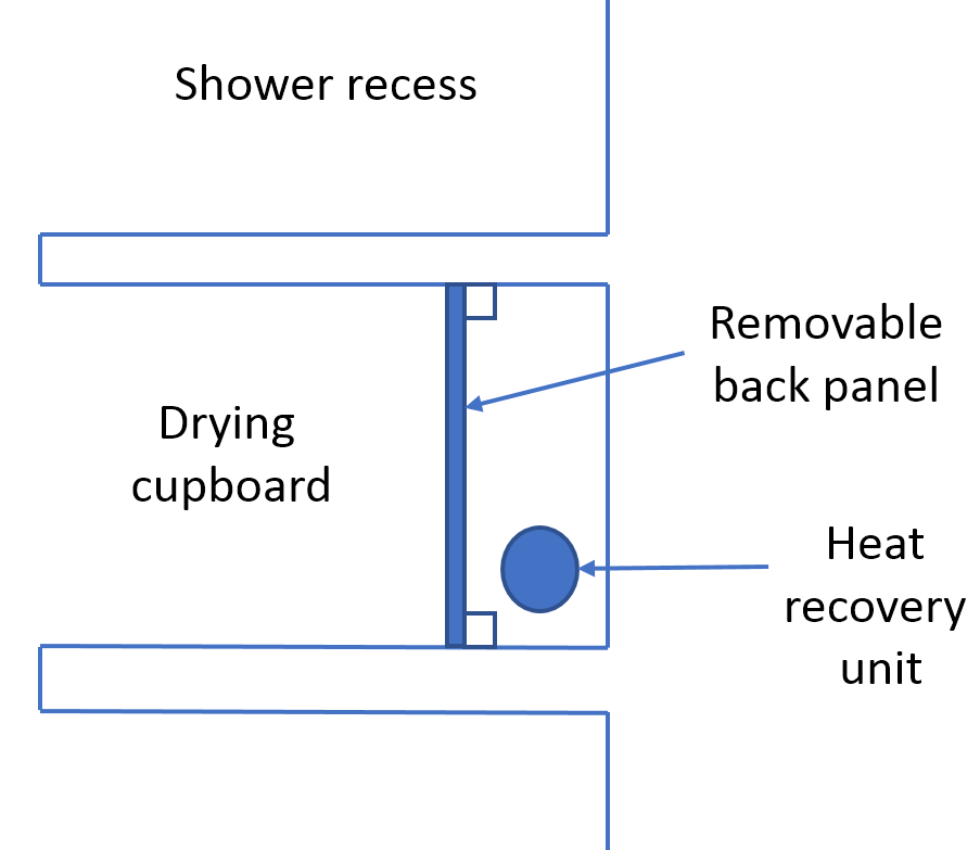

Nickfromwales Posted January 15, 2017 Posted January 15, 2017 Crikey. 2.4 m mounting height ! @jack, how is yours positioned for cleaning / maintenance / replacement etc? 67% ( manufacturers quoted efficiency ) isn't to be sniffed at TBH. Different models suitable for first floor showers ( 2m long vertical tubular type ) with other models specified for ground floor ( big shoe box basically ). Interesting that it says NOT to insulate the unit itself ( pipework to be insulated ), unit to be kept below 25oC ambient, and ( preheated side ) pipework to be kept 3m or shorter ( to achieve max efficiency ). Mounting and locating this unit should really be included as a design consideration, before your builder gets the tools out .

jack Posted January 15, 2017 Posted January 15, 2017 34 minutes ago, Nickfromwales said: Crikey. 2.4 m mounting height ! @jack, how is yours positioned for cleaning / maintenance / replacement etc? 67% ( manufacturers quoted efficiency ) isn't to be sniffed at TBH. Different models suitable for first floor showers ( 2m long vertical tubular type ) with other models specified for ground floor ( big shoe box basically ). Interesting that it says NOT to insulate the unit itself ( pipework to be insulated ), unit to be kept below 25oC ambient, and ( preheated side ) pipework to be kept 3m or shorter ( to achieve max efficiency ). We have high ceilings downstairs so the mounting height was okay for us. Ours is behind a full-height removable panel at the back of a drying cupboard in our utility room: I assume the 25 deg C ambient temp is to do with Legionella. We have several showers a day, so unless the house is left unoccupied for a long period, I'm not really concerned about this particular requirement (even if we go on hols, the temp in enclosed spaced will quickly approach the low-20s ambient of the rest of the house anyway). Our plant room would have been a better place for the unit, as it's just on the other side of the drying cupboard, but the plumber was very reticent to install it there given it was likely to be well above 25 deg C for long periods of time. 27 minutes ago, Nickfromwales said: @jack how much was your unit if you don't mind, please? It's been quite a while, so I'm not sure. I believe it was around £600, but that's a complete guess. Powerpipe (the main competitor to the one I used) has pricing on its website
