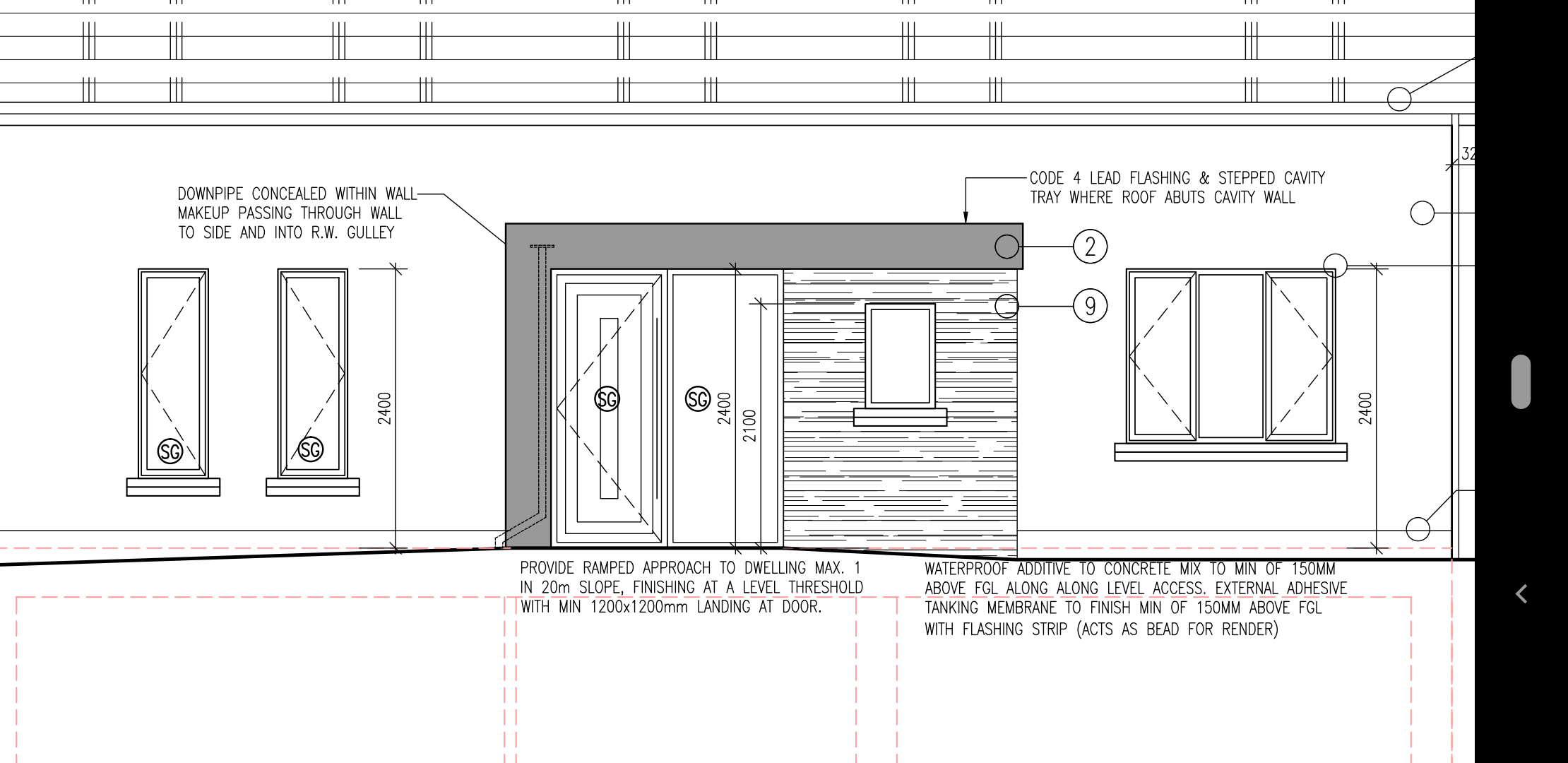

Conor Posted October 2, 2020 Share Posted October 2, 2020 (edited) We have 2650mm ceilings on our ground floor. We're shopping for external doors and have realised that the architect has door and window heads of 2400mm all around the house. This is making finding a front door a little more tricky as most standard doors are a max of 2100 or 2200mm. Is it normal to have higher head heights for higher ceilings? If we were to drop the front door HH to 2200, would we be best dropping the windows as well? Edited October 2, 2020 by Conor Link to comment Share on other sites More sharing options...
Oz07 Posted October 2, 2020 Share Posted October 2, 2020 I've got 2100 heads with 2550 ceilings. Its about the biggest I'd go. Would deffo want higher heads with 2650. If you go 2400 could you not have transome then fixed light above doorframes Link to comment Share on other sites More sharing options...
Oz07 Posted October 2, 2020 Share Posted October 2, 2020 Usually head heights should align all around btw Link to comment Share on other sites More sharing options...
Conor Posted October 2, 2020 Author Share Posted October 2, 2020 Thanks @Oz07. What about internal doors? Would we be wise to make these a little taller as well? I had a thought that raising windows and doors would negate some of the effect of higher ceilings? re top light... That's what the door guy suggested. But by the time you factor in frame 5hickness, you only end up with about 100mm of glass and a load of frame. Hoping to find a 2400mm high door. A pivot door will do that but they start at £5k.... Link to comment Share on other sites More sharing options...

eandg Posted October 7, 2020 Share Posted October 7, 2020 Interested in this too as we've designed 2750 on ground floor but windows and doors only to 2100, and it hasn't even crossed my mind that the windows would be out of proportion. Can't say I notice it in my in-laws' similarly proportioned extension. Link to comment Share on other sites More sharing options...
Thorfun Posted October 7, 2020 Share Posted October 7, 2020 2650 ground floor and 2100 windows and doors here too. hopefully it'll be fine! most our windows are down to floor level though so the whole window is 2100 high rather than starting at 900mm cill height. Link to comment Share on other sites More sharing options...
vfrdave Posted October 18, 2020 Share Posted October 18, 2020 I have all doors and windows set at 2100 with ceiling height approx 2800 and it is fine. Link to comment Share on other sites More sharing options...
Ronan 1 Posted January 6, 2021 Share Posted January 6, 2021 I am currently looking at this myself, I have sourced a local company that does a wide range on internal doors up to 2140mm (7ft) doors but I had my external doors and window head heights at 2.2m. My ceiling height is 2.750. My question is, is it ok to have the internal door head height that bit higher than the window head heights or would I be better lower the window and external height thatch or pay an additional £80 per internal door to raise them to match the 2.2 head height. I'd like you opinions on this as whilst it's a small thing it's been like a brain work and I can't seem to move on to the other 100 decisions I need to make quick till I land this one. Link to comment Share on other sites More sharing options...
