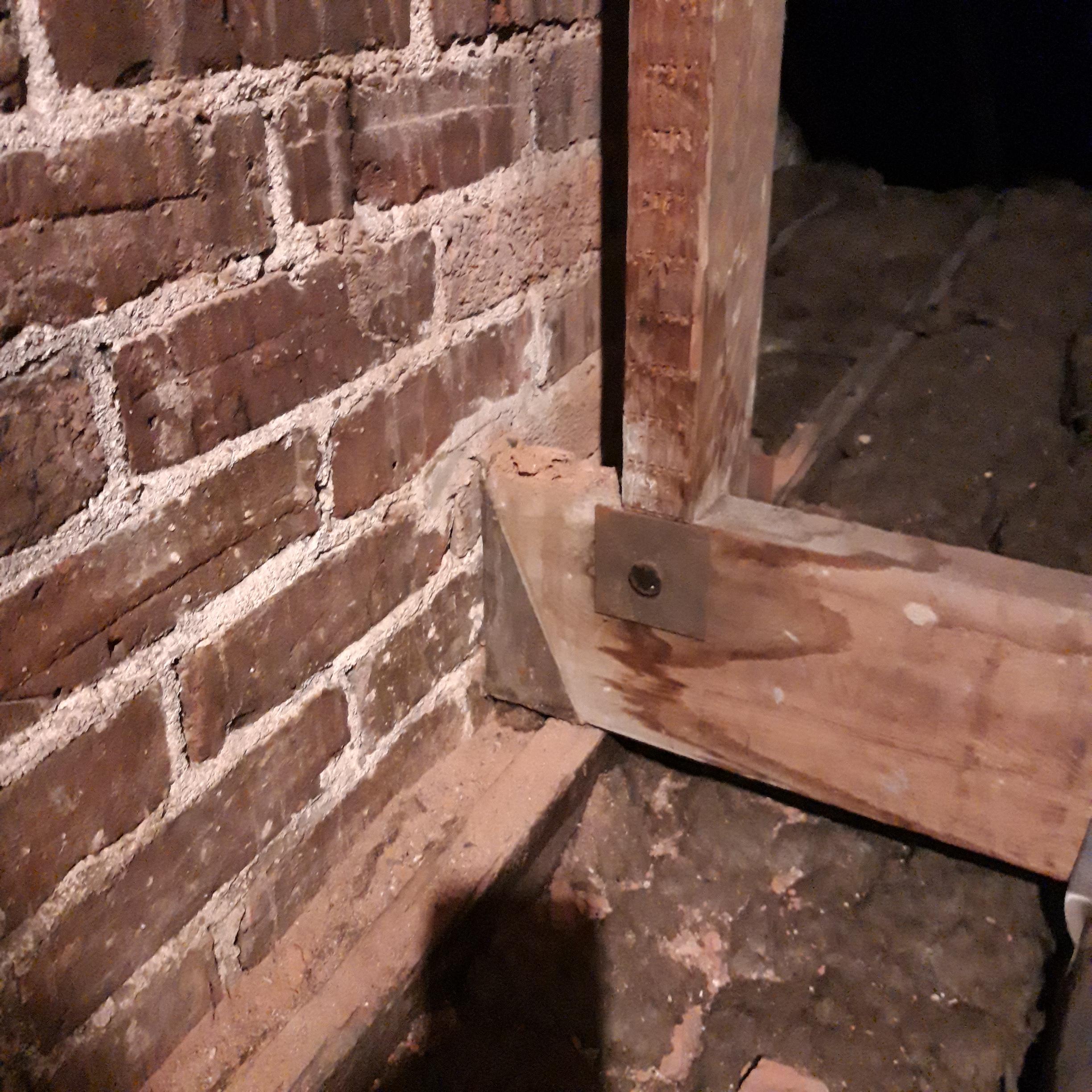

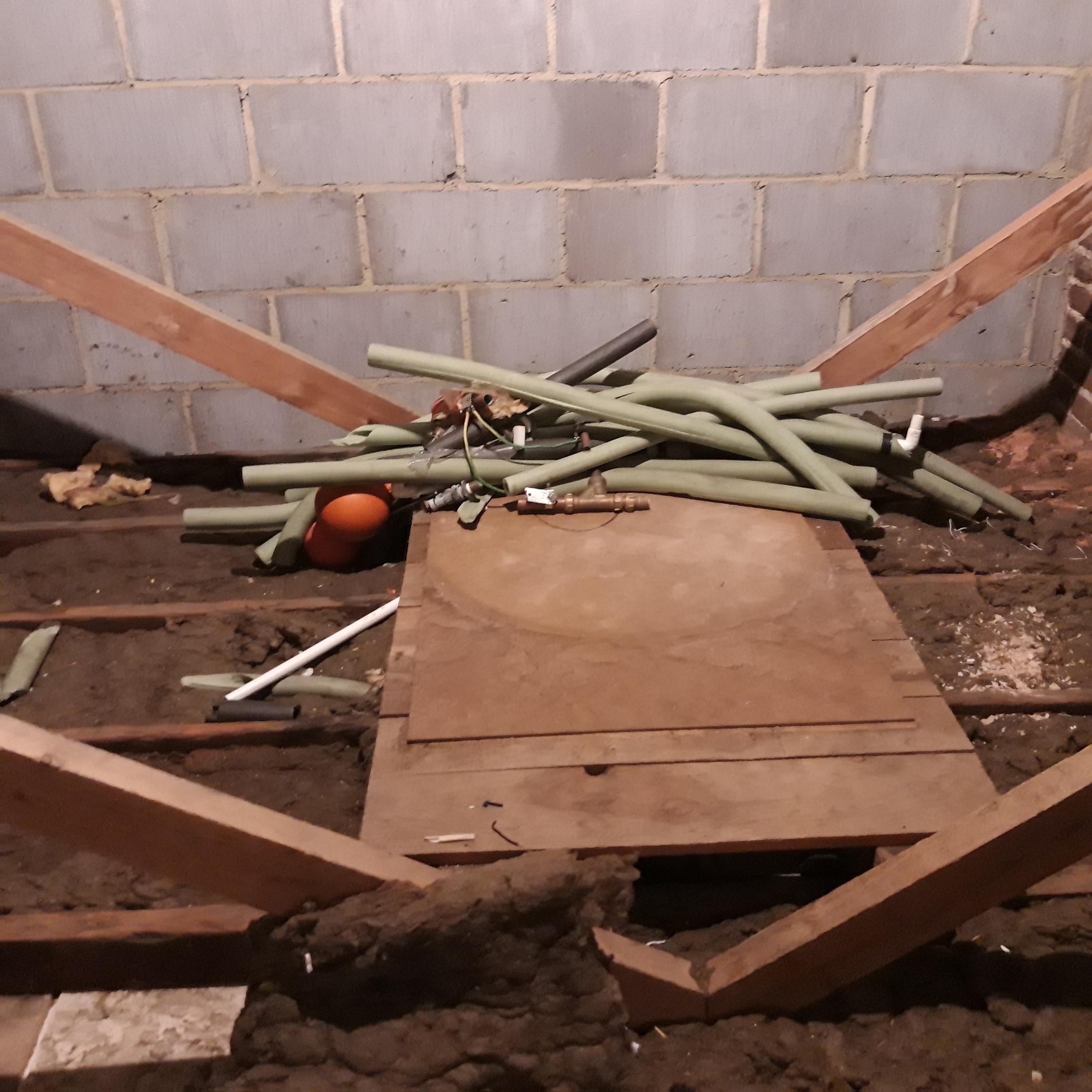

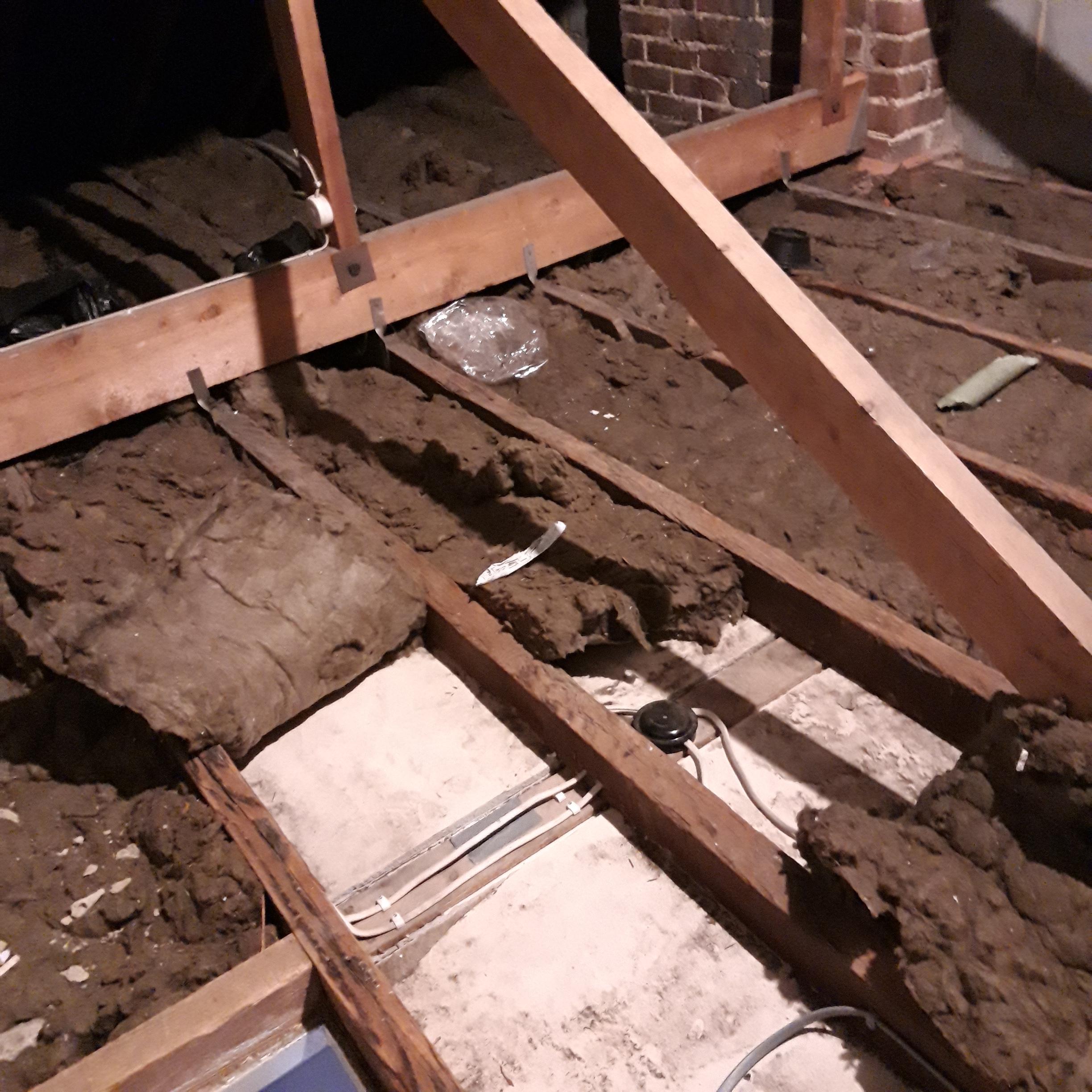

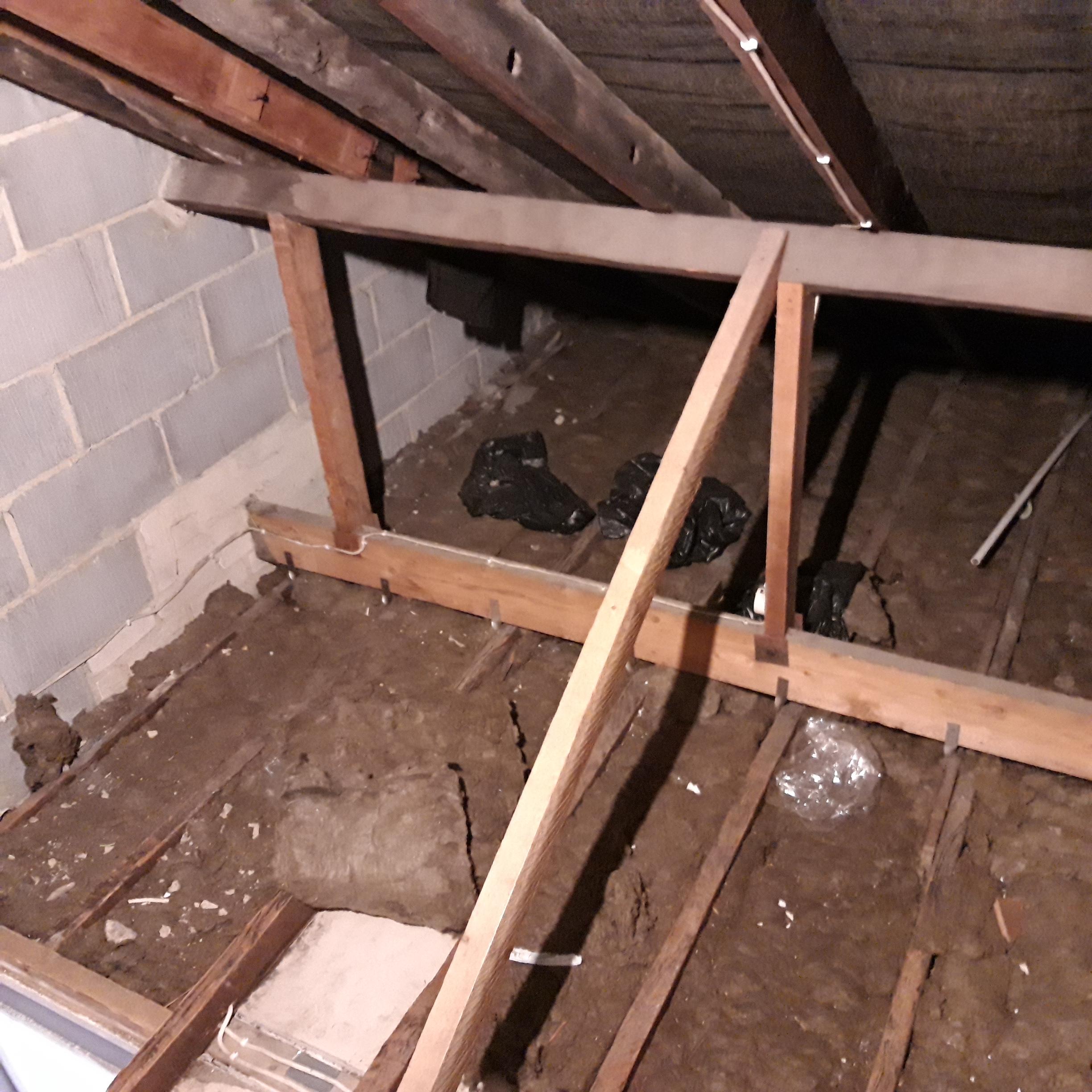

Onoff Posted September 27, 2020 Author Share Posted September 27, 2020 Needs a bit of a clear out. Roof seems to have been reinforced / repaired when tiles were put on (would have been slates originally). Insulation is very thin tbh and I guess compressed through age: 1 Link to comment Share on other sites More sharing options...
Pocster Posted September 27, 2020 Share Posted September 27, 2020 4 minutes ago, Onoff said: Needs a bit of a clear out. Roof seems to have been reinforced / repaired when tiles were put on (would have been slates originally). Insulation is very thin tbh and I guess compressed through age: No Tenant Access Ever ! ( just in case I didn’t make it clear ) 1 Link to comment Share on other sites More sharing options...
ProDave Posted September 27, 2020 Share Posted September 27, 2020 I would not give tenants access to an UNFLOORED loft. In the course of my work I see loads of lofts and some, with not a floor board in sight and the amount of junk piled up, mostly resting on the plasterboard, I am amazed the ceiling has not given in. But in our rental house the tenant has access to the floored loft space. Link to comment Share on other sites More sharing options...
Onoff Posted September 27, 2020 Author Share Posted September 27, 2020 15 minutes ago, ProDave said: I would not give tenants access to an UNFLOORED loft. In the course of my work I see loads of lofts and some, with not a floor board in sight and the amount of junk piled up, mostly resting on the plasterboard, I am amazed the ceiling has not given in. But in our rental house the tenant has access to the floored loft space. I haven't got the time now anyway to reinsulate and board out so other than getting rid of the lagging etc it's staying as it is. Link to comment Share on other sites More sharing options...
