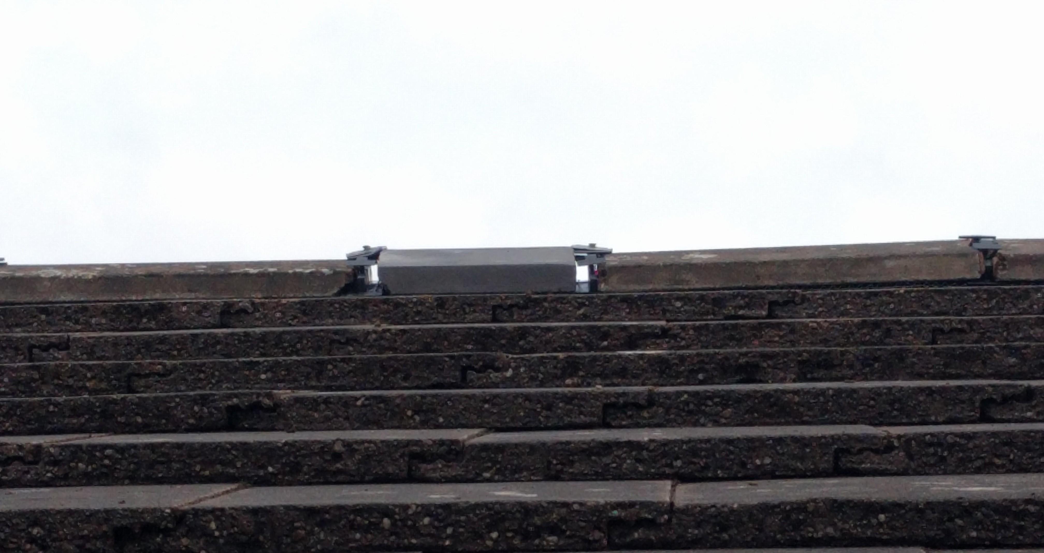

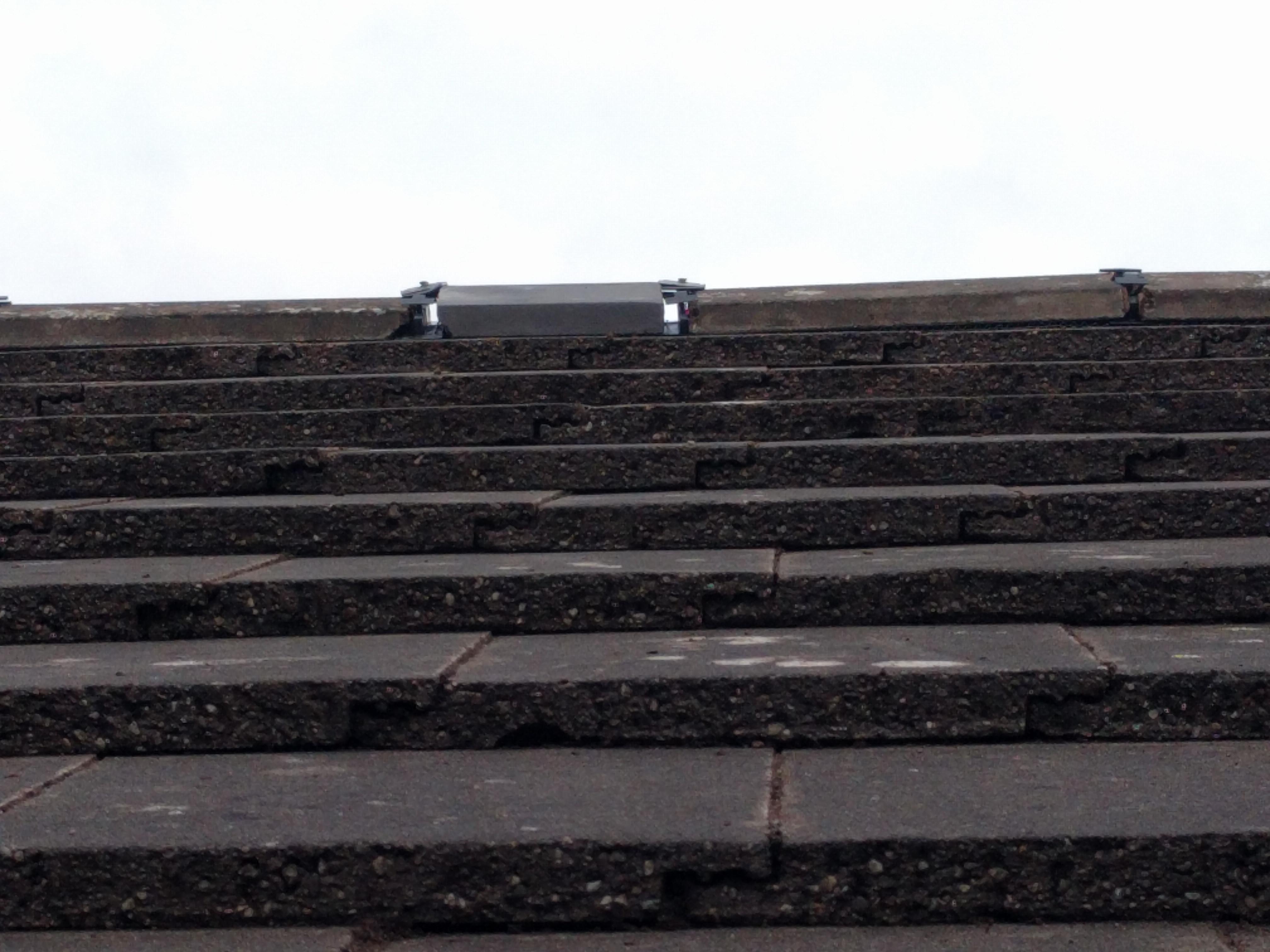

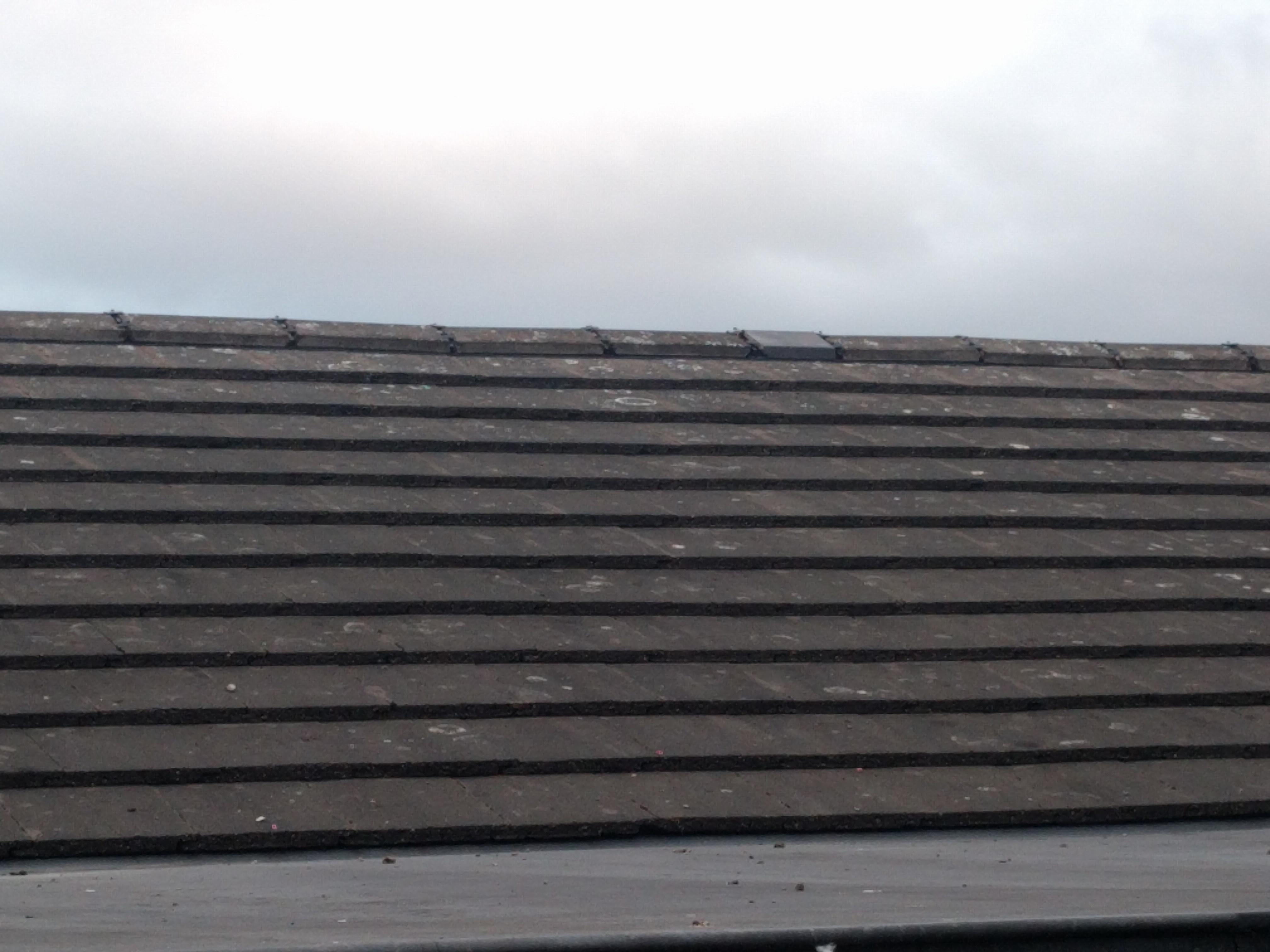

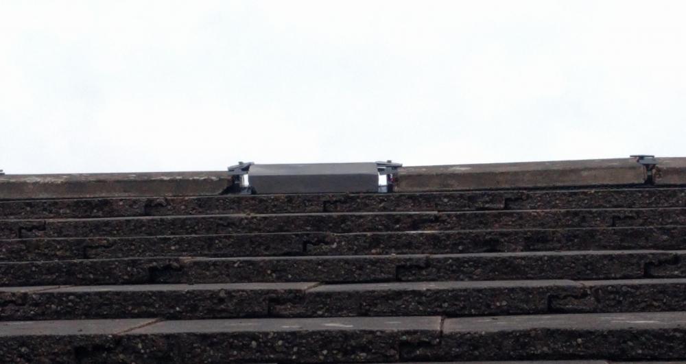

BobAJob Posted September 15, 2020 Share Posted September 15, 2020 (edited) We've just had a dry ridge system fitted to our house as the suggestion of a roof contractor who was doing some other work on the house. I'm no roofing expert, but to me it appears that he hasn't fitted it correctly as he has: 1. Left some mortar at the end of some of the tiles so the dry ridge system doesn't grip the tile and instead grips the old mortar 2. They managed to break one of the old ridge tiles and without telling me decided to install a half a new ridge as they said they can't get new ridge tiles of our design now. On this tile they have big gaps at the end of each tile so you can see the black plastic fitting and the plastic clamps that are supposed to hold the tile in place are barely touching the tile, so I am concerned the tile may blow off or we may get rain or snow into the roof space. Photos attached. 1. Does what he's done look correct? 2. Are these big concrete ridge tiles suitable for use with a dry ridge system? 3. How much should it cost to get a dry ridge system fitted? Thanks in advance. Edited September 15, 2020 by BobAJob Link to comment Share on other sites More sharing options...

makie Posted September 15, 2020 Share Posted September 15, 2020 I'm a roofer and this work is poor, the new ridge isn't any good. It needs to be tight. The mortar should all be cleared off of the ridge and the price is all dependent on size, time and how easy the access is etc 1 Link to comment Share on other sites More sharing options...
BobAJob Posted September 15, 2020 Author Share Posted September 15, 2020 17 minutes ago, makie said: I'm a roofer and this work is poor, the new ridge isn't any good. It needs to be tight. The mortar should all be cleared off of the ridge and the price is all dependent on size, time and how easy the access is etc That's what I thought. They had a man using the claw end of a hammer taking the mortar off but I think he has chipped bits off the tiles and it was probably him that broke the tile. It's a mid-1980s four bed bungalow so access is very easy. Do they still make concrete tiles like those or can you get them from reclamation yards? Thanks Link to comment Share on other sites More sharing options...
makie Posted September 15, 2020 Share Posted September 15, 2020 1 hour ago, BobAJob said: Do they still make concrete tiles like those or can you get them from reclamation yards? It's a universal angle ridge so even if they can't find an exact match there will be something really similar. Personally I never reuse the original ridges on any dry ridge or hip system, if one breaks like this then it is hard to match. Looks much better with new ridges. Link to comment Share on other sites More sharing options...
BobAJob Posted September 16, 2020 Author Share Posted September 16, 2020 10 hours ago, makie said: It's a universal angle ridge so even if they can't find an exact match there will be something really similar. Personally I never reuse the original ridges on any dry ridge or hip system, if one breaks like this then it is hard to match. Looks much better with new ridges. Do you think they're Redland Universal Angle ridge or are they hip tiles? The roof does have a Redland dry verge system fitted, so maybe Redlands make sense? How do you fix this job? Link to comment Share on other sites More sharing options...

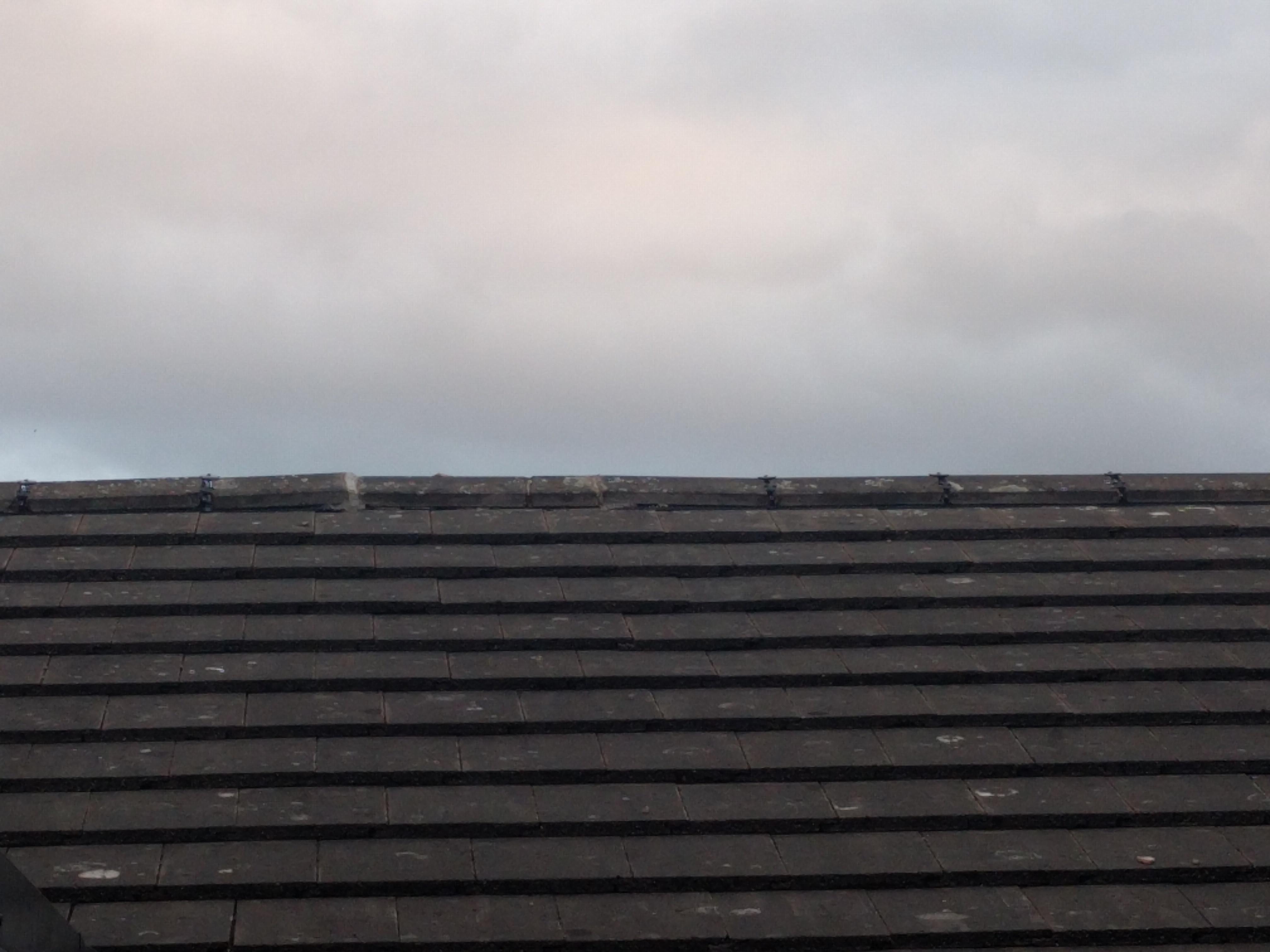

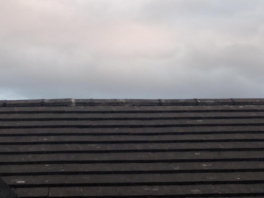

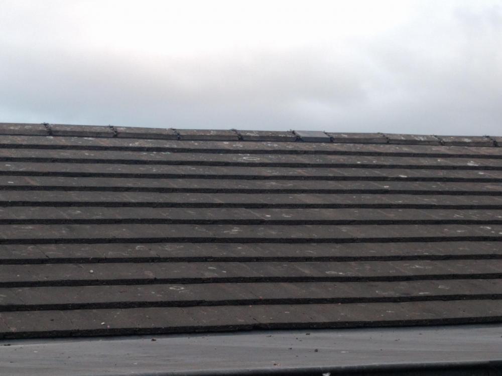

BobAJob Posted September 16, 2020 Author Share Posted September 16, 2020 Roofer came back today and I got him to remove every tile, clean them up properly and refit them tighter than they were before. Also got him to replace mismatching tile with one that matches. Cost him £4.80 for the correct tile. Not sure why he couldn't fit the correct tile the first time round. Link to comment Share on other sites More sharing options...
BobAJob Posted September 23, 2020 Author Share Posted September 23, 2020 My roofer came back again today as I complained about two last snagging issues. Then he started shouting at me that I was costing him money by having to come back to fix issues. He said he didn't want to get into a fight about it. It's ridiculous. I'm costing him money because I'm pointing out to him that he hasn't hasn't done the job right and I'm asking him to fix it before I pay him. He now says that it's not important that the dry ridge system fabric is not stuck down properly in a few places. There was me thinking it was there to stop the rain getting into the roof and allow the rain to flow away from the ridge. If I was him, I'd just get on the roof and stick it down. It takes 5 minutes and makes the customer happy with the job, but not this guy. Now he's demanding payment in cash. I said no. Simple solution to that one. Do the job right the first time and nobody complains and no return visits 1 Link to comment Share on other sites More sharing options...

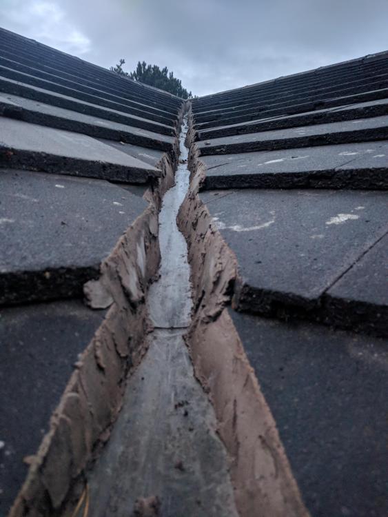

BobAJob Posted September 24, 2020 Author Share Posted September 24, 2020 30 minutes ago, ToughButterCup said: I would consider offering to pay him what he asks for minus the cost of putting it right. Or he puts it right. Ask him to show you one other roof - anywhere - with gaps that size between the ridge tiles. Frankly, the work is shockingly poor. I mean its not even hidden from view is it? He's back tomorrow and is starting to get aggressive about his money. I thought he was going to hit me the other day, which would just result in a call to the police. It was only that one tile was really bad. On the others his men had not removed all the mortar from the edge of the tiles. My concern was that this mortar would eventually fall out and then the tiles would get loose. I made them remove all the tiles and remove all the mortar and then put them back on again. I found it pretty bad that I had to them what good looks like. I'm no roofer. I've just watched a few videos on youtube. However, I know a botched job when I see one. Hopefully tomorrow he'll be less aggressive and less complaining and demanding of his money. If he's not, then I'll ask him to leave as I didn't hire him to be treated like this. He's still not getting paid tomorrow. Link to comment Share on other sites More sharing options...

Mr Punter Posted September 25, 2020 Share Posted September 25, 2020 What are the outstanding snagging issues? I hope the crazy gap ridge tile has now been replaced? Link to comment Share on other sites More sharing options...

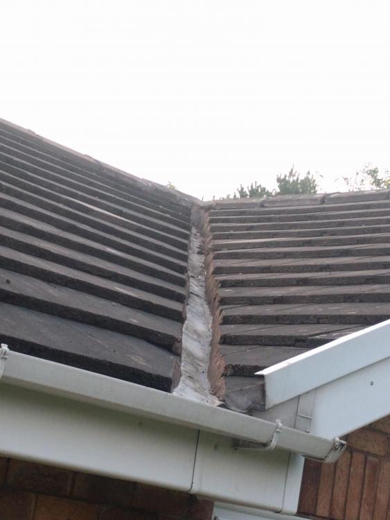

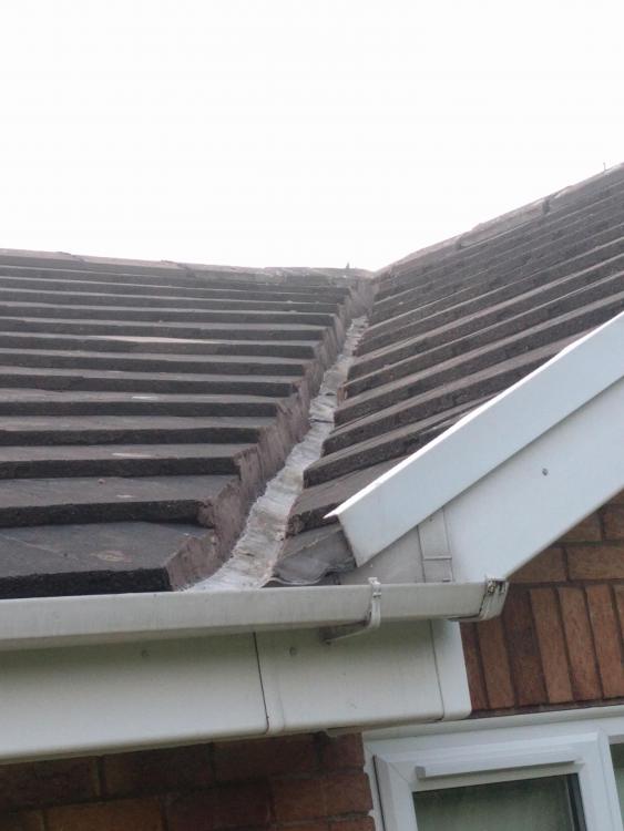

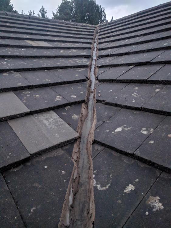

BobAJob Posted September 25, 2020 Author Share Posted September 25, 2020 1 hour ago, Mr Punter said: What are the outstanding snagging issues? I hope the crazy gap ridge tile has now been replaced? A couple of ridge tiles they've knocked corners and big chunk off which to my mind means wind and rain can get under the tile and there's one that they had to mortar to tie in with valleys in roof but they have left it high at one end and low at the other which means the dry ridge union doesn't hold it properly. I think it needs mortaring. I want the chipped tiles replaced with reclaimed matching ones not non-matching chipped off corner ones like he before. I think it would take them an hour or two tops to fix them but apparently that costs him money and he'd rather shout at his customers instead of fixing relatively simple issues. I'm not impressed. Who on earth thinks that gap around a ridge tile is good? The roofer told me his customers who think that was good and I'm a difficult customer. And after all this and £2000 spent I still end up with two cracked roof tiles on the house because they didn't replace them before they remortared the valley. To replace them we have to break the new mortar and then remortar again. Link to comment Share on other sites More sharing options...
