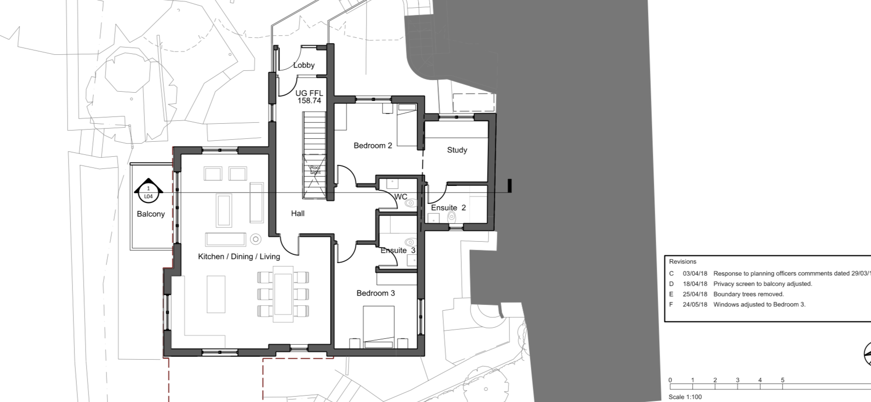

ZacP Posted September 7, 2020 Posted September 7, 2020 Hello one and all! After a few weeks of browsing BH and learning as best I can it seems appropriate to jump in at the deep end and say Hi and thanks for your help so far! My wife and I (and 2 daughters [4 and 20months], 2 dogs and 3 chickens) are buying a dated bungalow with full planning to demolish and rebuild a 225sqm 4 bed 2 story house. On the side of a hill. With v. poor access. I know, stupid, but its only a 5min walk to school and we've wanted to build for a long time so hey! At the moment were considering some form of ICF (either top contenders are Durisol vs Nudura) as getting light blocks onto site then pumping from off site seems the best option. Ultimately were on a v tight budget (£1400/sqm) considering the site and whatever is cheapest. No we cant get a crane anywhere near site! I'm sure there will be lots of questions along the way, and lots of oops moments, but hopefully i'll still be here to detail those ups and downs as we go. Thanks for reading my waffling, any advice and words of wisdom or experience welcome and valued at any point! Z 2

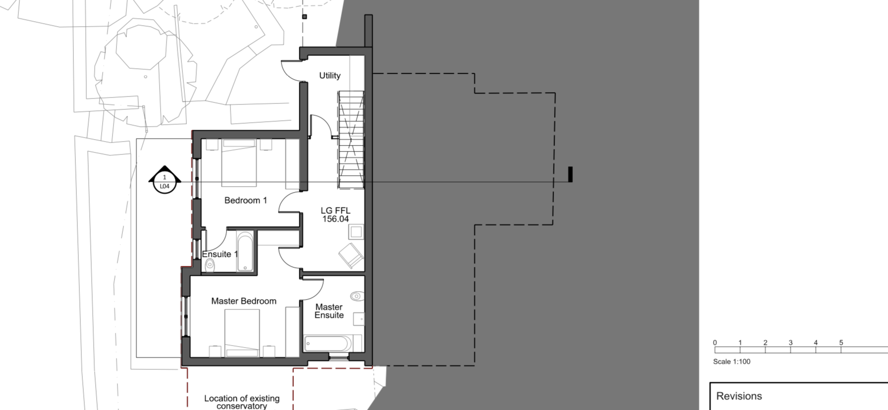

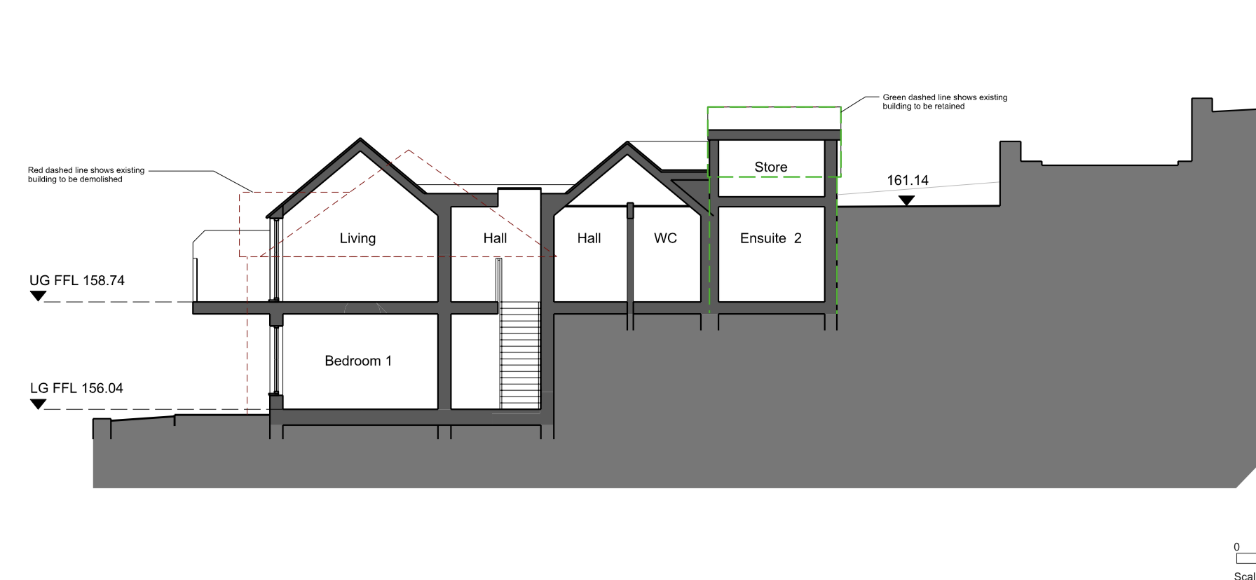

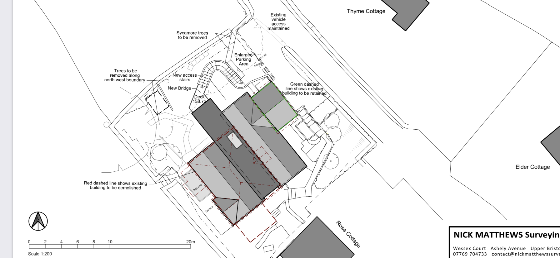

ZacP Posted September 7, 2020 Author Posted September 7, 2020 Well no pics at the mo but here is a section and some floor plans.... We’ll prob go back thru planning for some alterations and shift the floor plans around to suit our needs better, but the superstructure will stay the same bar a few (many!) window changes! 1

Iceverge Posted September 7, 2020 Posted September 7, 2020 Welcome. Smashing house! When I looked in detail nothing could come close to a concrete block cavity wall terms of price. Lots of your design is sub grade which rules out timber. ICF was very attractive initially given the supposed lego like buildability and excellent continuity of insulation . But I decided it was too expensive, tricky to prop and pour, and needed additional external insulation to reach passive levels. Of course many on here have great success with it so I'm willing to be corrected. Durisol certainly looks an attractive product. If you are going for a redesign, given your tight budget perhaps ask your architect to square up the building a little. After 3 sets of planning permission and many hours pouring over the costs I came to the conclusion my blocklayer mate wasn't far out "every extra corner adds £10 grand" Best of luck anyway! 1

Russell griffiths Posted September 7, 2020 Posted September 7, 2020 Evening @ZacP I’m just outside Cirencester, building in Nudura, there are two builds going on at the moment in Stroud/ Minch area both cut back into the hill, both in Nudura. Looking at your plans will some of those walls be waterproof as below ground, I’m not sure if durisol can do this as it isn’t a monolithic type concrete core, but I stand to be corrected. I noticed you need a bit of tree removal, that used to be my game so I can put you In touch with some good lads in Stroud. Are you aware how close the nudura rep lives to you, very handy chap always popping in to drop bits off, probably saved me a good few quid in transport costs. If you need some contacts let me know and I will sort out some numbers for you.
