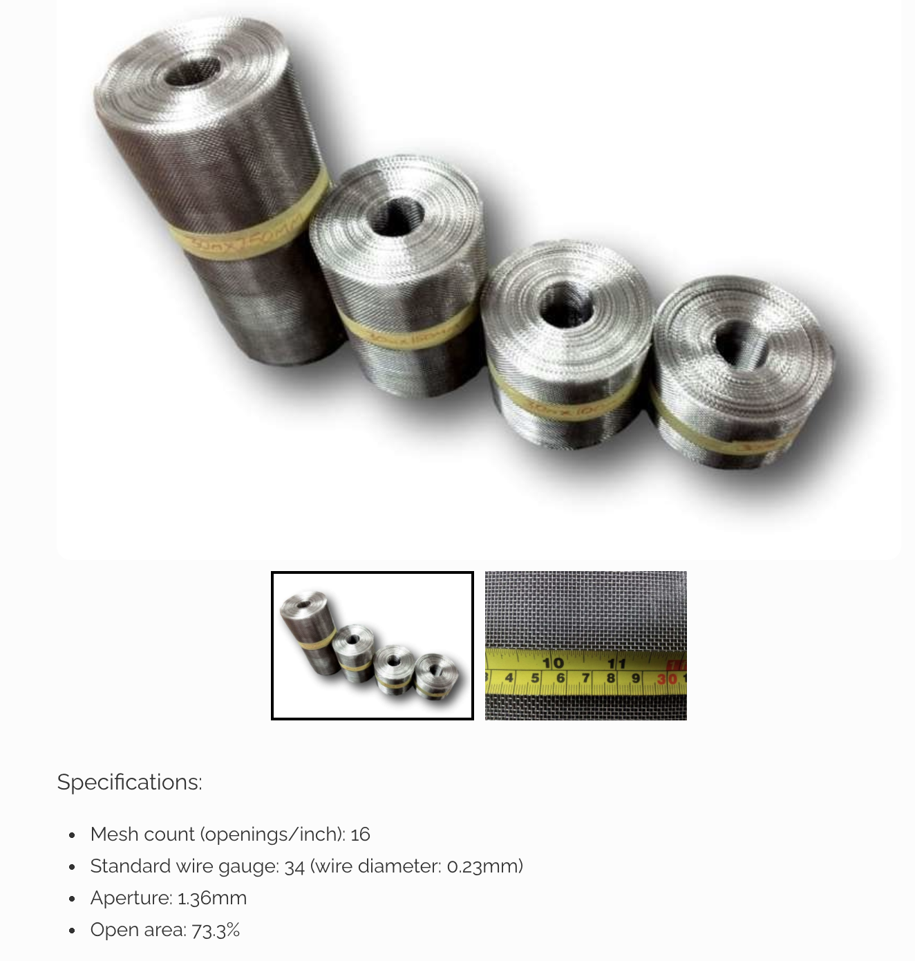

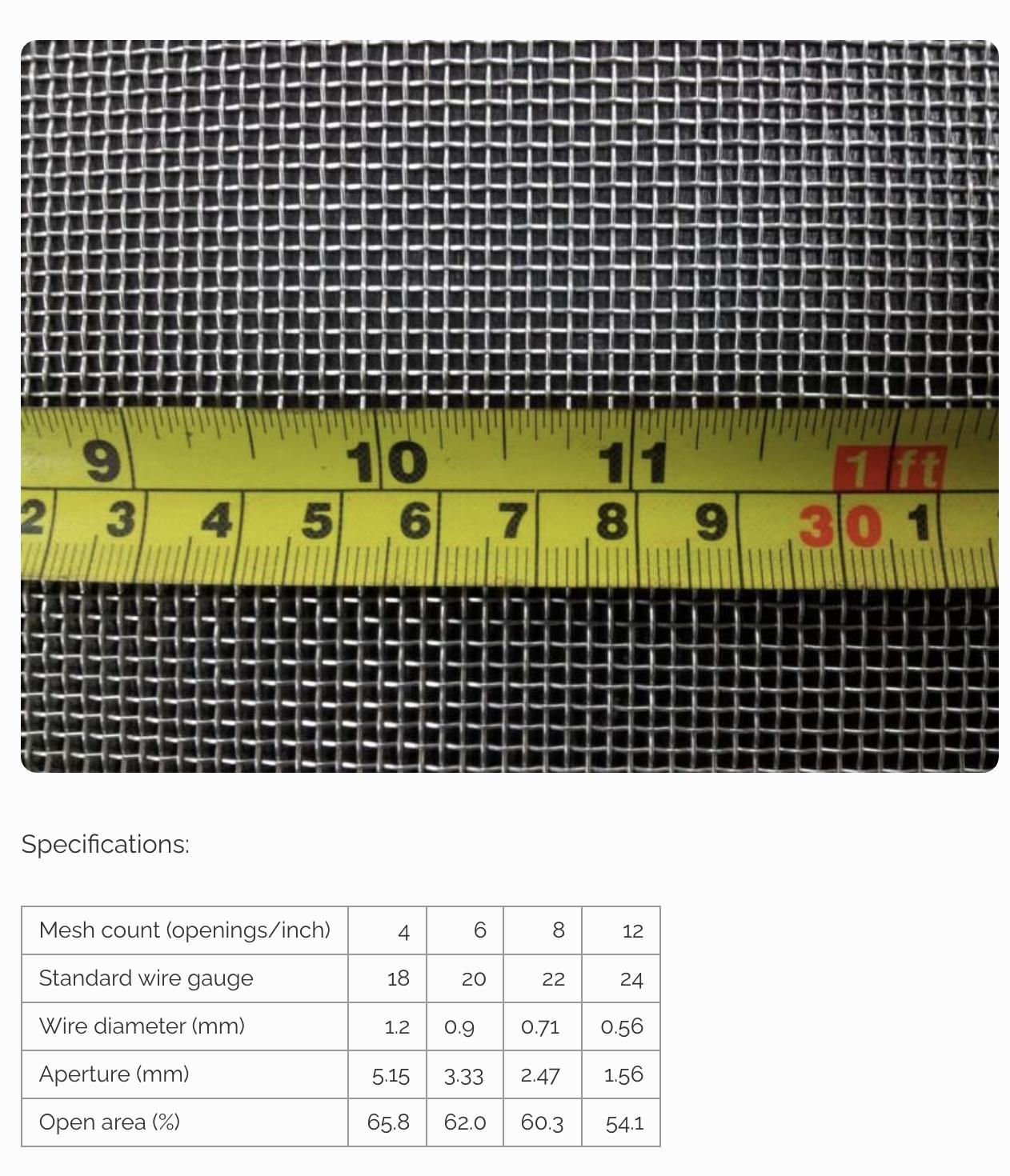

JamesP Posted September 4, 2020 Posted September 4, 2020 Can you advise as I am about to start cladding. I will have a 50 mm gap at the base of the vertical timber cladding and want to fix mesh to keep out rodents and insects as much as possible. Two options here but the Soffit mesh is a third of the price of the other. Any other alternatives you have used. 1
Mr Punter Posted September 4, 2020 Posted September 4, 2020 Most 50mm wide stainless mesh will do. If the cladding laps down a bit you could have a bit wider. Fix to the batten with stainless staples. 1

JamesP Posted September 21, 2021 Author Posted September 21, 2021 @SuperJohnG https://www.robinsonwirecloth.co.uk/online-shop/Soffit-mesh-stainless-steel-30m-roll-p49612077 Excellent product and SS staples. Spend some time getting the detail right. 1

eandg Posted March 2, 2023 Posted March 2, 2023 On 23/02/2023 at 15:11, JohnMo said: Pretty similar Expand Did you just use the Robinson stuff at 100mm and bend it? Looking at Cedral and it's awful expensive in comparison.
JohnMo Posted March 2, 2023 Posted March 2, 2023 Mesh direct, by the roll. Scissors are fantastic also Category:Stainless Steel Soffit Mesh | Product Ordered: 10cm wide x 30m roll x4 Item No 304-SFLY100 Category: | Product Ordered: Heavy-duty Scissors for cutting fine mesh Item No FIN-225--PROMO 1

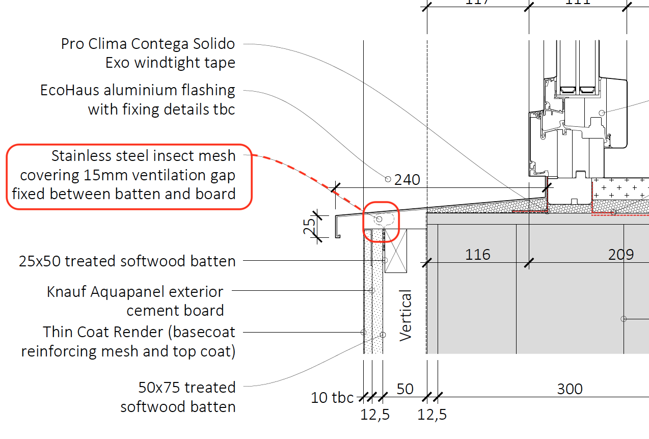

Russdl Posted December 17, 2024 Posted December 17, 2024 Definitely don’t leave a gap and don’t leave anything that could become ‘gappy’ over time. Any gap, no matter how small will be exploited. I’m trying to remember exactly how I did ours. IIRC correctly I attached the mesh to the timber frame, then the battens and folded the mesh over the top of the battens and secured the mesh with a counter batten so, to cover a 25mm gap I needed probably 75mm of mesh. I’ll see if I can find one of my drawings which may make it clearer.
Russdl Posted December 17, 2024 Posted December 17, 2024 Here's a detail of the insect mesh under the window cill. Basically do what ever you can with whatever you've got to seal every possible hole that an insect may exploit. It's a labour of love.
junglejim Posted December 17, 2024 Posted December 17, 2024 (edited) On 17/12/2024 at 20:17, Russdl said: Here's a detail of the insect mesh under the window cill. Basically do what ever you can with whatever you've got to seal every possible hole that an insect may exploit. It's a labour of love. Expand Thank you that’s really helpful… hadn’t even thought about the cills yet … can see the advantage of the flexible mesh. Edited December 17, 2024 by junglejim
Russdl Posted December 17, 2024 Posted December 17, 2024 On 17/12/2024 at 20:25, junglejim said: can see the advantage of the flexible mesh. Expand Yep, if you’ve forgotten a bit and all else fails you can just scrunch it into a ball and stuff it in the gap.
