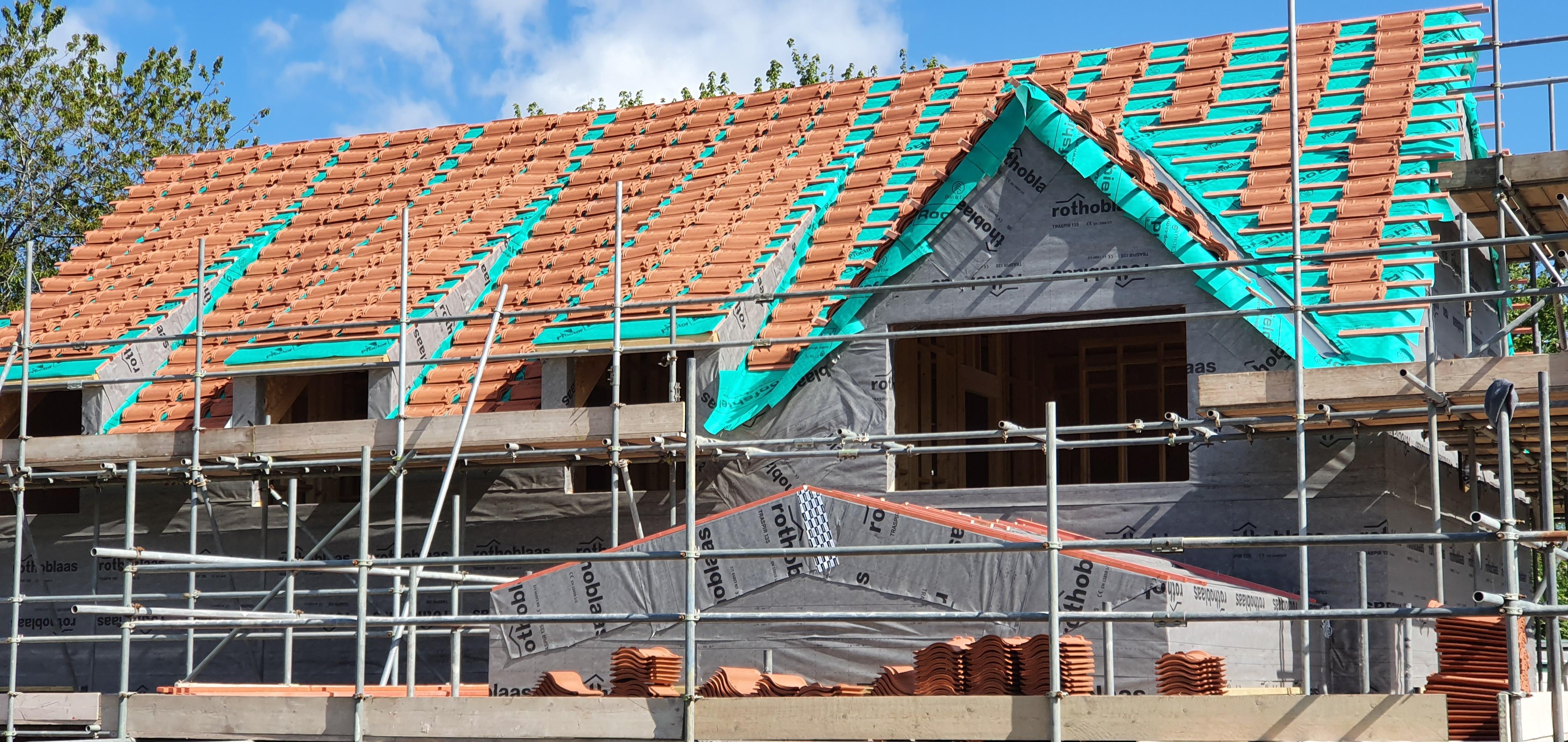

LA3222 Posted June 2, 2021 Posted June 2, 2021 (edited) 32 minutes ago, SuperJohnG said: plus I don't see why a membrane would be needed over the battens, makes no sense as there is a membrane on the SIPS outer layer. My roof buildup SIP outer sheath Membrane - housewrap Battens Proctor roofshield Counter battens Tile I did put an extra membrane on mine, reasons being it is a good quality non tenting roof membrane rather than a generic house wrap. Figured it can't do harm, only good?♂️ Edited June 2, 2021 by LA3222

LA3222 Posted June 2, 2021 Posted June 2, 2021 (edited) 7 minutes ago, SuperJohnG said: why???? lol. this is where I get confused. lol I view the house wrap as just a generic membrane, good at everything, Master of nothing. The Proctor roofshield is designed to be a roof membrane so I see it as belts and braces. Got generic wrap which was a bonus prize but got the good stuff doing the job it is supposed to do?♂️ I think the intimate contact between the wrap and the SIP didn't sit well we me either, happier having the roofshield with a ventilation gap under it between it and the SIP. Its probably all in my sward but I sleep easier having done it. The roof shield is expensive but pennies in the build budget. Edited June 2, 2021 by LA3222
SuperJohnG Posted June 2, 2021 Author Posted June 2, 2021 3 minutes ago, LA3222 said: I view the house wrap as just a generic membrane, good at everything, Master of nothing. The Proctor roofshield is designed to be a roof membrane so I see it as belts and braces. Got generic wrap which was a bonus prize but got the good stuff doing the job it is supposed to do?♂️ I think I have a VP400 roofing membrane on mine - so hoping that would suffice. What did you end up attaching the battens with? the engineer has specced nails, and from what I have seen so far looks like it'll be fine. I think you used screws though eh ?
LA3222 Posted June 3, 2021 Posted June 3, 2021 8 hours ago, SuperJohnG said: I think I have a VP400 roofing membrane on mine - so hoping that would suffice. What did you end up attaching the battens with? the engineer has specced nails, and from what I have seen so far looks like it'll be fine. I think you used screws though eh ? Yeah mate, screws. I went with the fixing details as given by kingspan tek. I emailed them about it and got directed to ejot technical department. They had done all the pull out strength testing etc and advised me on the type to use. Nails - not sure I'd want to go with them when all you have is 15mm of osb holding them in.
