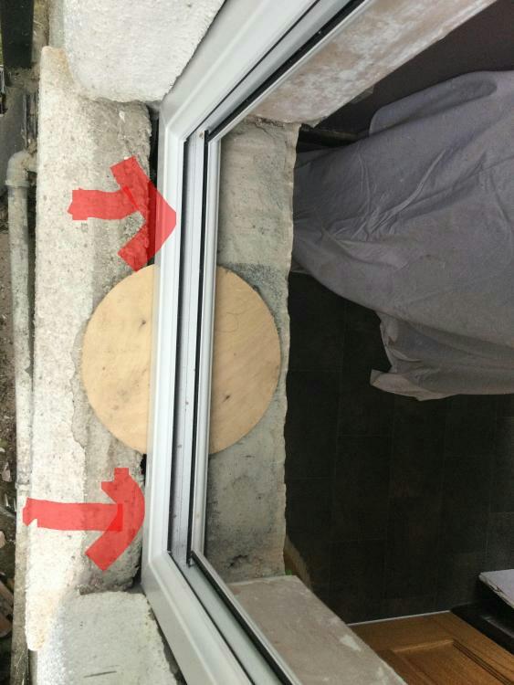

Gus Potter Posted September 2, 2022 Posted September 2, 2022 3 hours ago, zoothorn said: Thanks, never been called that before. Hi Zoot. Seems like you are going great. Just had a look at the photo. Where are the drainage holes/ slots? ? Looks like you have a face drained window with no sub cill.. can you check, hopefully you are going to tell me I am blind or worse.
Onoff Posted September 2, 2022 Posted September 2, 2022 1 hour ago, Gus Potter said: Hi Zoot. Seems like you are going great. Just had a look at the photo. Where are the drainage holes/ slots? ? Looks like you have a face drained window with no sub cill.. can you check, hopefully you are going to tell me I am blind or worse. It's face drained see the picture on page 4.
Gus Potter Posted September 3, 2022 Posted September 3, 2022 29 minutes ago, Onoff said: It's face drained see the picture on page 4. I've had a look at page 4 of the posts, I think I should see some small cover plates on the vertical face on the outside of the window frame.. face drains. Page 4 at my end shows a bottom drained setup where the water runs out onto the sub cill and outwards. Am I having a "senior moment"
Onoff Posted September 3, 2022 Posted September 3, 2022 3 minutes ago, Gus Potter said: I've had a look at page 4 of the posts, I think I should see some small cover plates on the vertical face on the outside of the window frame.. face drains. Page 4 at my end shows a bottom drained setup where the water runs out onto the sub cill and outwards. Am I having a "senior moment" The cover plates clip into the slots you can see? He must have them lying loose somewhere. @Tempput up typical pics on page 3.
Gus Potter Posted September 3, 2022 Posted September 3, 2022 Have had a look at page three.. oh happy memories Temp shows a bottom drained set up.. I think. Hey ho! Some may say.. "would you see it from a galloping horse?" I say.. get it wrong and you void the warranty on your sealed units and risk water ingress. I don't have a horse BTW so am talking..
Onoff Posted September 3, 2022 Posted September 3, 2022 8 hours ago, Gus Potter said: Have had a look at page three.. oh happy memories Temp shows a bottom drained set up.. I think. Hey ho! Some may say.. "would you see it from a galloping horse?" I say.. get it wrong and you void the warranty on your sealed units and risk water ingress. I don't have a horse BTW so am talking.. Erm no... This is a face drained set up: This is @zoothorn's window. The arrows point to the face drains, though my crap arrows are obscuring them maybe. Look at the original photo on page 4. It's face drained.
zoothorn Posted September 3, 2022 Author Posted September 3, 2022 17 hours ago, Gus Potter said: Hi Zoot. Seems like you are going great. Just had a look at the photo. Where are the drainage holes/ slots? ? Looks like you have a face drained window with no sub cill.. can you check, hopefully you are going to tell me I am blind or worse. Hi there Gus, thanks it is going great in fact. Yup as Onoff shows drain holes in outside front. Cheers Zoothorn
