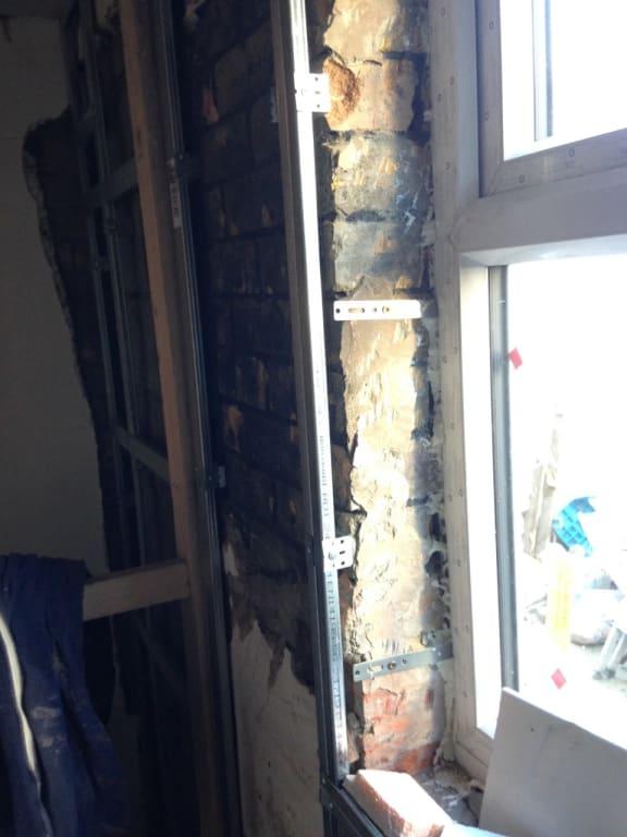

Onoff Posted September 1, 2022 Posted September 1, 2022 There are also window fixing cleats you can get that clip or screw into the outside edge of the frame, then get screwed to the block / brickwork, like this:
joe90 Posted September 1, 2022 Posted September 1, 2022 Just now, Onoff said: There are also window fixing cleats you can get that clip or screw into the outside edge of the frame, then get screwed to the block / brickwork, like this: Yes and these use rawlplugs and screws (or just use metal strapping and self tappers into the frame, but let’s not confuse Zoot anymore eh?).
