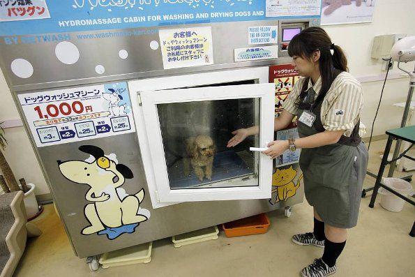

Ferdinand Posted September 1, 2020 Posted September 1, 2020 (edited) To be fair, when I lived in South Hampstead my landlord used to jog across the Heath for a swim every morning, then come back and take a cold shower in the nud in the back garden afterwards for most of the year. If a 60 year old willow-thin Londoner can do it, you lot must really be pampering your doggos. Have anyone got a hot air dryer to make them extra comfy? (But I'm the one who installed the catflap into the shed to keep the cat in its correct place.) Edited September 1, 2020 by Ferdinand 2
