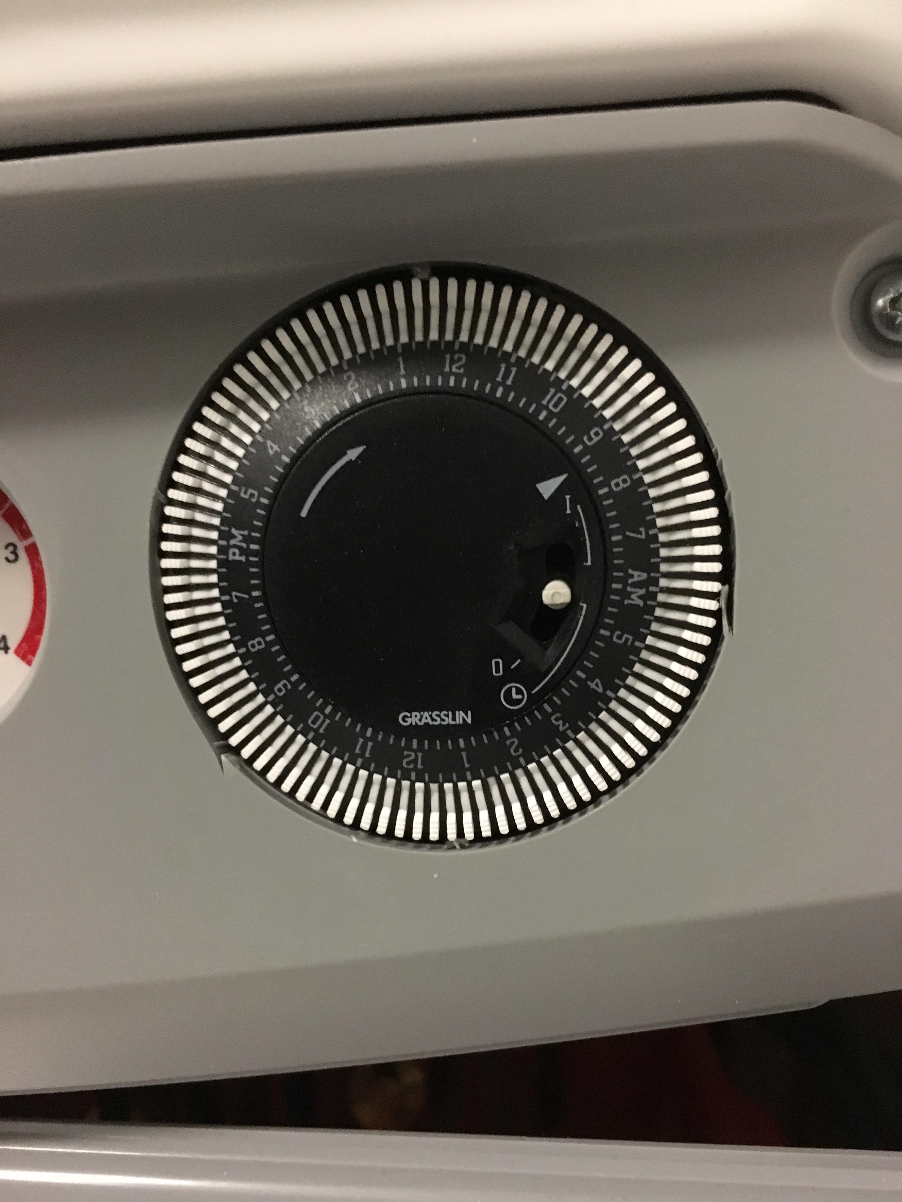

Calvinmiddle Posted January 3, 2017 Share Posted January 3, 2017 The mechanical timer switch on my new eat BAXI Duo boiler doesn't seem to be working, never tried to use it previously but I've tried to use it recently and it doesn't seem to turn. I'm wondering if these things are generic or do I have to buy a BAXI one. Also wondering if there is a way to fix it (take it out and give it a bang on the bench) and if this is a common problem Link to comment Share on other sites More sharing options...

Calvinmiddle Posted January 3, 2017 Author Share Posted January 3, 2017 This is the offending item, it's on the timer setting but just doesn't seems to turn. Not sure it would be covered but the warranty as it was an extra to the boiler, and I bought it myself and got the plumber to fit so don't think I have any recourse with him, besides it was a couple of years ago now Link to comment Share on other sites More sharing options...

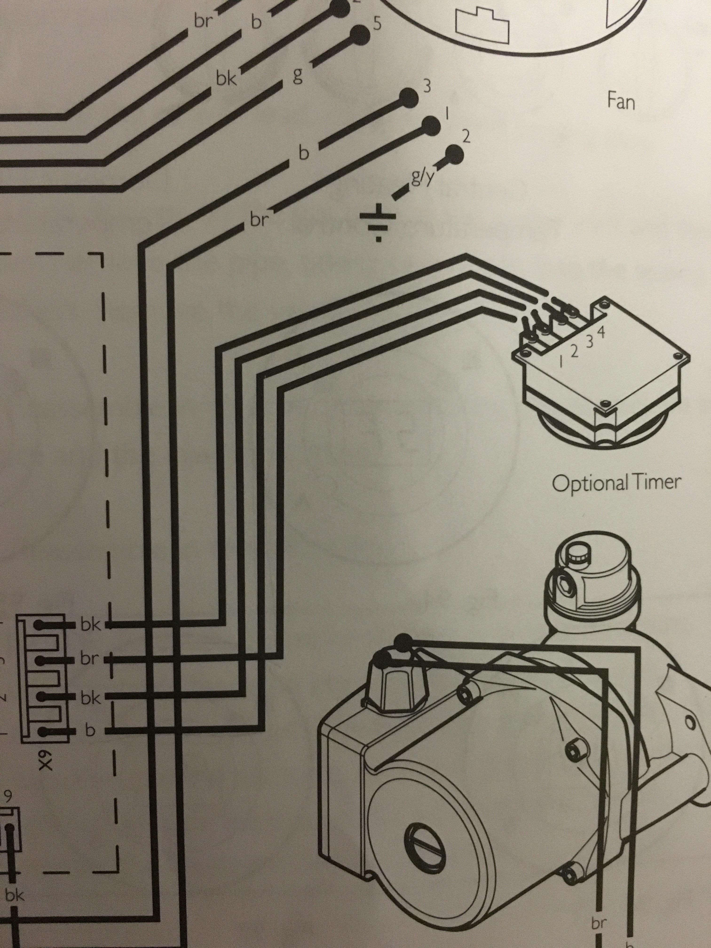

Calvinmiddle Posted January 3, 2017 Author Share Posted January 3, 2017 4 minutes ago, ProDave said: Then it's almost certainly generic, but you will need to know if it has switched L output, or a volt free contact. Here is a pic of the wiring diagram Link to comment Share on other sites More sharing options...
Steptoe Posted January 3, 2017 Share Posted January 3, 2017 Is it actually plugged in at all,? Believe it or not, sometimes people fit them but don't plug them into the loom. Link to comment Share on other sites More sharing options...
Steptoe Posted January 3, 2017 Share Posted January 3, 2017 9 minutes ago, ProDave said: Then it's almost certainly generic, but you will need to know if it has switched L output, or a volt free contact. They are generally volt free @ProDave Ls - Lr Link to comment Share on other sites More sharing options...

Nickfromwales Posted January 3, 2017 Share Posted January 3, 2017 @Calvinmiddle Did it work, and then stop working? Link to comment Share on other sites More sharing options...
Nickfromwales Posted January 3, 2017 Share Posted January 3, 2017 And can I talk you through taking the cover off and taking a pic of the back of the clock? Those grasslin clocks are just about as reliable as you can get, so I'd bet my arse it's wired ( arse ) backwards . So, with the power switched off.......... The pic you've taken of the clock shows a silver screw. It has a matching buddy the other side. Loosen and remove them and the panel will swing down. You'll see a square panel at the back of the clock which is the retention 'plate'. It'll have two smaller screws at two opposite corners.......remove those too. Remember how it comes off as its a pita to get back on . Once the screws have been removed from the plate lift it off. The clock is now free to move and certainly will. Take a pic of the wires as clearly as you can and post back. My money is on the number one common fack up, which is the 230v mains connected to the volt free contacts of the switch, and the switching pair on t'other ( motor feed ). Other than that it could be that they took the short cut ( avoided connecting it ) and left the factory 4-way moulded block in there ( which connects the switching pair together so the boiler will work for heating and hot water as normal, and isolates the mains feed also ). Go get your screwdriver. Link to comment Share on other sites More sharing options...

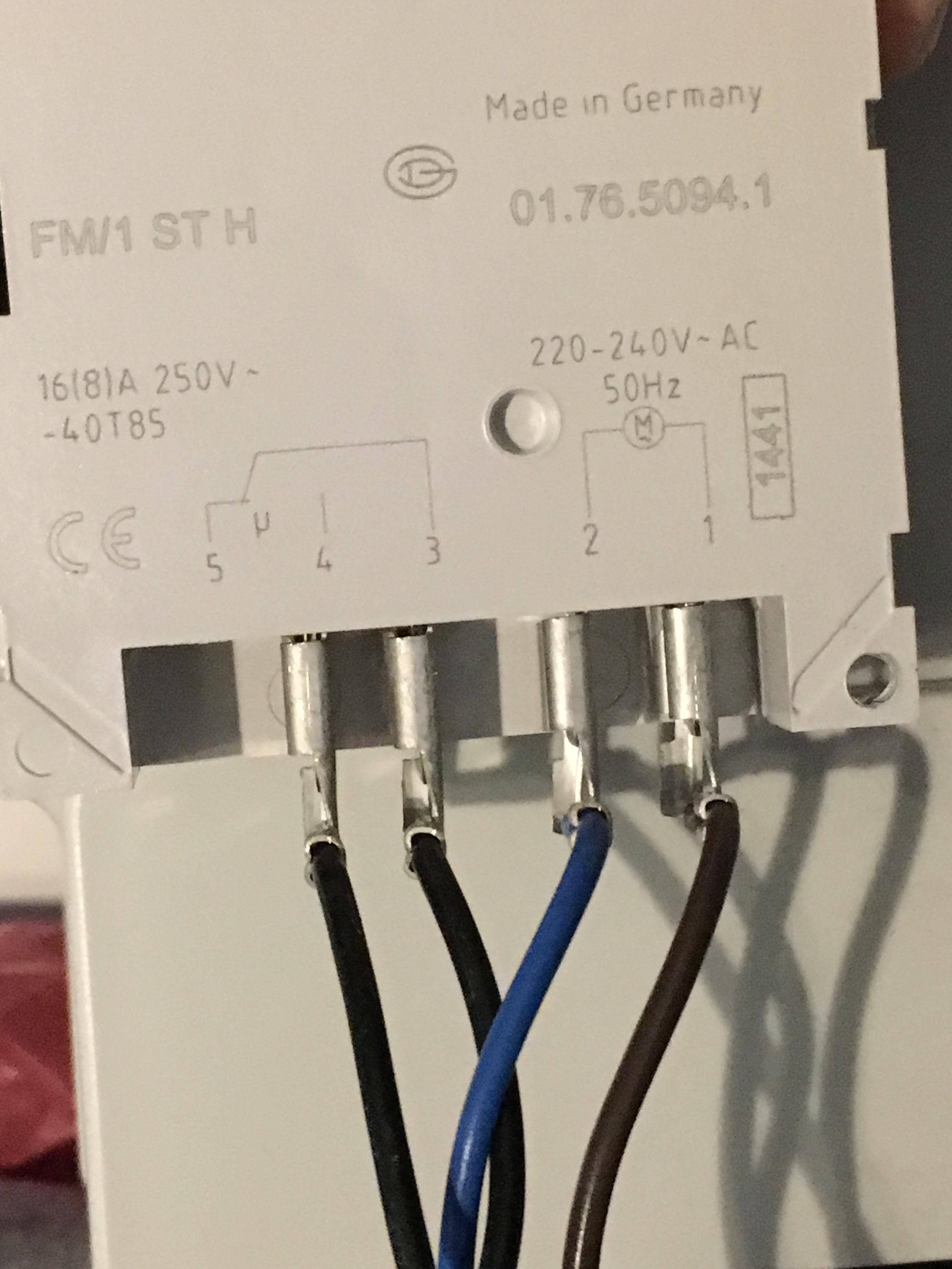

Calvinmiddle Posted January 8, 2017 Author Share Posted January 8, 2017 Here are the wires, looks OK to me as agrees with the wiring diagram, brown on 1, blue on 2 and black to 3 & 4 Link to comment Share on other sites More sharing options...
Nickfromwales Posted January 8, 2017 Share Posted January 8, 2017 5 minutes ago, Calvinmiddle said: Here are the wires, looks OK to me as agrees with the wiring diagram, brown on 1, blue on 2 and black to 3 & 4 Can you put a multimeter on 3&4 to check the switching action? Also, I take it you've moved the slider on the clock face accordingly ( on / timed / constant ) ? What exactly is the boiler doing / not doing? Link to comment Share on other sites More sharing options...
Nickfromwales Posted January 8, 2017 Share Posted January 8, 2017 Also, can you check that at least one of the black wires is live @230v ( with the boiler supply switched on ). Link to comment Share on other sites More sharing options...
Calvinmiddle Posted January 8, 2017 Author Share Posted January 8, 2017 Don't have a multimeter, should have a screwdriver with a mains tester in it somewhere so can check the back wires when I find it. when slider is on, boiler is on when slider is off, boiler is off when slider on timer it does whatever is selected on the little 15min increment things, but fail does turn, so just stays on that time forever. should the dial be turning even when the slider is at the "on"? Link to comment Share on other sites More sharing options...
PeterW Posted January 8, 2017 Share Posted January 8, 2017 Yes it should turn when the boiler has power and when it's firing not firing..... put it very close to your ear and you should hear a buzzing sound as they use a standard motor with about half a dozen nylon gears that make a racket ..!! Link to comment Share on other sites More sharing options...
ProDave Posted January 8, 2017 Share Posted January 8, 2017 Use your mains tester screwdriver. Does it light up when touching the brown (terminal 1)? Does it light up when touching the blue (terminal 2)? Link to comment Share on other sites More sharing options...
Nickfromwales Posted January 8, 2017 Share Posted January 8, 2017 Looks like I'm minus an arse cheek. Sounds like the clock isn't turning ( Friday afternoon on the ars-sembly line ) Buy a new one and should be the end of it, but can you not take it back for a free replacement? Link to comment Share on other sites More sharing options...
Steptoe Posted January 8, 2017 Share Posted January 8, 2017 Or, Try manually turning the clock to an 'ON' position, See if the boiler fires, But, deffo sounds like a dodgy clock. Link to comment Share on other sites More sharing options...
