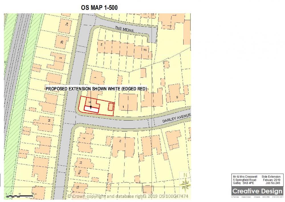

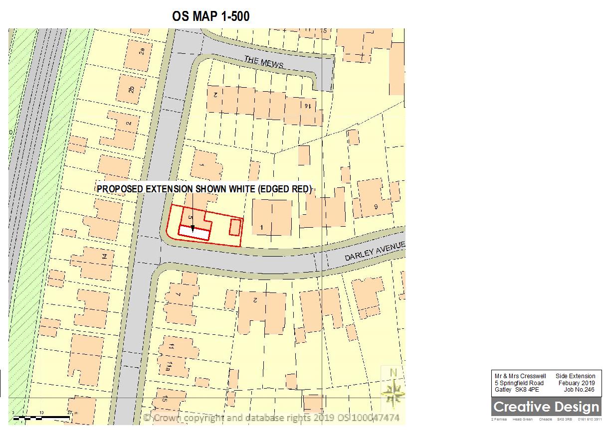

Cresswelle Posted August 21, 2020 Author Share Posted August 21, 2020 This is the site plan. As you can see the approved extension breaks the build line anyway so I don’t see why an extra level would make too much difference. The front elevation would be in line with similar houses on our road albeit they are not corner plots Link to comment Share on other sites More sharing options...
DevilDamo Posted August 22, 2020 Share Posted August 22, 2020 A two storey extension has much more of an impact than a single storey extension irrespective of the location/position of the property. It is however a little different for a corner plot because the overbearing impact can be seen to be a little worse. If you are going for any two storey side element, check your LPA’s policies and guidance on subservience. Also note the single storey extension could be carried out via PD, assuming the rear projecting part is ‘original’ and not a previous extension. Link to comment Share on other sites More sharing options...

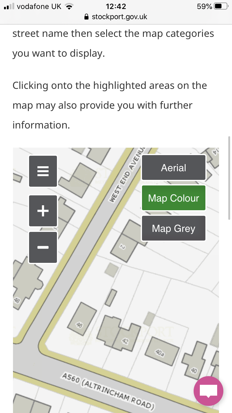

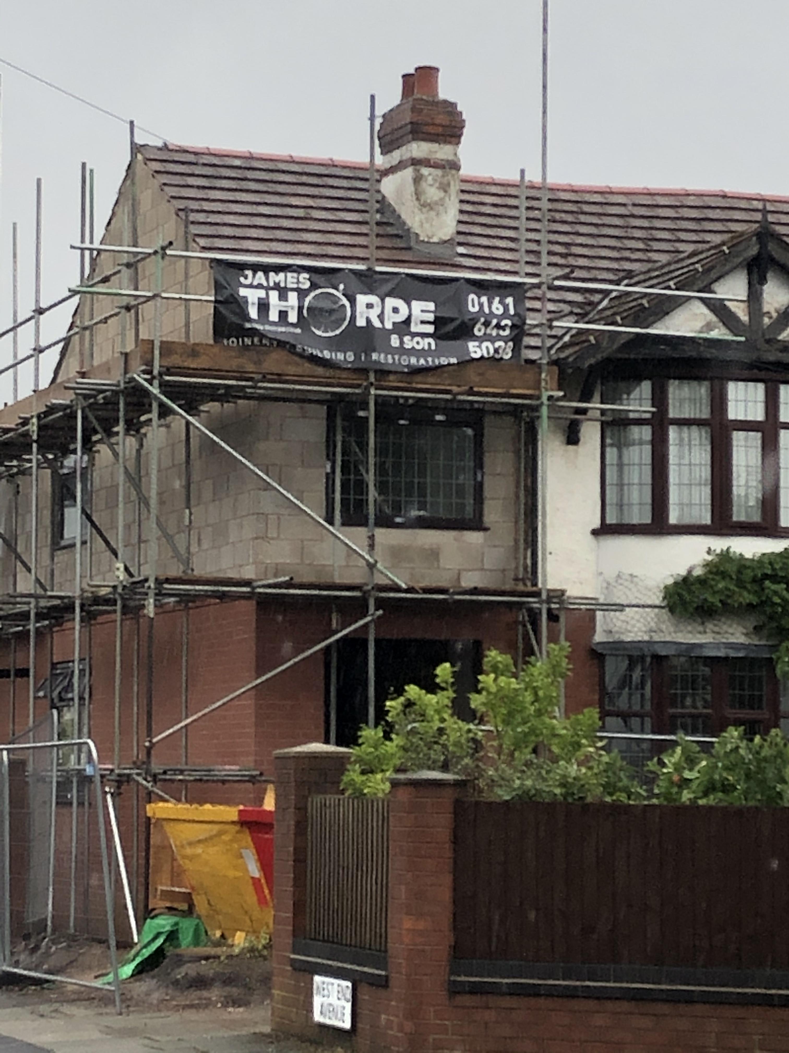

Cresswelle Posted August 22, 2020 Author Share Posted August 22, 2020 Did you end up not bothering or applying for planning anyway? ive been to see the house near me and they have def built over the build line. It’s number 46 on the below street plan. Link to comment Share on other sites More sharing options...

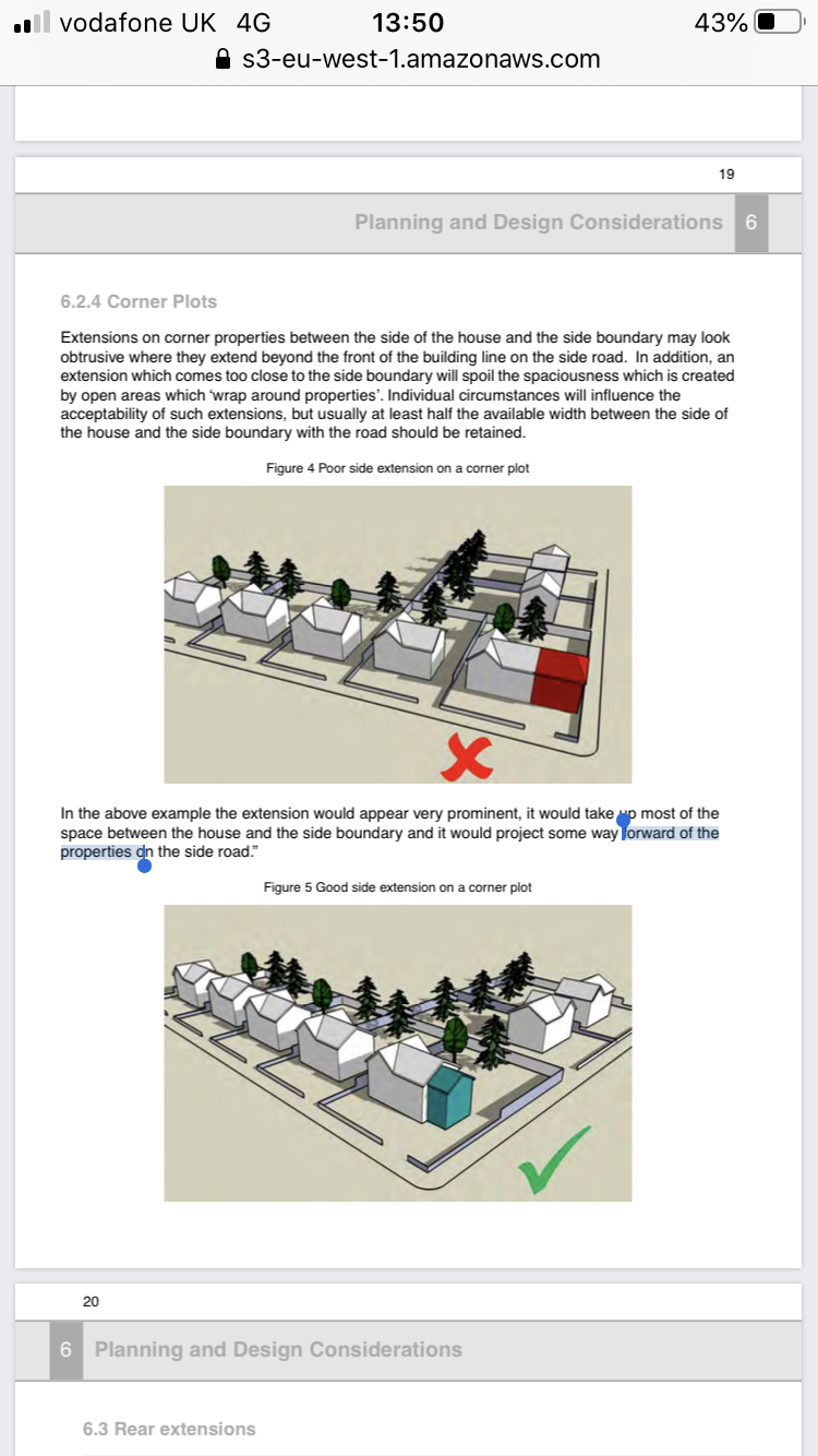

Cresswelle Posted August 22, 2020 Author Share Posted August 22, 2020 I’ve found this on the planning site which states as long as I leave half the boundary then it’s more acceptable. The side garden is 4 metres across so we could just bring the front in to 2 metres and then extend up. Just means the room would be 2 x 4.5 which is probably ok for what we need Link to comment Share on other sites More sharing options...
Temp Posted August 22, 2020 Share Posted August 22, 2020 Quote that in your application. 1 Link to comment Share on other sites More sharing options...
DevilDamo Posted August 22, 2020 Share Posted August 22, 2020 An external width of 2m? Link to comment Share on other sites More sharing options...
Cresswelle Posted August 22, 2020 Author Share Posted August 22, 2020 2m internally. Be two slim for a Bedroom but we could shuffle things round Internally to make it work. The architect has come back saying that our case is strengthened by the local example and we are leaving a good 1 metre from the boundary wall so worth a shot Link to comment Share on other sites More sharing options...
