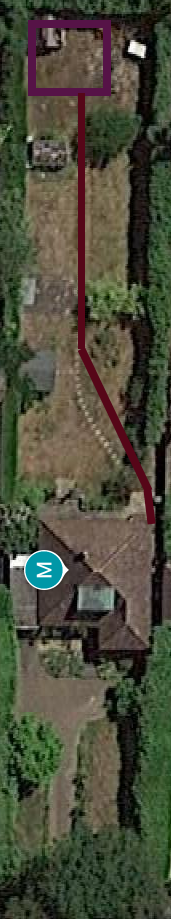

oldkettle Posted August 19, 2020 Share Posted August 19, 2020 Hi, Just had a quote for the foundations and services for our outbuilding. Seems on the high side to me - can you please have a look? South East. I will check how much insulation they quoted for because they omitted this little detail, but there are a few things I don't quite understand. 1) What are prelims - on top of setting up and SE work. 2) why do they need 2 skips (at an inflated price from what I can see) if there is no demolition involved, the only thing to get rid of is probably formwork? 3) 50m excavation (in our back garden, I think the number is slightly high) looks like a 2 day job for a mini-digger and probably less for a trencher? Obviously, no idea about the main item as the cage size may be quite large due to Lawson's cypress in 2m, but mesh seems to be about £600 for 2 layers + cages, the main slab is about 5m3 of concrete + way more on the toes at £100+m3. TA. Quantity Unit Value Total Raft Foundation Set up and enable site 1 item £ 300.00 £ 300.00 Supply structural engineers design and calculations 1 item £ 850.00 £ 850.00 Cut and fill ground to accommodate a 6x9m raft foundation 54 m2 £ 20.00 £ 1,080.00 Supply and lay HEXATHERM XFLOOR 300 (insulation) under raft foundation 54 m2 £ 62.00 £ 3,348.00 Lay hardcore sub base, install timber formwork, install 2 layers of A393 steel mesh with perimeter toe steel cage. Pour RC35 concrete for a reinforced slab as per Structural Engineers design 54 m2 £ 160.00 £ 8,640.00 Supply concrete pump 1 item £ 800.00 £ 800.00 6 yrd skip 2 nr £ 330.00 £ 660.00 Services Excavate trench and install 110mm foul pipe, include connection into exiting chamber 49 m £ 55.00 £ 2,695.00 Additional chambers and back drops 3 items £ 450.00 £ 1,350.00 Supply and lay 25mm water pipe to open trench (connections by others) 49 m £ 6.00 £ 294.00 To terminate by corner of house Supply and lay 65mm electric duct 49 m £ 7.20 £ 352.80 To terminate by corner of house Sub total £ 20,369.80 Prelims @12% £ 2,444.38 Total (excl VAT) £ 22,814.18 Link to comment Share on other sites More sharing options...

Mr Punter Posted August 19, 2020 Share Posted August 19, 2020 Your prelims are for managing the job, RAMS, PPE etc. May also be for overheads costs and profit. Skips - for concrete pump washout? Offcuts from insulation. Packaging. Pallets. Pipe and duct offcuts. Tree roots. Not sure how deep the foul is going but it doesn't sound crazy. Can you exclude any of these from their works and do yourself? At least now you have prices and quants you can compare to others / look at SPONS. 1 Link to comment Share on other sites More sharing options...

PeterW Posted August 19, 2020 Share Posted August 19, 2020 6 minutes ago, oldkettle said: They are quoting chambers and back drops at £450 a pop - seem to cost about £200 normally? Surely doesn't take a plumber half a day to install each of them? Sounds about right. Chamber will be £150, benching and backfill, excavation etc will be about right. If they have to do external backdrops then these take a lot more effort and bits to make them work. 1 Link to comment Share on other sites More sharing options...

oldkettle Posted August 19, 2020 Author Share Posted August 19, 2020 Sorry, there are none: he came around to look at the site, took some measurements and provided a quote in a few days. The project is to build a 9x6 gym at the top of our garden, and take services there (and foul water back). This company has quoted for the groundworks part. As I said, there is a fall of about 2.5-3m from the top point towards the house and the distance is about 40m. There may be a gentle turn or two on the way to arrive at the corner. Attached is a very very rough drawing of what needs to happen. Link to comment Share on other sites More sharing options...
PeterW Posted August 19, 2020 Share Posted August 19, 2020 So without knowing the invert level it’s difficult to say but not sure why he’s quoting to put back drops in ..? If your invert at the house is say 600mm, start at 1.2m at the back and you’ve got about a 1:20 fall across the drains. Nothing too dramatic. Needs an IC half way down but that’s all. 9 minutes ago, oldkettle said: The project is to build a 9x6 gym That’s a very big gym..!!! What is the construction method planned and whats the access to the back garden ...? Link to comment Share on other sites More sharing options...

Mr Punter Posted August 19, 2020 Share Posted August 19, 2020 Backdrops not required. Given that this is only a gym I would want to reduce the cost by 40%. EPS insulation is fine under the slab and if you DIY will save 70%. You may get a more economical slab design. The £4,700 for the trench and buried plastic seems steep. With the prelims, because they are a percentage these should come down as well. Just use this as an initial quote and look at savings that can be made. Because it is a fair sized slab you will need someone competent to pour and finish the concrete. Regarding the build method, why not blockwork cavity walls with insulation? Does not need to be passive standard, just normal batts or partial fill pur. If you are keen to muck in you could load out the blocks for your brickie. You could have the brickie and his mate do a day a week and they would do it in no time. 1 Link to comment Share on other sites More sharing options...
