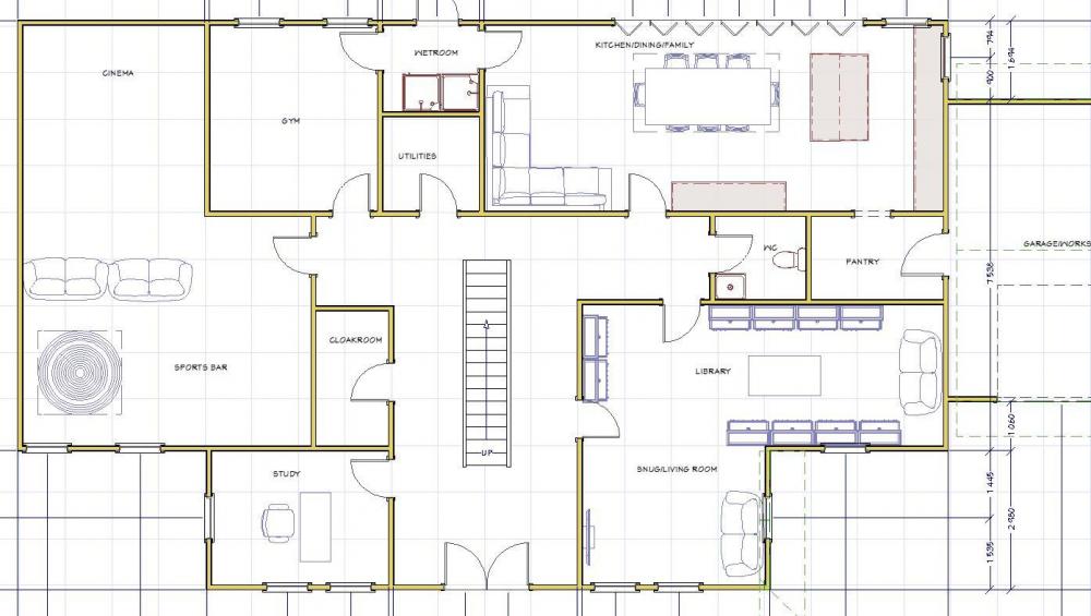

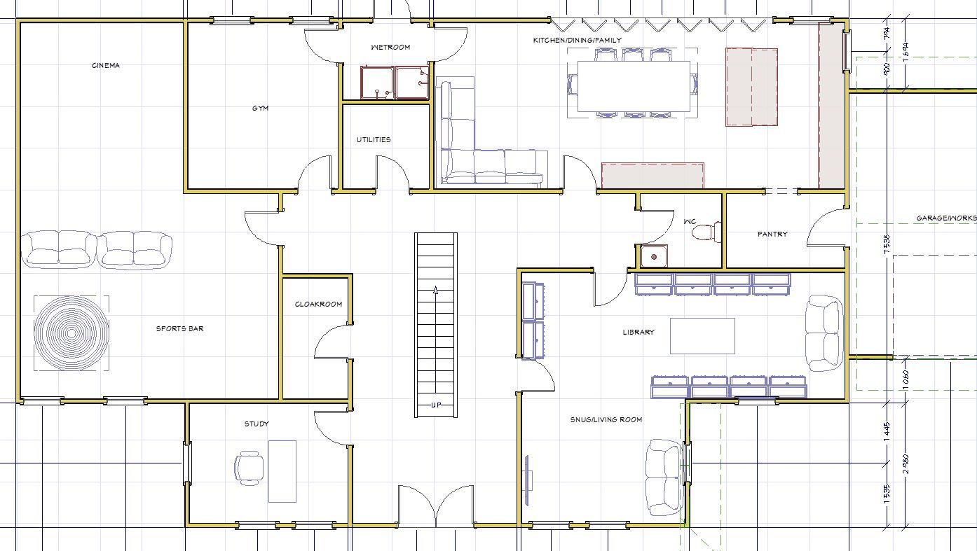

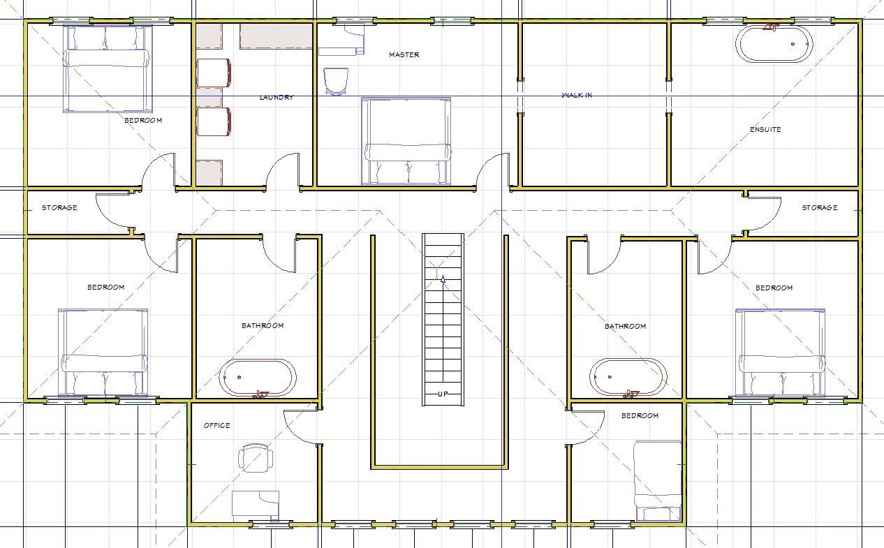

Ferdinand Posted August 20, 2020 Posted August 20, 2020 (edited) I think you have some excellent feedback above. I would add: 1 - I think you have too many small rooms. The library / study combo idea is excellent. 2 - I think there is too much circulation space - esp. the hall. See how the Edwardians or the Jacobeans did feature halls in their villa type houses - aiui normally they would get a dramatic staircase and some sort of reception or banquet space into something that size. If you want it dramatic I would move the bottom back from the door by some distance, and make it a Y staircase with 2 branches at the top. I would also make the staircase appreciably wider than a normal one -s ay 1.1-1.2m. The rake of the staircase also matters. You should be able to get a blow-em-away hall without quite such a sacrifice. 3 - Are you being conditioned by compressed London houseplan forms and small rooms? I had a delightful BH London-based visitor this week who commented that my 'orribly tight single bedroom was "medium sized". Different perceptions. Up until now I have thought of it as almost a box - room, with space for a bed, a bookshelf, a chest of drawers and a chair. Educational. Guess where London people who are used to smaller rooms will be sleeping now ?. 4 - Had some trouble with the font. I read them as "caveman's sports bar" and "petroom". ? 5 - When you revisit this the context in the plot - sun etc - will be the thing to take care adjusting. 6 - Cautionary. Make sure that you have the rest of your life too. The purpose of a self-build is ultimately to spend your time living in it not building it. We lost my dad at 72 to a condition where the seeds were sown when he was in his 30s, whereas mum had been hoping for another decade together - did not happen. There is a lot to be said for the 'Sacrament of the Present Moment" idea (that version is from a Jesuit idea) - time gone does not come back. That's something I'm coming to reflect on having had months of my otherwise-plans lost in lockdown. (I love the piccie of the dalmation - get a red setter on a floor like that and it will skating around like bambi on ice.) Ferdinand Edited August 20, 2020 by Ferdinand 1 1

mjward Posted August 20, 2020 Author Posted August 20, 2020 Didn't take me long...just had my first ??♂️??♂️??♂️??♂️ moment on this site. Spent 20 mins writing out a full response, pressed enter by mistake and it just went to the first page and lost all my content. Doh! The summary version: 1) staircase/hallway needs big asterix next to it. Not married to any design at this stage but simply want some open front door wow factor. 2) basement I love that idea and certainly makes more plots work for us. I'm just coming from Victorian property ownership (both have basements that love to flood/or get damp despite a fairly recent shoddy tanking #longstory). If I can get confidence in the waterproofing it is very appealing. 3) above also covers another point re room sizes, thankfully but bizarrely we have managed to enjoy large Victorian detached room sizes but I find them too big for the most part 4) our catalyst for all this is actually closer to the personal stories you have shared. My wife's health has steadily deteriorated and we decided that we have done enough that I could quit the rat race and finally fulfil our long term dream to enjoy quality time together for as long as we have it. 5) the % cost of the watertight structural part sounds good to me. Ballpark I think we have enough cash for the full build + 50% buffer but I'm naturally risk averse so this brings me further comfort Hopefully with the updated floor plans below you can see how I've adjusted to your advice whilst also keeping a house design that we actually want. Couple of notes: 1) garage is mostly out of shot but I've made it 6.5m in depth..just checked and my car is 4.98m so good spot thanks! 2) toying with developing the roof space above the garage with dormers etc. If we did we turn the far right storage space into a hallway to this garage roof area 3) conscious design is very much plot dependent but what I'm hoping to achieve here is a better understanding of what is the dream house, what do I really want. From there I hope to have a better idea of a small plot and go with basement works or if I indeed need a large area to accommodate the current designs.
the_r_sole Posted August 20, 2020 Posted August 20, 2020 So, say you're in your back garden doing some mucky work and you're bursting for a pee, you have to come in, through a room, through another room into the hallway and into the only wc on the gf ..

mjward Posted August 20, 2020 Author Posted August 20, 2020 44 minutes ago, the_r_sole said: So, say you're in your back garden doing some mucky work and you're bursting for a pee, you have to come in, through a room, through another room into the hallway and into the only wc on the gf .. Sorry it's not clearly identified in the plan but would have a toilet in the wet room. I need to figure out how to give it privacy as currently 3 doors go to that room

AliG Posted August 20, 2020 Posted August 20, 2020 You can get a room sealed wood burner. The issue you would have to watch for is they can generate too much heat in a very well insulated house. As you don’t have a site in mind yet I would just keep to a room schedule and a list of wants. The specific plan of a house would be incredibly different plot to plot. 1

Ferdinand Posted August 20, 2020 Posted August 20, 2020 2 hours ago, the_r_sole said: So, say you're in your back garden doing some mucky work and you're bursting for a pee, you have to come in, through a room, through another room into the hallway and into the only wc on the gf .. The back garden has a bush in it. ? 2
