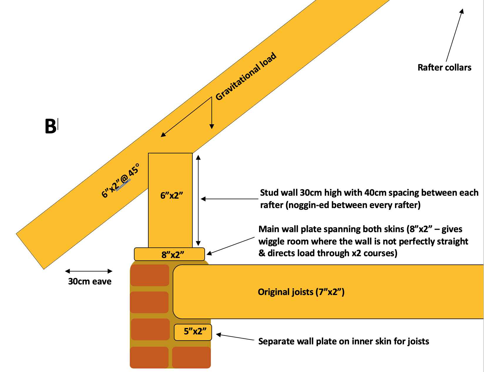

Just wondering what peoples thoughts are on this roof design...I'm considering sitting a roof on a 30cm stud wall to give more usable height on the second floor, however I haven't seen this method used elsewhere before. The structure will consist of 6x2 rafters with collars. The building in question is an 18th centuary stable block that I am renovating with my brother. We are reluctant to go up any more courses of brickwork in the interest of time and cost...we have done all the work so far and are on a tight budget (famous last words). We've calculated a 45 deg pitch will give us a 30cm eave with the stud wall and will not increase the ridge height too much (if at all) from what it was orginally.

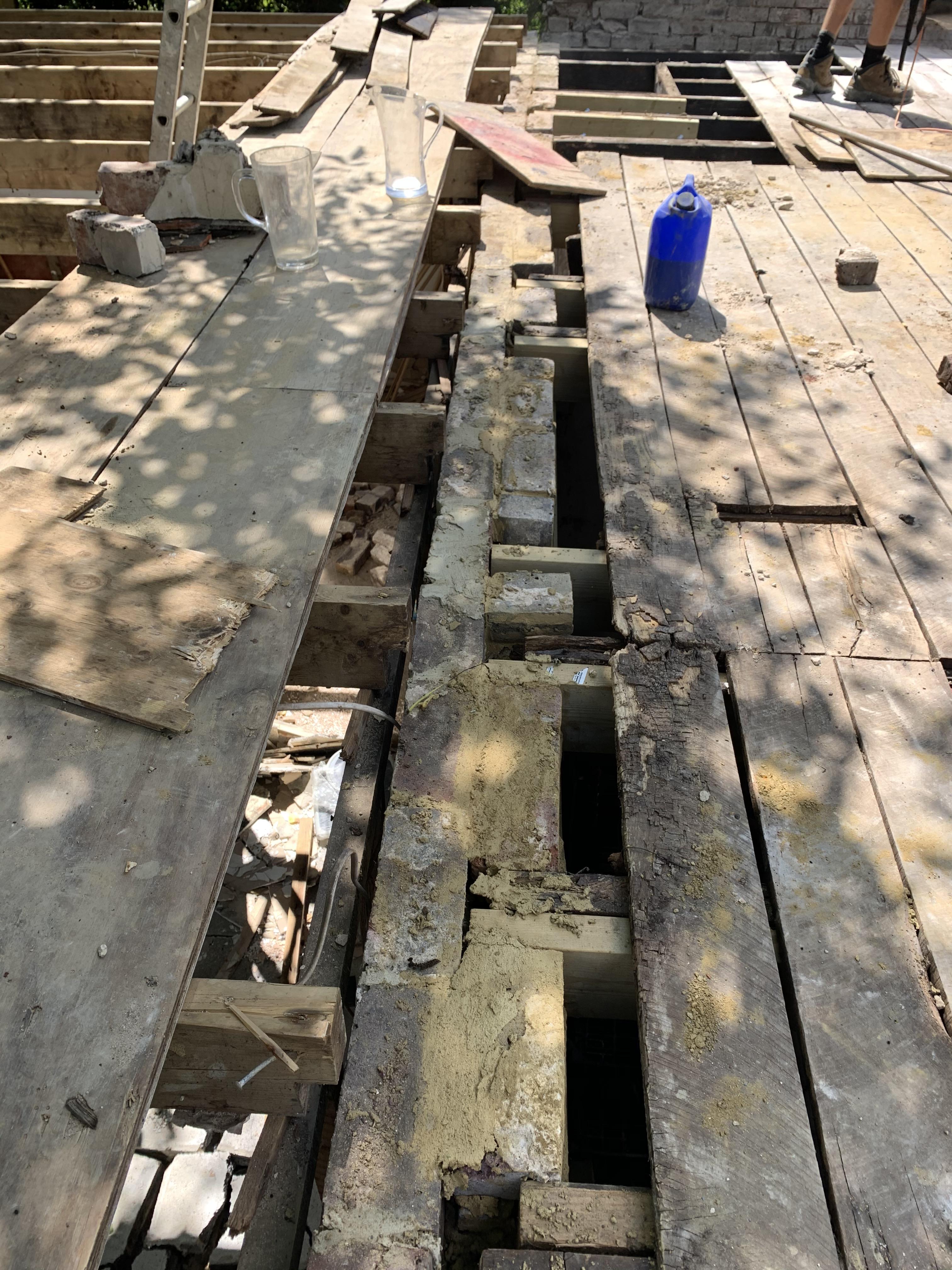

Note the odd design - two wall plates, one to bear the rafters and a second wall plate on the inner skin two courses lower to bear the joists which has brickwork ontop of that wall plate between each joist (the picture i've attached should clarify). In terms of building regs the building is an ancillary building to my parents house and we are treating the project very much as a restoration rather than a development...the original tiled roof had rotted and partially collapsed. We are considering putting a corrugated iron roof on but would like to build the frame so that it is strong enought to take tiles if we do decide to go down that route (unfortunately only about 30% of the original tiles are still usable).
Any advice is much appreciated, keen to hear peoples thoughts...

I think you need SE input on this, mainly to ensure the roof isn't going to sag and push the walls out. I recall reading that collar ties aren't intended to stop the rafters pushing outwards and that a structural ridge beam should be used if you can't otherwise triangulate the roof.

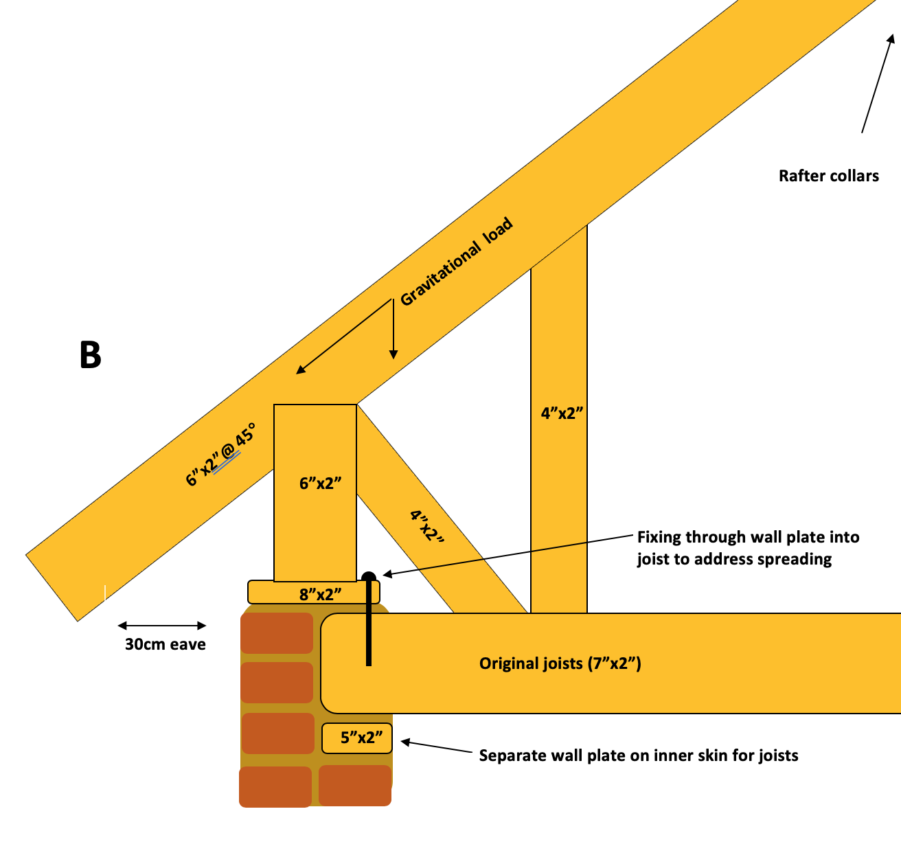

We are actually planning on driving fixings down through the wall plate and through the top of the joists where the 8x2 covers both courses which im hoping will minimise the chance of any spreading. The plates will also be strapped up every meter. Just to be belt and braces I could add some trianguation from the top of the 30cm lifter to the joist? There will also be a stud wall inside tied from the rafter to the joists.

Do you think with the wall plate fixed to the joists and also a stud wall on the inside tied from the rafter to the joist would provide sufficient triangulation?

If you can't have a bottom chord you'll need to do a ridge beam and rafter arrangement to have a useful space in the roof.

Triangulate like so....
that would work  but would use 6x2 for the vertical brace instead of 4x2,seems alot more to do than just using extended joists which would attach to end of rafters ,
 the 30cm upstand would not be needed or the short secondary brace.
 you could knock the outer row of bricks of and put joist through at same height as now and extend rafter down to meet it,but if not wanting to move any of old joists then yes it should work as you show,probably you could replace the short brace with 15mm osb triangles
Edited by scottishjohn
You originally said that building more block work will be a lot of hassle, I think you will find messing about trying to reconfigure this to have the correct geometry even more hassle.
By by the time you have messed around trying to work it out you could have run 4 courses of blocks around and be done with it.
Nope.

As I understand it collars are not designed to stop the load pushing the walls out but to stop wind loads pulling the roof apart at the ridge. For this reason they should be in the top third of the roof height (whereas to stop spread lower is better).
