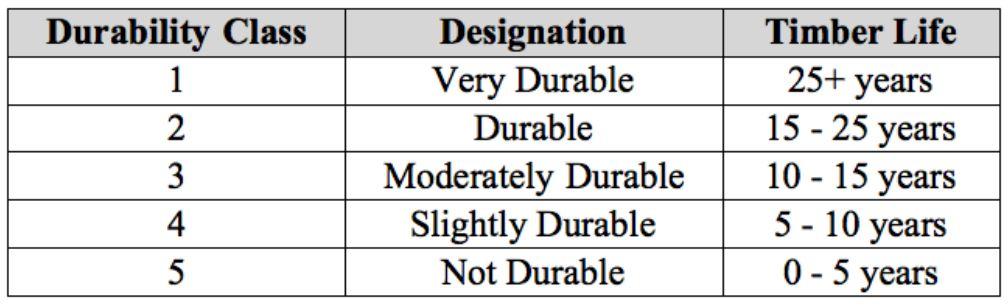

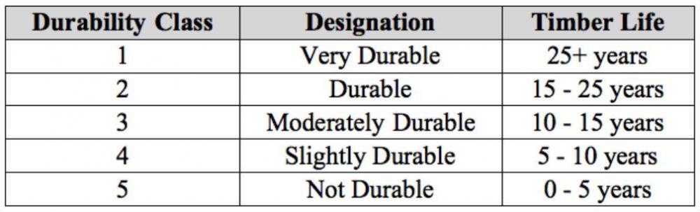

Ian Posted August 10, 2020 Share Posted August 10, 2020 (edited) 9 hours ago, ReX said: For the new bespoke fences, the landscaper I want to use suggests to use oak but many websites talk about Siberian larch What are the main differences? The main difference is durability. The chart below is Trada's guide and is measured using timber posts in contact with the ground. Oak is classified as durable and Siberian larch somewhere between slight & moderate durability. If you keep your fencing at least 150mm off the ground and it's used in an area where its well ventilated it will last a lot longer than indicated in the table. Edited August 10, 2020 by Ian Link to comment Share on other sites More sharing options...
ReX Posted August 10, 2020 Author Share Posted August 10, 2020 1 hour ago, PeterStarck said: I have yet to find a type of timber that doesn't become grey over time. Even the flooring of my balcony which is ipe has slowly become grey although slower than the cedar cladding on the house. Was the cedar untreated? Did it stabilise as in this picture or it changed? By the way I really enjoyed your blog - very informative and cool house! 3 hours ago, nod said: Oak needs a lot of looking after to stop it turning grey How often does it need to be stained? 22 minutes ago, Ian said: The main difference is durability. The chart below is Trada's guide and is measured using timber posts in contact with the ground. Oak is classified as durable and Siberian larch somewhere between slight & moderate durability. If you keep your fencing at least 150mm off the ground and it's used in an area where its well ventilated it will last a lot longer than indicated in the table. Okay, so it seem oak is more durable. Where is redwood in the chart? Which wood would be classified as very durable? Link to comment Share on other sites More sharing options...
Ian Posted August 10, 2020 Share Posted August 10, 2020 3 minutes ago, ReX said: Okay, so it seem oak is more durable. Where is redwood in the chart? Which wood would be classified as very durable? Untreated redwood is classified as 'slightly durable'. The (untreated) timber species classified as very durable are the tropical hardwoods such as Iroko or Teak. An example of an environmentally friendly treated timber which is very durable is Accoya Link to comment Share on other sites More sharing options...

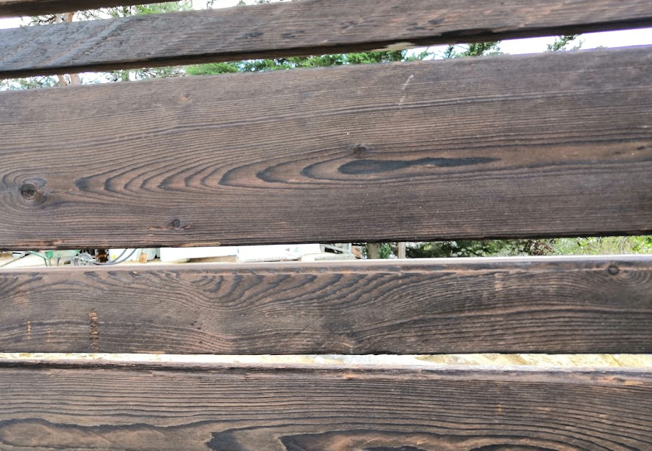

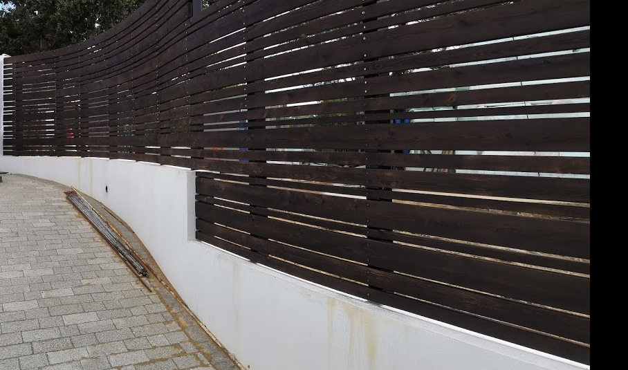

Adam2 Posted August 12, 2020 Share Posted August 12, 2020 My neighbour has been burning the face of his larch to turn it a dark brown - it's looking quite good but does take some time to do. Apparently then it will not go grey. Will dig up a pic Link to comment Share on other sites More sharing options...
ReX Posted August 14, 2020 Author Share Posted August 14, 2020 On 12/08/2020 at 13:13, Adam2 said: My neighbour has been burning the face of his larch to turn it a dark brown - it's looking quite good but does take some time to do. Apparently then it will not go grey. Will dig up a pic Very interested in looking at the result. Is it doable also with redwood? By the way, between redwood and cedar, which one would last longer for fencing? Link to comment Share on other sites More sharing options...

Adam2 Posted August 26, 2020 Share Posted August 26, 2020 On 14/08/2020 at 13:27, ReX said: Very interested in looking at the result. Took a little time but here you go: Link to comment Share on other sites More sharing options...
