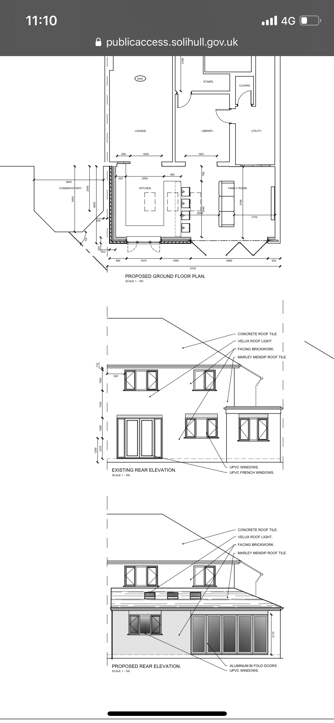

Martin88 Posted August 8, 2020 Posted August 8, 2020 Hi everyone, im new to this page, I’m after some advice.. I’m having a single storey wrap around extension built to the rear of my property, we live a in a semi detached house and the side nearest to my joined neighbour we are having a gable roof. They have a glass conservatory with a solid brick wall to one side (side facing us) - 200mm from the boundary, so based on our council’s planning document the solid wall means the 45 degree rule is taken from there middle point on that conservatory. We are well under this by about a metre and we are not going above 4mtr height. my neighbours daugther (who’s an architect) is getting into my planning officer to firstly try and refuse the extension and secondly try to change the gable to a hip roof so lessen the impact on their conservatory (suspect light and view) my planning officer emailed me yesterday saying he is seriously thinking about making me change the roof design. im trying to challenge this under what grounds as I’m compiling with everything else. Any help is appreciated thanks Martin
Mr Punter Posted August 8, 2020 Posted August 8, 2020 Hi Martin If you post the plans and elevations someone may be able to help. Block out your personal details. Is this being done as Permitted Development or a full planning application?

Mr Punter Posted August 8, 2020 Posted August 8, 2020 The main eave looks to be under 3.0m. If you have to, could you do a dotted line section with the neighbour's connie in the background comparing your proposal to a 6m deep extension 3m high flat roof, which I understand is the max allowable under PD? I can understand why you have applied for this. I agree it will be much nicer to have the vaulted part over the whole kitchen / dining area.
Martin88 Posted August 8, 2020 Author Posted August 8, 2020 The dim to eaves is circa 2385 and the dim to top of gable roof is 3375 eaves dim to above Connie eaves as that’s 2550 so if I have a flat roof, hip or gable it’s going to over shaddow

DevilDamo Posted August 8, 2020 Posted August 8, 2020 Just out of interest, what angle is your proposed roof?

DevilDamo Posted August 9, 2020 Posted August 9, 2020 2 hours ago, Martin88 said: Between 14 / 15 degrees why? Because with a 4m deep extension, it’s usually quite difficult to get a suitable pitch that would come below a first floor window cill. I’ve just drawn it up based on the dimensions shown and the rear angle is more like 13 degrees. Bear in mind your Velux’s will need flashing kits for a pitch lower than 15 degrees. I assume the lean-to roof element on the right (when looking back at the house) will be steeper than that to the rear because the width of that side part is less than 4m but would meet the rear wall at the same height? You also mentioned about if you ended up with a hipped roof on the left, you would need to move your build over. If the hipped roof detail would match that on the right, your left hand wall can remain where it is. To be honest, you could even pull it across closer to that boundary, allow for an eccentrically loaded foundations and introduce a small parapet for the hipped roof to run in to. This is obviously assuming and on the basis the Planning Officer requests a hipped roof over a lean-to/gable.
Martin88 Posted August 9, 2020 Author Posted August 9, 2020 By the time we finished with rafter and eaves we will be at 14 degree’s, we are taking the risk on the 1 degree with the roof lights. yes the right hand side will be 20 degrees ( looking at the house from the rear) I have a roof design already for the whole roof. my point I’m trying to make is why is my planner thinking about making me change the roof design if I comply with all the planning documents from my council. Even if I have a flat, gable or hip, the ridge line will be above their roof.
DevilDamo Posted August 9, 2020 Posted August 9, 2020 (edited) The overbearing impact can come in a variety of forms. A flat roof in my opinion has a more overbearing impact than a pitched roof but a lean-to/gable roof will have more of an overbearing impact than a hipped roof. The fact you’re having to go via formal Planning means you have no option but to comply with Planning policies and design guidance along with taking into account comments from third parties. If the Planning Officer came back requesting a hipped roof and in order to overcome that, would you consider a slight reduction in the depth of the extension from 4m to 3750mm or 3500mm? You may have to agree to reach a compromise. Edited August 9, 2020 by DevilDamo
