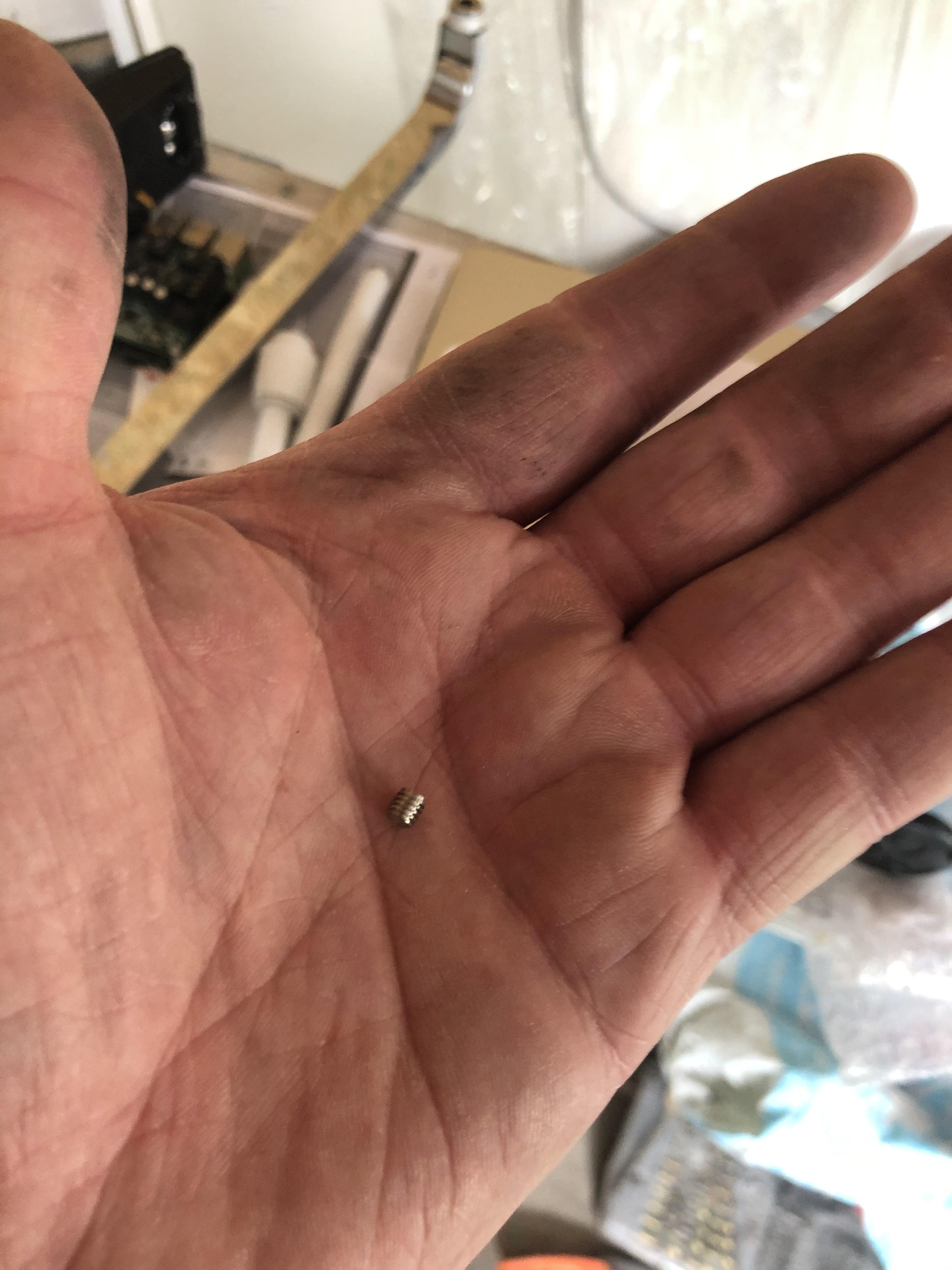

Pocster Posted August 5, 2020 Author Share Posted August 5, 2020 Found it !! then lost it again !! Aargh ! Need to buy a bag of them - bet there isn’t a ‘standard’ size !! Link to comment Share on other sites More sharing options...

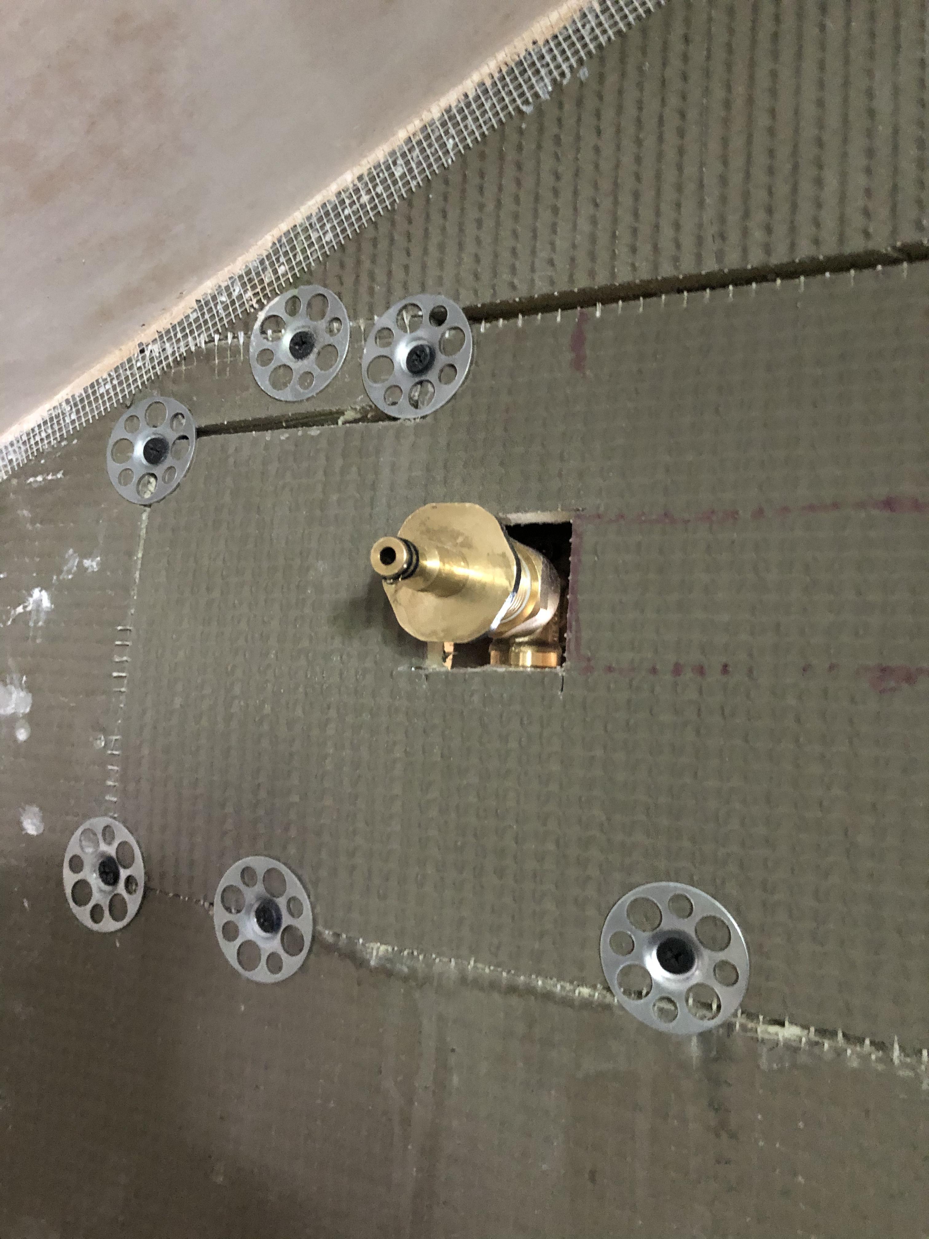

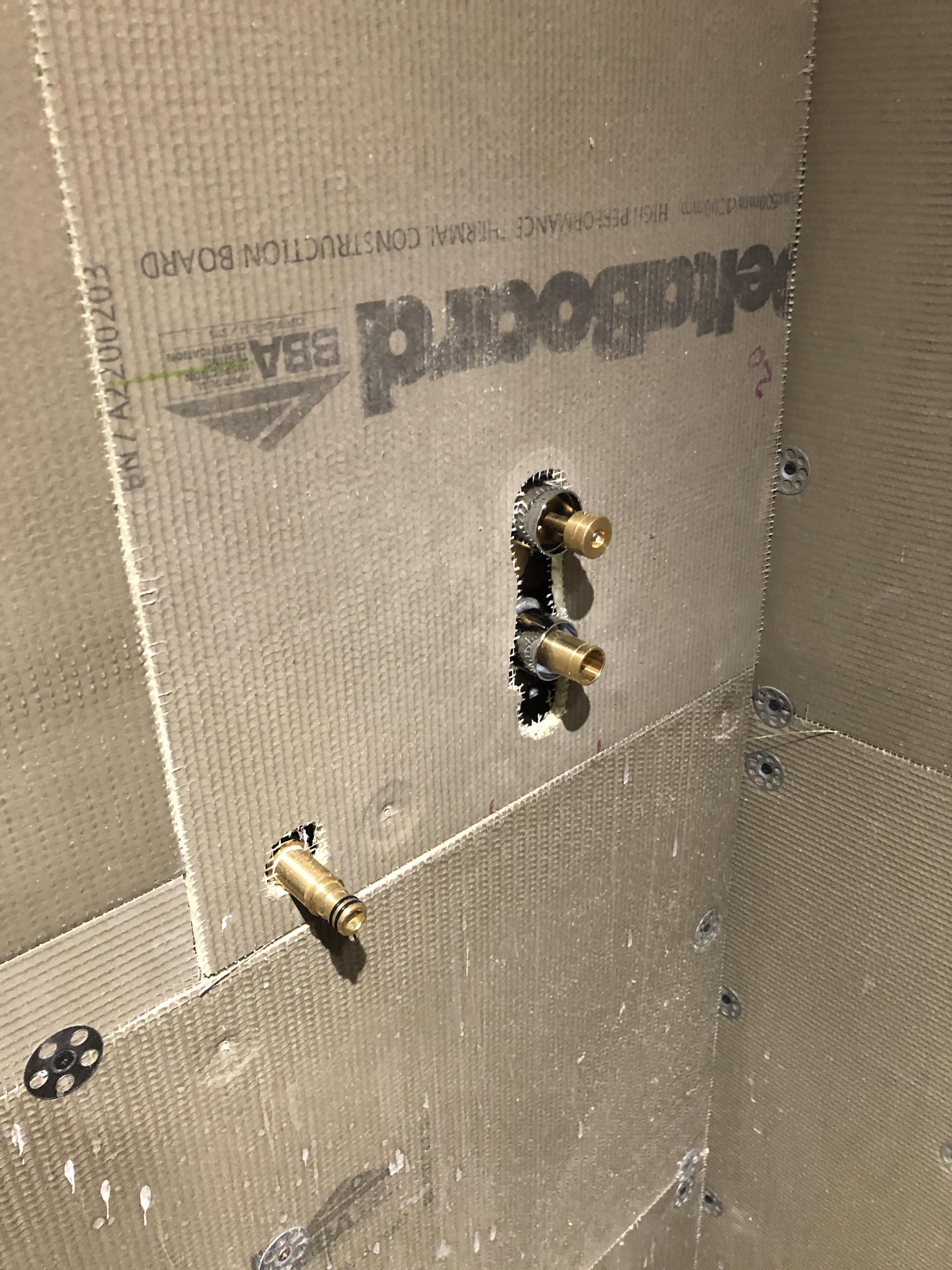

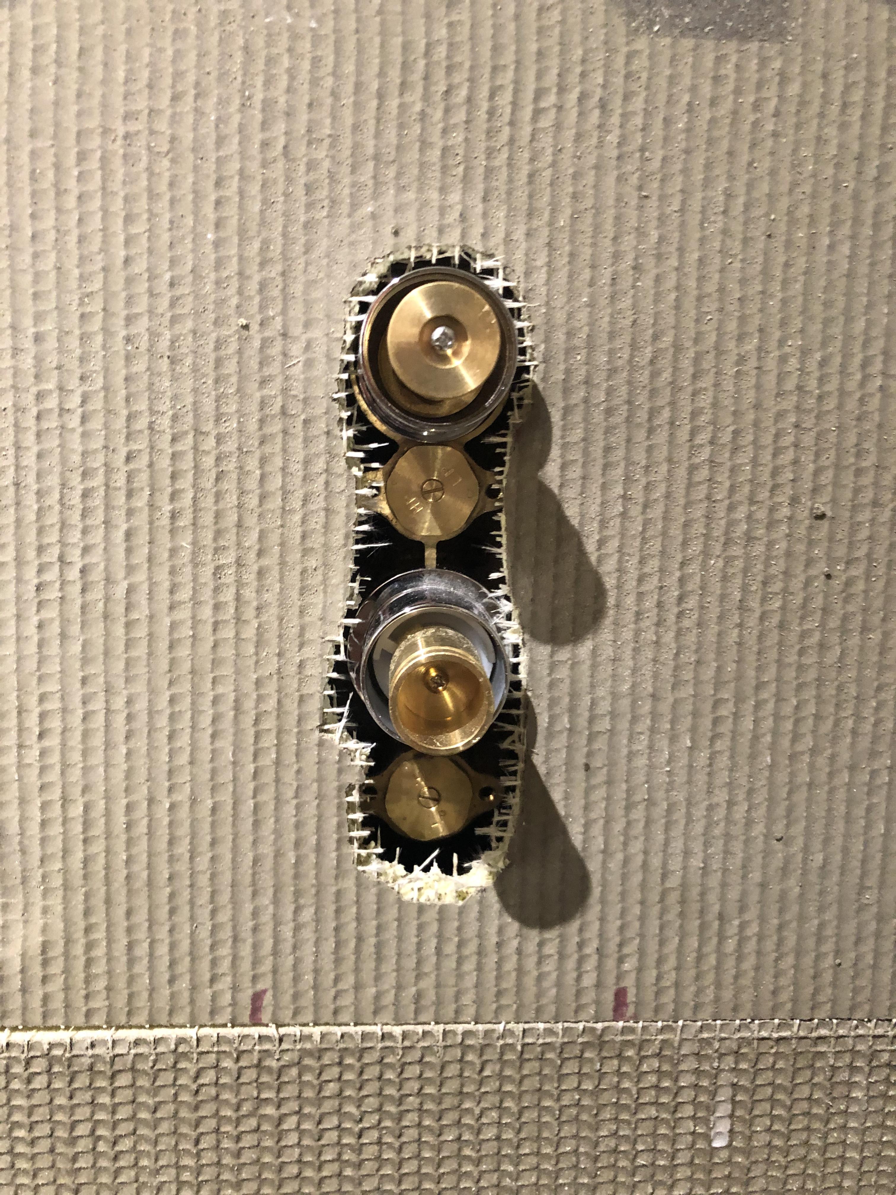

Pocster Posted August 5, 2020 Author Share Posted August 5, 2020 Patched back in the delta board . Presume I should fill around the fitting with something ? - tile adhesive ?? Foam gun ? Link to comment Share on other sites More sharing options...

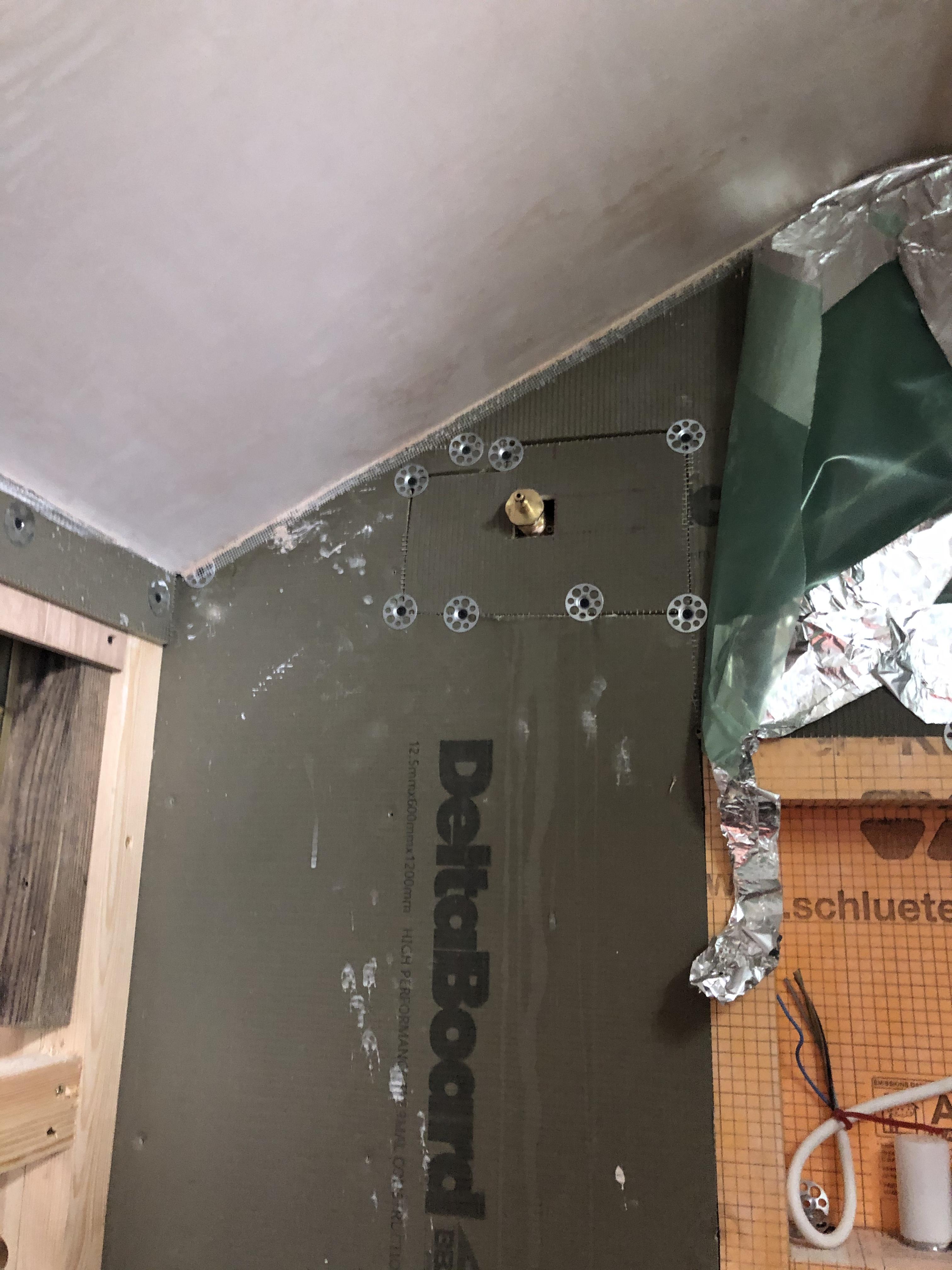

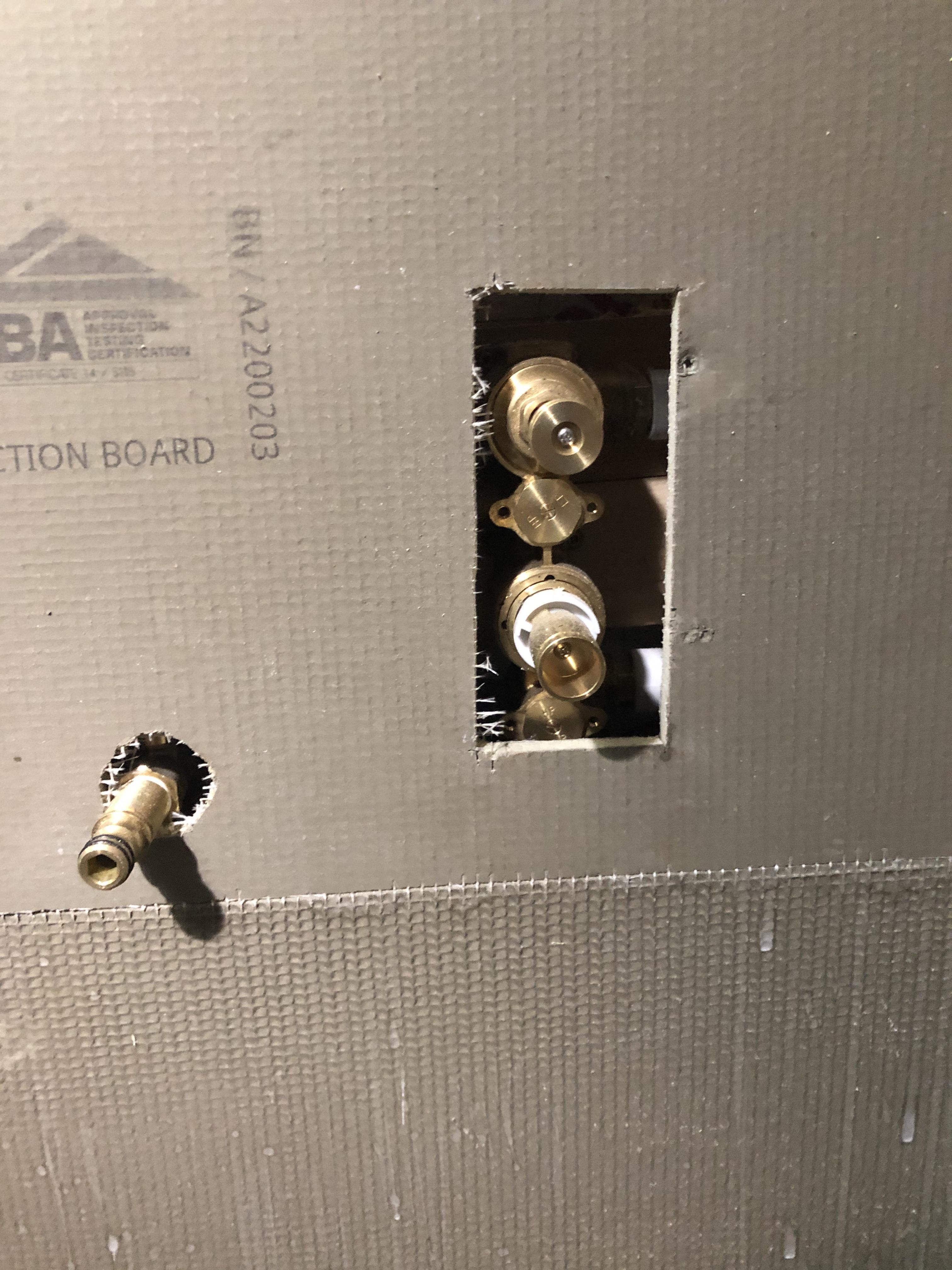

Pocster Posted August 6, 2020 Author Share Posted August 6, 2020 Assume this is enough space around the fixings for access ? . Still don’t like a big hole there ! I know I Mastik around the cover plate but still concerns me .. Link to comment Share on other sites More sharing options...
ProDave Posted August 6, 2020 Share Posted August 6, 2020 The hole in your final wall covering needs to be more accurate The lines drawn show the extent of the cover plate so the access hole for the thermal mixer cartridge could nor be any bigger. Link to comment Share on other sites More sharing options...
Onoff Posted August 6, 2020 Share Posted August 6, 2020 42 minutes ago, pocster said: Still don’t like a big hole Not what I heard... As Dave says. Tile neatly cut. I can get all the necessary tools to dismantle, remove cartridges etc Horseshoe of silicone, open at the bottom: 1 Link to comment Share on other sites More sharing options...
Pocster Posted August 6, 2020 Author Share Posted August 6, 2020 18 minutes ago, ProDave said: The hole in your final wall covering needs to be more accurate The lines drawn show the extent of the cover plate so the access hole for the thermal mixer cartridge could nor be any bigger. Not a problem - so the tile cuts need to be more accurate . The instructions though seem to suggest the opposite.... I don’t want it that access becomes an issue afterwards Link to comment Share on other sites More sharing options...

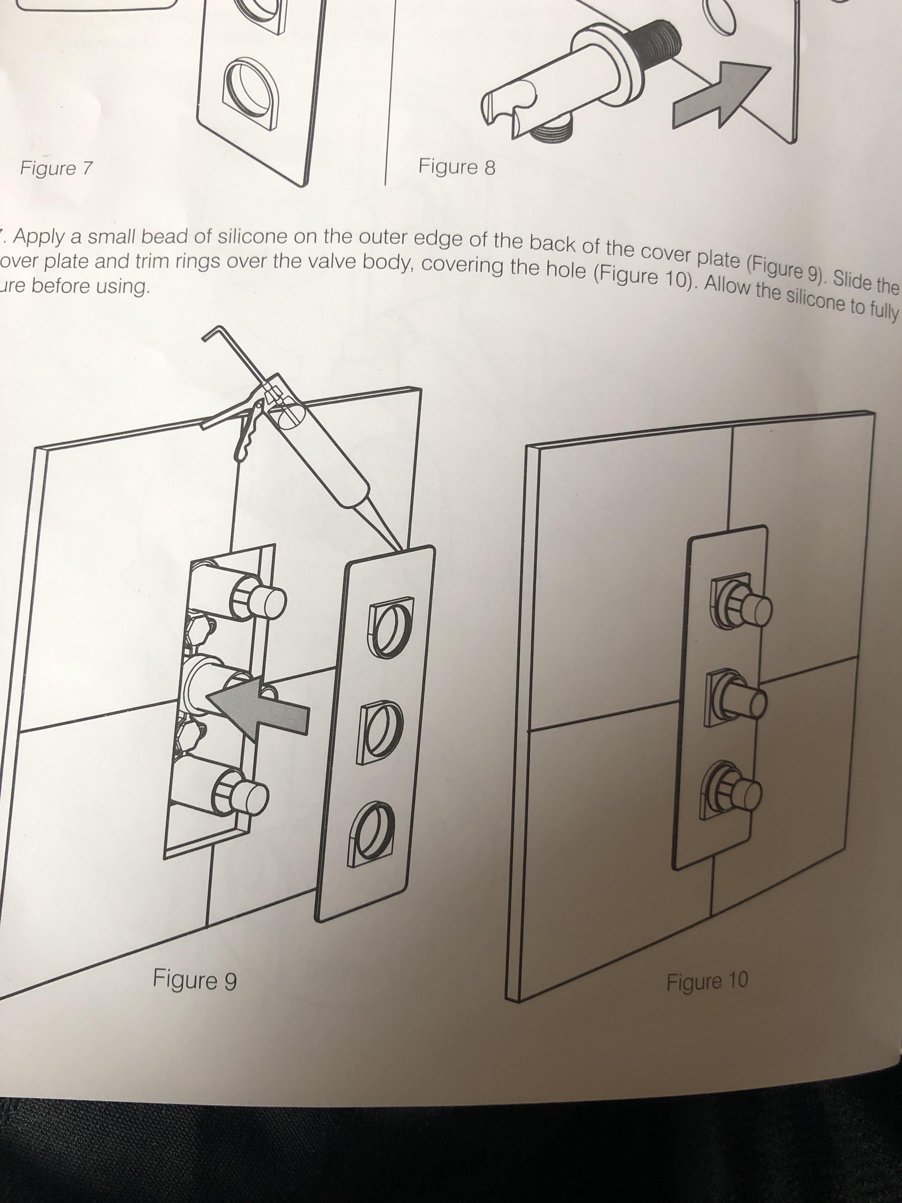

Onoff Posted August 6, 2020 Share Posted August 6, 2020 (edited) Mine and Dave's cover plates are the same make. They're not that wide to cover necessary future access holes hence the accuracy. Besides, cutting sharp internal corners and aren't the tiles more likely to crack? & don't use CT1 to stick the cover plate on unless you don't want to ever get it off again. Use ordinary clear silicone. Edited August 6, 2020 by Onoff Link to comment Share on other sites More sharing options...
Pocster Posted August 6, 2020 Author Share Posted August 6, 2020 Just now, Onoff said: & don't use CT1 to stick the cover plate on unless you don't want to ever get it off again. Use ordinary clear silicone. Ah ! Was going to use ct1 - will make a mental note not to . 6 months later I’ll forget and stick it on with ct1 . 2 years later when I need to remove the plate you can link to this thread . 1 Link to comment Share on other sites More sharing options...
Onoff Posted August 6, 2020 Share Posted August 6, 2020 1 minute ago, pocster said: Ah ! Was going to use ct1 - will make a mental note not to . 6 months later I’ll forget and stick it on with ct1 . 2 years later when I need to remove the plate you can link to this thread . ...just edited my post to add about the cover plate width. Link to comment Share on other sites More sharing options...

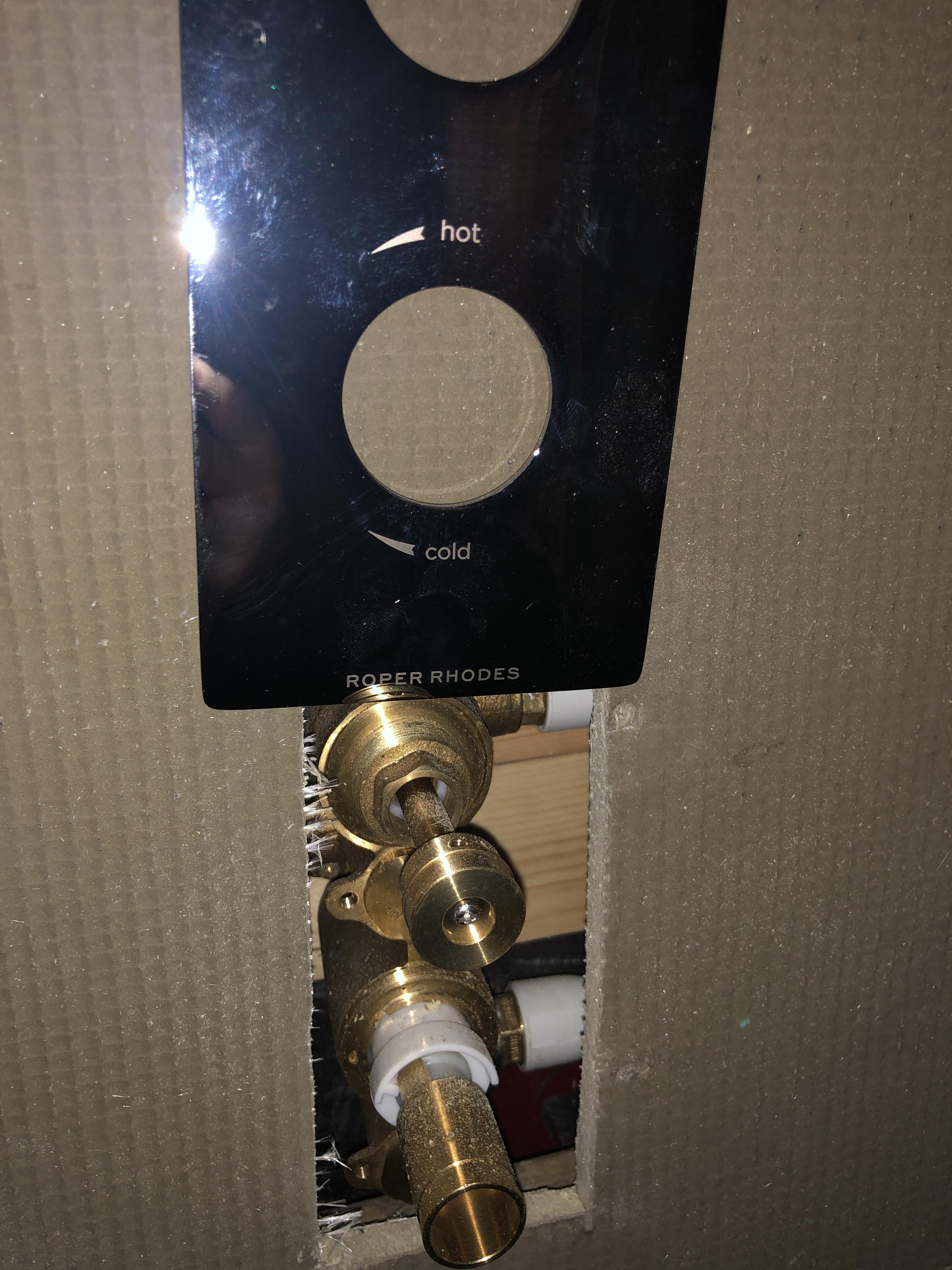

Pocster Posted August 6, 2020 Author Share Posted August 6, 2020 5 minutes ago, Onoff said: Mine and Dave's cover plates are the same make. They're not that wide to cover necessary future access holes hence the accuracy. Besides, cutting sharp internal corners and aren't the tiles more likely to crack? & don't use CT1 to stick the cover plate on unless you don't want to ever get it off again. Use ordinary clear silicone. Fair enough . My plates quite wide ( see photo ) . Though if you think it’s pants - I’ll recut the holes - probably make a template first . I only did it as a ‘crude’ rectangle because the destructions said so . Link to comment Share on other sites More sharing options...

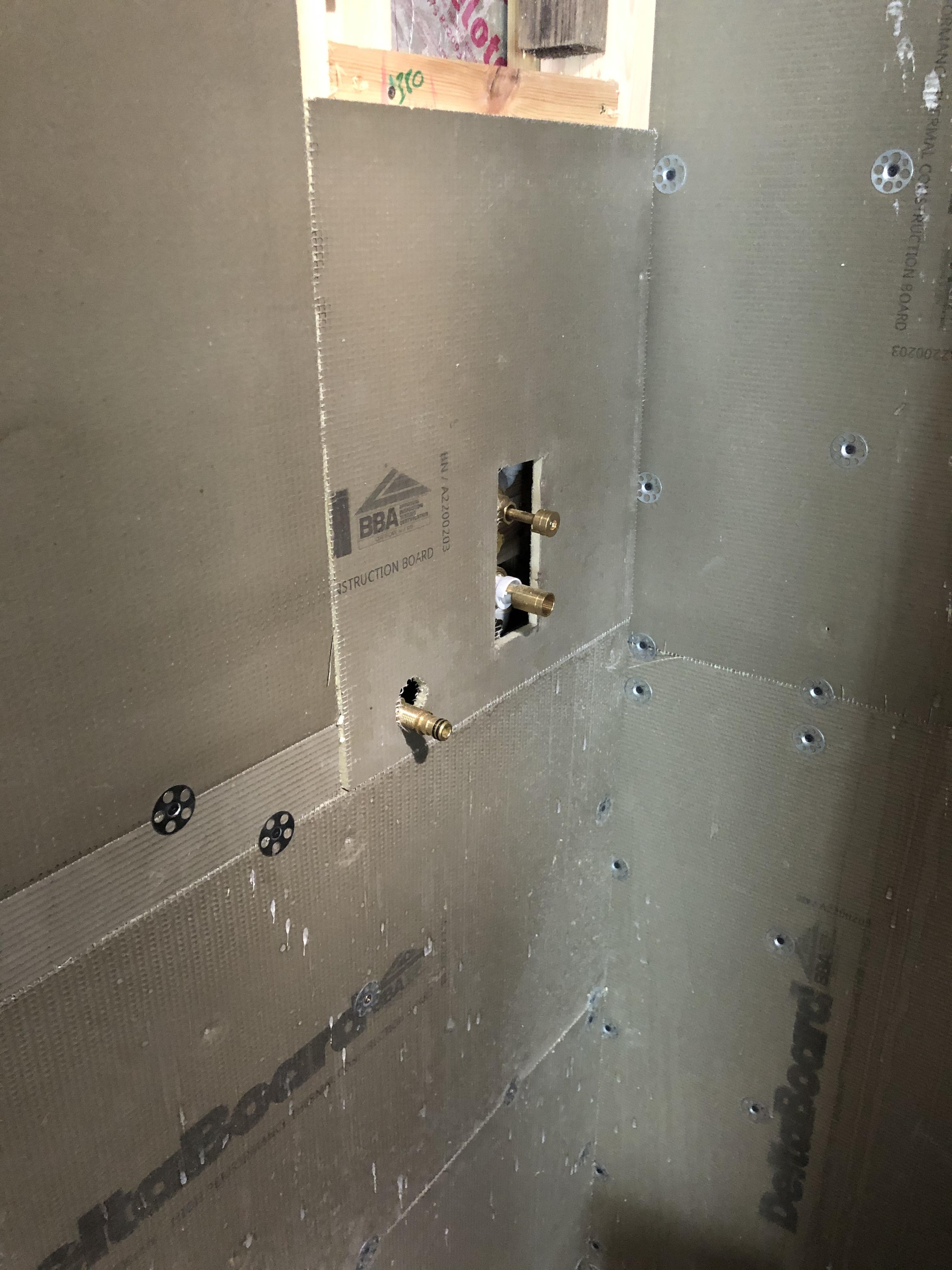

Onoff Posted August 6, 2020 Share Posted August 6, 2020 (edited) 23 minutes ago, pocster said: Fair enough . My plates quite wide ( see photo ) . Though if you think it’s pants - I’ll recut the holes - probably make a template first . I only did it as a ‘crude’ rectangle because the destructions said so . I'm thinking rather than take your boards off just cut to fit and stick on a bit of tanking membrane. There's a pick somewhere of one @Nickfromwales did. Edit: Found it! Edited August 6, 2020 by Onoff 1 Link to comment Share on other sites More sharing options...
Pocster Posted August 6, 2020 Author Share Posted August 6, 2020 8 minutes ago, Onoff said: I'm thinking rather than take your boards off just cut to fit and stick on a bit of tanking membrane. There's a pick somewhere of one @Nickfromwales did. Edit: Found it! Could do . But I’ll do it properly so everyone thinks I’m skilled !! 1 Link to comment Share on other sites More sharing options...
Onoff Posted August 6, 2020 Share Posted August 6, 2020 8 minutes ago, pocster said: Could do . But I’ll do it properly so everyone thinks I’m skilled !! I bought a set of the cheapo diamond grit edged holesaws then a couple slightly bigger. Made a template that the tile dropped into then used that to cut the tile. Fill with water & drill: Cheap ceramics but the cut is perfect: Link to comment Share on other sites More sharing options...
Pocster Posted August 7, 2020 Author Share Posted August 7, 2020 Bit tight with the 135 ‘s but I’m guessing we’re all happier with that arrangement? Link to comment Share on other sites More sharing options...
Pocster Posted August 7, 2020 Author Share Posted August 7, 2020 (edited) Cut a new board . Think I would have access to everything Edited August 7, 2020 by pocster Link to comment Share on other sites More sharing options...
Onoff Posted August 7, 2020 Share Posted August 7, 2020 40 minutes ago, pocster said: Cut a new board . Think I would have access to everything As long as the biggest box / socket required will fit later on. Think this is 46mm (more commonly use on Land Rovers I believe). 1 Link to comment Share on other sites More sharing options...
