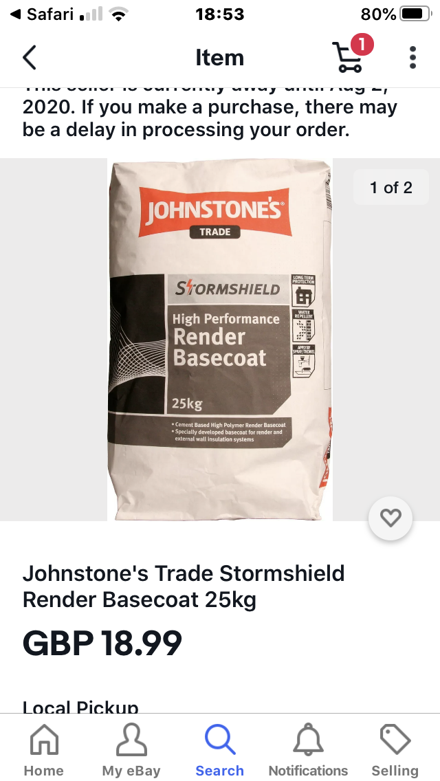

LA3222 Posted July 31, 2020 Share Posted July 31, 2020 The render bloke I went with used Johnstones stormshield - said he used to use K Rend but Johnstones is better ?♂️ Much of a muchness really, ask ten different people and you'll probably get ten different answers. KRend seems to be the 'known' brand associated with render. I had the Johnstones rep on site via the renderer but he then told me that the renderers work is good and johnstones warranty it once done - whether that means anything in practical terms I dunno. My house likewise pinches the 'look' of borderoak to a certain extent - my borderoak porches actually turn up next Friday ? Link to comment Share on other sites More sharing options...
nod Posted July 31, 2020 Share Posted July 31, 2020 I’ve never come across Johnston K are the market leader by far I’ve used K on a weekly basis for over 20 years Cem rend before that The thing most like is batch matches are good There are loads of renders that guarantee no cracking Like most guarantees the onus is on the installer So pick a good one that will quickly sort out any minor problems We Give a five year no argument Guarantee Link to comment Share on other sites More sharing options...
dpmiller Posted July 31, 2020 Share Posted July 31, 2020 Never heard of Johnstone's @nod ? https://www.johnstonestrade.com/specifiers/render Link to comment Share on other sites More sharing options...
nod Posted July 31, 2020 Share Posted July 31, 2020 1 hour ago, dpmiller said: Never heard of Johnstone's @nod ? https://www.johnstonestrade.com/specifiers/render 1 hour ago, dpmiller said: Never heard of Johnstone's @nod ? https://www.johnstonestrade.com/specifiers/render Did I really say I’ve never heard of Johnson’s ? Link to comment Share on other sites More sharing options...
nod Posted July 31, 2020 Share Posted July 31, 2020 I think the price would dictate why I’m never asked to price site work at double what I pay for K Link to comment Share on other sites More sharing options...
