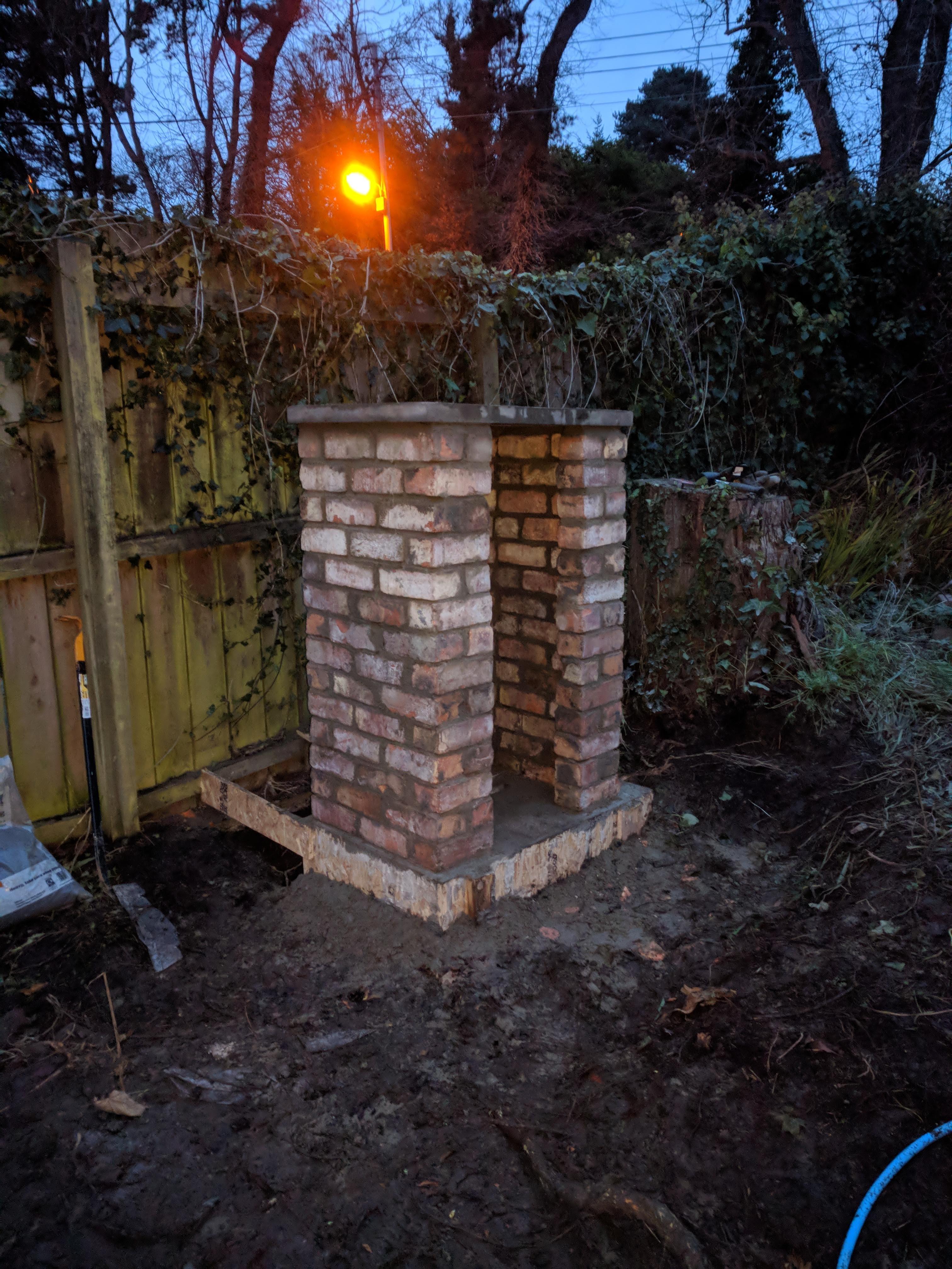

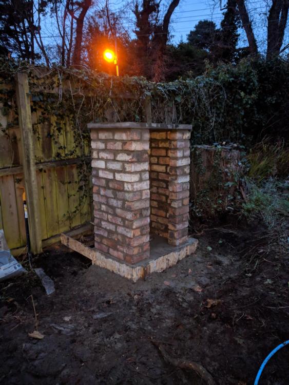

Conor Posted July 27, 2020 Posted July 27, 2020 (edited) Our supplier specified a weatherproof kiosk to specific dimensions along with a easy sweep conduit up through the base for their cable. They also specify the supply must be fused and can only use 16a outlets. All DNOs have different requirements. If you don't meet their spec, they may not install your meter- as happened in our case as we had a standard 13a socket alongside the two 16a. As I was demolishing a brick house, this cost about £30 to build. Others here have got away with fitting a standard meter box to a boundary wall and even fence. Edited July 27, 2020 by Conor 1
Randomusername Posted July 28, 2020 Author Posted July 28, 2020 @Conor that looks a lot like the barbecue my father never quite got round to properly building! I’ve seen some specs for a temporary brick cabinet somewhere but can’t find them now... I do however remember it being required to be massively over engineered - framed ledged braced doors, 1950s Cold War fallout bunker cast concrete roof etc! Anyway I’ve contacted Western Power and they are going to contact me about the process so that’s good.

Mr Blobby Posted May 18, 2022 Posted May 18, 2022 On 27/07/2020 at 15:47, Conor said: Our supplier specified a weatherproof kiosk to specific dimensions along with a easy sweep conduit up through the base for their cable. They also specify the supply must be fused and can only use 16a outlets. All DNOs have different requirements. If you don't meet their spec, they may not install your meter- as happened in our case as we had a standard 13a socket alongside the two 16a. As I was demolishing a brick house, this cost about £30 to build. Others here have got away with fitting a standard meter box to a boundary wall and even fence. So did you put a permali box inside the "barbecue" or just a board at the back. And doors on the front I take it? I'm jumping through the NIE brick-enclosure-only hoop this week. NIE are such a nightmare compared to GB DNO's 😕
Conor Posted May 19, 2022 Posted May 19, 2022 (edited) Just a backboard. And a very crude door! Make sure your spark leave meter tails and fits the right type of breaker and the 16a commando sockets only. We had ours refused for having a 13a socket wired up. Edited May 19, 2022 by Conor

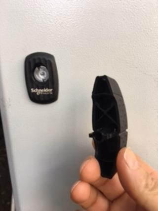

markharro Posted June 17, 2022 Posted June 17, 2022 Hi I am getting 3phase put in shortly. I have had our electrician fit a box to accept it on a shed wall. The plan is to wire up our outbuildings' supply to it during the build and then take the new 3phase into the house from the same box. I thought I had read somewhere that the box had to be locking ie come with a key or have some option to use a padlock but the box fitted has neither. Is that an issue (in Scotland)? thanks

markharro Posted June 21, 2022 Posted June 21, 2022 I am getting a new 3phase supplied installed in a couple of weeks. The cable is going into a box that my electrician has mounted on my shed wall. I am getting the meter put in this box and ultimately the feed to the new house when it is up. The box (Schneider) does not have a lockable handle which surprised me. I thought I read somewhere that it needed to be lockable? I am in Scotland if that is relevant.
AliG Posted June 21, 2022 Posted June 21, 2022 Does it not have a quarter turn type lock? If it doesn't and they insist on one, you could just buy one and drill a hole for it. https://www.amazon.co.uk/sourcing-map-Triangle-Cylinder-Thickness/dp/B07BPWPM5C/ref=sr_1_28?crid=LZKDVJ91GIQ&keywords=triangle+lock&qid=1655830032&sprefix=triangle+lock%2Caps%2C92&sr=8-28
markharro Posted June 22, 2022 Posted June 22, 2022 Thanks @alig that's a good suggestion. However on closer inspection it turns out I dont have a problem after all ... the plastic twist handle actually comes off so essentially is the "key". Photos make it clear I think... 1
