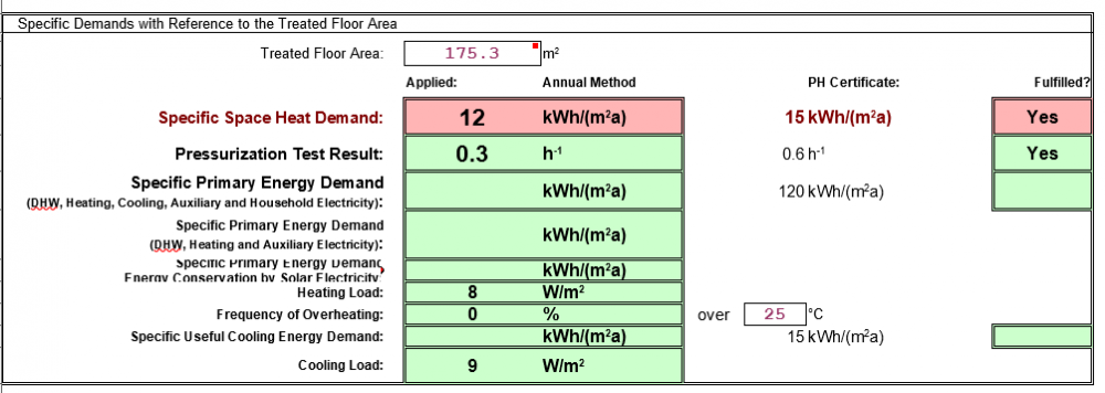

pdf27 Posted September 2, 2021 Author Posted September 2, 2021 Bumping this as we've just got the PHPP model back for a design nearly ready to go to planning, and cavity wall is looking a lot better than we thought it would. We're planning on a brick outer skin no matter what build system we use (cost + blending in with the rest of the village), and PHPP says that 200mm of Dritherm 32 plus aerated concrete inner blocks and a brick outer leaf is good enough to hit the targets since we've got a very good form factor (~0.15 W/m2K gets us to Passivhaus - the form factor is 2.4 which is one of the best the architects have seen for a Passivhaus). That starts to get interesting as any timber frame system with a brick outer leaf rather than slips is looking like >500mm rather than ~400mm. Airtightness is a significant concern if we go down this route because unlike the timber frames where there are a large number of companies with a track record of delivering a package which meets the airtightness requirements. A 200mm cavity is actually pretty close to a conventional build (150mm), so if there is a builder-friendly way of putting the airtightness barrier inside the cavity that would make getting good airtightness with non-Passivhaus focussed builders a lot easier since we'd only have to control penetrations and roof/window/door junctions. I'm aware of the use of painted on liquid membranes, and our architects have been playing around with some peel-and-stick membranes intended for this sort of application (probably something like this), as well of the use of a parge coat/wet plaster on the inside for airtightness which I'd prefer to avoid. Is anybody aware of any alternative solutions to achieve the same thing?

pdf27 Posted September 2, 2021 Author Posted September 2, 2021 Will have a think - initial assumption was MBC or similar timber frame would be required and that cavity wall would be bunker-like. With the design evolving and the realisation that render boards are much more expensive than we thought, we've ended up with a brick outer skin and cavity wall is back on the table, so I'm only just starting to think through some of the issues. Insulation values are being driven by comfort rather than energy cost - the alternative Passivhaus criteria of 10 W/m2 is essentially a comfort one (drafts and cold internal surfaces translate into feeling cold), that ends up with a low energy cost as a side effect, but that isn't the primary driver. This leaves us a heating load of 1.8kW and cooling load of 650W if we don't open windows at night - so essentially representing a heat wave. Similarly, in addition to comfort airtightness is associated with moisture movement within the structure and thus in the long term to durability, so it makes sense to minimise it. It doesn't force us to go Passivhaus - indeed we are explicitly not committed to it - but it's a decent quality control system and I suspect the majority of people with the skills we're after will be in the ecosystem in some way. Because cooling is a hard requirement for us (my wife is from the US) we're essentially tied in to a heat pump solution - this means heat is very cheap, so we're unlikely to be at the most cost-effective point, but since we aren't trying to go for maximum value-engineering this is acceptable to us. As it happens, the form factor helps us a lot - the cavity wall option has 200mm of Dritherm 32, 150mm PIR under the floor and 350mm cellulose in the pitched roof which gets us to 8.6 W/m2. Since we want a heat pump and a fair bit of PV, we have a strong suspicion that we'll end up hitting Passivhaus Plus without much if any effort so may end up doing that. If we want to reduce heating demand, it's pretty clear that thicker cavity insulation is the best place to go - which happens to be relatively cheap, so means we've got a decent ability to tweak the performance if required. If we do adopt the two layer approach then it's worth noting that the inner layer **is** accessible and so can be tested and fixed, and that the starting point for finding any leaks is inherently going to be lower than for a single layer as the majority of leaks going through one layer will be stopped by the other. I'd agree that the testing requirement makes a single layer in the cavity very difficult to test however, at least for a 100mm inner wall which can't be built up unsupported. The concerns in relying on a single inner layer are that it requires quite a lot of detail work around any wiring chases, etc. and that it is accessible and hence vulnerable to degradation over the lifetime of the house. It is also potentially quite a slow and thus expensive process to chase down leaks - as I won't be doing it myself that's a significant concern. In either case a track record in high performance building will be required - it's possible we may end up choosing the build system based on what the selected builders have experience with.
