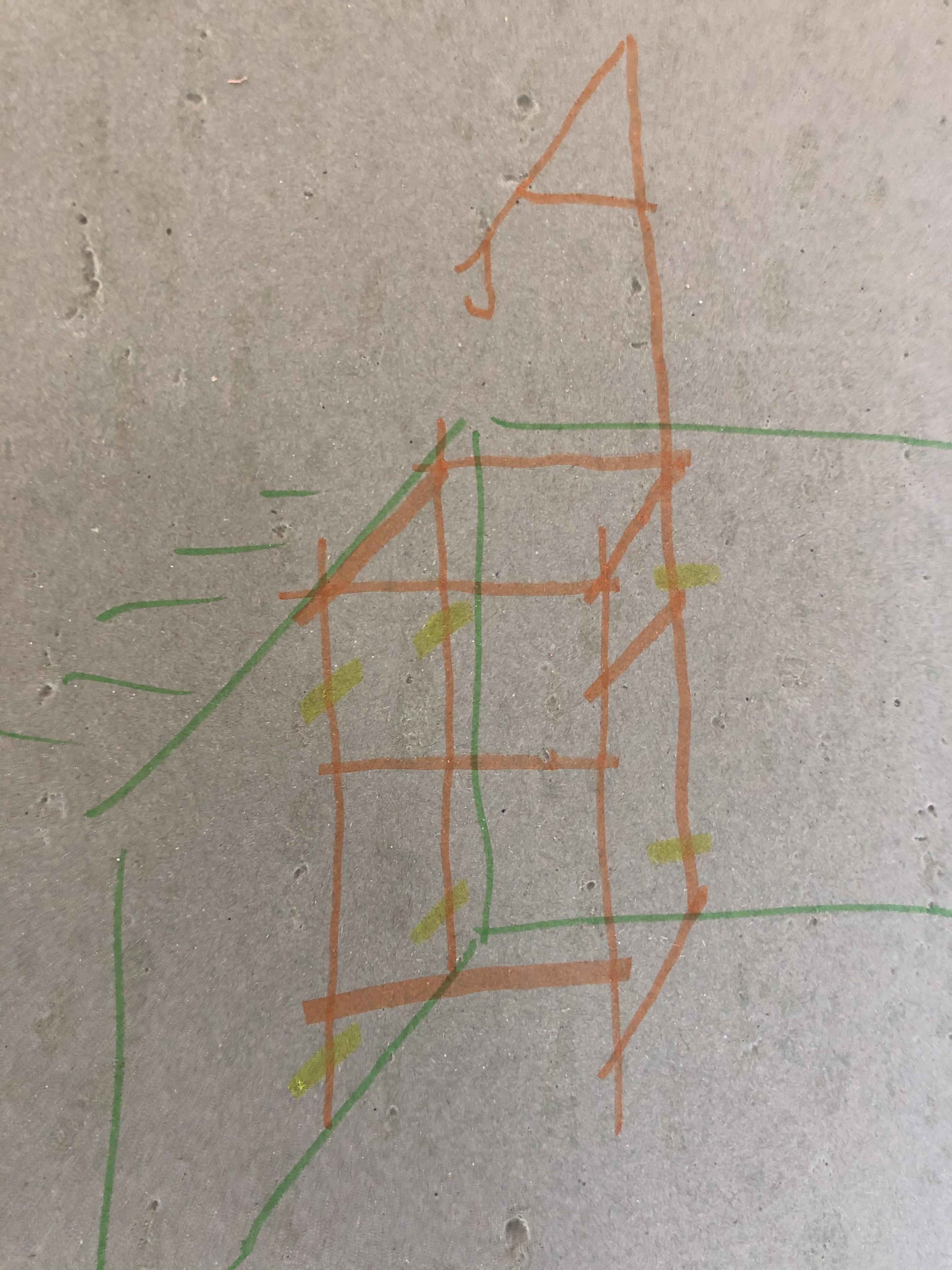

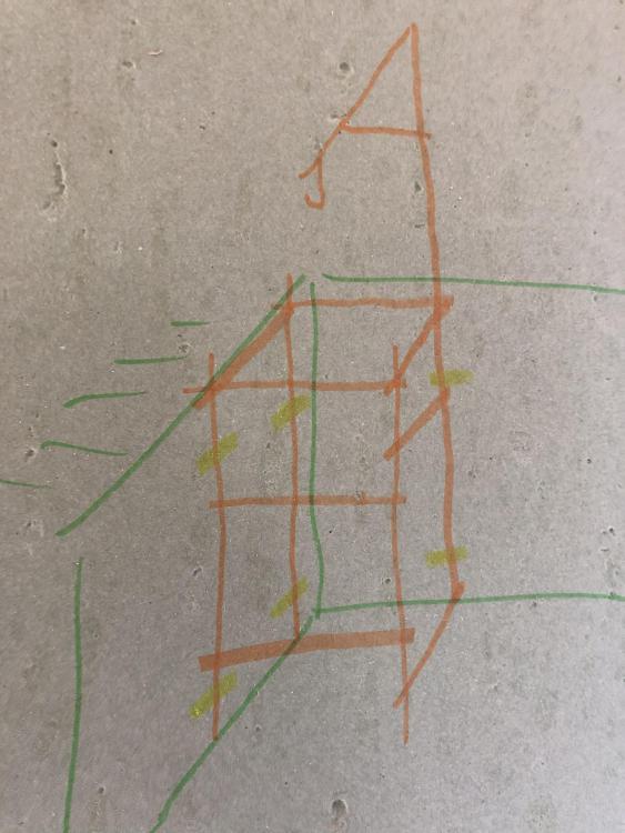

Pocster Posted July 31, 2020 Author Posted July 31, 2020 Right ! Dithering on this ! Had some quotes - but I think I need to simplify . So ! green is the concrete wall - 3 uprights can be bolted to that orange Scaff yellow showing verticals bolted to wall This means I can lay Scaf boards across the top part as a platform so loading is easier . Winch load up a few inches - remove Scaf boards then lower down . So - wooden pallet as lift floor ( would prefer something made of metal to be honest ) . Sling straps from that to a ‘spreader’ then straps to winch

JFDIY Posted July 31, 2020 Posted July 31, 2020 Is the jib going to swing? If not, take two opposite poles higher and have a scaffold pole across the two to share the load, I'd choose the ones bolted to wall. In fact you could take three vertical poles higher then use a ratchet strap as a 'handrail/'edge protection for when you're loading

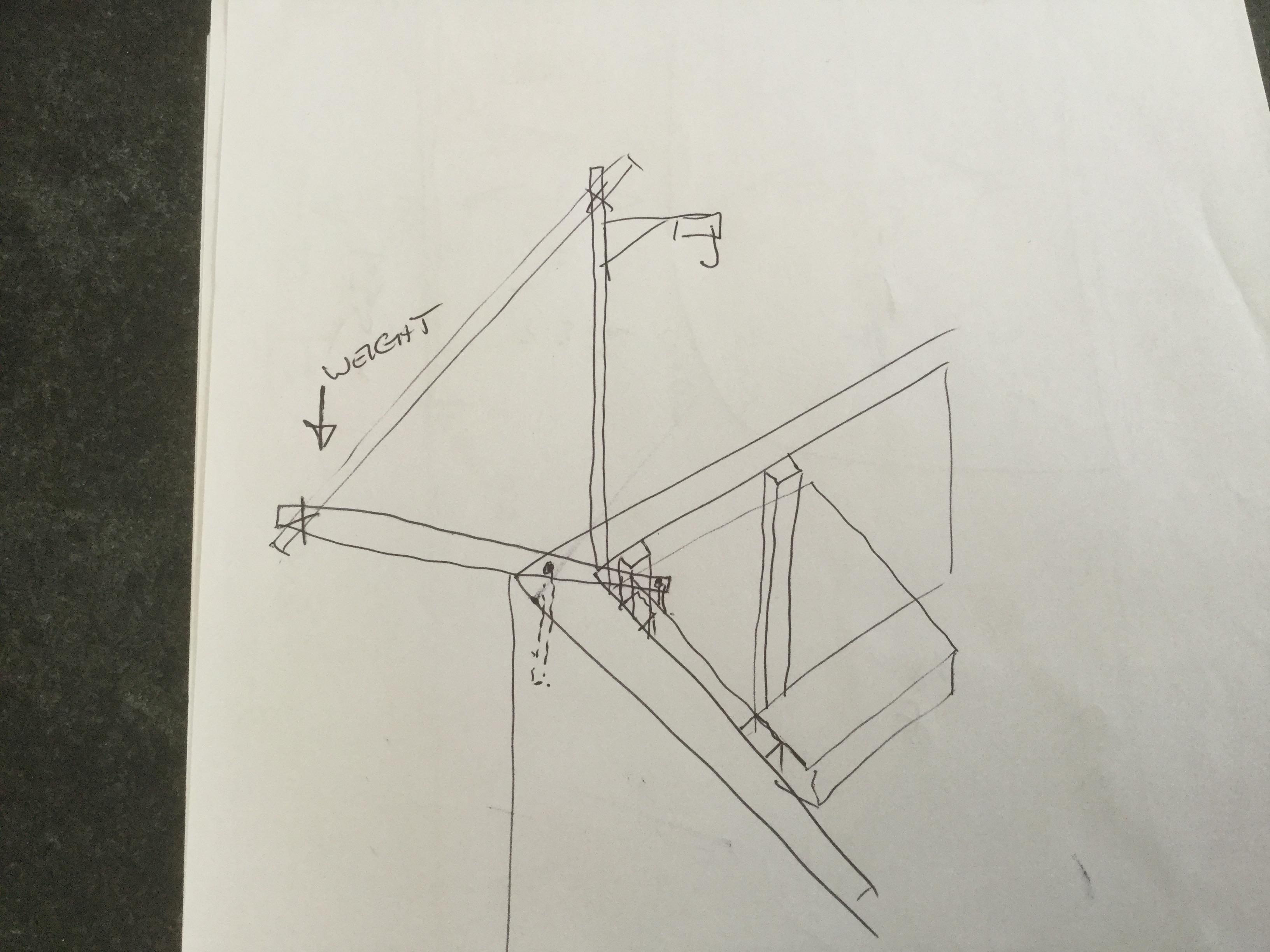

joe90 Posted July 31, 2020 Posted July 31, 2020 (edited) I still like my original idea, vertical pole in the corner so can’t go anywhere (side to side), bottom of pole pushing into the corner so no need to fix, horizontal pole fixed to vertical pole but overhanging pallet by 200mm with a bolt fixed to end of pole and hole in pallet to stop it swinging when level with the ground. Horizontal pole bolted down into wall or straps behind wall to stop vertical pole pulling away from wall. pallet slides up and down timber fixed to wall, counter balance weight at end of horizontal pole, it can be loaded and unloaded without swinging. Fixed to winch with straps/cable and spreader bars above height of tallest load you wish to carry. main advantage of my design is less critical fixings, only the bolt into the wall or straps behind wall are taking any load. Edited July 31, 2020 by joe90
Pocster Posted July 31, 2020 Author Posted July 31, 2020 46 minutes ago, JFDIY said: Is the jib going to swing? If not, take two opposite poles higher and have a scaffold pole across the two to share the load, I'd choose the ones bolted to wall. In fact you could take three vertical poles higher then use a ratchet strap as a 'handrail/'edge protection for when you're loading No swing . My poor drawing should show the winch hook central . So yes I could just bolt a Scaf pole horizontal between 2 corner poles .
Pocster Posted July 31, 2020 Author Posted July 31, 2020 1 hour ago, joe90 said: I still like my original idea, vertical pole in the corner so can’t go anywhere (side to side), bottom of pole pushing into the corner so no need to fix, horizontal pole fixed to vertical pole but overhanging pallet by 200mm with a bolt fixed to end of pole and hole in pallet to stop it swinging when level with the ground. Horizontal pole bolted down into wall or straps behind wall to stop vertical pole pulling away from wall. pallet slides up and down timber fixed to wall, counter balance weight at end of horizontal pole, it can be loaded and unloaded without swinging. Fixed to winch with straps/cable and spreader bars above height of tallest load you wish to carry. main advantage of my design is less critical fixings, only the bolt into the wall or straps behind wall are taking any load. You should of learn't by now that you have written too many words!. A scribble drawing would be appreciated assuming this is a different design to your other drawing? I'm getting scaffolding overload!

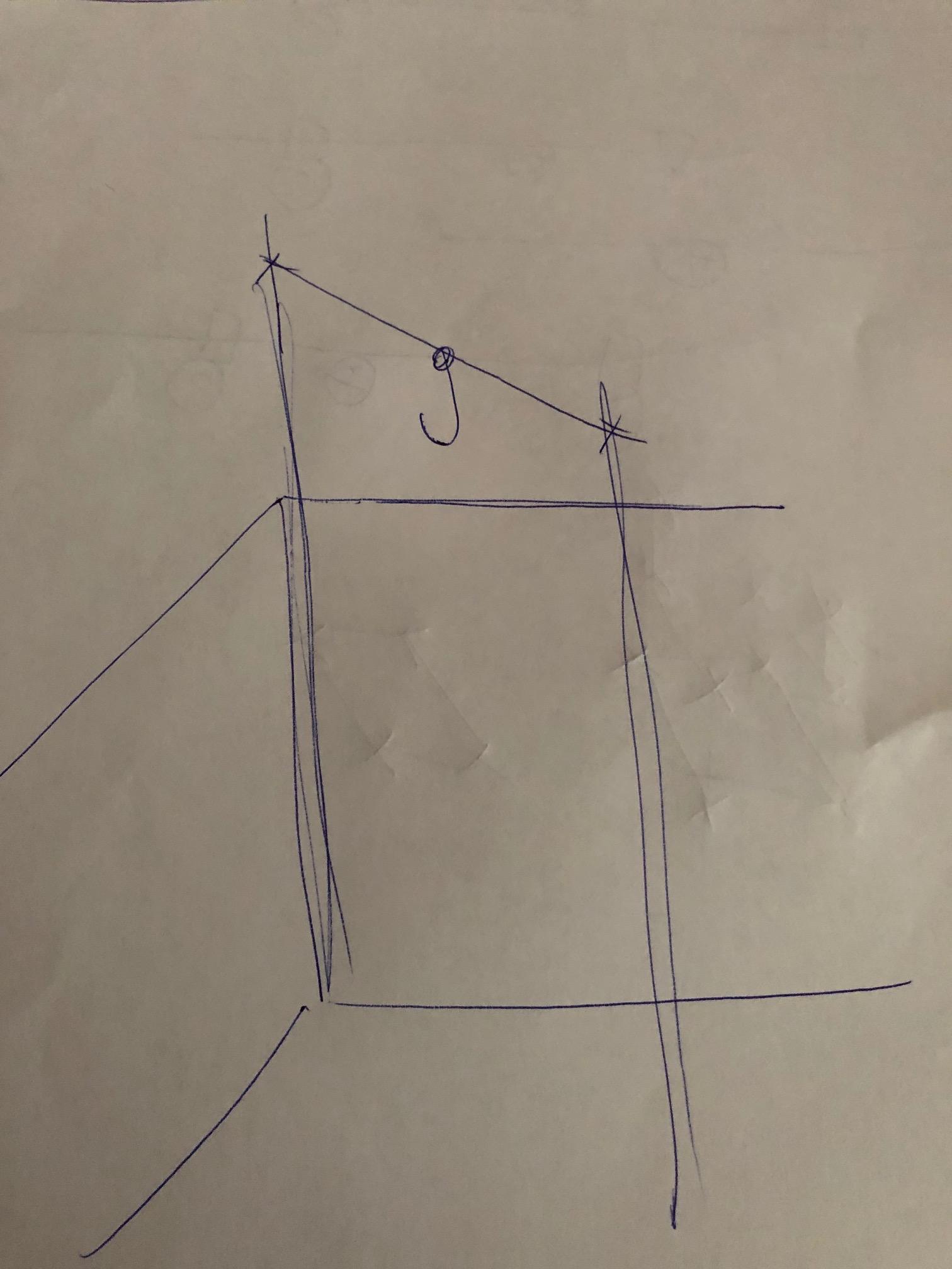

Pocster Posted July 31, 2020 Author Posted July 31, 2020 Right!. I need to get this going! The spreader is just 4 scaf poles all linked together with clamps to form a square What is to stop the straps connected from the floor 'slipping' over the spreader i.e. what keeps them in place? Use a wooden pallet for lift floor *for now* So! ( hate scaf websites; all in feet and inches!) 2 x 19ft vertical poles ( these are effectively the supports for the gantry) i.e. corner to opposing corner 2 x 9ft vertical ; these are the other corners 13 x 5ft ; so 4 for bottom brace, 4 for 'floor' level brace , 4 for 'spreader' , 1 to go between the 19ft poles i.e. the gantry Pole to pole standard fixings x 8 - is this a drop forged double coupler? HELP HERE 'clamp' fixings as against wall x 6 - is this a drop forged putlog coupler? HELP HERE swivel coupler x1 for corner to corner gantry fitting? HELP HERE I'm going to try https://www.generationscaffolding.com/en-gb/ as they have a local branch to me so assume delivery will be cheaper ... Need some help on what fixings/couplers I need; to bolt this all together. Input required before I push the "Launch nuclear warhead" button i.e. purchase!
joe90 Posted July 31, 2020 Posted July 31, 2020 Sorry @pocster forgot my PAD (pen assisted drawing) 1
Pocster Posted July 31, 2020 Author Posted July 31, 2020 Just now, joe90 said: Sorry @pocster forgot my PAD (pen assisted drawing) I did think that type of arrangement is what you meant. But I'm more comfortable ( i.e. less chance of my death ) with 4 corner posts I can then stick scaf boards across as a 'loading' platform. Also I'm unhappy ( not as in sad, I've drunk some wine now ) with the counter leaver weight. A corner to opposing corner vertical with a horizontal gantry across means the weight of the lift load is central so doesn't need a counter balance ( if I'm wrong I'll die proving you were right )! 1
joe90 Posted July 31, 2020 Posted July 31, 2020 (edited) My old Dad always said “there is no such thing as right or wrong, only opinion!” Go with what your comfortable with ( I will visit you in hospital with grapes) ? Edited July 31, 2020 by joe90 1
Pocster Posted July 31, 2020 Author Posted July 31, 2020 (edited) 4 minutes ago, pocster said: I did think that type of arrangement is what you meant. But I'm more comfortable ( i.e. less chance of my death ) with 4 corner posts I can then stick scaf boards across as a 'loading' platform. Also I'm unhappy ( not as in sad, I've drunk some wine now ) with the counter leaver weight. A corner to opposing corner vertical with a horizontal gantry across means the weight of the lift load is central so doesn't need a counter balance ( if I'm wrong I'll die proving you were right )! So @joe90 using PAAI (pocsters Advance Artificial Intelligence ). this arrangement feels better .. ( doesn't mean it is better; just feels better ! ) Edited July 31, 2020 by pocster (expletive deleted)ing speel check

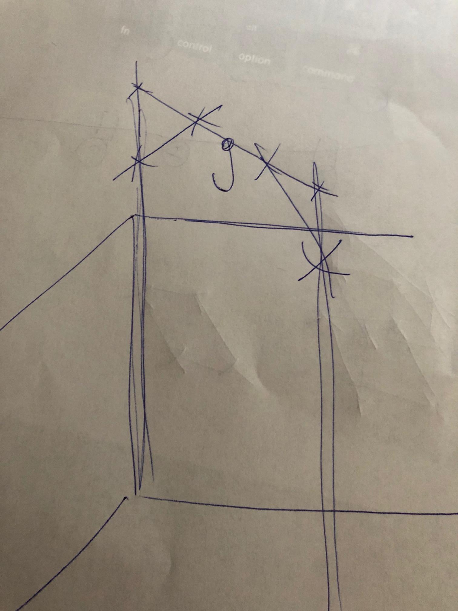

Pocster Posted July 31, 2020 Author Posted July 31, 2020 2 minutes ago, pocster said: So @joe90 using PAAI (pocsters Advance Artificial Intelligence ). this arrangement feels better .. ( doesn't mean it is better; just feels better ! ) Though..... Should I brace these? i.e. ... ( more wine please ; reality is slipping back in !)
