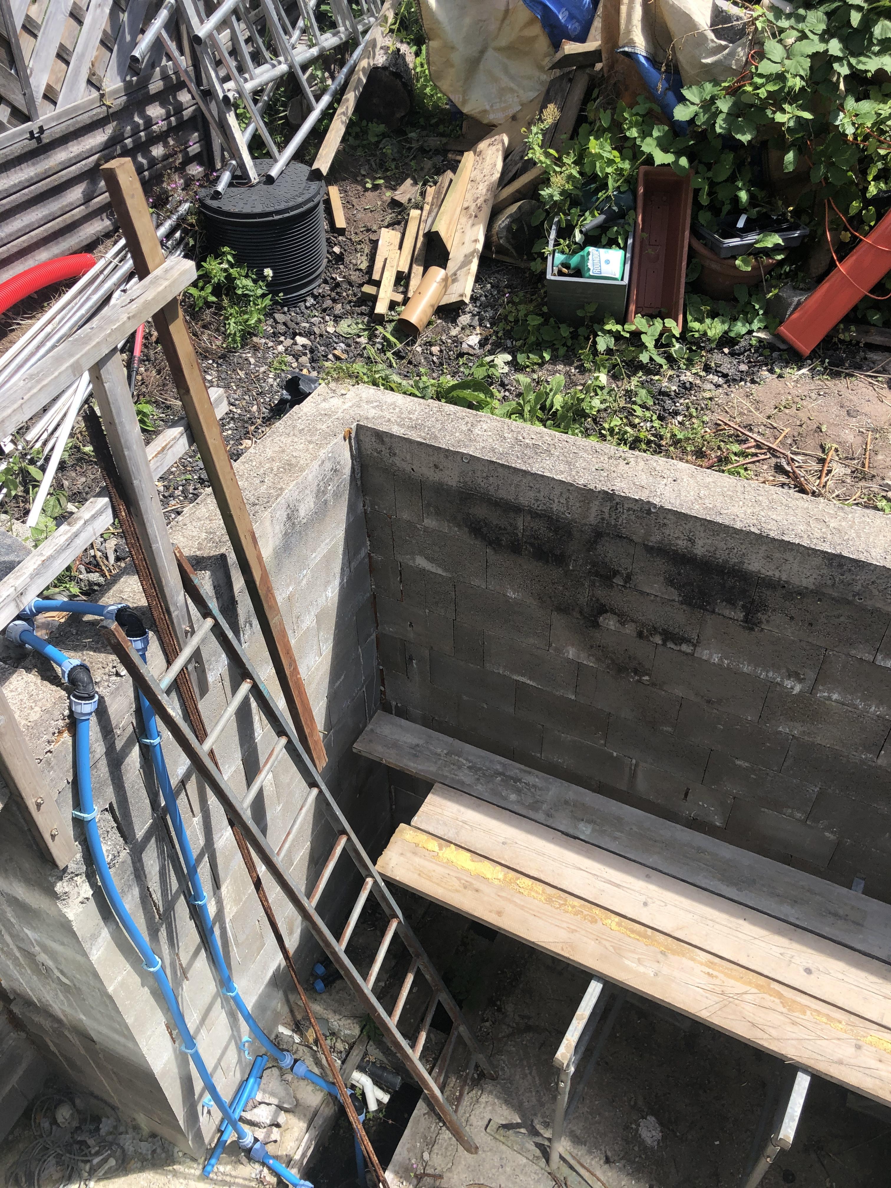

Pocster Posted July 22, 2020 Share Posted July 22, 2020 My single unit uvc turned up yesterday with installers . It weighed 130kg and worse it was top heavy . Nothing to dismantle. We tried multiple ways ( strapping it to a ladder , lower ladder etc. ) - to get it underground . It was fairly obvious this was a risky thing to do . So I quickly ( expensively ) ordered a crane to lower it down . As I’ll have loads of other large items and heavy I really need a cheaper method I can use over and over again . My temporary staircase just isn’t suitable to carry down a washing machine safely . So I look out the back - thinking what can I construct that can lower materials / items safely ? . Perhaps a crane/winch bolted to the concrete wall ? Want some thing that will take the weight of a large American fridge freezer , washing machine , plenty of materials . A nice hydraulic lifting platform would be good ? Ideals welcome ! Link to comment Share on other sites More sharing options...

Onoff Posted July 22, 2020 Share Posted July 22, 2020 (edited) A-frame gantry? Difficult without seeing the wider site conditions. What's going over "the hole"? Build an I beam into a pergola structure? Any higher structures adjacent? Edited July 22, 2020 by Onoff Link to comment Share on other sites More sharing options...

Pocster Posted July 22, 2020 Author Share Posted July 22, 2020 2 minutes ago, Onoff said: A-frame gantry? Difficult without seeing the wider site conditions. What's going over "the hole"? Build an I beam into a pergola structure? Yeah . I thought about that - but there's no real good ground to stand it on. Bolting it to the walls seems a bit risky. A mini elevator as in my latest video seems cool - but out of timber????!!!???? Link to comment Share on other sites More sharing options...
Onoff Posted July 22, 2020 Share Posted July 22, 2020 What sort of lift height? Link to comment Share on other sites More sharing options...
Pocster Posted July 22, 2020 Author Share Posted July 22, 2020 1 minute ago, pocster said: Yeah . I thought about that - but there's no real good ground to stand it on. Bolting it to the walls seems a bit risky. A mini elevator as in my latest video seems cool - but out of timber????!!!???? Scaffold steel be better?. But what about most important part the gantry ? i.e the bit that's taking the load Link to comment Share on other sites More sharing options...
Pocster Posted July 22, 2020 Author Share Posted July 22, 2020 Just now, Onoff said: What sort of lift height? Below ground floor top of wall 2.6 m Link to comment Share on other sites More sharing options...

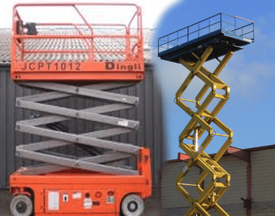

Bitpipe Posted July 22, 2020 Share Posted July 22, 2020 (edited) I would have thought a genie lift would do the job? They go up to 4m and 180kg. We used one to get two heavy (150kg) stone baths up to the first floor as, like you, I did not trust the mdf temp stairs to take the weight of that plus two blokes given there were 4 screws holding it in. Edited July 22, 2020 by Bitpipe 1 Link to comment Share on other sites More sharing options...
Mr Punter Posted July 22, 2020 Share Posted July 22, 2020 1 minute ago, Bitpipe said: I would have thought a genie lift would do the job? Won't be much fun lowering that down and getting it out though 1 Link to comment Share on other sites More sharing options...

Pocster Posted July 22, 2020 Author Share Posted July 22, 2020 2 hours ago, Bitpipe said: I would have thought a genie lift would do the job? They go up to 4m and 180kg. We used one to get two heavy (150kg) stone baths up to the first floor as, like you, I did not trust the mdf temp stairs to take the weight of that plus two blokes given there were 4 screws holding it in. Quick google 3k!!! Link to comment Share on other sites More sharing options...

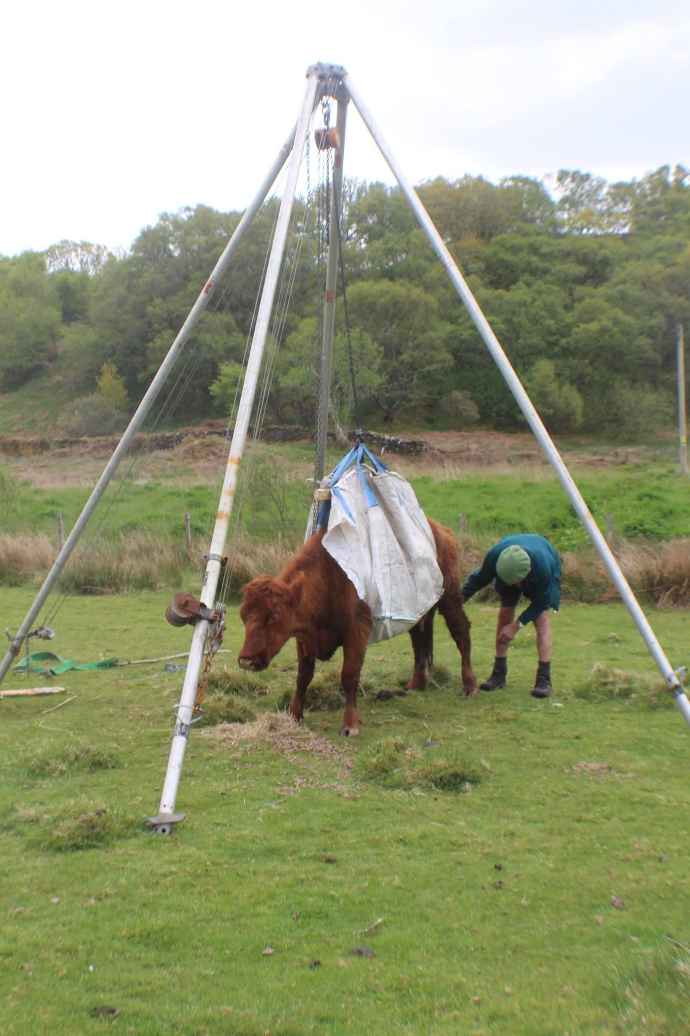

Cpd Posted July 22, 2020 Share Posted July 22, 2020 I have made numerous a frames out of wood and metal for lifting everything from engines out of cars to cows out of swamps..... costs next to nothing and many that I Have built can lift in excess of 1000kg - this poor bloody cow was stuck in a swamp for days and had lost The use of its legs Due to lost circulation, a few hours of massage got it back on its feet and it lived for a good few more years. Scaffolding is the quick fix for lighter stuff, the ones in the photo are purpose built but not sure of there origin as a mate left them here 6 years ago...... 2 Link to comment Share on other sites More sharing options...
Pocster Posted July 22, 2020 Author Share Posted July 22, 2020 2 minutes ago, Cpd said: I have made numerous a frames out of wood and metal for lifting everything from engines out of cars to cows out of swamps..... costs next to nothing and many that I Have built can lift in excess of 1000kg - this poor bloody cow was stuck in a swamp for days and had lost The use of its legs Due to lost circulation, a few hours of massage got it back on its feet and it lived for a good few more years. Scaffolding is the quick fix for lighter stuff, the ones in the photo are purpose built but not sure of there origin as a mate left them here 6 years ago...... I would have started a fire under it - fresh steak !! Link to comment Share on other sites More sharing options...
