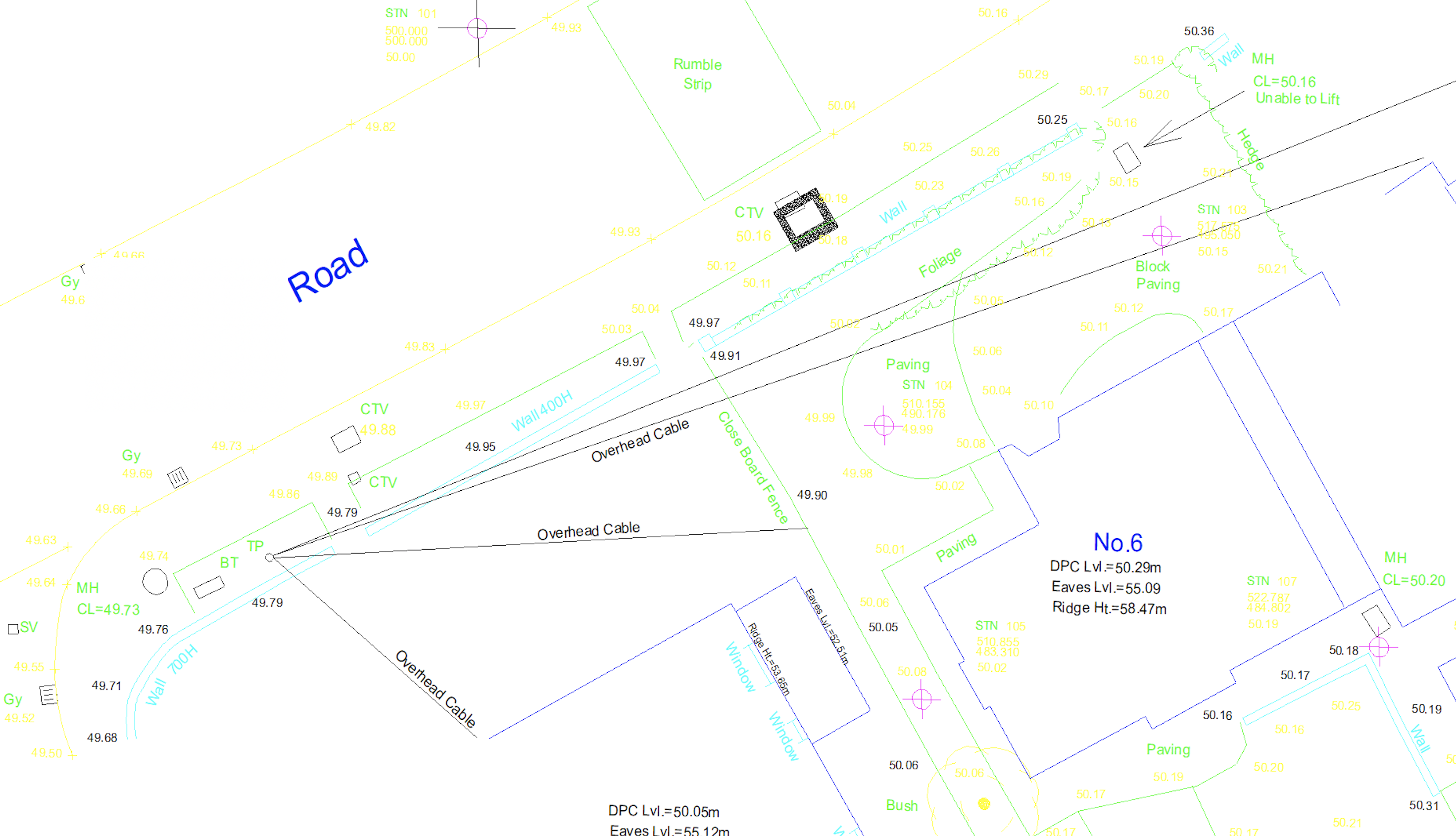

How do LPAs look up ridge heights and compare them? Case in point:
Ridge height of neighbour 1: 58.90 (above sea level)
My intended ridge height: 58.54
Fine, right? But no, sadly my neighbours DPC is at 50.84 and mine - in the current house, 50.29. The 'absolute height' of that neighbour is 8.06m (vs my 8.25)
Dumb question but is there anything stopping me from sinking the house (or more specifically the DPC) a few cm?
Nope, its what we did, dropped the GF level by 100mm - just need to make sure that you don't compromise your invert levels to main sewer.
Re fire regs - if you're planning to make your loft at all habitable at completion - occasional play space etc, then you need to make sure that you're good on the fire regs - that's all.
You may consider a particular space as 100% non habitable and use it for some domestic purpose, even occasionally. You don't need to be sleeping overnight in it for it to count. Only bathrooms and hall cupboards were exempt from our FD30 regulation.
If the house is signed off and the loft is not considered a room, then you may be ok as any future change of use would be considered as a conversion under PD.
However if you build the loft as a room in roof from the outset then BR will probably be all over it.
Link to comment
Share on other sites
I guess my main question is: can I provide the info the LPA works with - e.g. can I put in my DAS that our ridge is planned to be 50.65 whereas neighbours are 50.55 and 50.89 respectively (which is also reflected on our survey) - or do they do their own due diligence, which might turn up the more contentious point of view, that we are aiming for 8.25m from DPC, where neighbours are 7.95 and 8.05 respectively.
Who gets to "provide the data" the LPA uses

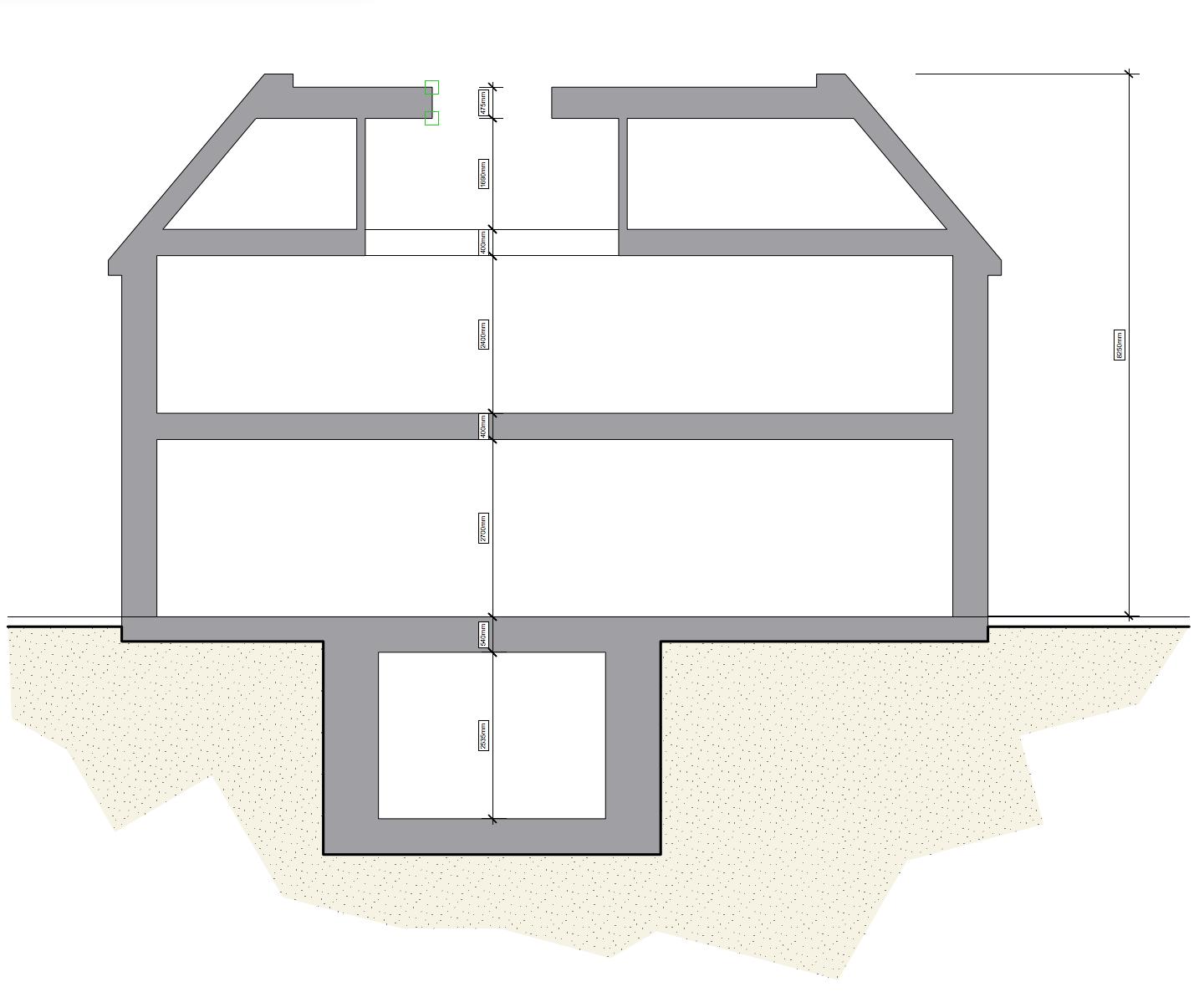

And as a bonus, surely I'd have to specify the basement? Or can I leave that out for planning permission?
Not a chance !! Basements require planning as they are an engineering activity. They also require escape windows / wells which show up on plans anyway.
Architect appears not to have considered this?
Link to comment
I did wonder about that one, but I thought that if the basement contains no official living space (just a plant room and some storage) it was okay to go without?
Link to comment

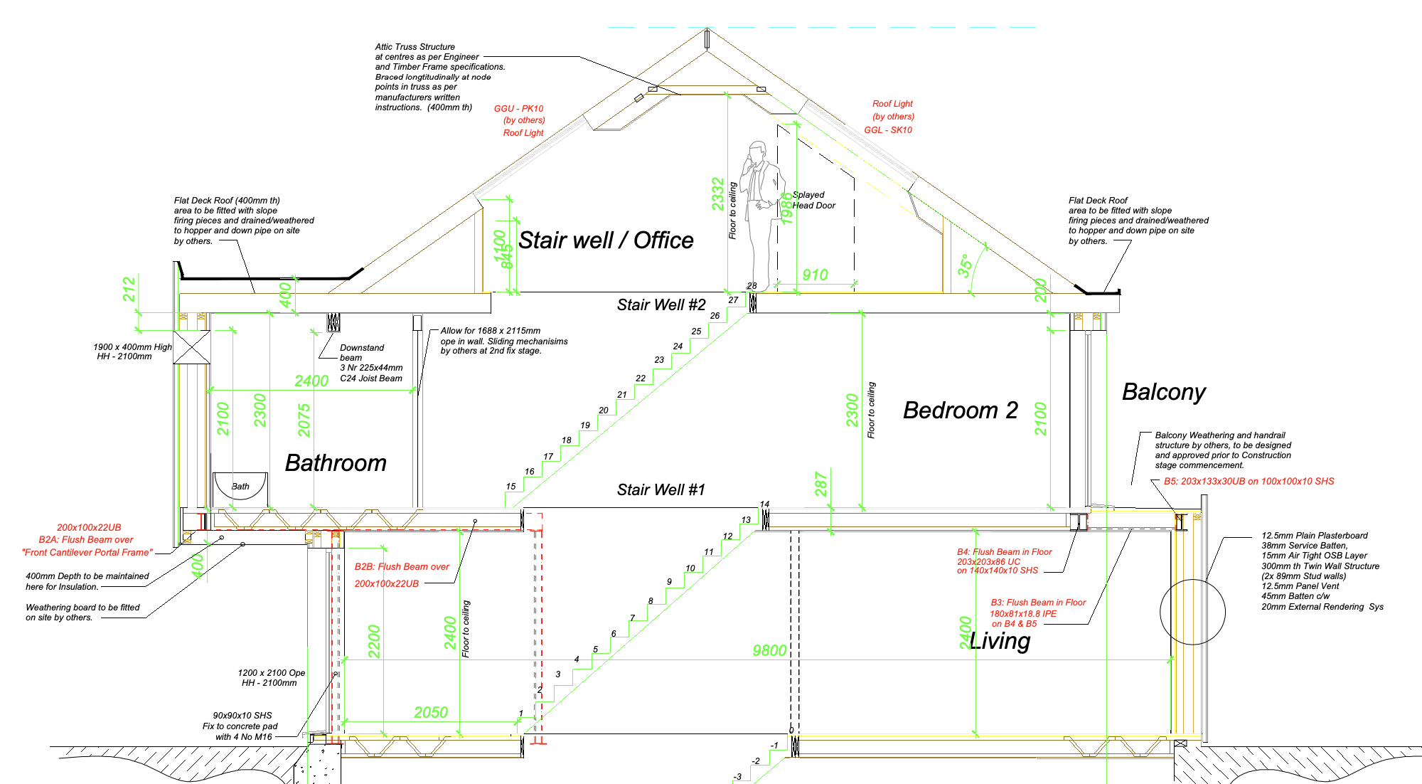

FWIW this is the current architect design:
(the 400mm floor structure was based on advice from our builder as a safe amount, but can probably be squeezed, the central hall is up to the roof, so the actual loft in this pic is the left+right section)
As such, I don't think I can 'stretch' the loft to 2200.
Loft is currently 1800.
I could probably get away with 2650/2350 for 1st and 2nd
-> 1900
Possibly 350mm floor structure depth (x3)
-> 2050
But that last 150 I don't really see where I can get that, unless I perhaps 'sink the house' 150..

Would you consider reducing your GF ceiling height?  Going above 2.4m incurs additional cost when it comes to plaster boarding  as the sheets come in 2.4m so lots of cuts? High ceilings are always impressive but it could be a compromise worth considering to make another floor viable.
For floor buildup, you need to allow 15mm for pb & skim on the ceiling underside and whatever your floor covering is upstairs. The floor deck is likely 18mm OSB so the rest is joist. Rule here is that the longer the span the deeper the joist to provide stiffness. The other consideration is any steel that you have in your roof structure to create large open span areas - these will be as deep as the engineer dictates (same principal as joists) and will need to be battened underneath to allow PB to be fixed to them.400mm is decent allowance - mine are 340mm surface to surface.

as per @Bitpipe's post - it doesn't really feel like you're getting the most/best out of your architect because you're trying to drive the design - I'm sure any creatives in the group will have seen the I design, you watch pricelist before....
I've worked with a fair number of self builders before, but I've never have someone work like you appear to be, I'm not sure how or why you've engaged them, but it looks like you're paying money to a design professional and then redesigning their design - can you not just sit down around a table with a set of drawings and tell them what you want them to design?

It’s all very well having a client wanting to get involved but to me, this much involvement is quite concerning. I’d feel embarrassed or upset if one of my clients was asking the quantity and quality of the OP across the forum. Just hope their architect never reads BH ?

1 hour ago, Bitpipe said:
Do you know your sewage invert levels (if you're connecting to a mains sewer)? You work backwards from here to get the necessary fall (between 1:40 and 1:80) and then see if you're high enough for the ground floor drains to gravity flow to the main sewer.
Nope, don't know. I've been trying to find the info on my survey but I don't think it says. The only thing I see on there is a manhole marked "SV" (sewage valve?) about 20m away from the edge of my property, which is about 0.5m lower than my DPC, which sounds mildly promising since it would mean that it sits indeed at slightly better than about 1:50 ratio (assuming the actual pipe is somewhat below that manhole lid)
If invert levels allow, your house can sit lower than the surrounding ground but you'll need a landscaping / drainage strategy like ACOs around the perimeter to intercept ground water. We have an imperceptible slope up from the house to the street boundary - did not need ACOs as the basement perimeter backfill acts as a giant French drain and also used a water permeable resin bound gravel/tarmac driveway.
Doesn't sound like a massive deal then?
As it stands my current DPC is 300mm above the street level (at the lowest point, toward the manhole), and the house is on a very slight upward slope (higher toward the garden)
2117058063_Screenshot2020-07-20at23_19_43.thumb.png.7e1f99ae1c2753960e5f922410483afc.png
(sorry for the colors, not my choice, but MH in green far left, SV slightly beyond that.
One more consideration for that basement, what's your drainage strategy for it? If you're putting services or plant down there then you'll need some arrangement to extract water - e.g. the UVC tundish or MVHR/boiler condensate. Worse, if you had a flood (burst pipe, washing machine disaster etc) that's where the water may end up.
