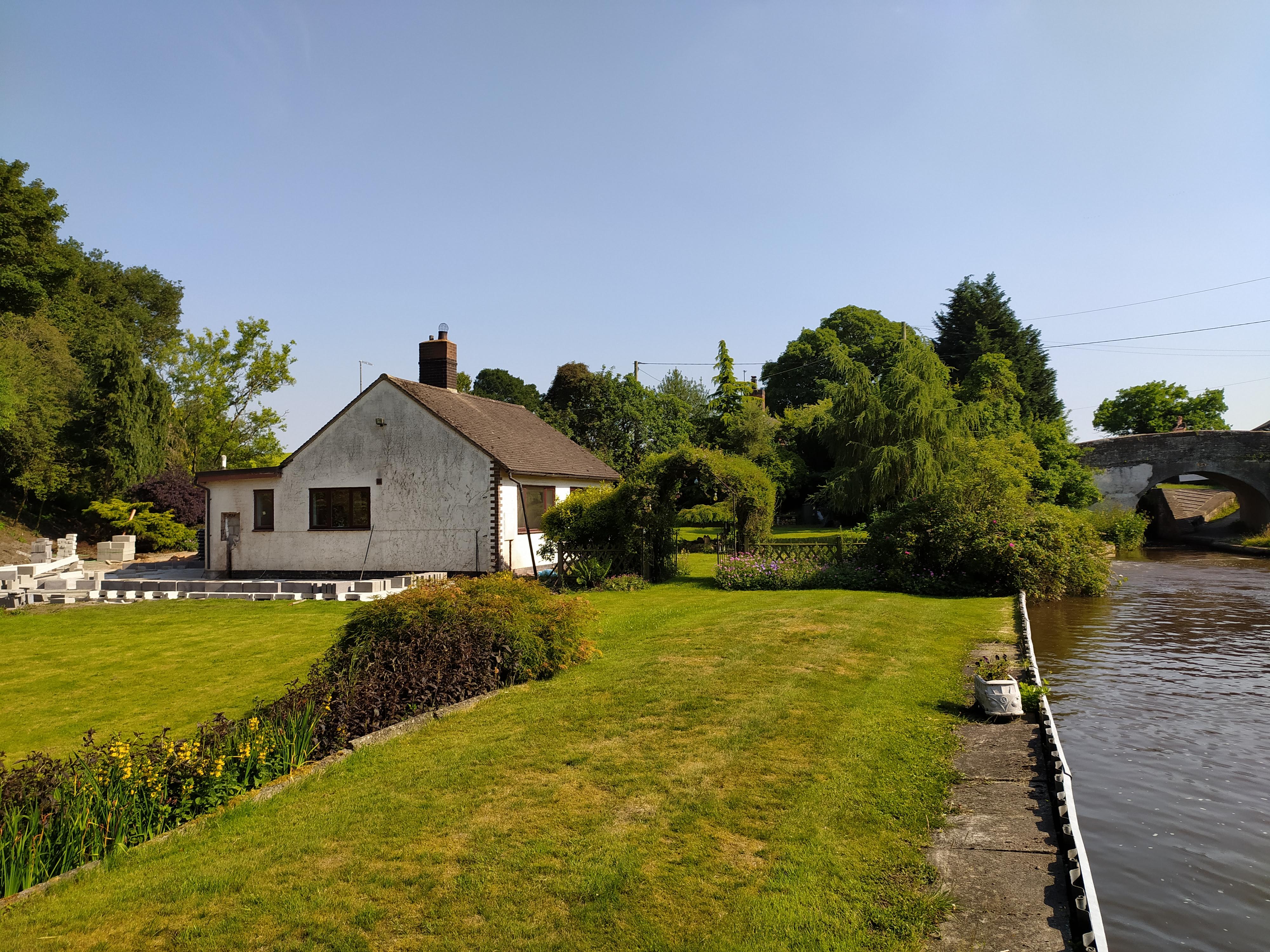

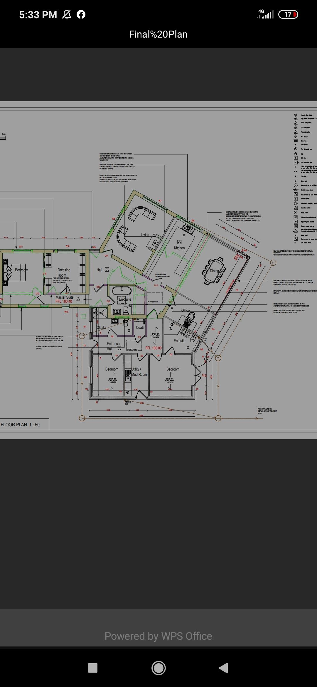

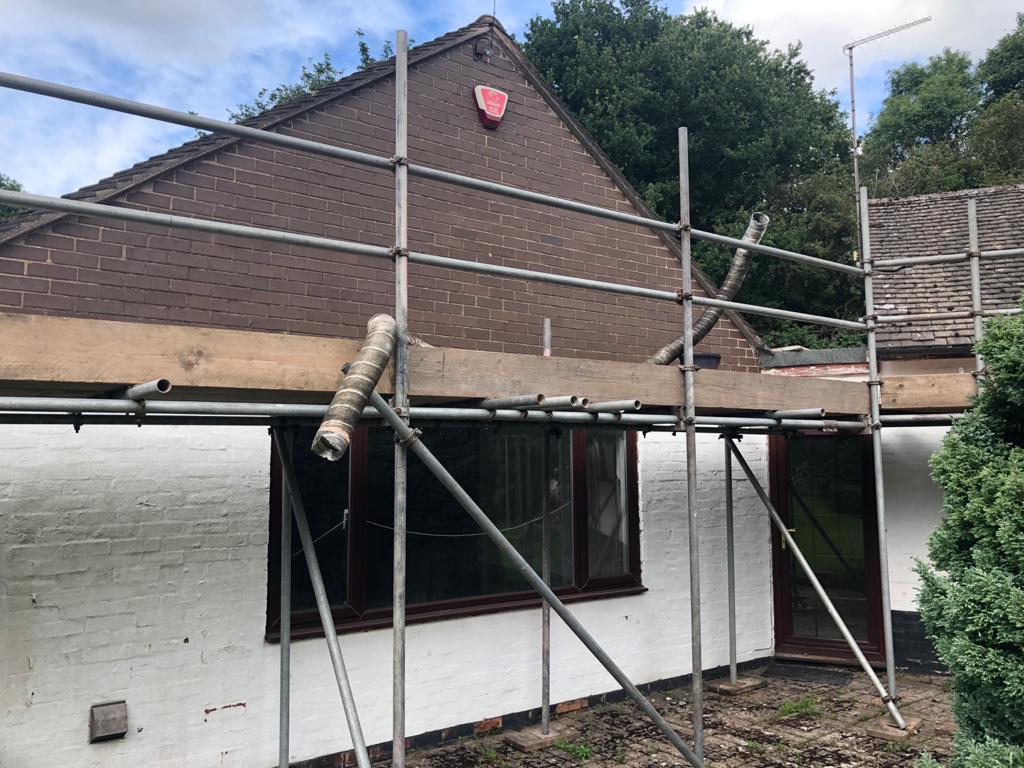

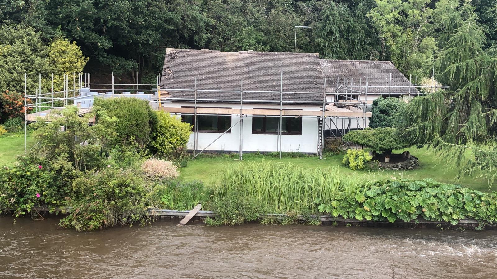

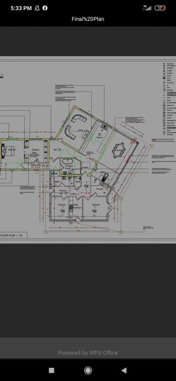

canalsiderenovation Posted July 14, 2020 Posted July 14, 2020 Internorm came today for a technical survey and we can't seem to agree on something (though unusually I don't have an opinion on this I just want to get the things ordered)! It concerns these two windows - the extension isn't up yet so added on to the left window is the kitchen extension. Looking at the bungalow the window on the left will form part of the kitchen and will have our kitchen sink/worktop so the bottom will be raised (I'm not on site at the moment but you're talking 10-15cm) to account for the base units/worktop. This is not an opening window, nor split rather just one pane measuring 1800mm *1050. To the right of this is the living room window this is a separate living room and not accessible from the kitchen/dining (plan attached) nor is it our only window in the living room (the other one is round the corner as you look at the bungalow on the righ. to raise the same as the kitchen one (10-15cm). The size of this 2400*1050 single pane and also fixed. Apparently having a higher than normal window in this room is not normal, though I can't see an issue with it though one of us described it as a letterbox! Is raising the height really that much of an issue. Frankly I don't care..... The other lounge window is 1490*1050 too but there are no other windows on this wall (see other pic - the window will be slightly smaller than the one in now). Plan attached for info.

the_r_sole Posted July 14, 2020 Posted July 14, 2020 Use the right window for the right place! I tend to not even use the 150 upstand around worktops anymore in kitchens and just run the worktops into the window reveals instead of cells... But anyway, the external elevation should give you a hint of what's happening inside, so people would know where the kitchen is on your house by the nature of the windows... have windows as big as are useful, certainly in the sitting room I'd go fairly low to make sure I can see out of them when sitting 1
canalsiderenovation Posted July 14, 2020 Author Posted July 14, 2020 (edited) 1 hour ago, Temp said: Windows are normaly lower so you can see out when sitting down. If it was me I'd put a wide patio door in there to max the view over lake. It's not a lake it's the Llangollen canal and it runs adjacent to our property and we have over 90 metres of canal frontage, the towpath being the other side. We have 5.5 metre sliders planed from our large kitchen diner with views of the canal and will have some seating area there. We are lucky in that we have the views not only in the living room but pretty much every window of the house so it's not like we are limited with the view only being from our living room and I'm all honestly I think we will spend much more time in the kitchen/dining area as it will have a bit of room for a small sofa too so will be more of a social space. I can only see the living room being used in winter when we want to snuggle in front of the log burner! Here's a better pic from earlier on in the build and looking towards those large sliders we have planned. On reflection I don't think it matters making the living room window a bit higher to keep it in line with the kitchen. Edited July 14, 2020 by canalsiderenovation
