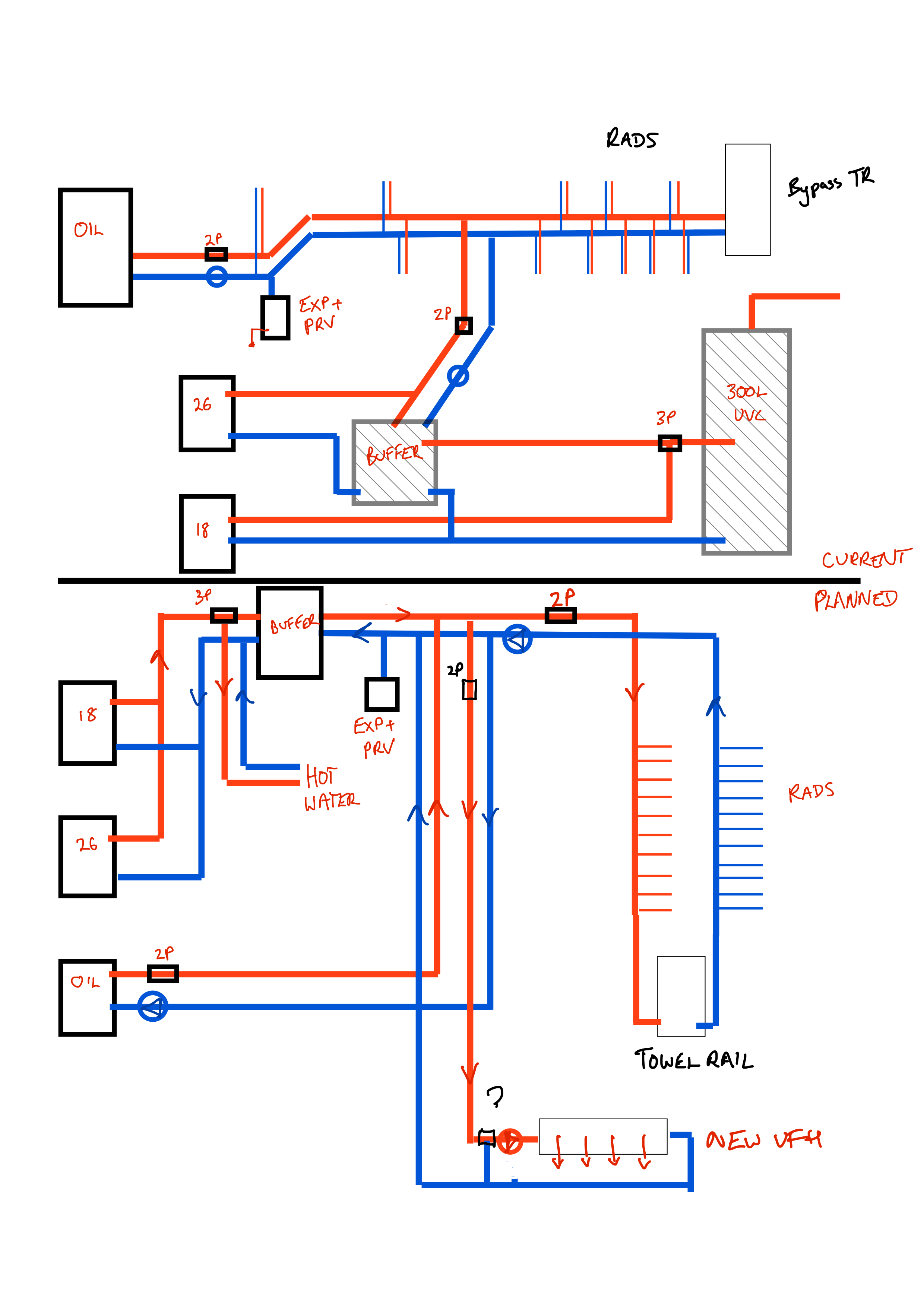

Wil Posted July 1, 2025 Posted July 1, 2025 A pretty terrible scribble, give me a few mins to tidy it up! 1
Wil Posted July 1, 2025 Posted July 1, 2025 @Nickfromwales see scribbles below. Current above, planned below. The idea is I could eventually drop the oil and the 26kW ASHP but they’re there anyway so might as well use them.

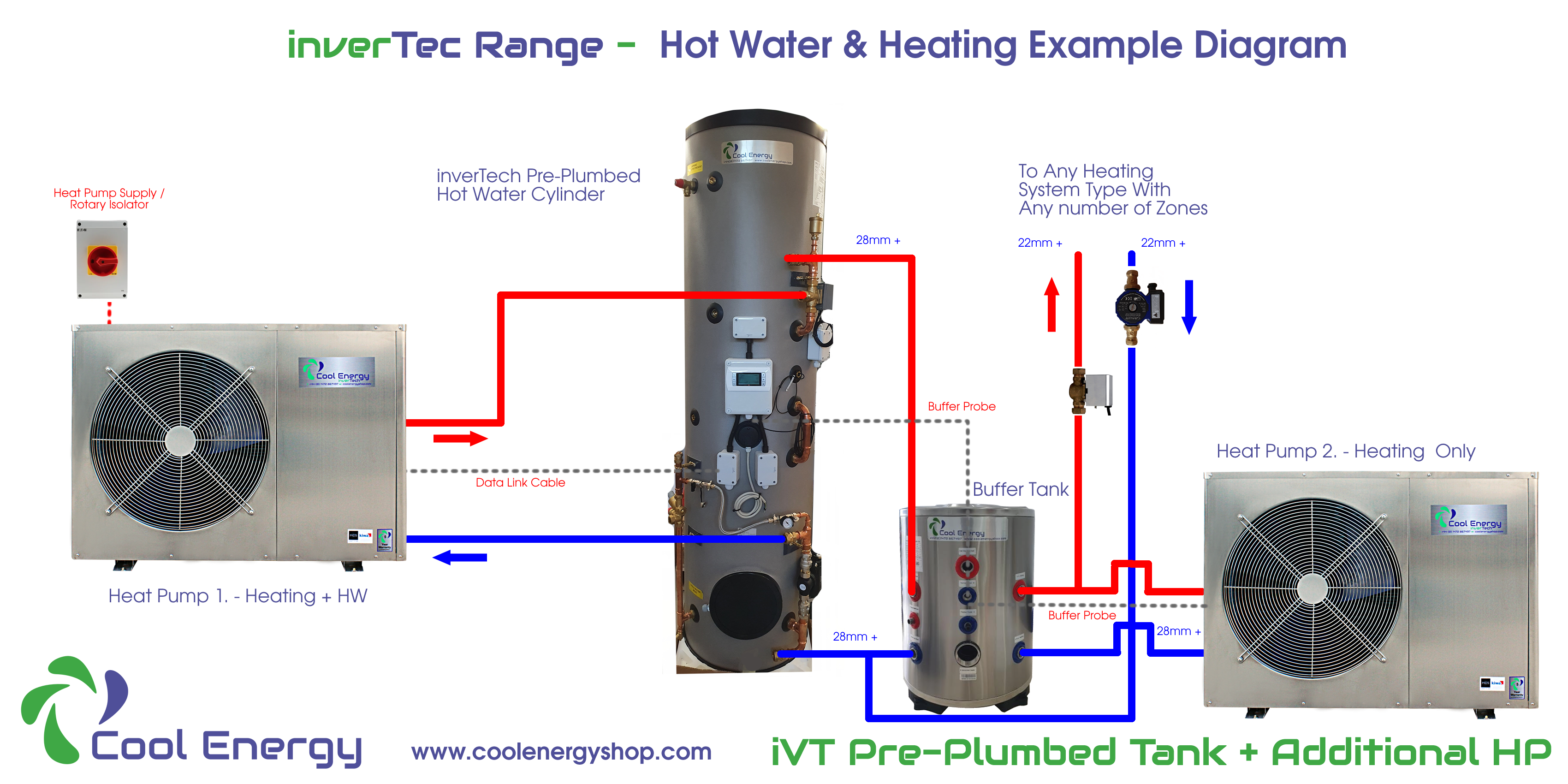

Wil Posted July 2, 2025 Posted July 2, 2025 (edited) @JohnMoThey’ve been installed per top scribble for 3 years. I appreciate the ridiculous oversizing but I have another project this 26unit will move to once I finish the upgrades to the main house and can prove just the 18 copes. this is the ASHP setup as per CE: Edited July 2, 2025 by Wil Added diagram
Nickfromwales Posted July 2, 2025 Posted July 2, 2025 44kw...!! Yikes. Anyhoo, as you plan to reuse that elsewhere (which one will you remove btw?) pointless going over that. On the proposed I saw the 2 HP's tee'd together to do DHW, but I assume that will no longer be the case; only 1x HP can do the DHW cycle obvs.
Wil Posted July 2, 2025 Posted July 2, 2025 Yep, it certainly makes the meter spin when it all runs together. Ah yes, only one can ever do the DHW, currently the 18. I would aim to drop the 26 altogether in the future. In the CE diagram 18 is on the left and 26 on the right. The intent of the proposed was to allow them to run in parallel for heating and one for DHW but that’s not what is shows! I’ve read in the other threads about removing buffers and using volume of system (my house is plenty cold enough there’s valves open). But specifically at the moment is is the pumped UFH system the correct approach? Can I simplify as per JohnMo’s example or is the current setup optimal in terms of feed.
Nickfromwales Posted July 2, 2025 Posted July 2, 2025 If there’s a single ASHP then you can do away with it as suggested, whilst the oil remains you should have a cap on the max permitted flow temp into the UFH. That means, as of now, you should have one. (afaic).
Nickfromwales Posted July 2, 2025 Posted July 2, 2025 3 hours ago, Wil said: @NickfromwalesThank you, I’ll insist he changes it. It won't need altering later, just may become an ornament that's the catch. Way too much Russian roulette here without it tbh. 1
