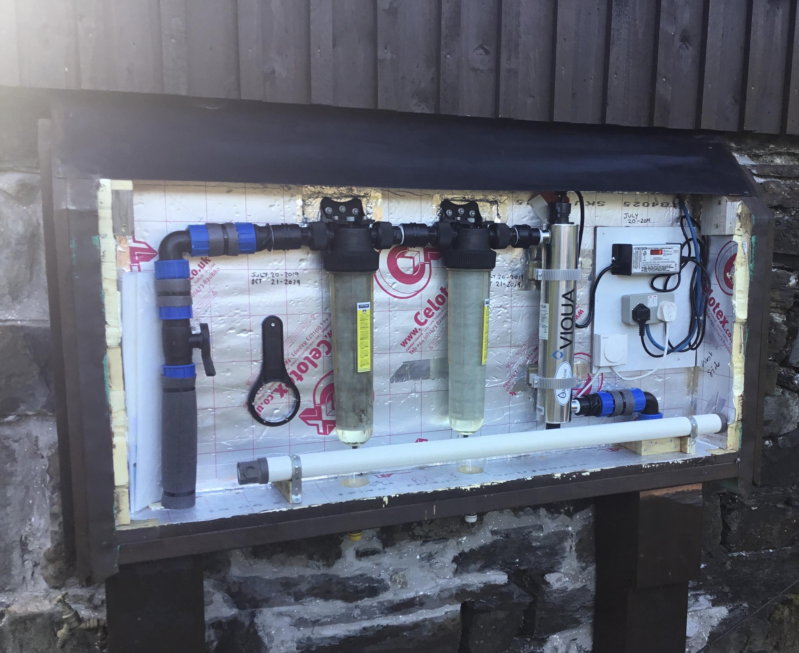

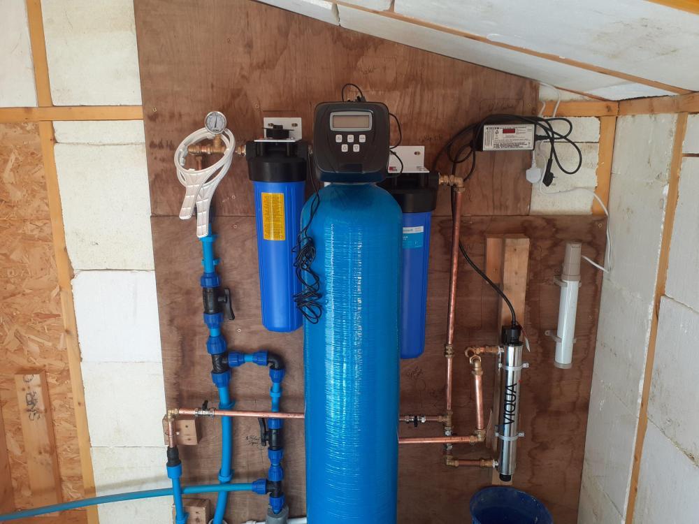

PeterW Posted July 6, 2020 Posted July 6, 2020 I’d be storing a minimum of 10,000 litres and taking it off with a floating pickup - they sit about 8-10” down and you get none of the top surface or the silt. You will need filtration - @jamieled has just done his and it looks really tidy. Add a 500 litre accumulator after this and you’ll have plenty of water. 1

jamieled Posted July 7, 2020 Posted July 7, 2020 @scottishjohn In Scotland you are generally required to submit a 'private water supply assessment' with your planning app. If you don't then they will often put a condition on your planning that you provide one prior to construction work commencing. They are looking for evidence of both quantity and quality for a supply. The requirement to do this does seem to vary a bit between local authorities. This website: https://dwqr.scot/private-supply/technical-information/physical-and-chemical-properties/ Provides the relevant info on the limits for certain parameters - colour, turbidity, iron, pH etc. If you need to get the water tested then there are private labs that can do it, but I found Scottish Water the most economical and easy to deal with. You are generally correct that upstream landowners have a responsibility (in law) not to interfere with downstream users water supplies. This would also apply to a spring. In practice this can get a bit messy and I have been involved in a few jobs over the years with arguments between landowners and supply owners. 2
