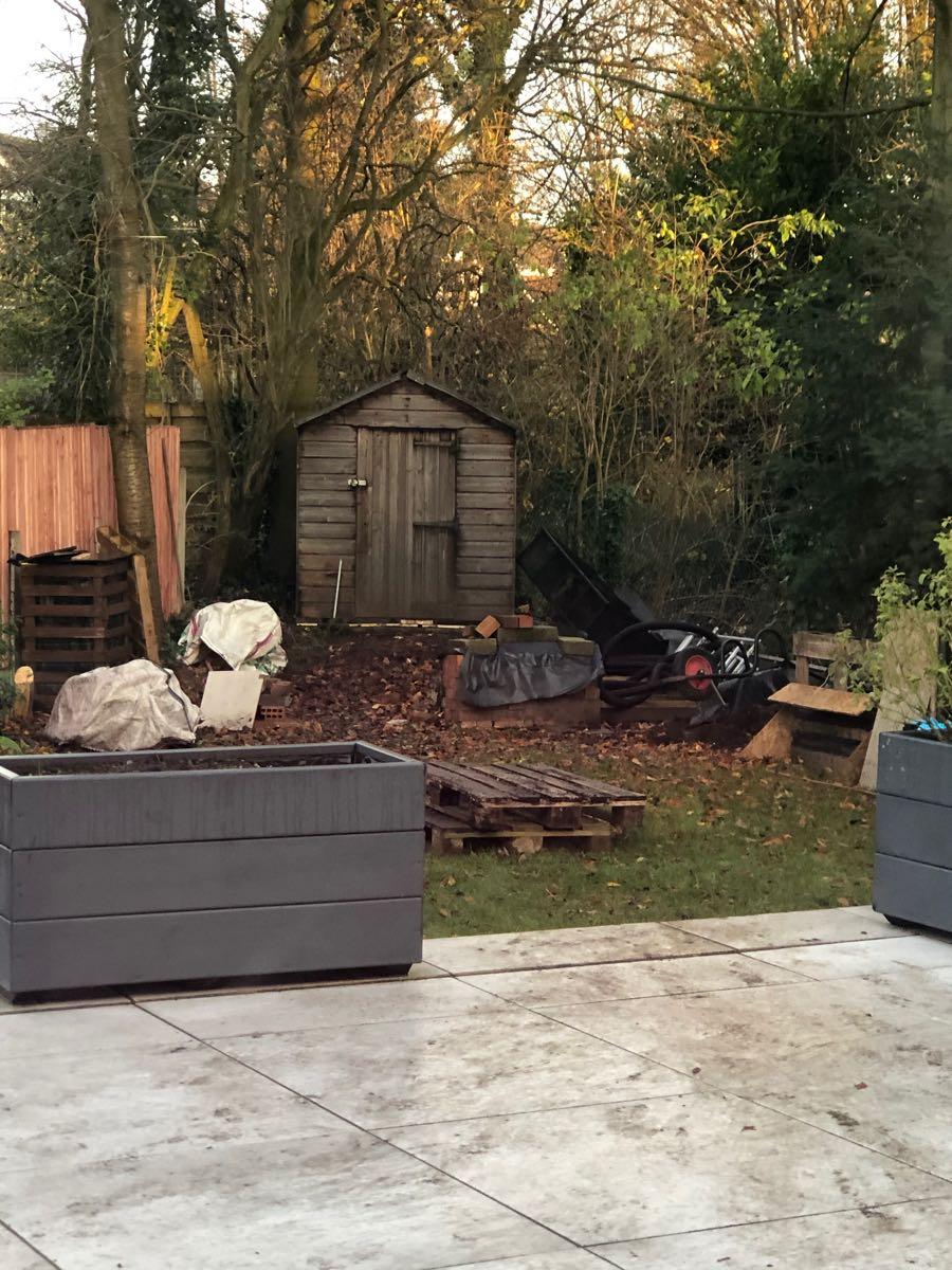

Size concerns:
Want to push the width to max but difficult to survey space to work out. That sketch in the OP is indicative not 100% sure that size would fit so can’t just plonk a small square cabin in the plan
Base concerns:
Trees - will be close to a couple of trees at diagonal opposite corners. One tree big, one free fair size.
Timber - good in that reduced digging near trees but will raise the building by 150mm and already pushing the PD height limits as cabin options we like are 2.8m tall.
Concrete - not looking forward to digging that area by hand due to trees and previous vegetation. 100mm x 15 Sq m so a nominal 1.5m3. Would prob need pump for readimix and way over what I could do as a first concrete base.
Hoping it’s dry this weekend to have a gook look.
(Priority job is to take out a wonky fence post. See how big they are and whether 1m above ground will hold a 6ft panel ?)
