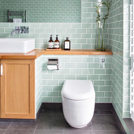

Roz Posted July 2, 2020 Posted July 2, 2020 (edited) (the concealed cistern I have posted about before is at my mums place... this is for mine!) So I had in mind to do something vaguely like the attached picture, and I would really like to have the basin countertop at the same height as the toilet boxing in. However, the shortest concealed cisterns with frames I can find are at 0.82m in height, which is quite high for a sink shelf no? As shallow sinks seem to be around 15cm high, so would make the top of the sink 97cm which seems high? Even without a frame surely it would end up at the same height because of the height of the pan and flush pipe? Can anyone shed any light on if this can be shorter, or if this sink in the pic is likely to be at 97cm? Plus the wood board so maybe 99cm I see the countertop furniture units you can buy off the shelf are about 75cm high as standard, making sink height 90cm. Maybe an extra 7-9cm isn't that big of a deal?? I don't know! I know you can have the inset sinks but that's not the current aspiration. Edited July 2, 2020 by Roz
PeterW Posted July 2, 2020 Posted July 2, 2020 That looks to be a floor mounted WC Pan so I would guess it doesn’t have a frame and is just a cheap built in cistern - quick and easy to do. https://www.victorianplumbing.co.uk/hudson-reed-dual-flush-concealed-wc-toilet-cistern-xty014
Roz Posted July 2, 2020 Author Posted July 2, 2020 21 minutes ago, PeterW said: That looks to be a floor mounted WC Pan so I would guess it doesn’t have a frame and is just a cheap built in cistern - quick and easy to do. https://www.victorianplumbing.co.uk/hudson-reed-dual-flush-concealed-wc-toilet-cistern-xty014 Hey Peter, thanks! would it not end up the same height because of the height of the flush pipe? Or can you alter this?
Temp Posted July 2, 2020 Posted July 2, 2020 (edited) We have a wall hung WC and the recommended height of pipes and separation between them varies from make to make. I tried to compile the enclosed spreadsheet but it may not be accurate. So from that the height of the flush pipe for a wall mounted is around 355-360mm. WC.xlsx Edited July 2, 2020 by Temp 1
Roz Posted July 2, 2020 Author Posted July 2, 2020 10 minutes ago, Temp said: We have a wall hung WC and the recommended height of pipes and separation between them varies from make to make. I tried to compile the enclosed spreadsheet but it may not be accurate.. WC.xlsx 12.16 kB · 0 downloads Thanks Temp! They all seem to have roughly the same flush pipe height which is good to know. So I guess it's whether the pipe itself can be shortened maybe.
PeterW Posted July 2, 2020 Posted July 2, 2020 15 minutes ago, Roz said: Hey Peter, thanks! would it not end up the same height because of the height of the flush pipe? Or can you alter this? no you can cut them down. Min is about 100mm but that will put the cistern well below the counter. I can’t work those tiles out but think they are about 75mm tall looking at them so you can calculate the heights from that. 1
Temp Posted July 2, 2020 Posted July 2, 2020 4 minutes ago, Roz said: Thanks Temp! They all seem to have roughly the same flush pipe height which is good to know. So I guess it's whether the pipe itself can be shortened maybe. I may have discarded some that were different. I was doing this because I had a cistern to fit but hadn't chosen the pan yet. Just wanted to keep options open. Floor mounted might be different? Another cistern.. https://www.qssupplies.co.uk/bathroom-furniture-shower-taps/20043.htm Floor to flush 355mm Flush pipe to top of cistern 35.5 + 7.5 = 430 mm Plus 20 counter top = 805 total.
Temp Posted July 2, 2020 Posted July 2, 2020 7 minutes ago, PeterW said: no you can cut them down. Min is about 100mm but that will put the cistern well below the counter. So thats 303 for the cistern and about 100 for the flush pipe.. Floor to flush 355mm Flush pipe to top of cistern 403 mm Plus 20 counter top = 778 total.
Roz Posted July 2, 2020 Author Posted July 2, 2020 (edited) Thanks @PeterW @Temp Do you think this would only work for a floor standing toilet rather than wall hung ? I guess I would need to build my own fixing frame for wall hung as the standard ones put them high, which seems tricky Edited July 2, 2020 by Roz

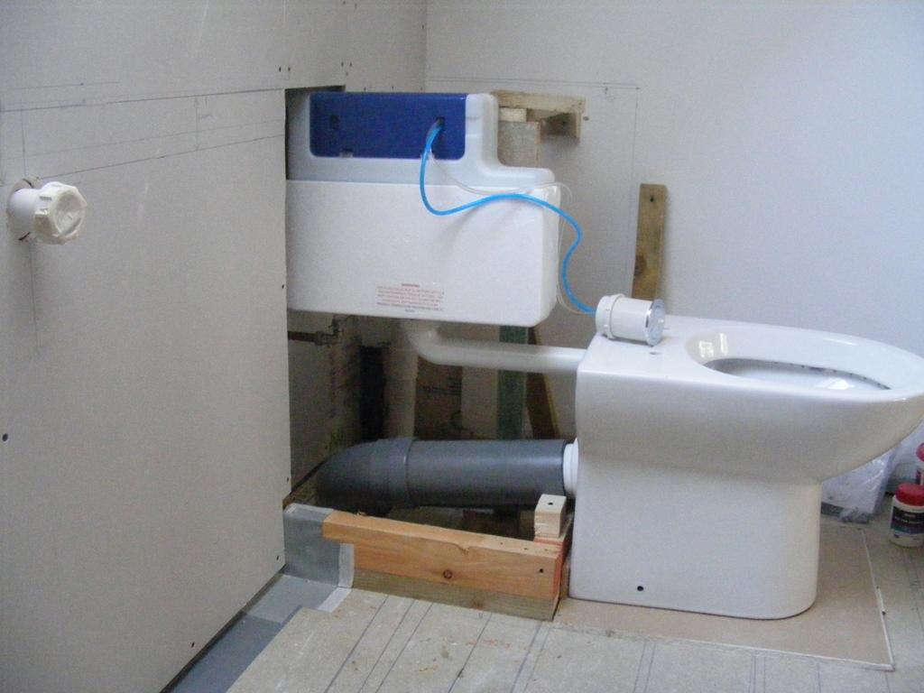

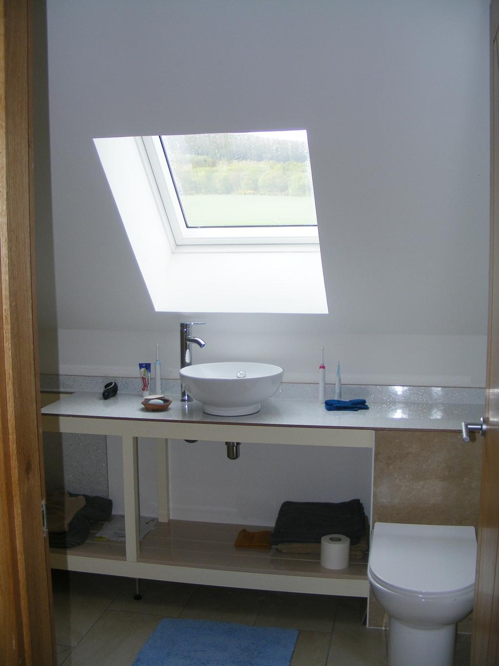

ProDave Posted July 2, 2020 Posted July 2, 2020 I have a similar arrangement. It is a floor standing back to wall pan so no frame needed. It is just a standard concealed cistern bought before we knew exactly what we were going to do. The flush pipe is shortened as much as possible, to set the cistern as low as it can go. I then set the worktop height as low as it could go still allowing room to lift off the service hatch on the cisterm, which in my case is all front access. And then I chose a thin worktop, just 10mm thick. This gives a counter top height of 80cm and it's 95cm to the rim of the basin. In my case the cistern is set at right angles to the pan and service access is by removing a trap door in the right hand end of the shelf unit. 1
