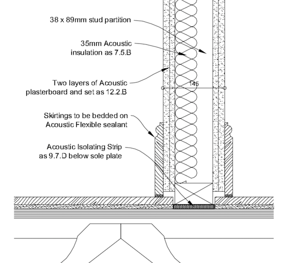

Dan F Posted June 27, 2020 Share Posted June 27, 2020 (edited) Hi, I have a good understanding of the different way to mitigate noise transmission through walls usiing soundbloc, mineral wool and resilient bars, but I'm unclear on how to best use acoustic flanking strips and where they are really advantagous vs. not really needed. Our architect has specified these under amost all internal stud walls, but when I speak to the product supplier they recommended using them both below and above internal stud walls and also where stud walls butt up to external walls. Obvisouly we want to use these where it makes sense, but don't want to go overboard as it may drive our frame designer crazy and there is also obvisouly also an additional cost invovled. My understanding is that these strips are mostly about avoiding the structure transmitting noise, but if you have well detailed walls, resilient bars on the ceiling, screedboard above the decking and you are as using the correct asositc sealant/strips at PB/skirting juntions, how important is it to use these strips between i) slab and studs ii) external wall and studs iii) studs and joists? This is the product I'm referring to: http://www.cmsdanskin.co.uk/general-construction/acoustic-wall-solutions/regupol-acoustic-isolating-strips/ Thanks, EDIT: I should add that this is a MBC twin-wall build with 89mm internal studs and 253mm metal-web joists at 400mm centers. Edited June 27, 2020 by Dan F Link to comment Share on other sites More sharing options...

Dan F Posted June 28, 2020 Author Share Posted June 28, 2020 1 minute ago, Dreadnaught said: @Dan F, I wonder are planning using timber studs or metal framing for your internal walls? (I have chosen metal framing). Timber studs because these come with the MBC package. They can put the isolating strips in, no issue, I just need to decide where. Thing is I don't want to i) regret not putting them in when I could have (can't retrofit) or ii) put them everywhere if not needed due to cost implications and risk it doesn't go down too well with designer/installers if I put them everywhere just in case. Link to comment Share on other sites More sharing options...
Moonshine Posted June 28, 2020 Share Posted June 28, 2020 11 hours ago, Dan F said: @Moonshine Is this one that you can help with? From a quick scan of what you are trying to do they seem a bit redundant. Have you got drawings you can share? Are these going at ground floor or first floor? Link to comment Share on other sites More sharing options...
Dan F Posted June 28, 2020 Author Share Posted June 28, 2020 8 minutes ago, Moonshine said: Are these going at ground floor or first floor? That's part of what I'm trying to work out. This is our standard wall details (upstairs is 22mm caberdeck on metal-web joists, downstairs is concrete slab). The TV room is the same plus a resi-bar on one side. You can see that a strip is proposed below stud, but not above. Yet the supplier says that to do the job probably you need to use it at the top of studwork and where it abuts external walls too. Link to comment Share on other sites More sharing options...
Moonshine Posted June 28, 2020 Share Posted June 28, 2020 You won't need them on the ground floor as the impedance mismatch between concrete and timber will do a fair bit of isolation for you. At first floor I am not convinced they will make a bit difference as aren't the wall sole plates going to get screwed down to the joists negating the isolation provided by the pads. Btw that drawing doesn't show resilient bars 2 Link to comment Share on other sites More sharing options...
Dan F Posted June 28, 2020 Author Share Posted June 28, 2020 (edited) 41 minutes ago, Moonshine said: Btw that drawing doesn't show resilient bars Currently we don't have resilient bars planned for anywhere apart from TV room. The detail for TV room is the same as pasted with the addition of a resi-bar on one side (TV side). It might make sense for us to use resi-bar detail slightly more widely though, e.g around bedroom/studies. 41 minutes ago, Moonshine said: You won't need them on the ground floor as the impedance mismatch between concrete and timber will do a fair bit of isolation for you. In laymans terms, does this mean that the type of sound/vibration carried by the slab isn't going to be transmitted easily by wood and vica-versa? Also I assume that if you wanted to prevent sound (e.g. from a subwoofer) travelling through the slab, the best approach would be an acoustic mat in that specific room, right? 41 minutes ago, Moonshine said: At first floor I am not convinced they will make a bit difference as aren't the wall sole plates going to get screwed down to the joists negating the isolation provided by the pads. We'd use "Regupol® 3D Isolation Washers" where mechanical fastenings are needed. So potentially still value in using tape at top of downstairs stubs and bottom of upstaris studs? In you view, does the use of resi-bars reduce the need for isolation strips or are they two seperate complimentary strategies? Edited June 28, 2020 by Dan F Link to comment Share on other sites More sharing options...

Dan F Posted July 1, 2020 Author Share Posted July 1, 2020 I think I'm going to skip the isolating strips and use resilient bars more widely along with correct use of perimeter acoustic sealants etc. My thinking is that this will reduce transmission to structure to the point that reducing transmission through the structure via these strips is less critical and wouldn't have much more additional impact. 1 Link to comment Share on other sites More sharing options...
