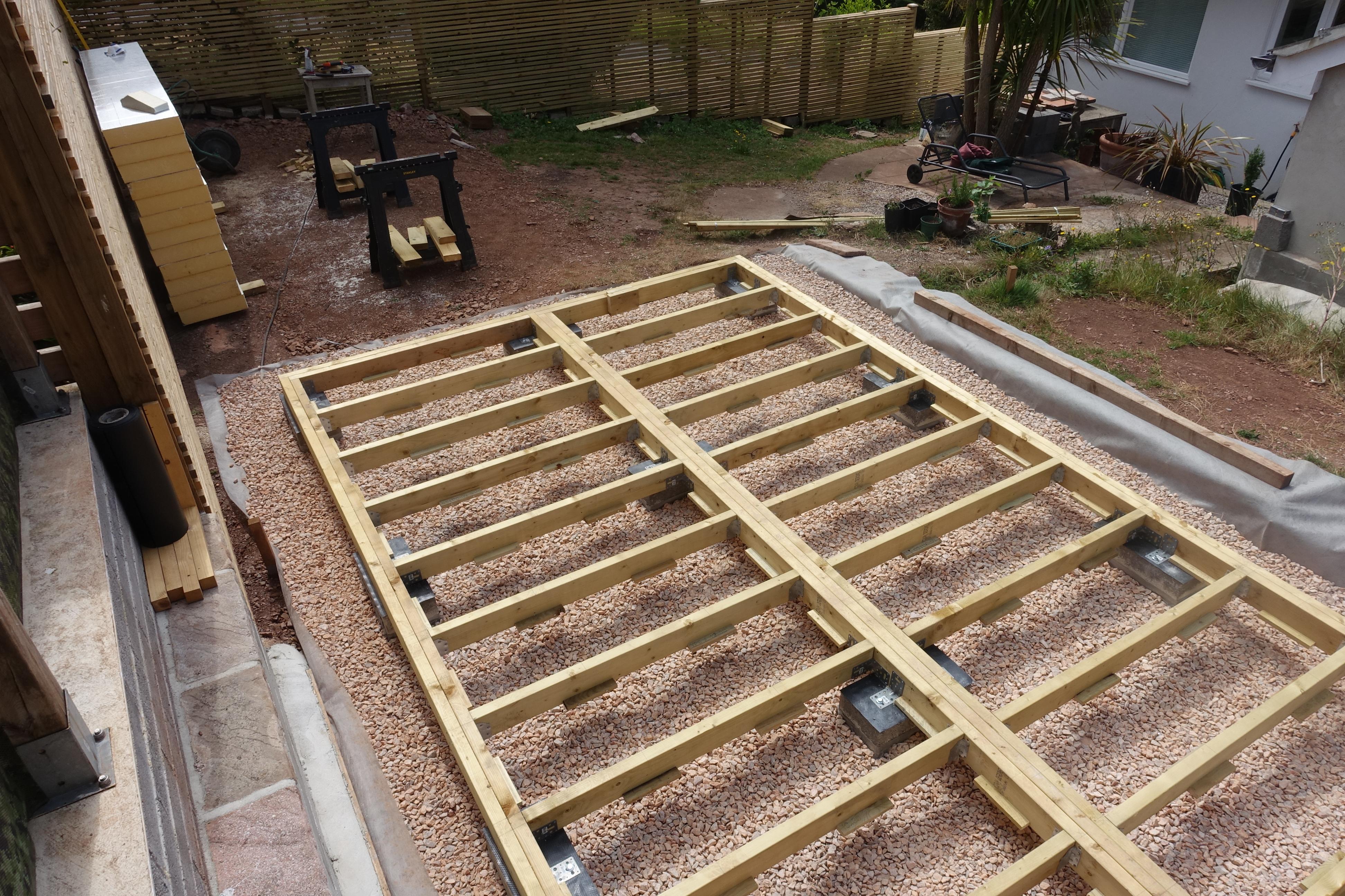

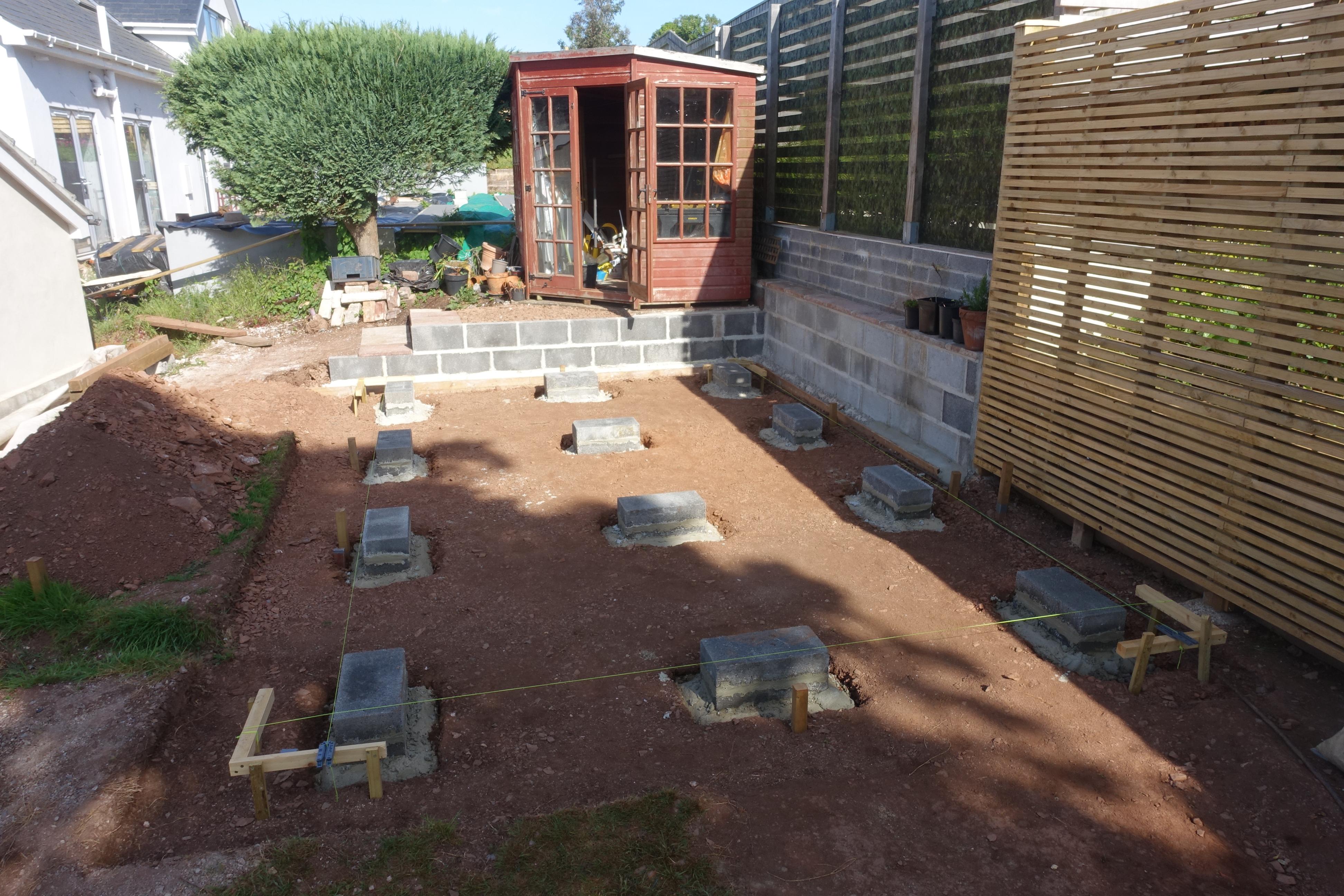

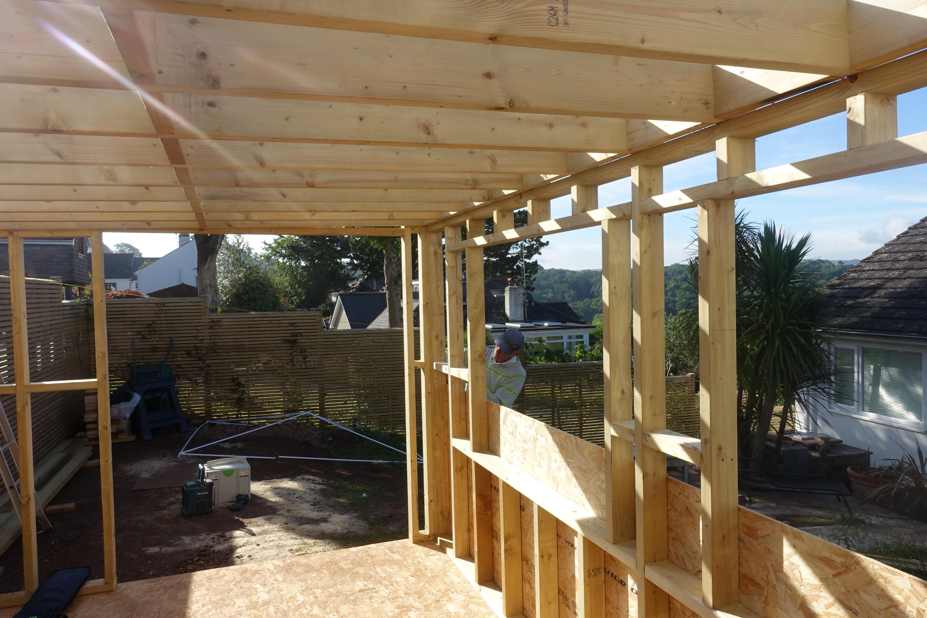

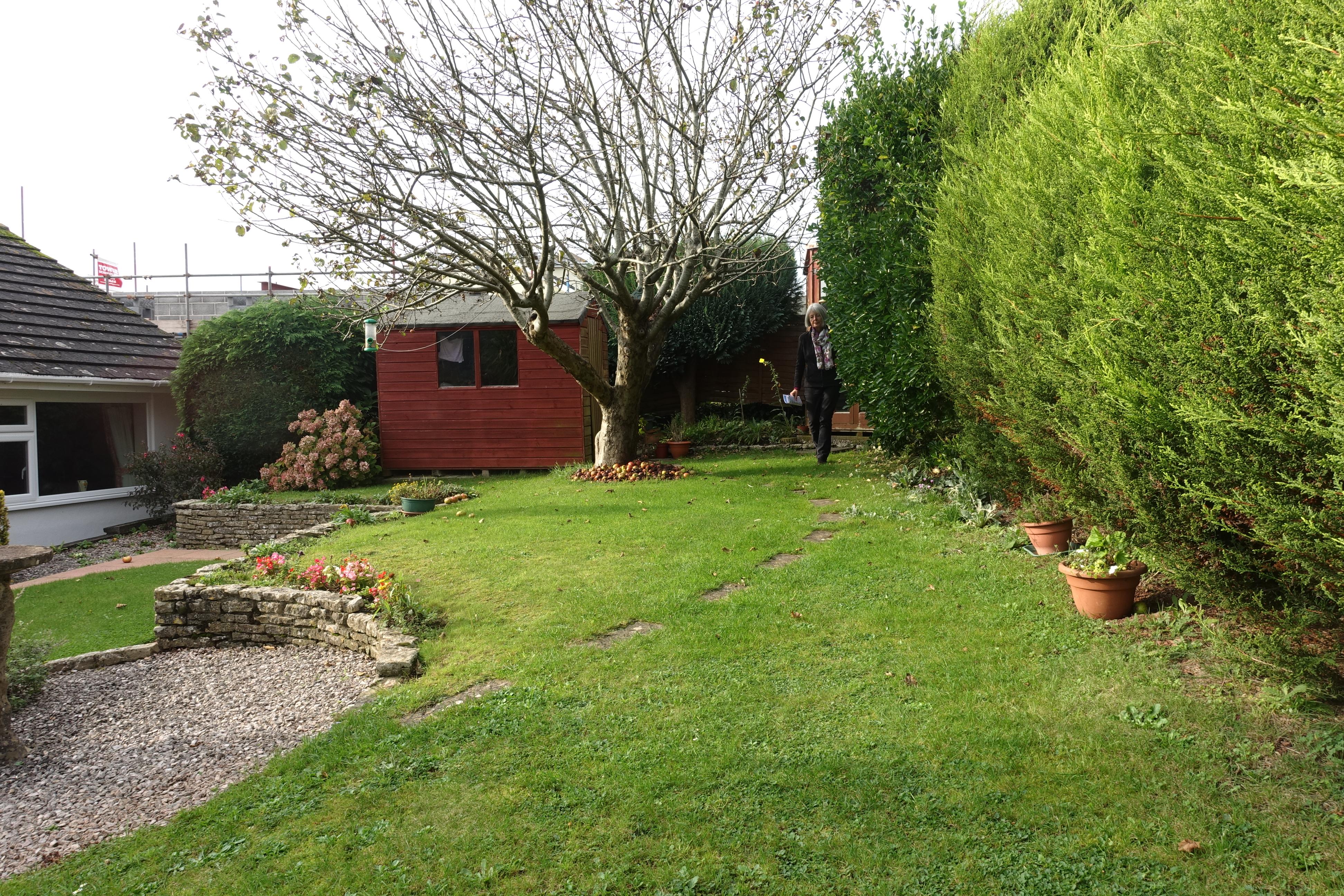

timsk Posted June 19, 2020 Author Posted June 19, 2020 (edited) Thanks everyone for the warm welcome and to Russell especially for the heads up about TBC; it's always good to know who the big cheese is and who one should be deferential towards! ? Peter, some pic's for you - nothing very interesting I'm afraid. Currently, the whole structure is wrapped in a breathable membrane (a cheap version of Tyvek) and looks dreadful. The chap one can just see in the corner of the final image (pic #4) is our local village chippy who helped with the main construction of walls and roof. A great bloke, a good carpenter and super quick. From the base frame, (pic #3) to the main structure being completed - including two windows - took just eight days. It would have taken nearer eight months if I'd been working alone! Tim. #1. Studio Site Diseased apple tree and Leylandii hedging subsequently removed. Just behind the figure (my wife, Pam) you can just make out the corner of the summer house which you can see in pic #2, below. #2. Concrete Piers 24 concrete blocks used in total - much cheaper than using bespoke products. #3. Base Frame This is secured to the concrete blocks with steel angle brackets and 80mm long 10M concrete screws. The 200mm long battens at the bottom of the 5" x 2" joists are for the 100mm insulation to sit on to ensure it doesn't fall out. #4. OSB Sheathing Going Up The large aperture on the end elevation is where the entrance door will go (currently the entrance to our bungalow which is due to be replaced). The openings in the right elevation are for two windows bought from a supplier of misfits for £190 including the glazing and VAT! So, that is in fact the total cost of windows and doors - which is often a big chunk of the budget for a project like this. Edited June 19, 2020 by timsk Adding comments to the pic's 5

timsk Posted July 13, 2020 Author Posted July 13, 2020 On 13/07/2020 at 11:30, daiking said: That's cheap as I can't find anything much below £1.50 for treated. I also need double-sided slats which is a lot more work. I also need to take a closer look at that youtube channel as I'm wary of how on earth I will get concrete piers level myself when I get round to the same project. Expand Hi daiking, The fence timber is only rough sawn - not planed. Planed, although much nicer, would easily have doubled the price and, if I'd gone for larger 25 x 50mm slats the price would have been over £3.00. Also, because of the quantity, my timber merchant gave me a discount. Levelling the concrete piers was a little tricky as I don't have (or have access to) a laser level and had to rely on my trusty 1.8 metre Stabila. Because of the number of piers - three rows of four, all are spaced apart less than the length of the spirit level which meant I was able to check each pier with three of its neighbours. That gave me a good Idea that I was in the right ball park. I knew that if I needed to tweak the timber frame that, if necessary, I could use spacers to make subtle height adjustments. In the end, that wasn't necessary. Your other option is to ignore the problem entirely and invest in a set of these: StrataRise MULTI-LEVEL Decking & Flooring Support Pedestal - 15 pack Tim.
Declan52 Posted July 13, 2020 Posted July 13, 2020 On 13/07/2020 at 11:30, daiking said: That's cheap as I can't find anything much below £1.50 for treated. I also need double-sided slats which is a lot more work. I also need to take a closer look at that youtube channel as I'm wary of how on earth I will get concrete piers level myself when I get round to the same project. Expand A tool as simple as a water level, £17 in Screwfix, will be your friend. You set your 4 corners using the water level then string line in between. 1
