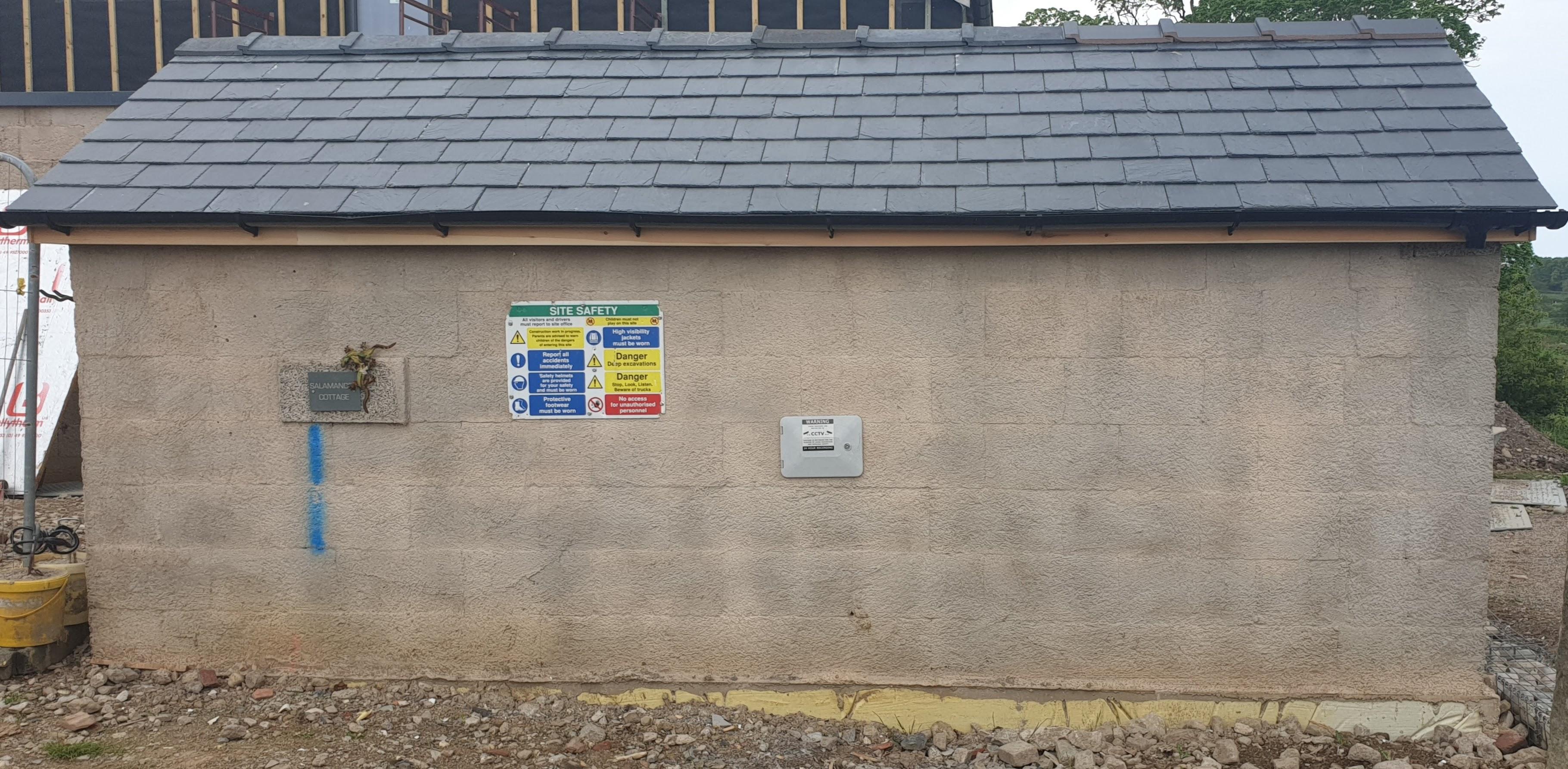

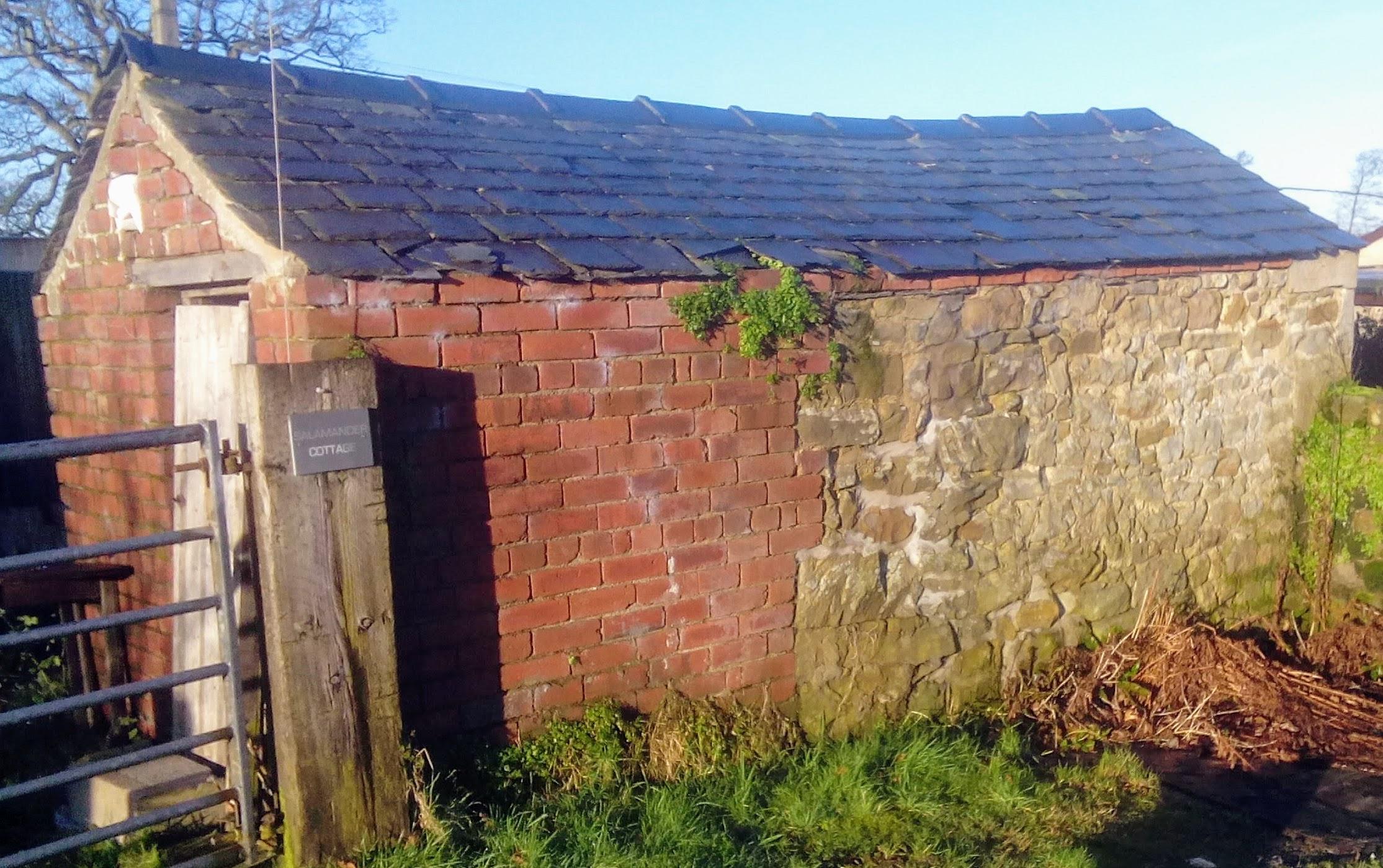

I want to have a go at copying the  ramshackle style of our old piggery with stone and brick slips. An ask too far?
I think it would be difficult to make it look convincing. Think i'd just go for one or the other and plant some climbing plants..
Yes, I was wondering how to camouflage the 'join': maybe some plastic (?) ferns or run some ivy up the wall......
Have you finished the rest of the house?  bored?  if so I could find some jobs to keep you going.......
What you could have done is get an amateur / blind bricky to build a 2nd skin from the old bricks alongside your new block wall - extend the width of the building slightly but you would prob get the same effect!
 but the thing is there's only about 50 mm of space on the edge of the foundation - just visible above the yellow radon barrier. So it'll have to be slips, I think.
Just now, PeterW said:
... what was the "agreed" finish for planning purposes..??
brick and stone.    ?

Have you still got the old bricks / stones?
Yep. All neatly stacked like you told me.....

Could you fit a diamond saw to a cheap table saw. Then saw the existing bricks in half.
My large angle grinder cuts through most things with the cheap diamond blade in it.
3 hours ago, AnonymousBosch said:
1308902433_IMG_20160210_091346(1).thumb.jpg.39bf719a314fe602867f0868ea759b25.jpg20200503_123133.thumb.jpg.3bdbf044cec6e150952e15c4c206902b.jpg< Then
Now>
Set makers in the film industry could do that
Im fairly certain the hole in the middle will be the wrong size. I had a lot of trouble trying to enlarge the hole on one to get it to fit my skill saw. Ended up using a plasma cutter iirc
Good point. May check when I get home.
8 minutes ago, AnonymousBosch said:
I can hire one.....
Hire a wet bench instead.
Will make short work of the bricks too - and could get them all uniform in thickness.
Stone will take some practice and may need to flip them over as some look pretty big, but all do-able...
