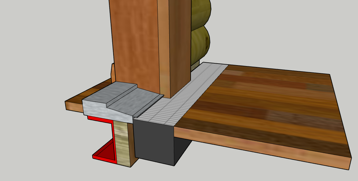

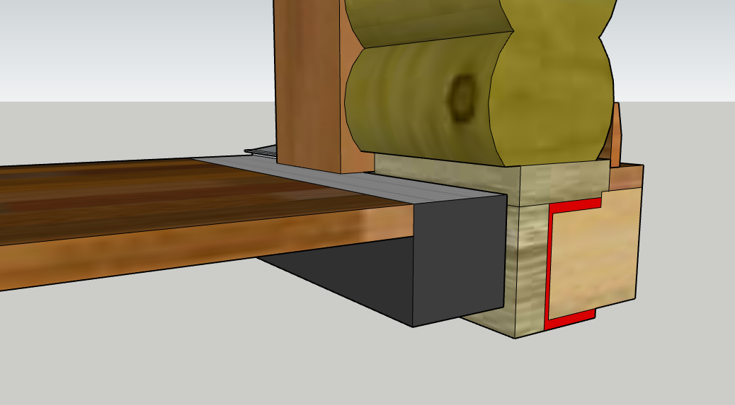

iSelfBuild Posted June 6, 2020 Author Posted June 6, 2020 I feel more comfortable visualising this now. There is a 30mm drop from the log underside to the channel drain. There is a 15mm step up onto the threshold from inside floor level then a 10mm step down onto the channel drain off the threshold. I'm pretty sure this meets the regulations. I was looking at some other speciality disabled accommodation and they really have gone the full hog with grab handles all over, wet rooms etc, hoists into beds etc. Basically fully fitted out which is very impressive and commendable. It was never my intention to go to this level of 'disabled friendliness' and I don't want to for this dwelling for various reasons, I'm going to speak to the listing company I intend to use and see what they actually require. The tick box is 'wheelchair access' - https://www.cottages.com/scotland/dumfries-and-galloway?fshow=1&features=6734 Looking at the competition I think they are just making sure the entrance door is level and that's about it. 1

Temp Posted June 7, 2020 Posted June 7, 2020 Can you elaborate? Why is it so expensive? We were required to provide a level entry by the building regs. Love it now. So much easier when you want to get something like a washing machine in on a trolley. I reckon the mistake people make is to build a house and then worry they have to add a ramp. Just design it level in the first place.
