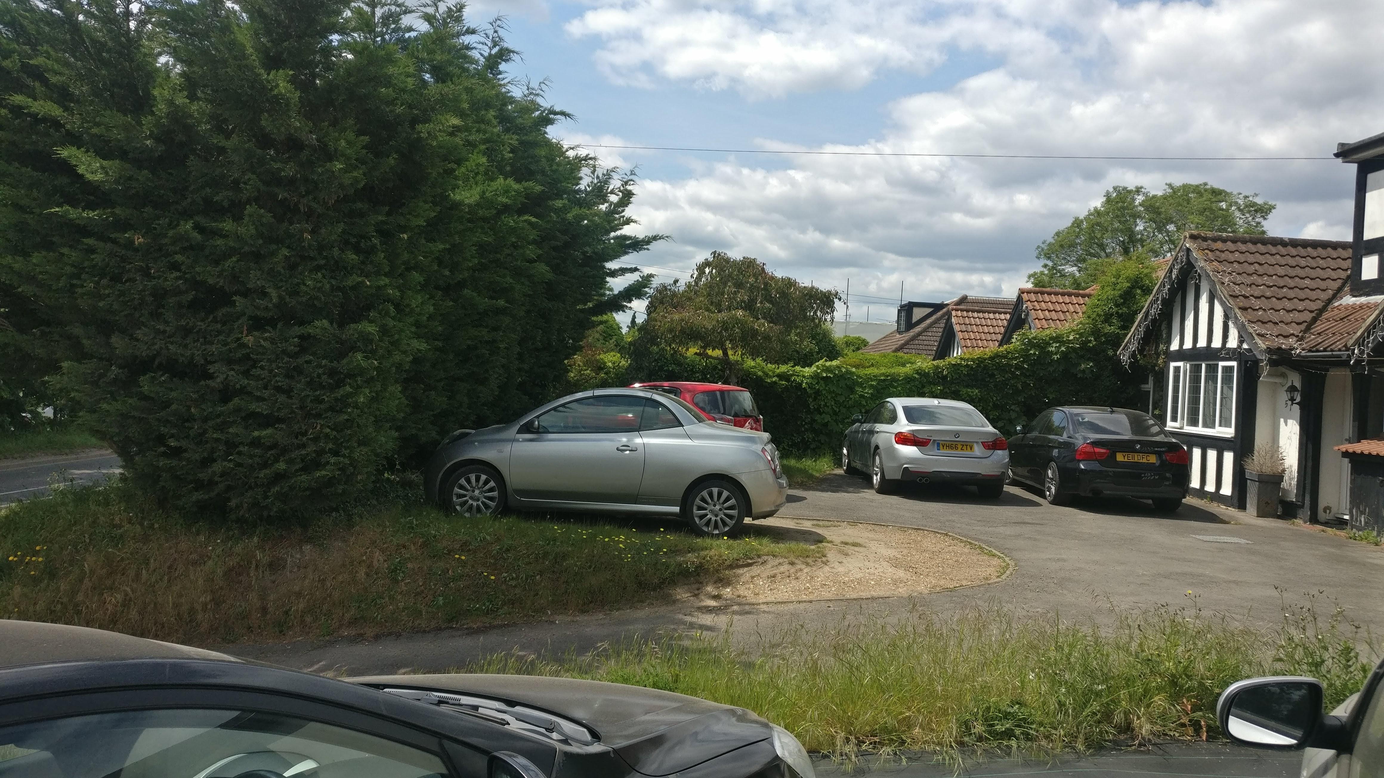

Zeffo77 Posted May 31, 2020 Posted May 31, 2020 Hi I am going to build a 2-tier retaining wall for my driveway. 8m in length. The higher tier will be 1.1m. The lower tier will be 600mm. I am looking into drainage behind each wall and it looks like a french drain is my best option. But I do not know where to outlet the water. I cannot let it come out onto the pavement so could someone please advise on what I should do. I have attached a picture of my drive currently. Thanks.

Temp Posted May 31, 2020 Posted May 31, 2020 What's under the sheets? Looks like you have weed suppression sheets down. If you want to level and pave or tarmac the front you should probably put a soakaway under it first. These days if you don't deal with rainwater run off on site you will need to make a planning application.

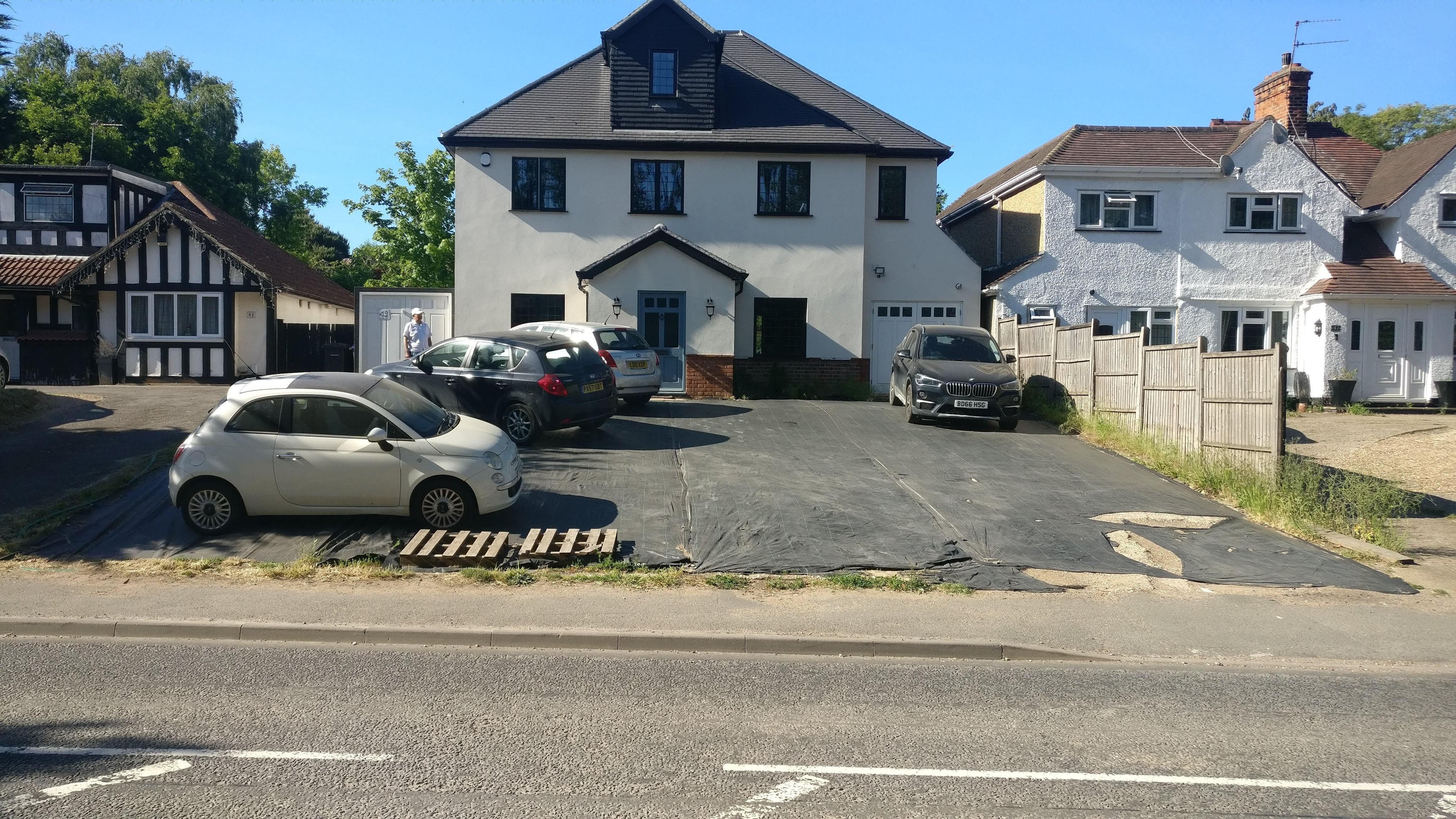

Zeffo77 Posted May 31, 2020 Author Posted May 31, 2020 We want to level out the driveway for 2 reasons. 1. My parents live with me and it's getting harder for them to navigate the slope. 2. Kerb appeal. It looks unfinished at the moment. When I bought the house it was similar to my neighbors drive (image attached). We cleared it all thinking it would be better with an entrance/exit in the middle. That isn't the case anymore so want to have the driveway level in line with the front door height, 1.1metres.

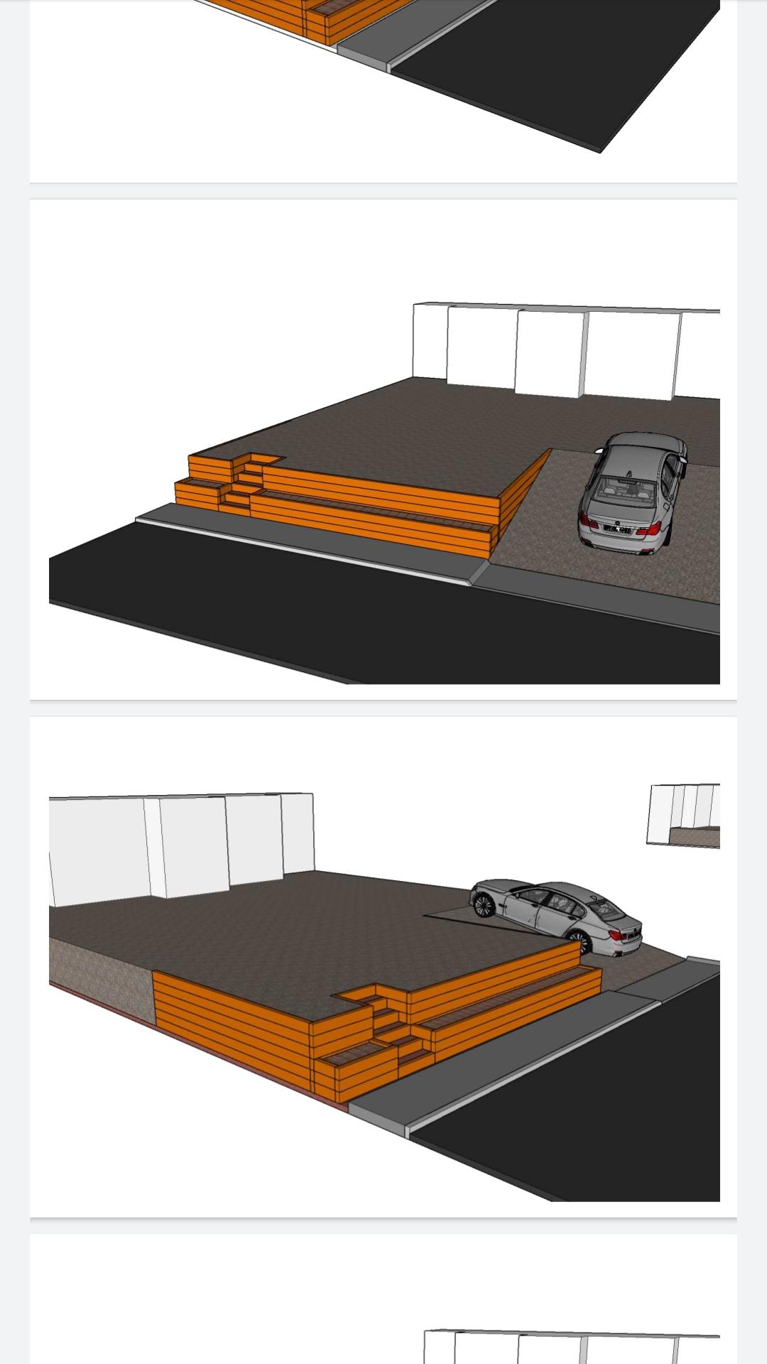

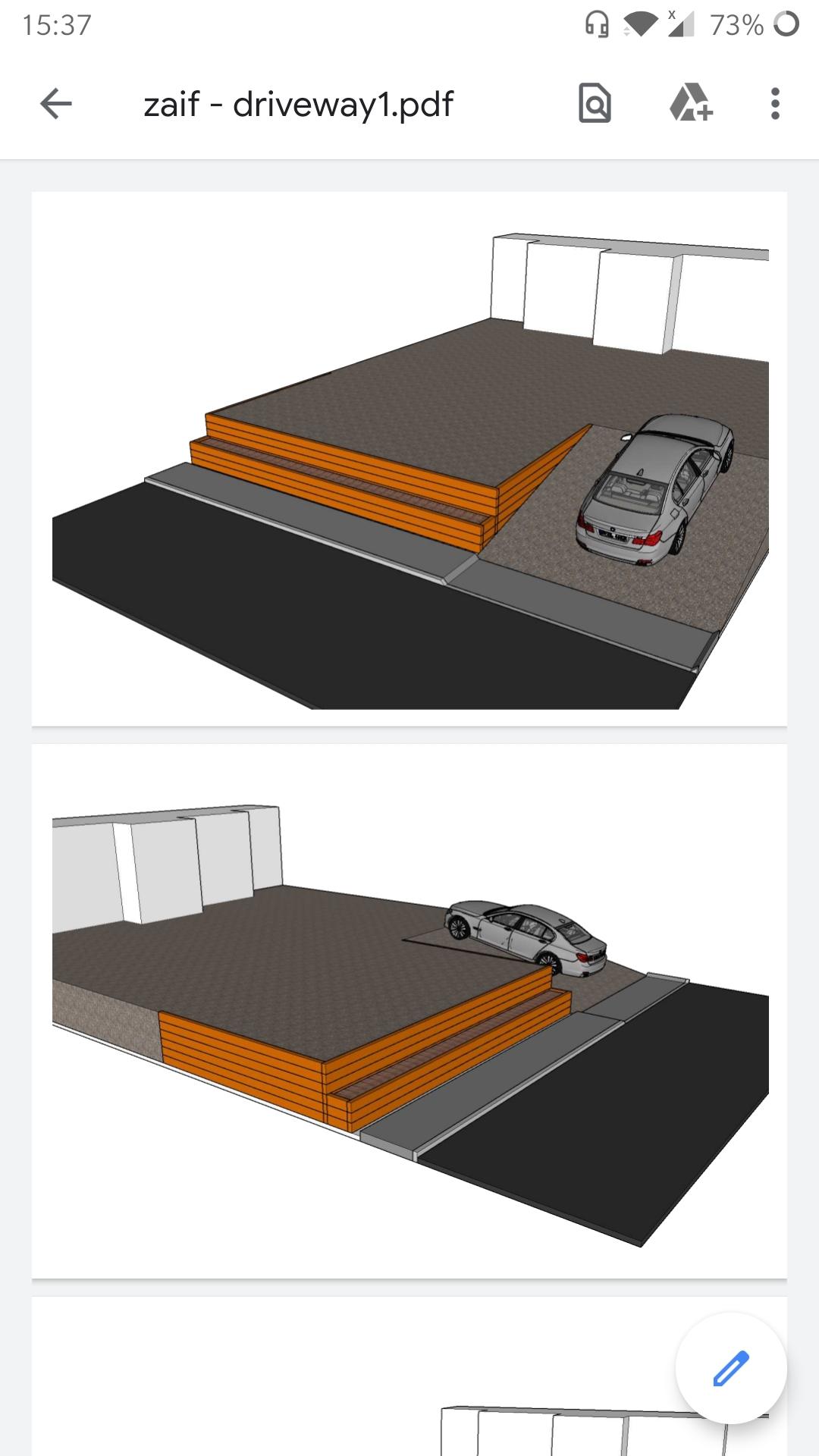

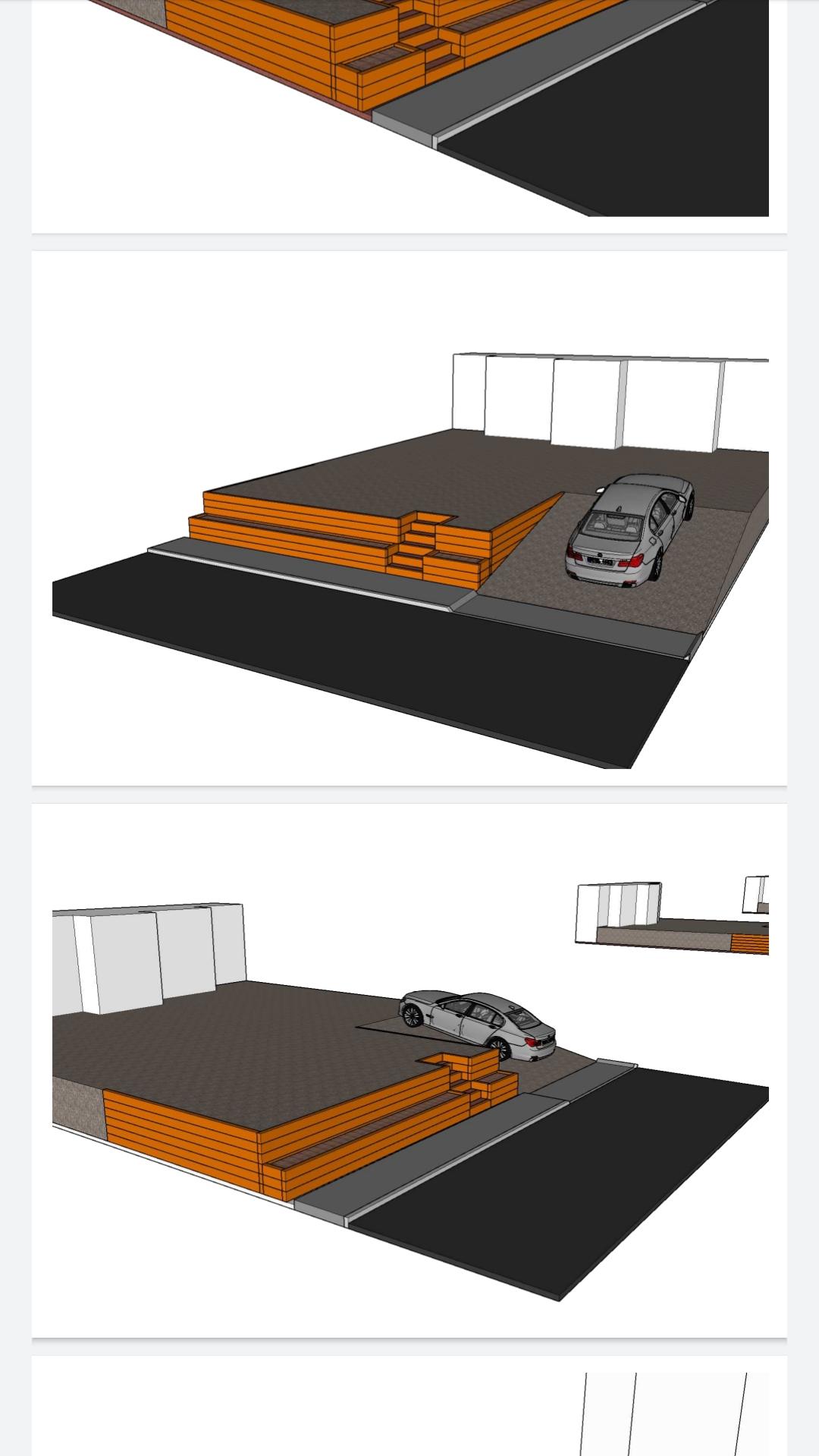

Zeffo77 Posted June 3, 2020 Author Posted June 3, 2020 (edited) Hi all. Please find designs attached. We are leaning towards having the design with the stairs on the right hand side. If anyone can help with my original question regarding drainage, please do. The second wall, which is the highest, will be 1m so no need for planning permission. We plan to have gravel on the driveway. Edited June 3, 2020 by Zeffo77 Adding extra info
tonyshouse Posted June 3, 2020 Posted June 3, 2020 You will need foundations, let’s say 450 deep, concrete, and I think protective railings on each level, I would dig a soak away 3m back in the middle 2m deep and run land drains back to it that link to perforated pipes that run behind the bottom of each wall. how about Gabions, plonk em down, done, cheap, easy paving slab steps between two of the.
Mr Punter Posted June 3, 2020 Posted June 3, 2020 In your other thread you were looking at sleepers and I suggested this could be achieved fairly easily with no drainage issues.
