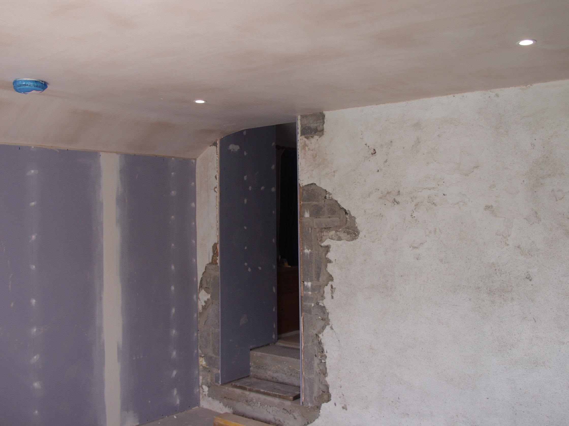

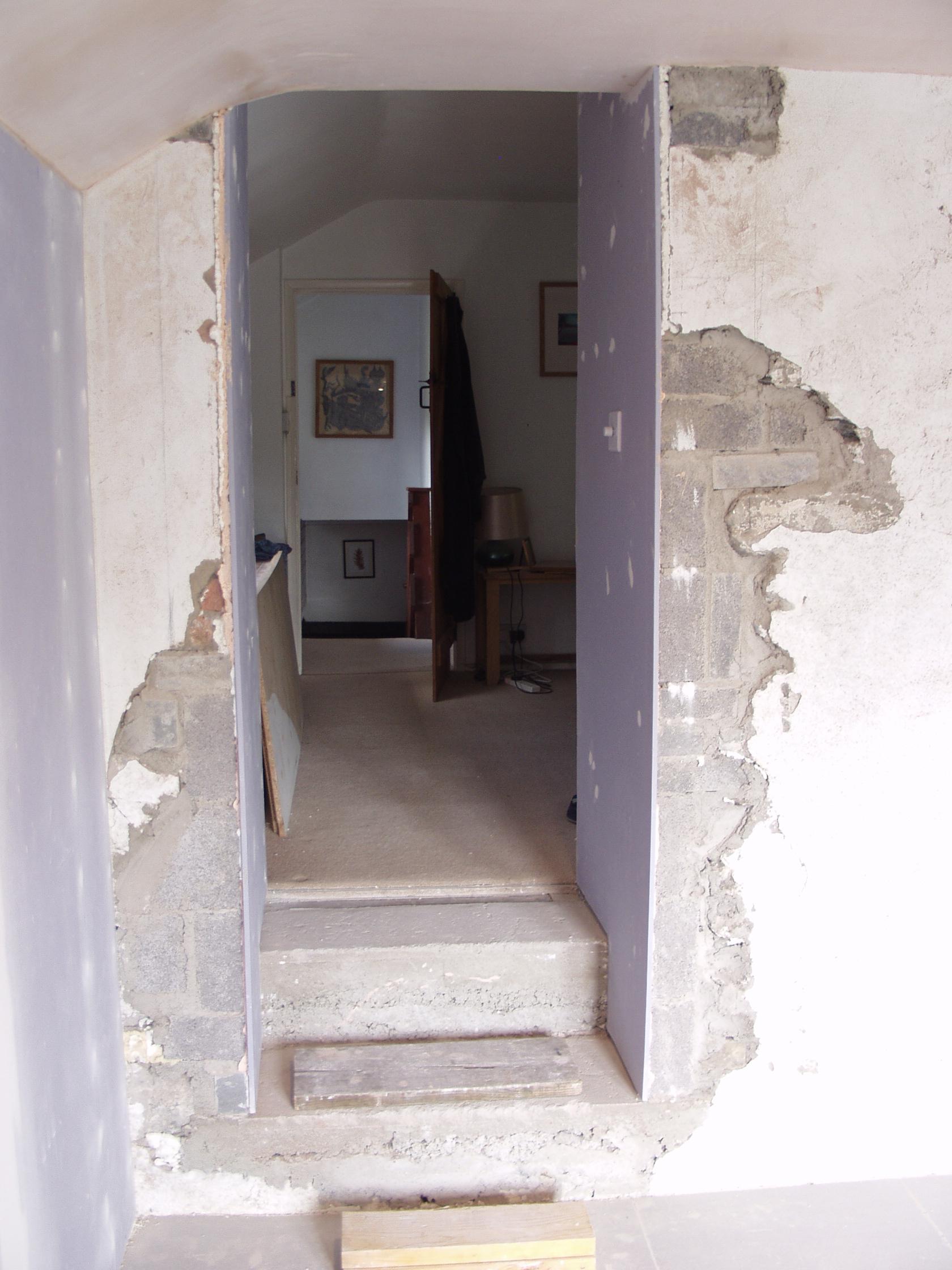

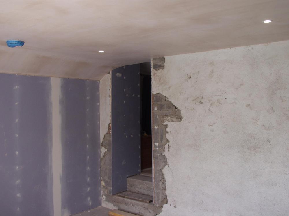

zoothorn Posted July 11, 2020 Author Posted July 11, 2020 My next big job, is to address these old wall areas. The knock-thru 'tunnel' Ive pB'd either side, leaves a good 1" depth to fill in deepest bits where the block is. My plasterererer (& spark) suggested I could perhaps use my 1/2+ bag of Thistle Bonding I got left for it. What do you think? I also got some multifinish left too.. but the old wall (white here) is a pretty rough surface of render + top coat of contoured paint. Last job is to tidy this wall up so I can get signed off & get the room useable/ not quite sure of options for this in the long run: it depends on the winter: if I get huge cold in from this wall (I expect as much).. I might have to consider lining it. But a next year job.

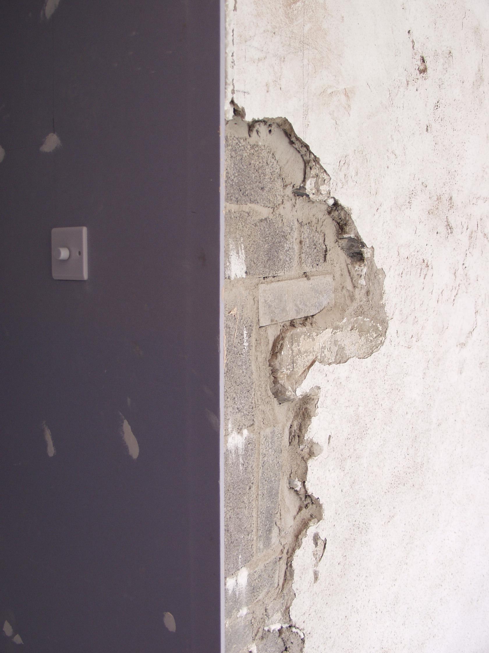

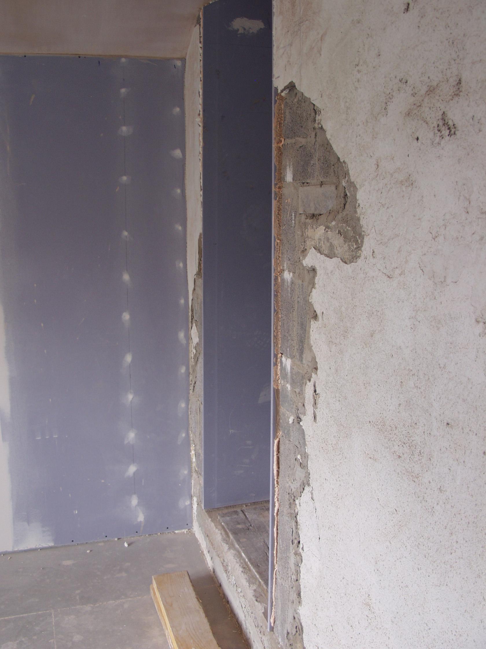

zoothorn Posted July 16, 2020 Author Posted July 16, 2020 Can anyone lend advice on tackling these damaged areas L & R of the knock-thru (esp deep ~1" or so on the R) ? thanks, zoot.
PeterW Posted July 16, 2020 Posted July 16, 2020 base coat of bonding plaster up to 10mm thick. Let it dry and add another. Then skim / texture a top coat over the top.
Onoff Posted July 16, 2020 Posted July 16, 2020 (edited) 5:1 pva the area, whilst still tacky get the bonding in there in a couple of layers. Leave a few mm under then multifinish. Edited July 16, 2020 by Onoff "pva" not "of a" ?
