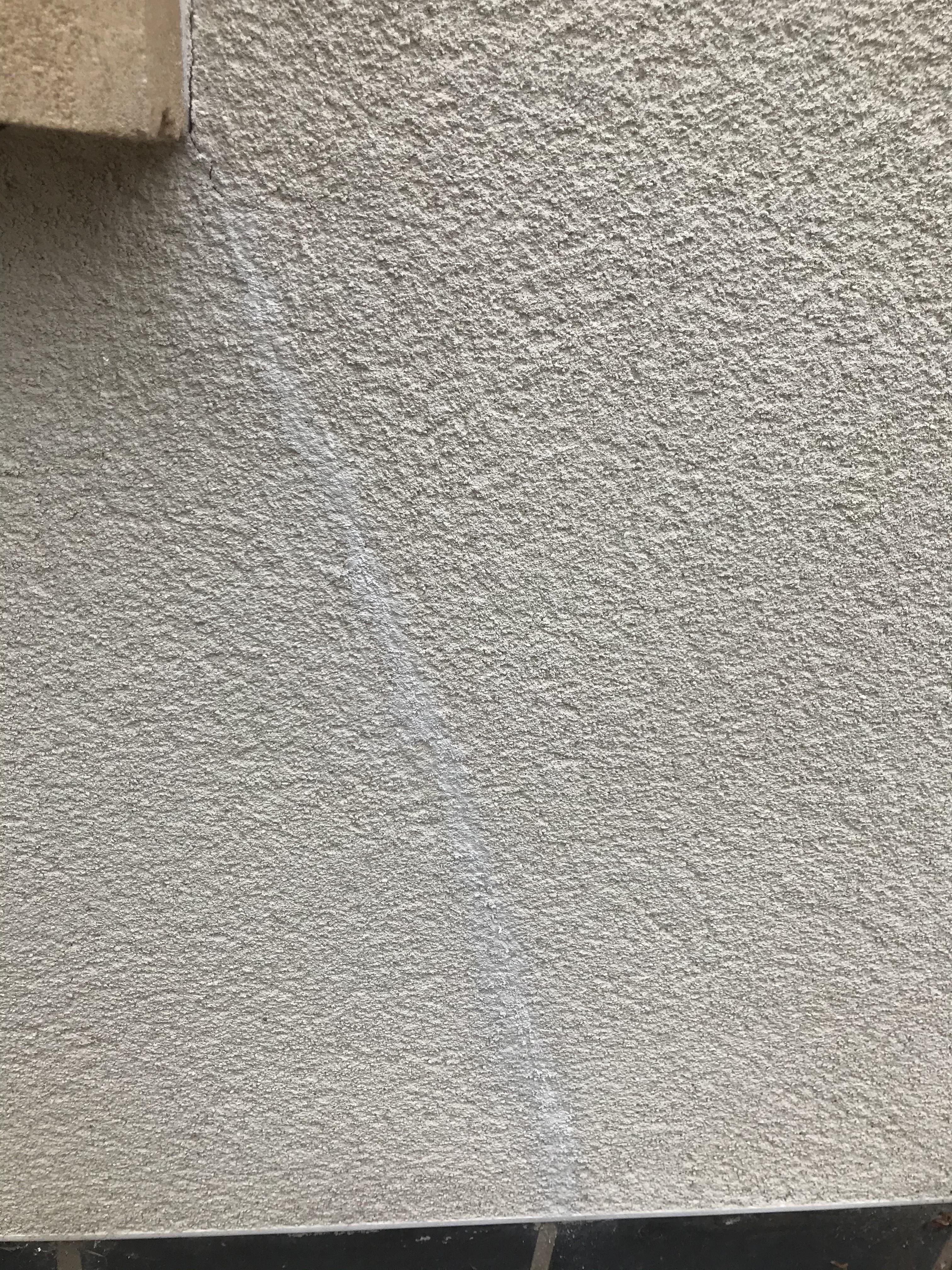

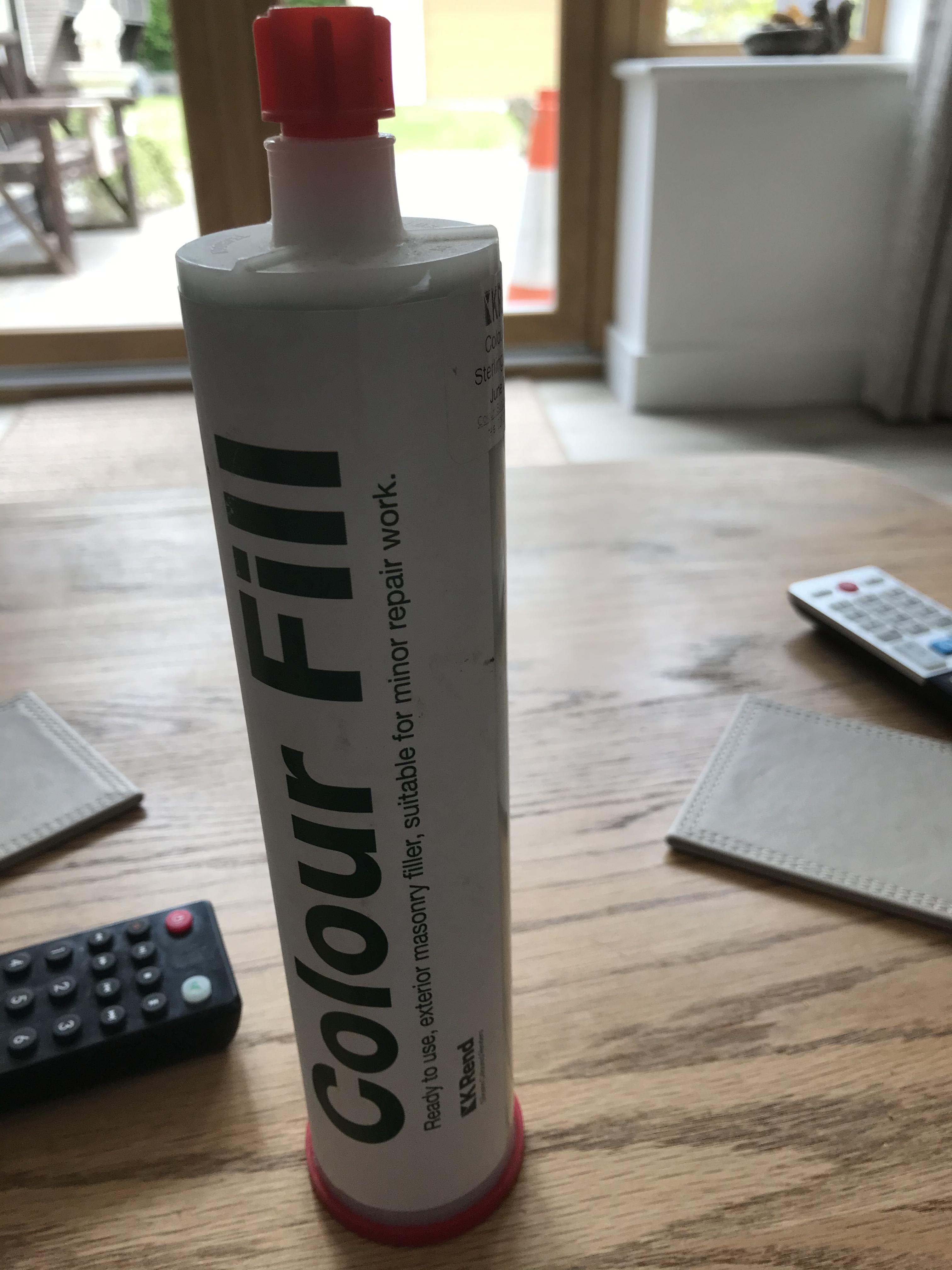

nod Posted May 23, 2020 Posted May 23, 2020 (edited) Someone asked about K rend crack repairs a couple of weeks back I thought this may help anyone panicking that the odd crack has appeared Pictured is a House we did about four years ago I’ve just called round and carried out two free of charge repairs I was there less than an hour including having a bacon butty and a brew The Colour matched tubes are Suplies free Of charge by K rend You can see from the photo how little is used Tge repair is usually invisible after a couple of weeks Just clean 600 either side with an anti algi solution a week before Then wash off Or the rain will do it for you Hope this is of interest to someone Edited May 23, 2020 by nod

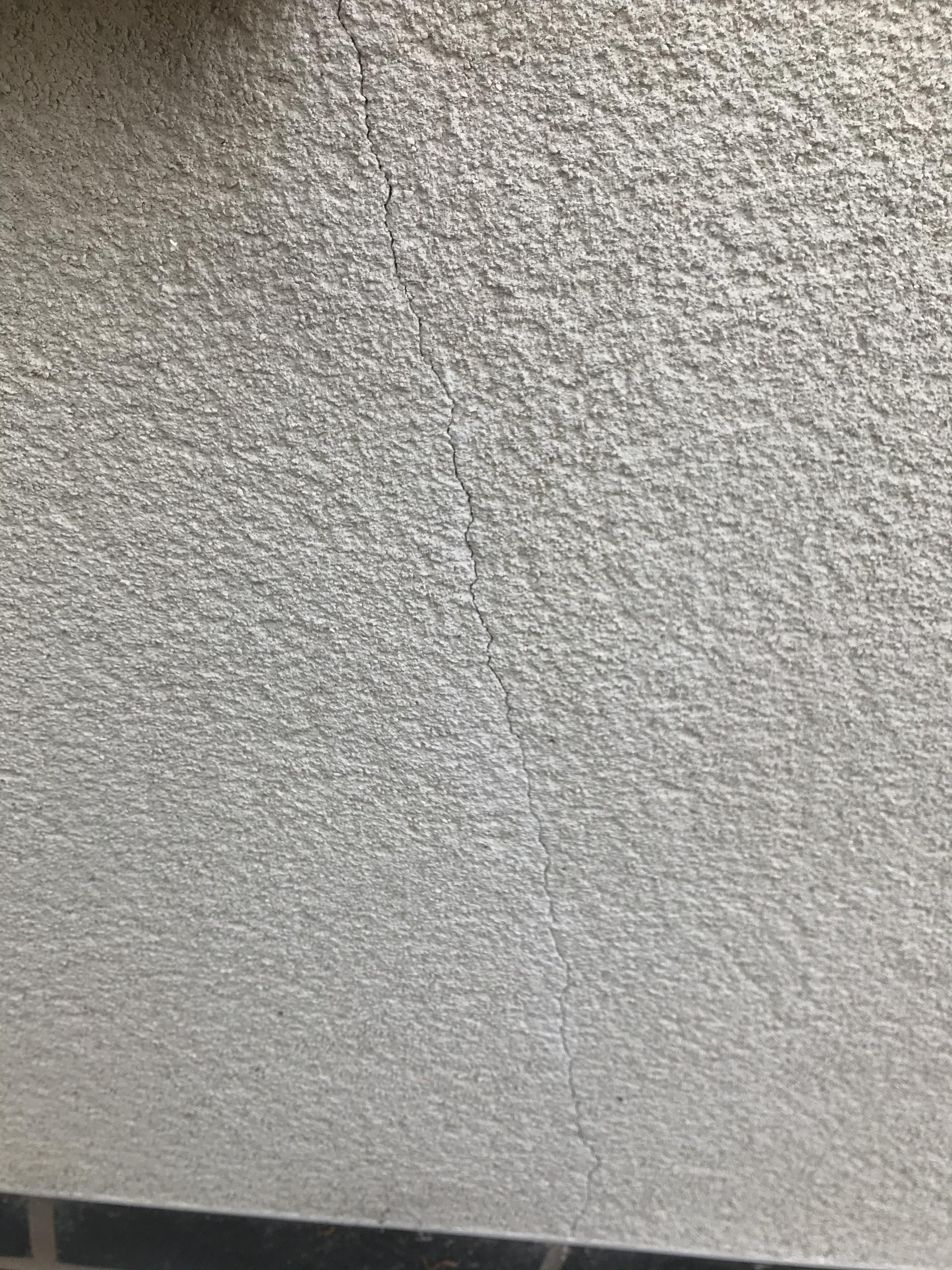

ProDave Posted May 23, 2020 Posted May 23, 2020 Did you get a close up of the crack before and after? What if it's more of a crack and a section is delaminating?
nod Posted May 23, 2020 Author Posted May 23, 2020 6 minutes ago, ProDave said: Did you get a close up of the crack before and after? What if it's more of a crack and a section is delaminating? If it more than hairline It has to be raked out into a V pretty Mick like a skimming crack filled within 5 mil Then filled proud the following day and carefully scraped flush If the render has been damaged badly we just cut a panel either side of say a window and pip a stop bead on K rend say if a repair is not noticeable from 3 mtrs It acceptable

nod Posted May 23, 2020 Author Posted May 23, 2020 2 hours ago, scottishjohn said: a surveyor looking at house if you want to sell it might think differently and assume its hiding something If its as obvious as in your picture after the repair. saying that minor cracking is normal has confirmed to me i won,t be using render as first choice Is it a problem cused by TF structures moving about or is just as bad on solid walls like blocks or ICF thats a bit like me trying to convince a s/h car buyer that the car is not scratched if you can,t see it from 3m back No the picture shows a new crack repair (Still wet ) If I was to k rend a wall next to it It would also look darker 3 day you will hardy see it It will be invisible within a week picture to follow
scottishjohn Posted May 23, 2020 Posted May 23, 2020 what is major cause of these types of cracks drying out too quick or house movement
nod Posted May 23, 2020 Author Posted May 23, 2020 We hardly get any cracks on Krend If it’s a high suction surface you need mesh and base coat These two cracks I think are just a little bit of settlement and are just cosmetic I’ll get them to send me a photo in a weeks time If there is a larger patch like removing a window There is a K paint But you have to cover the whole panel It more of a grout than paint

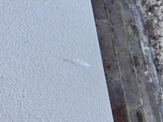

Billybob123 Posted June 7, 2021 Posted June 7, 2021 On 23/05/2020 at 17:04, nod said: No the picture shows a new crack repair (Still wet ) If I was to k rend a wall next to it It would also look darker 3 day you will hardy see it It will be invisible within a week picture to follow Hi there, did you ever get a picture of the repair after a couple of weeks? Scaffolder has put a rather deep scratch in ours and I’m curious to know the best option for repairing it. Whether using the colour infill you have or does it need cutting out deeper to then refill?
nod Posted June 7, 2021 Author Posted June 7, 2021 I didn’t But we repair loads Just-a case of being careful
Billybob123 Posted June 7, 2021 Posted June 7, 2021 1 hour ago, nod said: I didn’t But we repair loads Just-a case of being careful How would you repair this? Been on the wall for 2 weeks now. Would the krend colour fill be best or is my plasterer best cutting that out and putting fresh mix in as he tells me he has a spare bag of the same batch left. He doesn’t seem confident in the repair ☹️

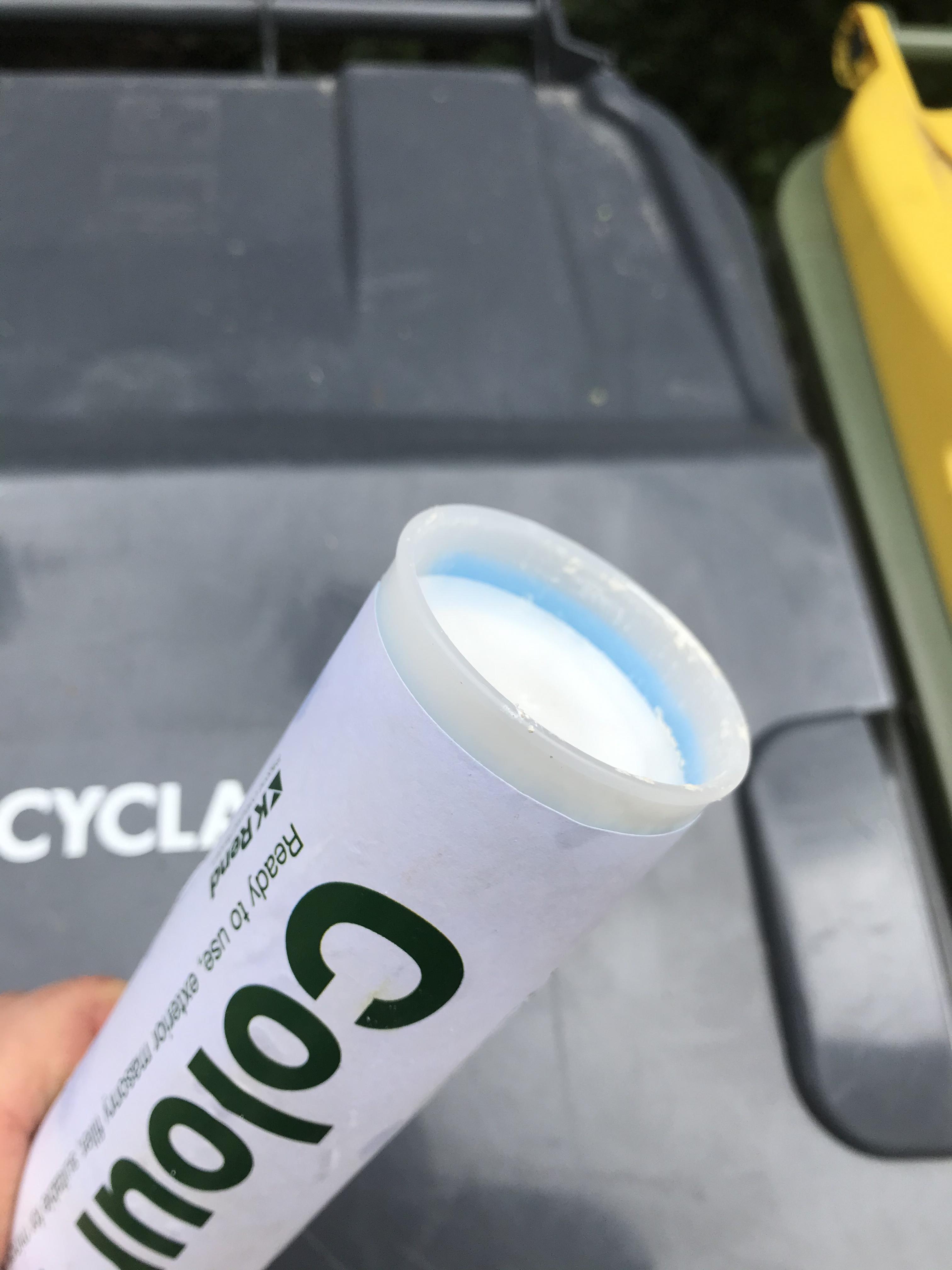

nod Posted June 7, 2021 Author Posted June 7, 2021 (edited) Easy fix get your render company to do it on there way home Tube of Free repair colour match from k Rend Hacksaw blade the following morning Edited June 7, 2021 by nod
