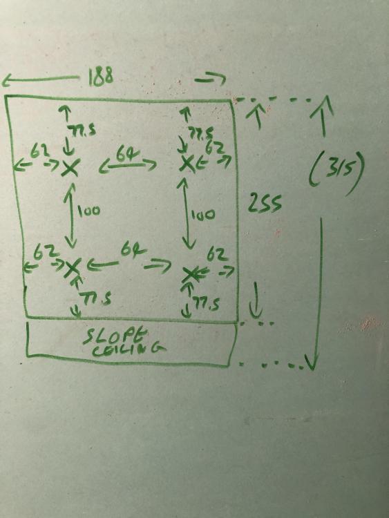

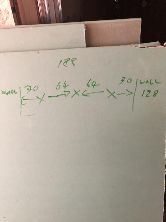

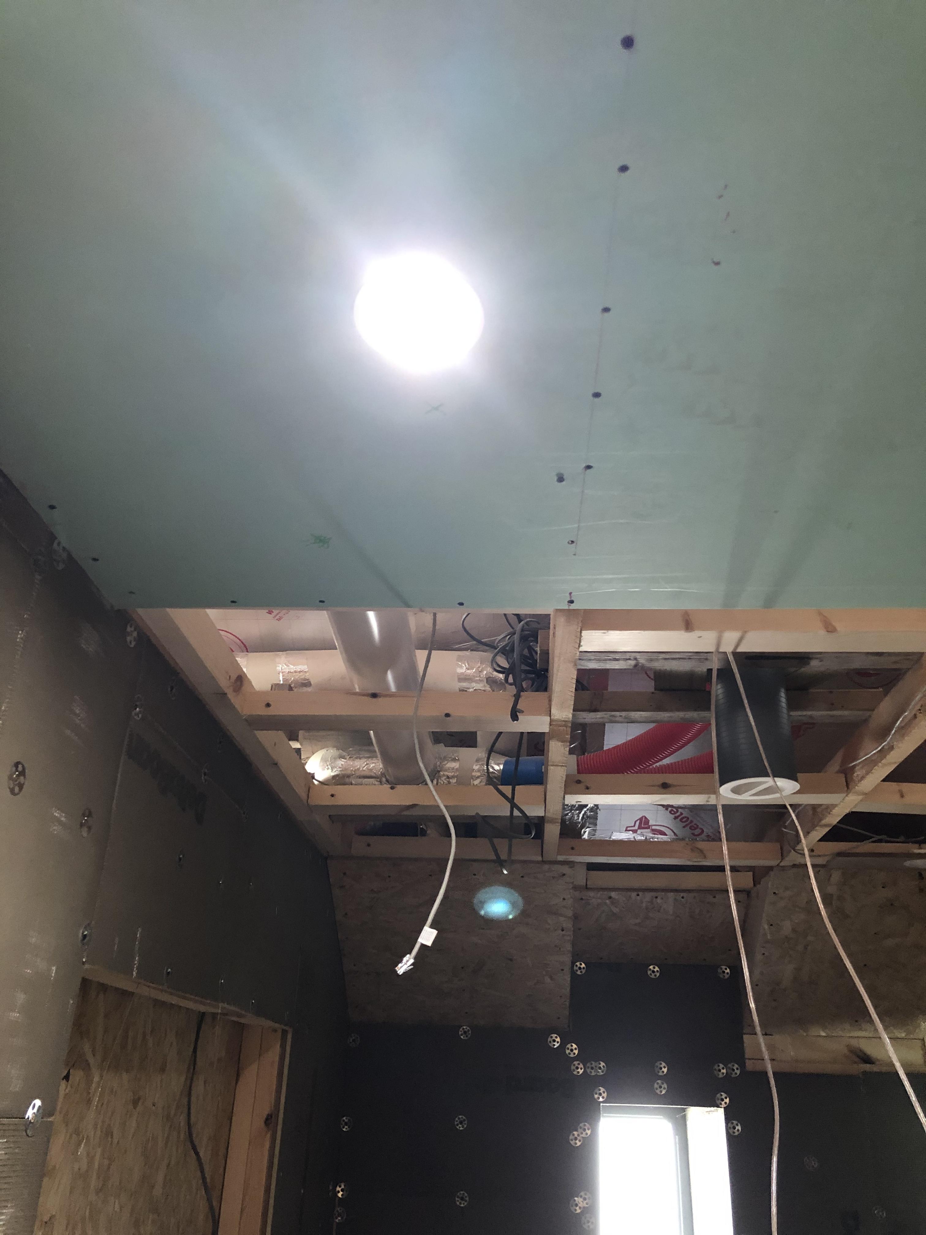

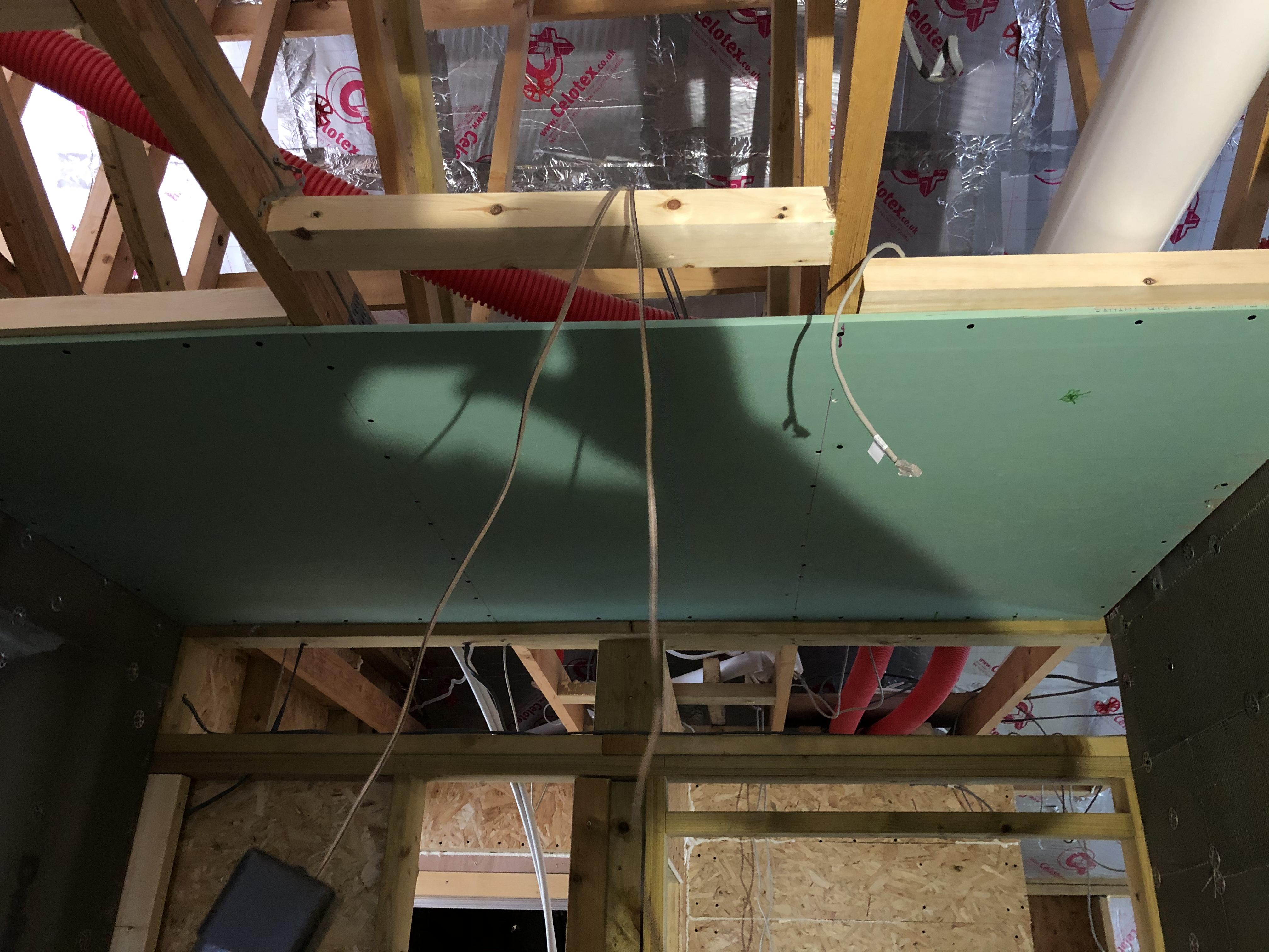

Pocster Posted May 18, 2020 Posted May 18, 2020 So ! I’ve got the first sheet of plaster board up . Bathroom width is 1.88m My plan was to have 3 rows of lights - 1 metre apart from each row ( approx 4 rows ) .Not sure if this is best ? My question though is what distance should a recessed light be from a wall ? 30cm ?? cheers

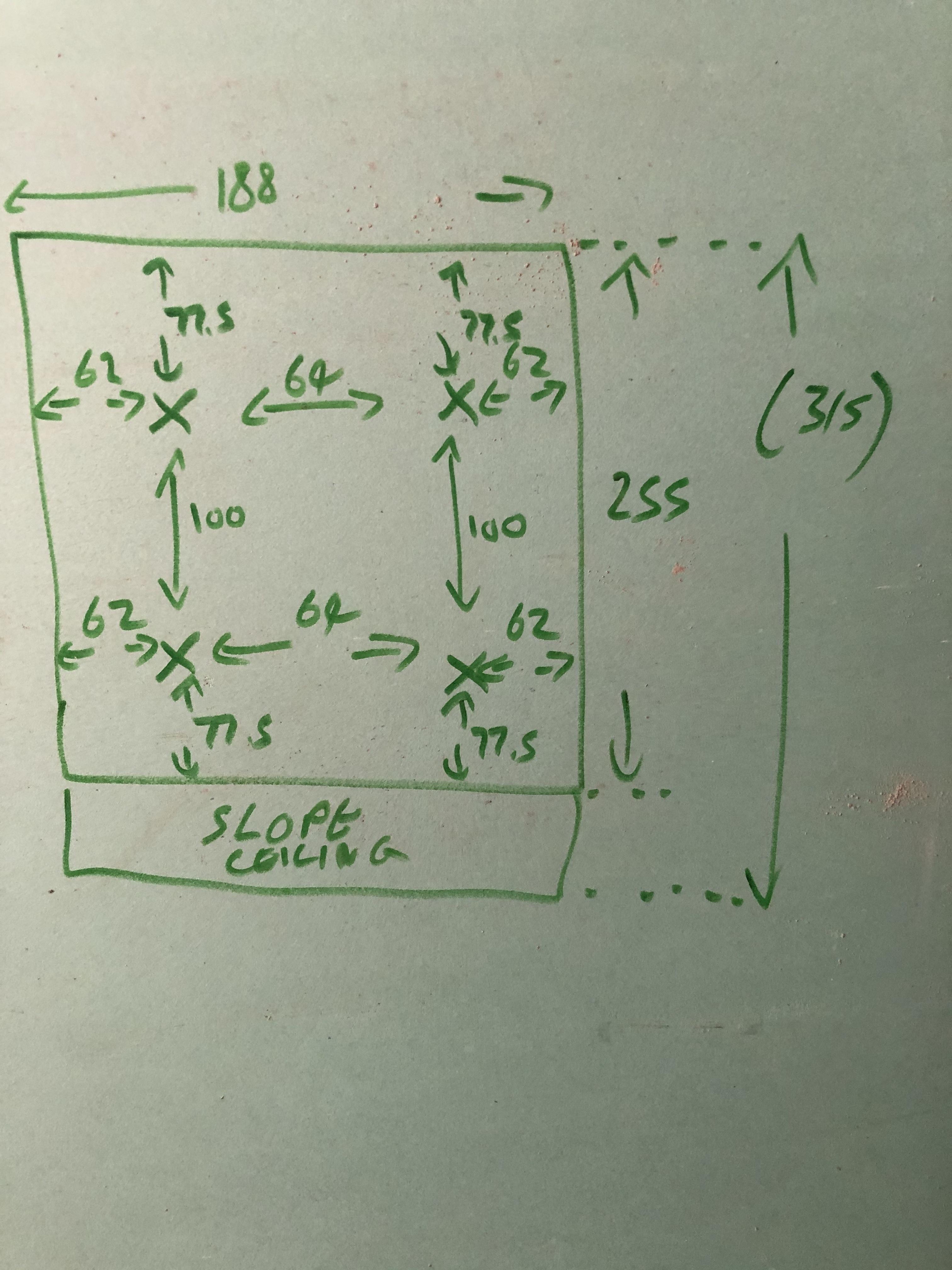

Pocster Posted May 18, 2020 Author Posted May 18, 2020 I think 3 lights in a row is too much Bathroom width 1.8mm Length 3.15m ( but actually 2.55 ceiling ) Perhaps 2 per row and only 2 rows ? Should point out lights are dimmable ( as a collective bit individually) . Also can be tilted . This ??

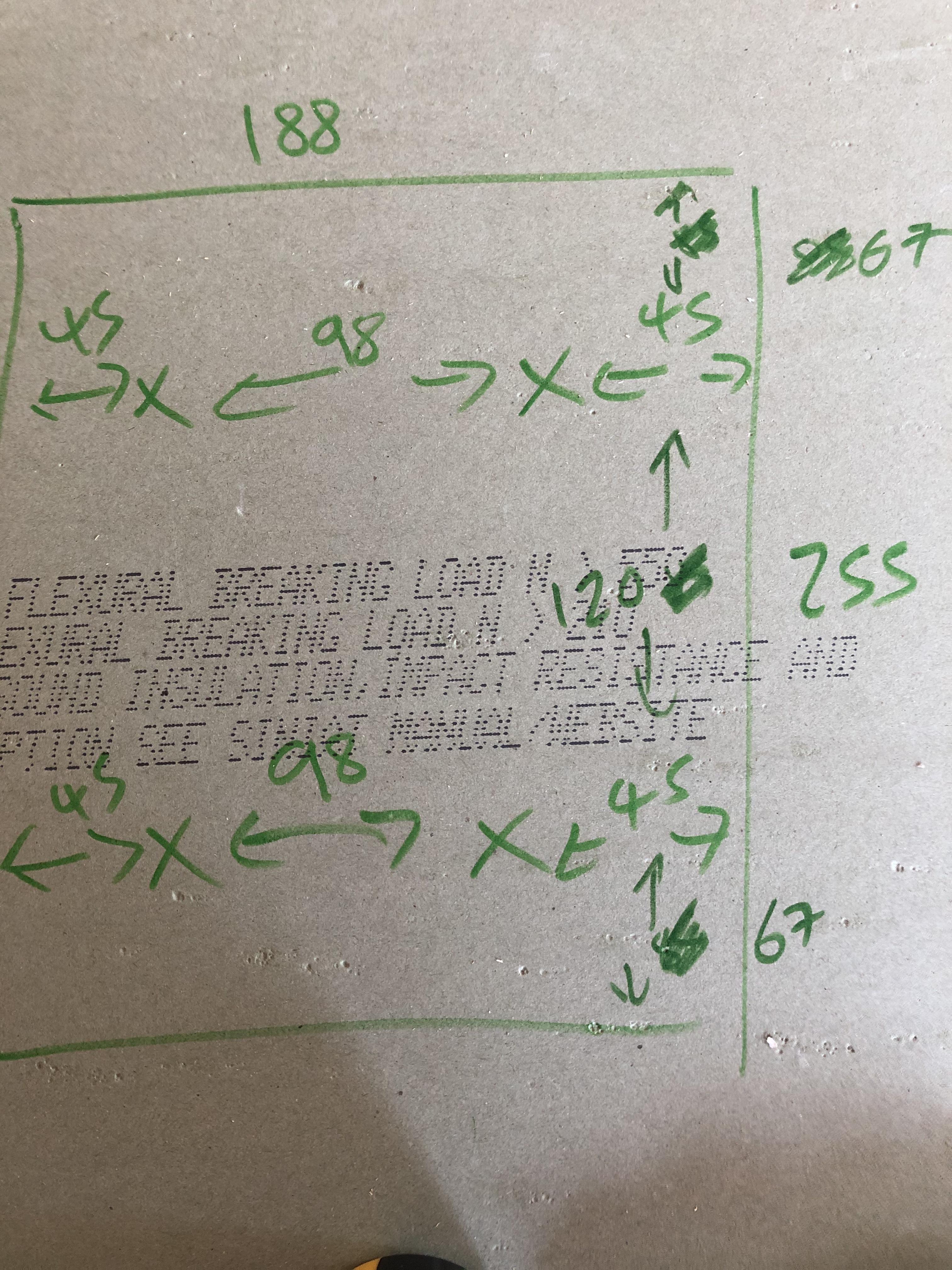

Pocster Posted May 18, 2020 Author Posted May 18, 2020 Hmmmm 62cm from wall puts me right in timber ! 45 cm seems safe .

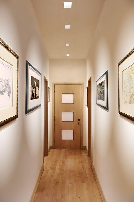

Carrerahill Posted May 18, 2020 Posted May 18, 2020 (edited) 45 minutes ago, pocster said: This ? It depends what you like/want. I like creating scallops of light down walls, I like creating interesting light, my attitude is an office should simply be lit whereas a home should be bathed in light. Light is a medium and lights are light artist tools of the trade. Look at the lighting in this hallway - it is subtle but very cleverly thought out. So you need to consider, the optics employed, colour temperature, sharp or soft cut off's etc. Also bear in mind, that when lighting a space, you must consider what your eyes are going to be looking at, no point in having the floor of a room lit highly yet the walls are dark because that automatically makes the room feel dark. Some rooms benefit from the walls and task areas being lit but very little attention to general light. Restaurants are often lit like this - very low ambient level, but tables, bars and areas of importance picked out in light. You have only lifted the cover of this book! Edited May 18, 2020 by Carrerahill 1

Pocster Posted May 18, 2020 Author Posted May 18, 2020 Just now, gc100 said: I think lighting is THE most important aspect of the interior design of a house. So hard to get right. I read this to get me going and I learnt a fair bit https://www.amazon.co.uk/gp/product/B07FPX2Q66/ref=ppx_yo_dt_b_d_asin_title_o04?ie=UTF8&psc=1 My issue is I have no idea what will work, especially around if I have enough lighting/too much without actually experimenting in each room. That’s one of the reasons I choose dimmable and tiltable . Deliberately so I can compensate/adjust . I’m going with 4 ceilings lights . Based on @Onoff ‘s pic . It’s not a massive room so perhaps I was getting carried away !!

Onoff Posted May 18, 2020 Posted May 18, 2020 (edited) 8 hours ago, pocster said: What distance are your down lighters from the wall ? 475mm from the window wall to centre of the spot, body dryer, rainfall head. Then 575mm from the wall on the right, to account for the 100mm full length shelf. Room is 2.9m long tile to tile. Spots are: Enlite DE8/40 8W IP65 Fire rated Fixed Cool white 4000K Dimmable 60 degree angle Edited May 18, 2020 by Onoff 1
Temp Posted May 18, 2020 Posted May 18, 2020 Our bathroom has a sloping ceiling and triangular dormers which limited where we could put downlights. Electrician recommended a single line 55cm away from the wall that has the basin/mirror and shower against it. Actually works better than expected. Personally I prefer wide angle downlights (say >100 degrees) rather than narrow angle (typically 36 degrees). I feel the wider angle produces more even lighting and less shadows. If not too late put Zinsser paint on the ceiling (especially above the shower). After the problems we had I wouldn't use anything else now. Someone here recommended it to me. Fantastic stuff. 1
