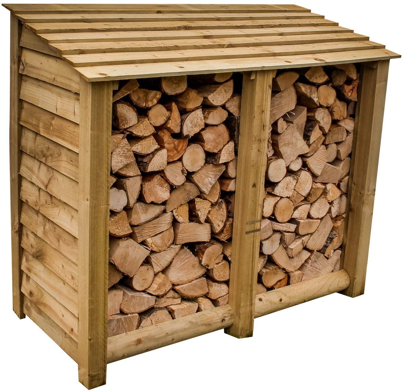

I used onduline on a chicken house. Works ok. How about lapped timber like this sort of thing..
Yeah I see all the read-made stores use planked roofs... I'm not convinced it's a good idea, especially at the size I'm aiming for. I'd expect it to warp/shrink and start letting in water. They look nice on the smaller stores, though.

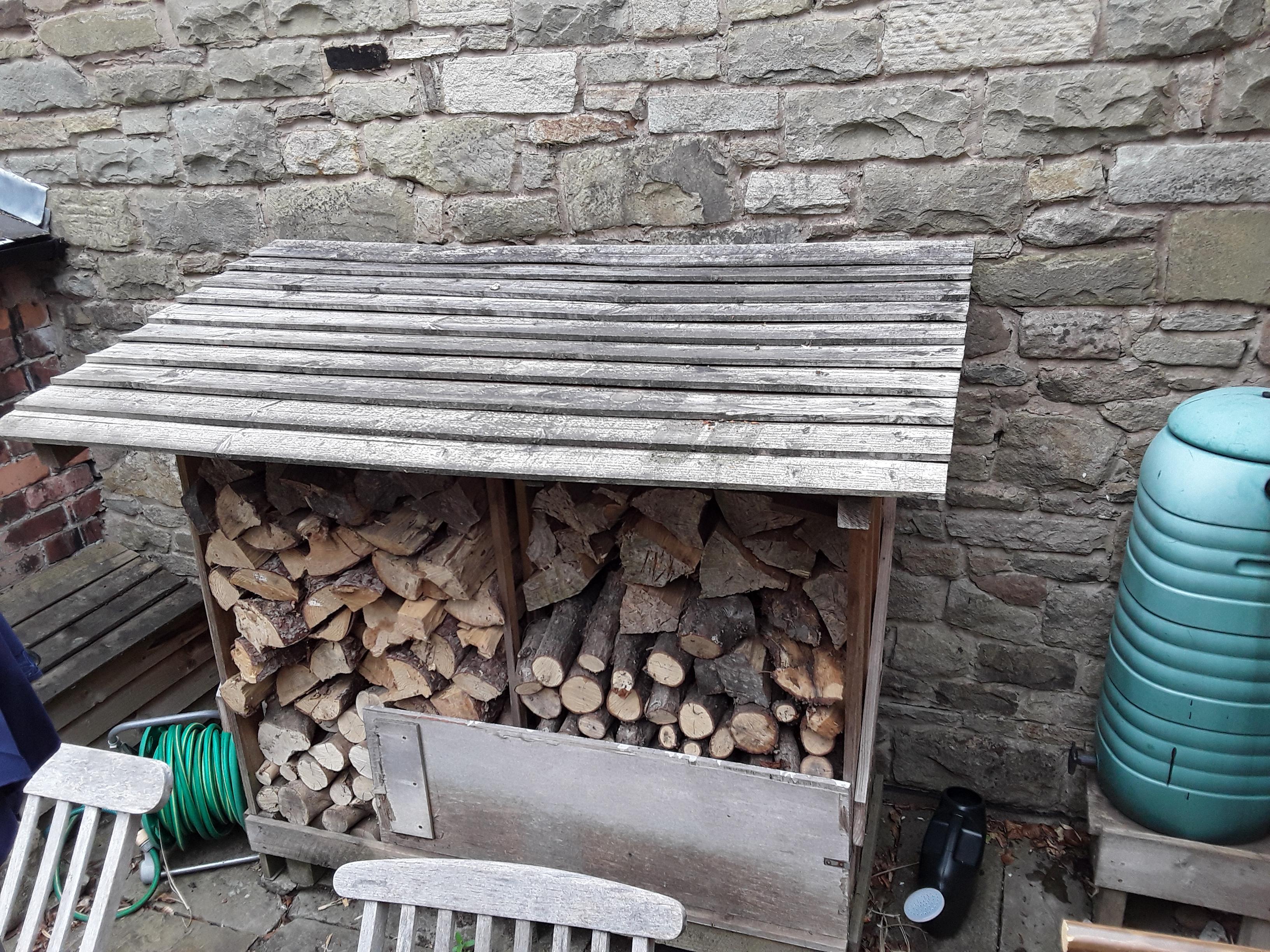

I made a planked roof for one of our stores about 5 and a half years ago. It leaked from the beginning, so I had to put a bit of DPM or something underneath. This is what it looks like now.  Bit different from Temp's picture! (The plywood's there because there's too much splashback at one end)
