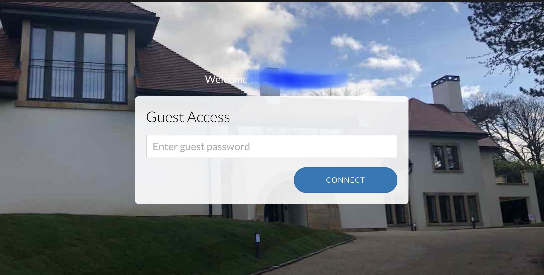

MrSniff Posted May 11, 2020 Posted May 11, 2020 The Unifi app (iOS in my case) was fine for managing 3 APs without a key, which we did for a year or so. A key does make management easier and enables some additional functionality like guest access, so we do have one hooked up now. 1
AliG Posted May 11, 2020 Posted May 11, 2020 I believe that they work without they key. Our Ubiquiti PoE switch broke after less than 2 years and I replaced it with a much cheaper and smaller Netgear switch. The Key cannot see the switch, but there is very little benefit to being able to manage the switch via the app, everything such as guest access works just fine still. Apparently the built in power supply in the Unifi switches is a known point of failure, the Netgear has a separate PSU. 1
vfrdave Posted May 11, 2020 Posted May 11, 2020 All works fine without the key just hooked up to a Cisco switch. The key may have some additional features but guest access can be set up without it I believe. What the key gives you is remote access for management.
AliG Posted May 11, 2020 Posted May 11, 2020 I used the Key to do this for guest access which I thought was pretty nifty
