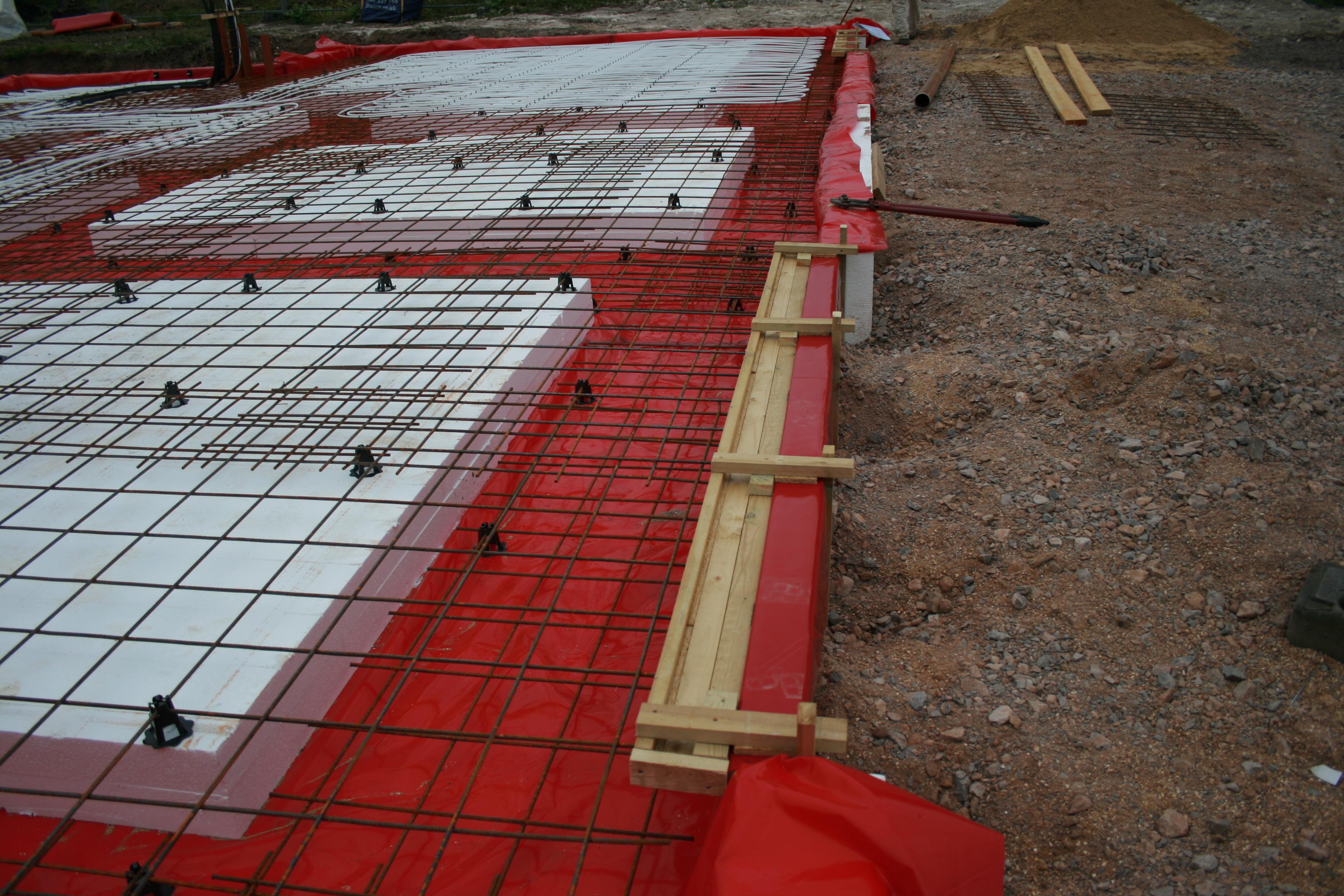

Russdl Posted April 29, 2020 Posted April 29, 2020 @SuperJohnG It really is worth giving your flooring and threshold heights significant thought before committing. We knew all along that we would have tiles by the kitchen sliding door, back and front doors and carpet by the living room sliding door. What I’d failed to spot on the final drawings was that all the thresholds were shown as 30mm above the slab. We were after exactly what you’re after, a level transition from inside to out and 30mm is too much to achieve that with tiles. To achieve what we wanted has cost a fair few £££ in self leveling compound, way more than if the thresholds had been, say, 20mm above the slab. (We have a raft foundation and the levels are pretty accurate throughout)

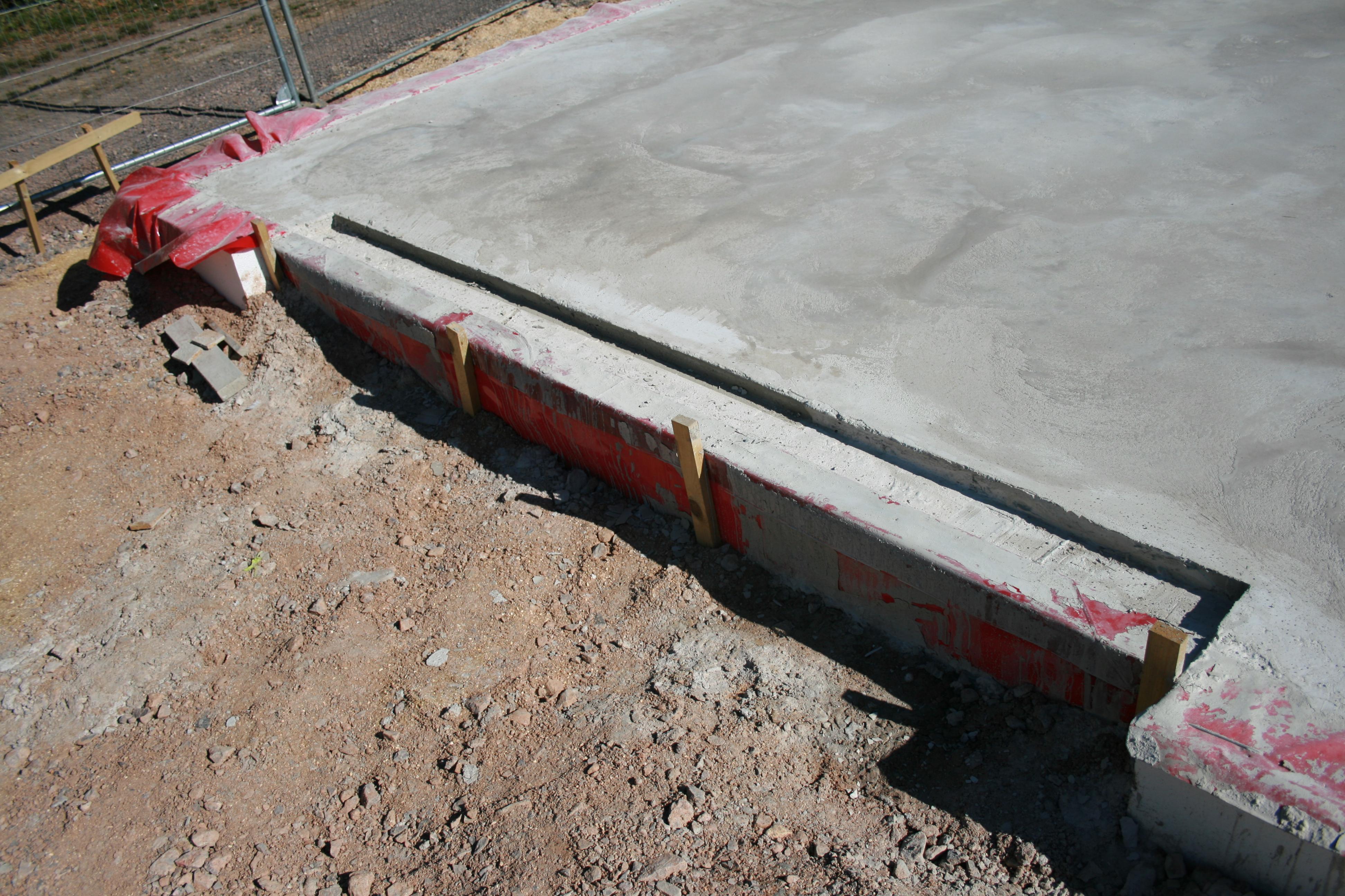

Russdl Posted April 30, 2020 Posted April 30, 2020 @SuperJohnG The thresholds of our doors were of various depths, 3 of them significantly deeper than 30mm. Prior to the slab being poured wooden formers were made to provide the required depth in the finished concrete to ensure that once the doors were dropped into these depressions then the threshold would be 30mm above the finished floor level. Which was too high. It would have been incredible simple and free to make those depressions 10-15mm deeper, not doing so cost hundreds of pounds. Twas my fault, I didn't check the drawings closely enough until I saw the problem, by then it was way too late. 1

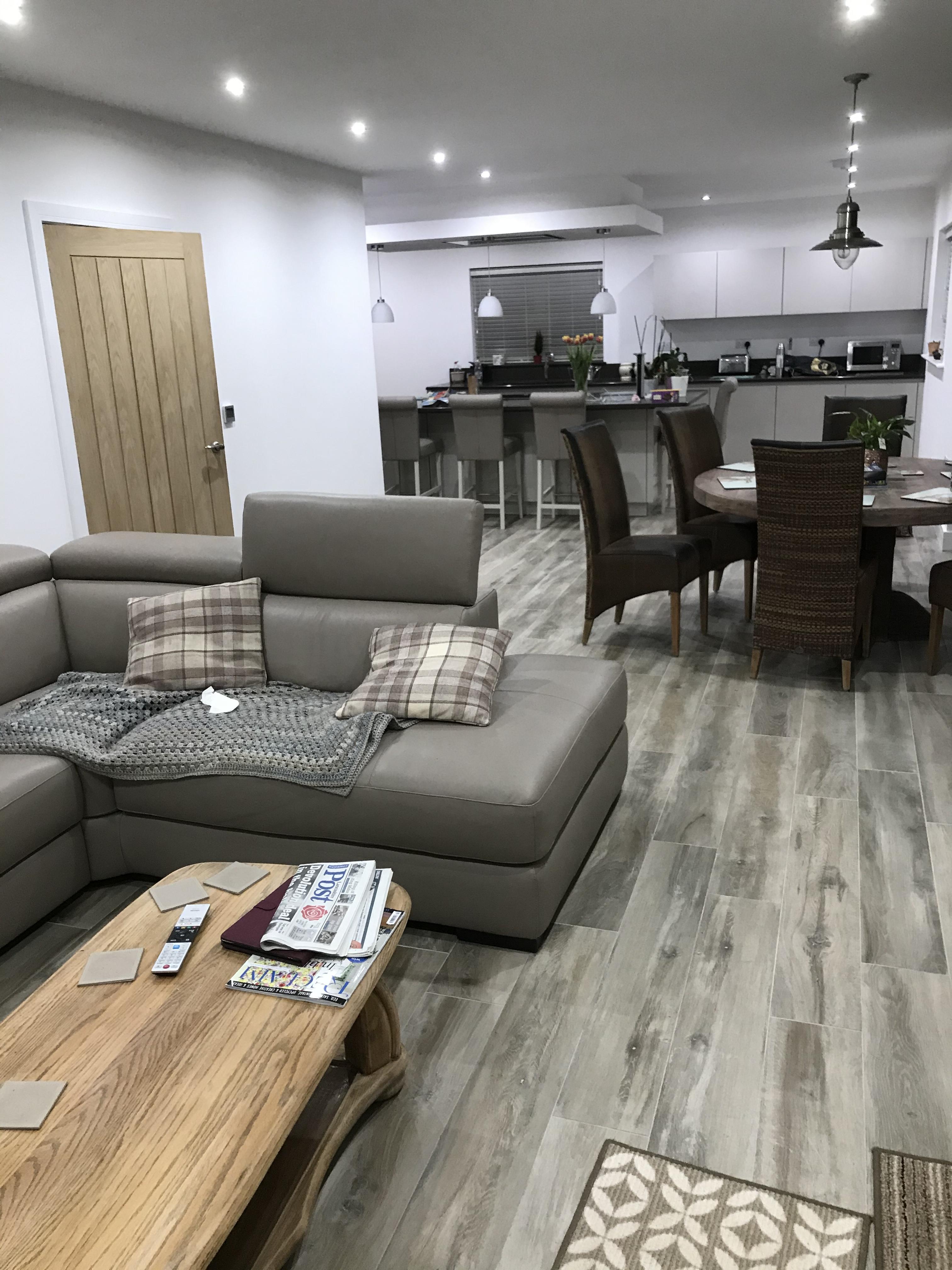

nod Posted April 30, 2020 Posted April 30, 2020 Back at the old house it would have been to cold At the new house we have 156 of Italian Porcelain Lovely under foot with UFH 1
