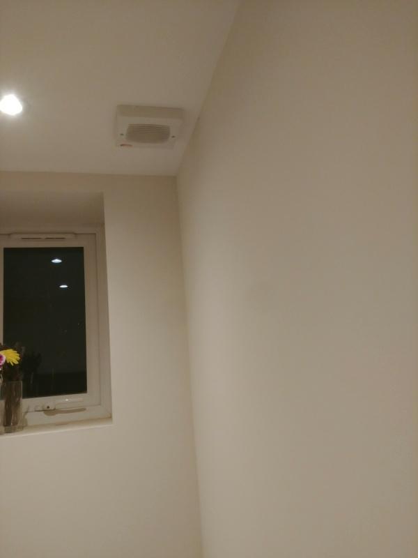

Roundtuit Posted April 28, 2020 Share Posted April 28, 2020 Sorry, don't want to be negative, but your pics look like you've got trickle vents in your windows. If that's the case, I'd have a serious rethink about whether you'll get a benefit from mvhr; there might be better ways to invest the money. Link to comment Share on other sites More sharing options...
bluebirdnick Posted April 29, 2020 Author Share Posted April 29, 2020 15 minutes ago, Roundtuit said: Sorry, don't want to be negative, but your pics look like you've got trickle vents in your windows. If that's the case, I'd have a serious rethink about whether you'll get a benefit from mvhr; there might be better ways to invest the money. Good spot. Yes we have trickle vents in 3 places. The one you can see here (the WC downstairs); the back bedroom; and the kitchen bifolds. The WC window you can see here will be removed and blocked up shortly anyway (we have extended on that side of the house so it opens up into the side extension. And I will seal up the bedroom and kitchen ones when I am fitting the unit. However the general point you make is one I have been grappling with. A 1930s house is far from airtight. We have done a lot to improve things since we bought it, not really with airtightness in mind but nevertheless helpful. For example, I ply-lined the suspended timber floor downstairs, taping joints and refitting skirting boards; replaced all doors and windows; wet plastered every wall, and overboarded and skimmed every ceiling; blocked up chimneys and replaced the roof. We have also extended on two sides (wet plastered walls with the exception of one); and rendered most of the outside walls. But there will still be loads of places for air to move around - I have done nothing about sockets, light fittings, letterboxes etc. So yeah - I accept that to make the HR part work I have quite a bit to do and even then it may be futile, but I still want a system that takes stale, moist air out of wet rooms and puts fresh air back into bedrooms and living rooms. The MV part is more important to me, any HR I get from it is a bonus! 1 Link to comment Share on other sites More sharing options...
