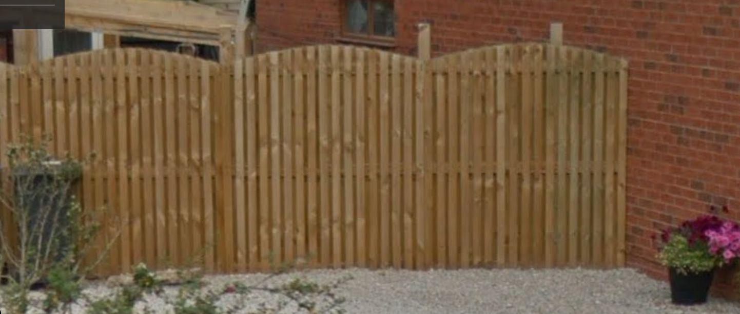

There is a conventional concrete post and wood panel fence between us and next door. Problem is that it’s only 3 foot high. I would like to have something taller at one end of the fence to give us a bit more privacy. I’ve marked the intended outline in red in the photo. This is approx. 6m long and 2m high.
The existing fence appears to be in the neighbours land and I’m not interested in the work of removing the old one and replacing. I’d just like to put something simple a little on our side of the boundary.
Simple being to use the existing wooden post one the left in the paved area and installing the posts (wooden or concrete) in the bed behind the small laurels. Filling with this style fence panel.
https://www.sheds.co.uk/hartwood-6-x-6-double-sided-slatted-pressure-treated-fence-panel.html

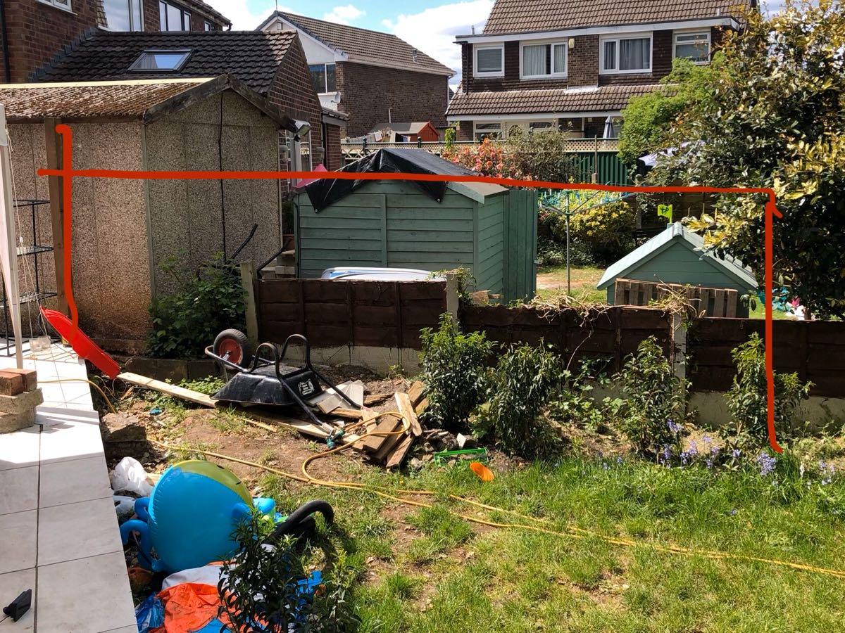

Cheers for the tips, obvs I got a level and other basic tools but only a laser for hanging pictures. I don’t think I’ve ever got anything straight or level but for this it really matters. I may even splash on a post level.

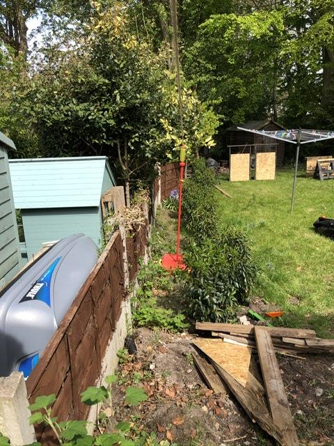

Before I order anything I’ve got to dig the post holes really. There are council slab retainers, tree stumps, roots and all sorts along there. It might be beyond me to start with.
In the photo, the swing ball is about where the end post would be and further down you can see where the fence kinks back into the boundary.

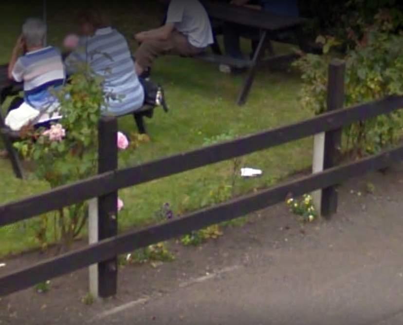

Remembering, just having been out in the garden and looking at them, you can use 1.2m fence repair spurs (they come with bolt holes) and bolt wooden posts to them clear of the ground. Which solves all the rot problems and will give you a 25 year fence.
This is a pub car park and uses wooden posts bolted onto fencing repair spurs.
I do the similar thing with 1.8m posts, but cannot find the pics at present.
That would solve all of your weight handling problems.

That is as ugly as sin but not something I’d thought of. Thanks.

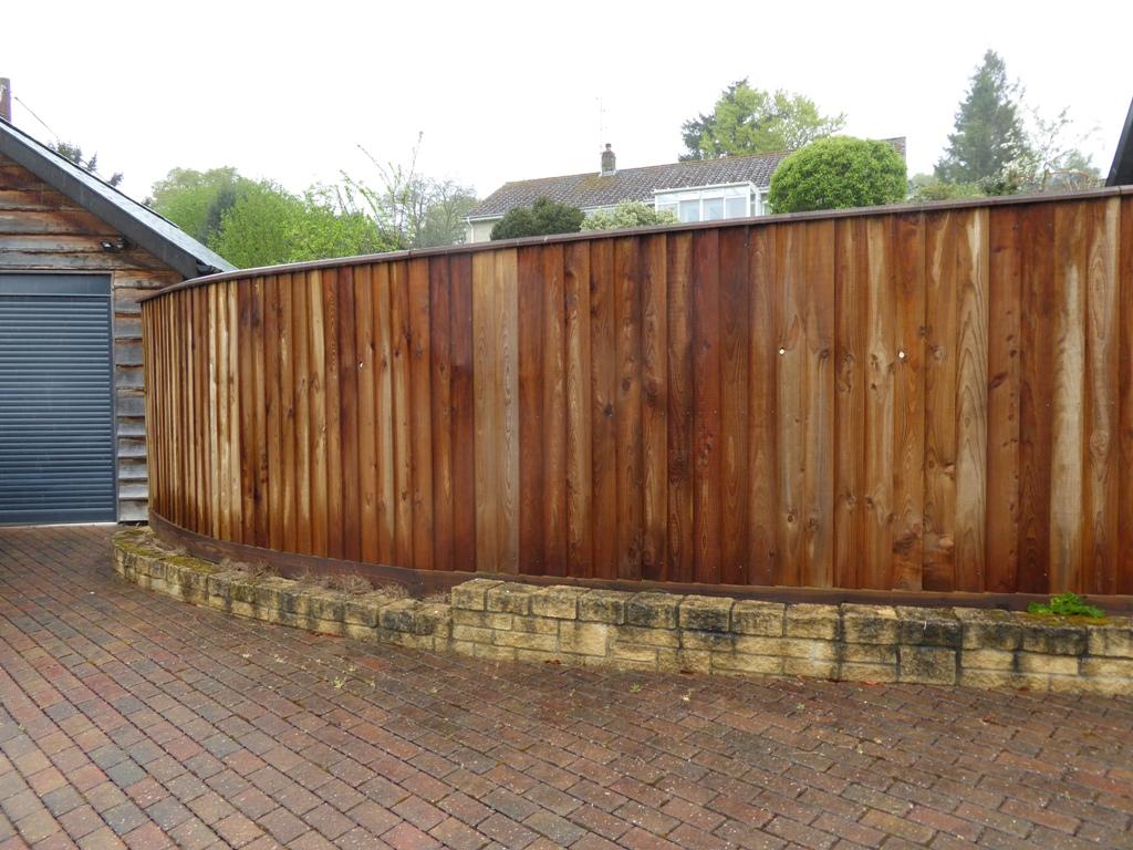

That one is ugly, but it is where the idea came from. Here is one of mine from Streetview.
These are on display so I overspaced the posts by about 25-50mm for the bolt, which leaves a gap between the panels which I can then cover with a cosmetic batten which matches the fence panel slats - so the concrete fence repair spur is completely hidden from the good side. And still get to both ends of the bolt if necessary, easily.
The panels were done 25-50mm clear of the ground, and then extra depth of gravel was added to cover the gap. These are hit and miss panels to allow the wind to blow through.
The post heights were trimmed, and the posts capped later.
The offset one to the right is because the neighbour has reinforced foundations over the boundary, and was then trimmed to just below the panel height.
(Just in case you think of those sort of panels - they were bloody heavy. With two of us moving them I had to have rests because my fingers wilted. But the fence was built by my handyman; a very good job.)

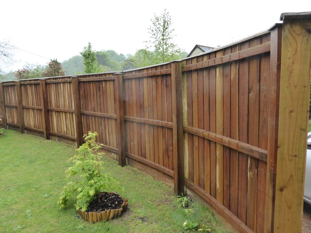

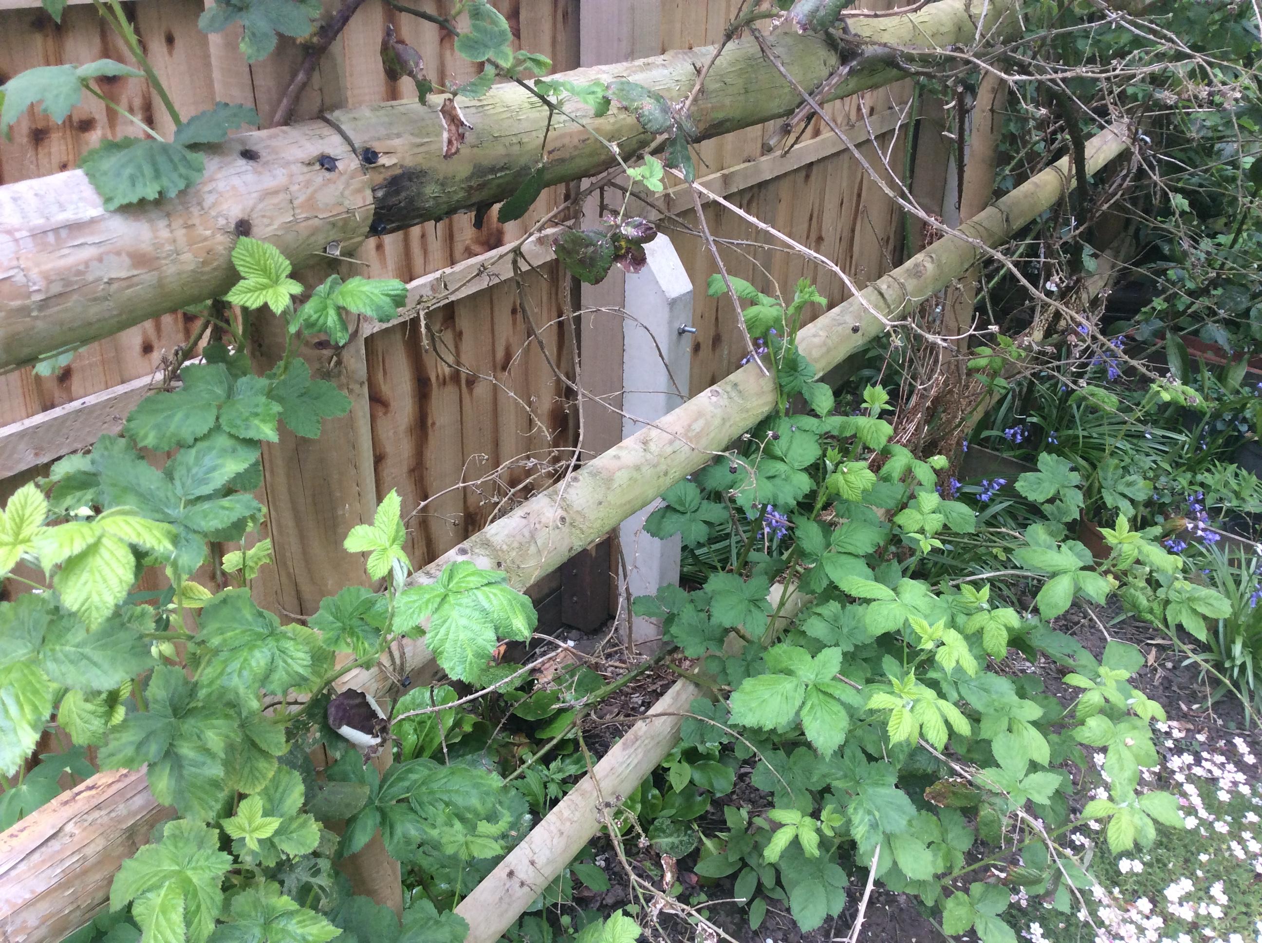

Just to wrap up my contribution here, here is a piccie of what he back of one of the wooden post bolted to fencing spur fences looks like.
Ths is in my own garden. The neighbour has the good side here; I’m not worried because it is at the end of the garden behind a fruit frame with a blackberry. Not especially happy tat he stained his side mind, but it was paid for 50:50.

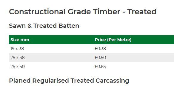

This is doing my box in. Posts are the least of my worries. Panels are an awkward size that come up short.  Reasonably priced raw materials for a diy approach don’t seem to exist and if they did there would be delivery for weeks and weeks.
If anyone knows where I can find some smooth, treated timber, 35-50mm wide, 20mm deep or so for external use at much less than £1/m (I need 300m+ initially), I’m all ears.
And I would still need to double up on something to provide the necessary level of privacy, grrrrr.
i use 3 x 2 treated and 2.4 100x100 wooden posts to make our closeboard fence. None of it weighs a ton and all pretty cheap from any builders merchant.
My father in law's lockdown project was making us a picket fence out of old pallets.

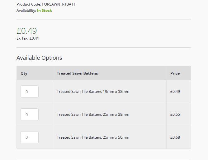

It sounds like you need tiling battens, but watch out for them being dyed. If by smooth you mean planed as opposed to sawn timber, I think you are going overboard for a fence!

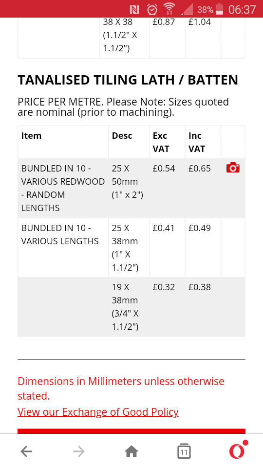

Cheaper than my local timber merchant by a little bit are your prices but same ballpark. @daiking needs to shop around I guess.
Ex VAT:
Oddly enough, the other yard, 10 miles away, prices include VAT:
Edited by Onoff
Ex VAT:
Tell me about it. You search for cheap timber but then find you're out of their deliver area not that deliveries are easy to get at the mo.

Tile battens alright. Whack it up and give it a sand over. Put the worst face towards your neighbour.
If you have the yime you could sand tiling laths, but it would take forever for 300mm.
Personally I would try a length of PSE from wickes etc and a length of tiling batten and see if they really look that different once painted, it will be about half the price.
Or buy panels and then diy a final small section if the sizes don't fit your space exactly
