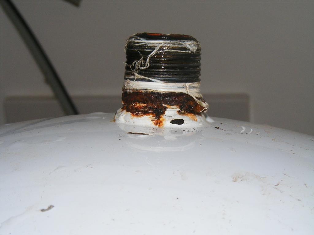

Tenant in our rental house phones this morning, water dripping through the ceiling.
It's the expansion vessel in the top of the Telford UVC leaking AGAIN.
It has rusted through at a weld where the threaded coupling is welded to the body of the vessel. No doubt rusted from the inside,
This is less than 2 years old, replaced when the previous one leaked in the same place.  I was shocked when the previous one rusted through and started leaking.  Even more shocked that this one, failed at less than 2 years old.
Of course the plumbers merchant I bought it from is shut, otherwise I would be arguing with them (I probably will when they re open)
And I can't find a plumbers merchant open today.  I will be trying again on Monday to find anybody open in Inverness that has one.  Until I get a replacement the tenants have no hot water (they do have an electric shower they can use)
Screwfix have one listed but not in stock and saying Friday.  Can't get to speak to them.
Utter shambles we are in, but the point of the thread is my disgust at the lack of quality of much of the stuff being sold.  And yes it was an expansion vessel rated for potable water.

how much more is a SS one or one made in EU,not china

I have not yet found a SS one.
The original one, supplied by telford with the cylinder lasted about 10 years, and the bladder went.
If I could buy a SS one, with a replacable bladder I would (or would if I expected to be owning the house for very much longer)
It seems daft that the UVC is SS and let down by a bit of mild steel rubbish. How anyone thinks that is going to last a long time with potable water (i.e. there won't be any rust inhibitor) beats me.

Looks like weld corrosion from that photo.  We had something similar with a small 8 litre pressure vessel, failed in the same location.
You can get stainless ones that I'd guess might permanently fix this, and one might be a good option for where you are, as I suspect that the water there might be slightly acidic.  Slightly acidic water may well make the corrosion problem worse.  I bought one of these stainless steel pressure vessels, and so far (~5 years) it's been fine: https://www.ebay.co.uk/itm/8-litres-1-thread-stainless-steel-pressure-vessel-accumulator-water-tank/174144644679?hash=item288bd46647:g:0pUAAOSw6GJeD0n0
The other advantage of these PVs, is that the bladder can be changed if it fails.

There's an 18L SS one on the bay just now for a good price.  I will have a chat with the tenant tomorrow and see if he is prepared to wait a few days to get a better one posted here rather than the tat the local merchants sell.  But it will likely be the end of the week before it gets here.  That's the trouble when you are fixing a breakdown of something that is urgent and the local suppliers don't stock the quality stuff.

Okay found one.  Only one in Inverness it seems.
For those wondering, a summary of my findings:
Highland pump centre, no answer assume shut
City plumbing, open but don't have it in stock
Plumbase, no answer so assume shut
Plumbstore, open to account holders only, no flexibility.
Dobies, no answer, assume shut
Plumb centre, dud phone number on yell.com
William Wilson, no answer, assume shut
And finally Wolseley, open for contactless collection, only 1 in stock, paid for and going to collect it shortly.

Just back from fitting the new one.
I have to say this new one is an order of magnitude better.  It is the sort that has a flange that can be removed to replace the bladder. I still don't think it's stainless steel, it looks more like galvanised or some other plating.
