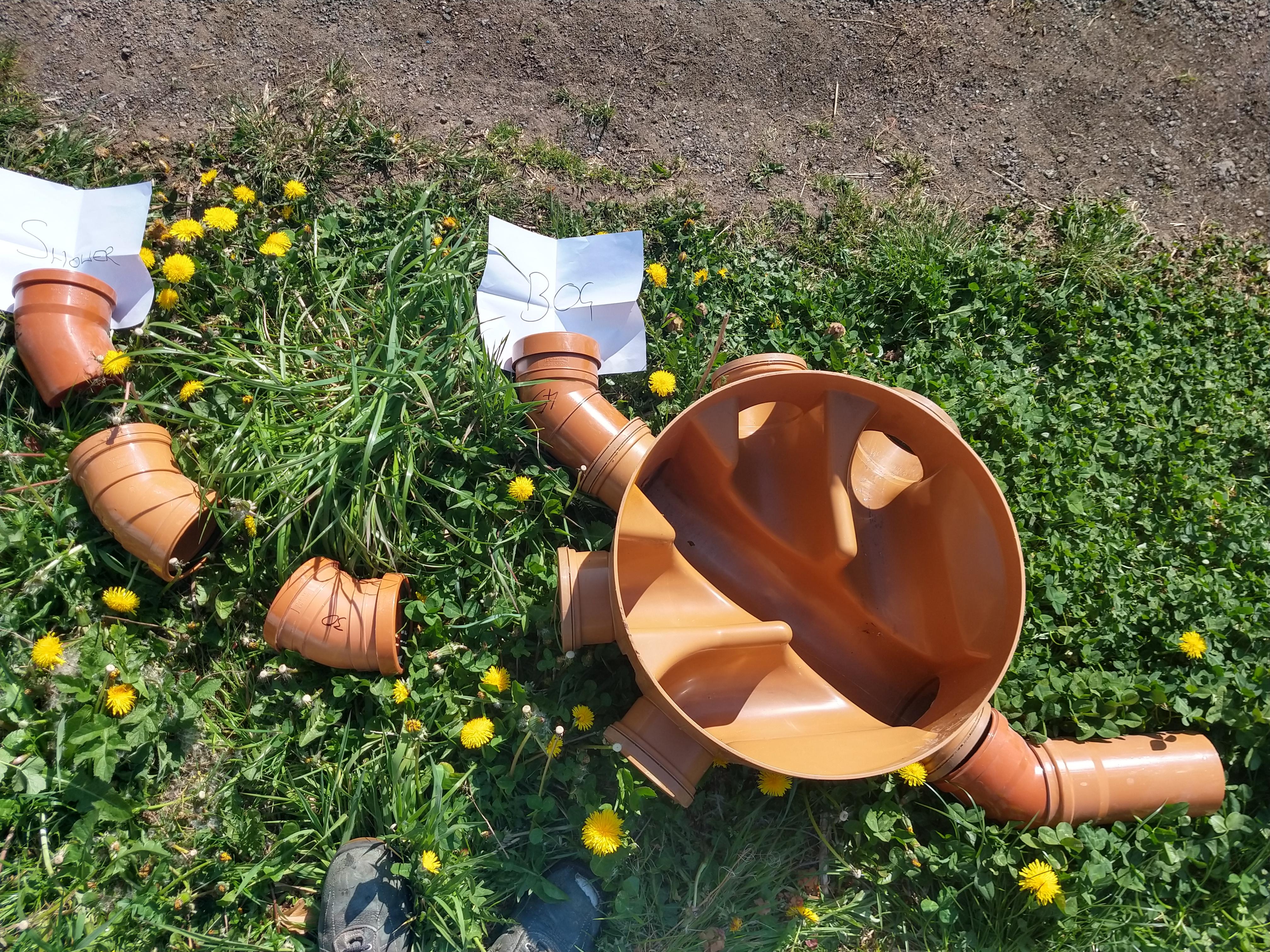

@AnonymousBoschHere's how I'd do it.
Single socket 45's straight into chamber on exit and toilet make it rod-able.
Swept bend or several 30's make shower rod-able too.  Toilet has main run so solids won't get stuck.
Edited by JFDIY
Thank you very much @JFDIY. Its very kind of you to lay out one way of sorting out my loo and shower drains. I am only just discovering the joys of making your own foul drainage runs. And playing with 45s, 30s , 22s and 11s  is a pleasure that I have never had until today. It's a bit like playing with your grandchildrens' transformer toys. Just for fun, I  had a go at making a loop out of all my corners : well, it is Friday after all.
I take the point about the loo being on the main run : it makes emminent good sense to do that. You have taught me to look a bit harder at the layout of the base of the I/C. I'll remember that for next time.
The complication of needing to add another run to that I/C (at a later date) and having to hand dig in what is now rock hard clay means I'll stick with the piping layout that we currrently have. But thanks all the same.

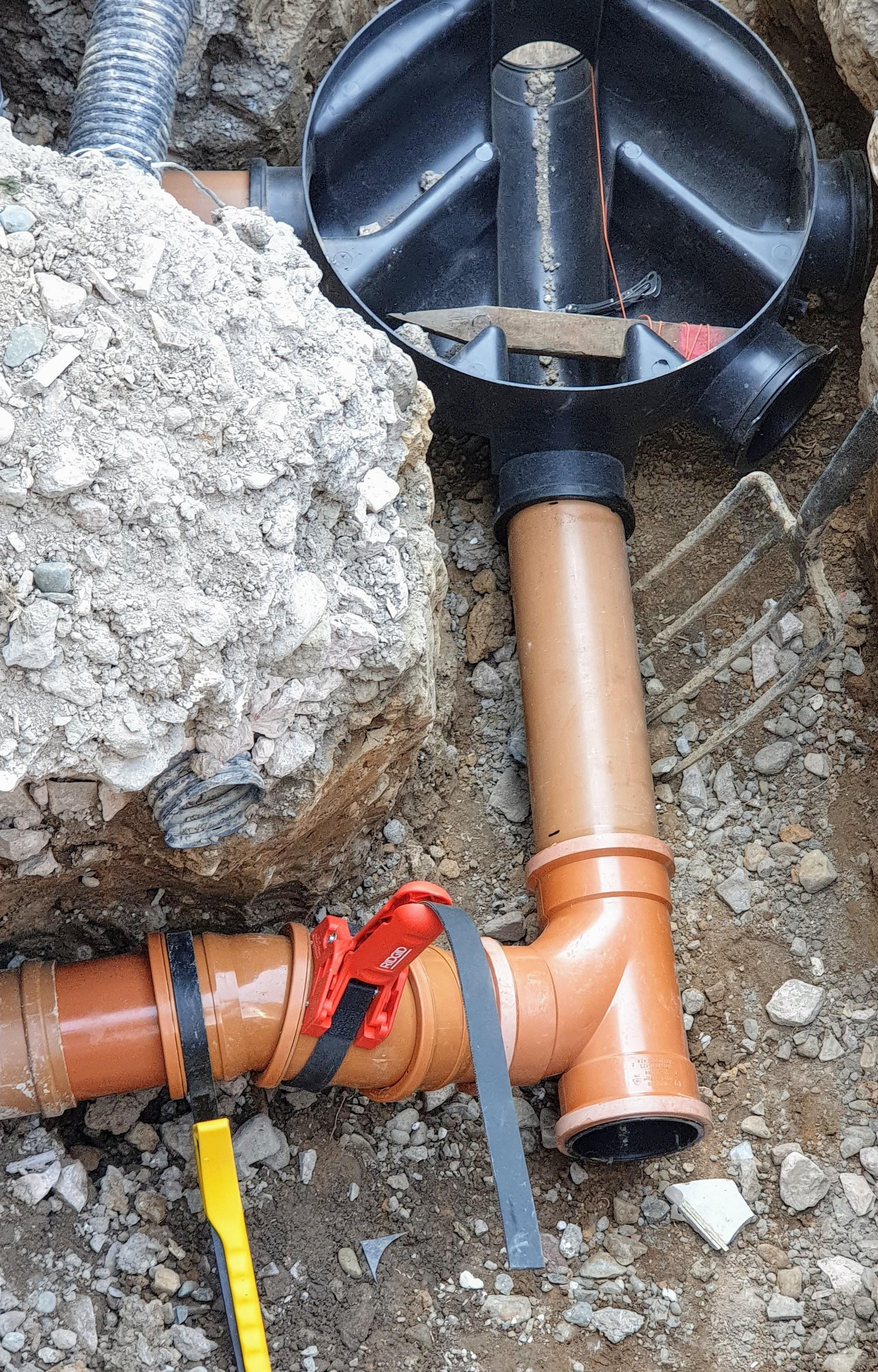

well I wasn't to know that grey stuff wasn't certified was I?
So I grabbed some 11s and 22s ( BM open FGS!!!!!) and
My god, spraying silicone (sorry, KY) on three piping corners and then trying to twist them to the right shape is like Turkish oil wrestling. Ya cant get yer hand to grip  anywhere. Those pipe straps worked a treat.
Now, how do I test this little branch of my system? I can't block the inside of the I/C can I? (Normal stoppers are too big)

Can you do a sketch of what you are proposing please as I just can't understand how it can be anything other than how it is.
The photo example using plastic components uploaded by @JFDIYis exactly as I was suggesting though I suspect the helta skelta fiddle on the shower drain could also be eliminated because the different invert levels of the main run through the IC compared to the branch entrances would also fix @AnonymousBosch's height problem.
Thanks for the thought @epsilonGreedy
Have another look at this image ....
The yellow dot represents another connection running vertical at that position (as yet not fitted)   coming from the roof of the piggery, a washing machine and small sink. (sanctioned by the BCO)  The piggery is to be used as a laundry.
The arrangement agreed with the BCO is that the swept 135 (posted above) should provide for a roddable line which enters the as yet blanked off end of the 135 - as well as an outlet for the shower.
Cats and skinning comes to mind. As well as digging by hand.
On 23/04/2020 at 15:36, AnonymousBosch said:
I think @epsilonGreedy has implicitly accepted that the I/C is correctly orientated as is.....?
My advice was sound as subsequent posts explain. As a minimum you should adopt @PeterW's halfway plan correction and come in via the intermediate branch with a 45 degree bend just prior to the IC entry. It seems a shame to hardwire an intermittent sewage problem into your new build for the sake of an extra bit of digging to reprofile your trenches.
Forgot about the piggary, but that could use another branch entirely again with a 45 straight from chamber again to make it rod-able, two pipes (piggary + shower) then run parallel for a short section.
You put your hand up the outlets inside the IC until you reach the actual pipe and put the stopper in the end of the actual bit of pipe.
Assuming your IC risers and lid have seals, you could assemble them with the lid on and test the whole lot in one go.  I did that with the BC man watching to prove the outside drain runs.  I was surprised the IC risers and lids sealed so well.
