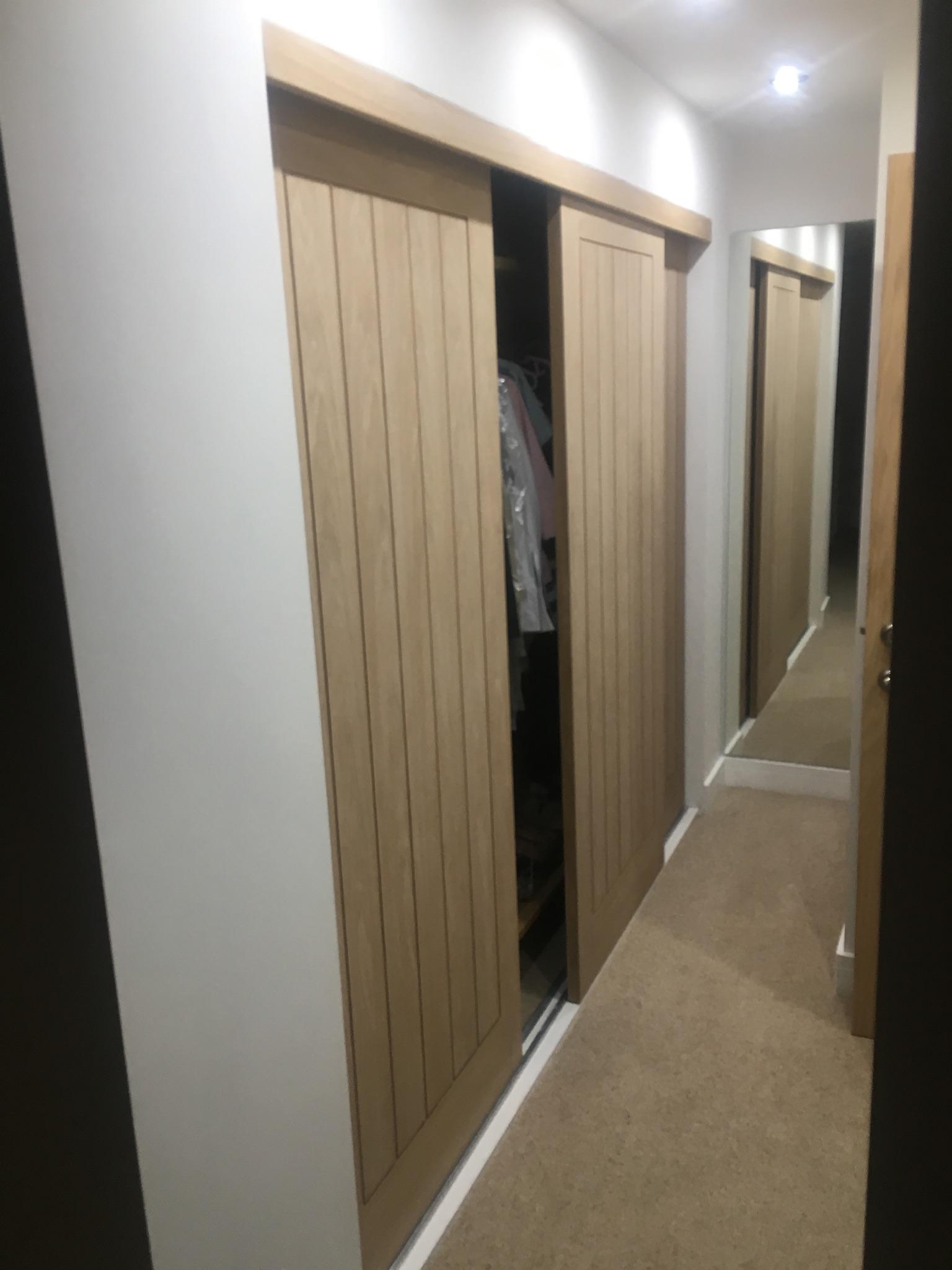

overdrev Posted April 22, 2020 Share Posted April 22, 2020 I want to build a sliding door cupboard, consisting of several doors sized 210 cm x 90 cm my question is : what material is best and what thickness ? I can chose between MDF, Chipboard, or Plywood The most important for me is a feeling of stability and quality feel - plus that the door does not distort over time. Cost is not so important factor. .michael Link to comment Share on other sites More sharing options...

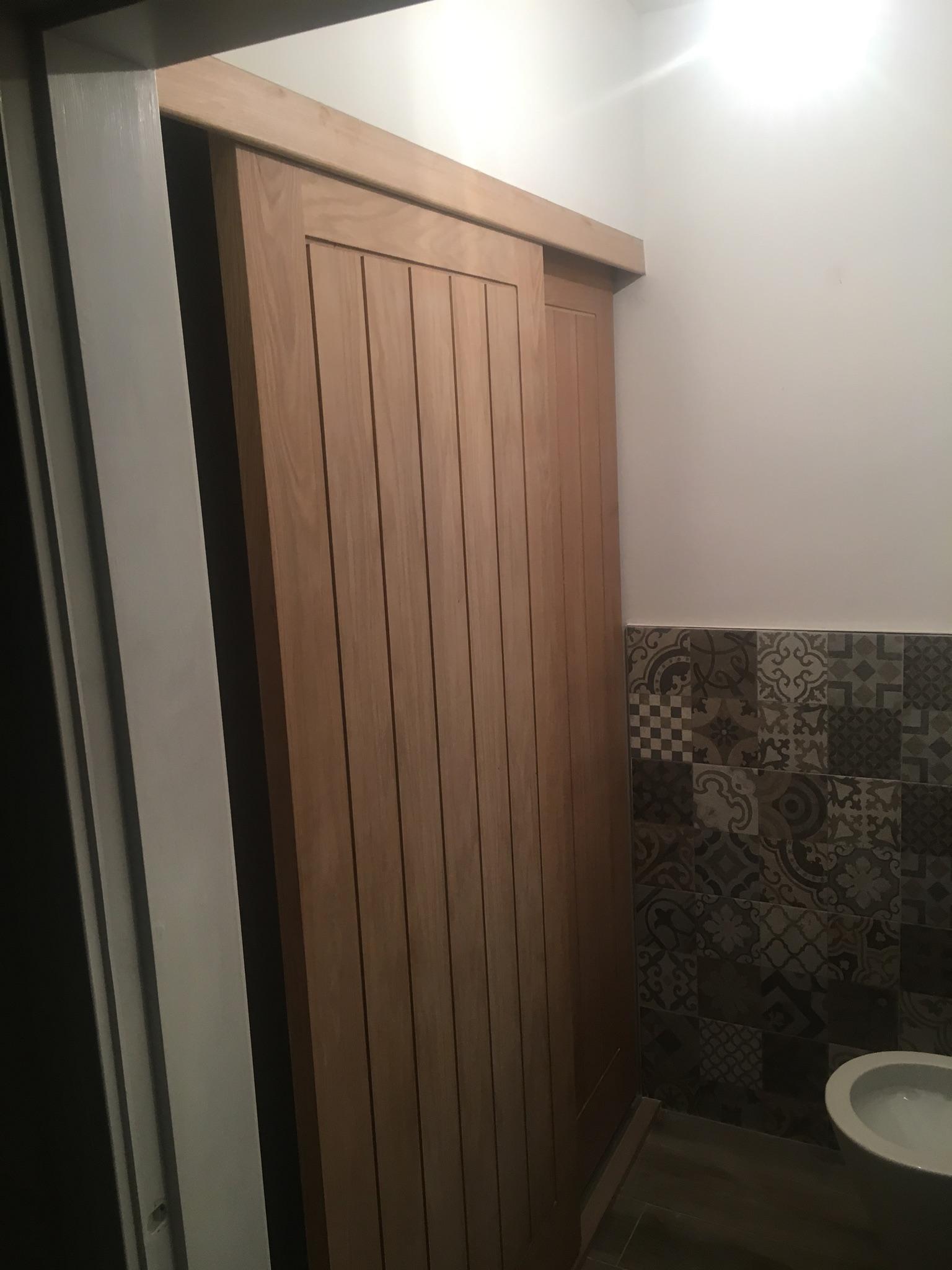

nod Posted April 22, 2020 Share Posted April 22, 2020 I built five sets Some in pairs and some triple I purchased the sliding door feet from Slingers at Preston Between £40 and £75 per set Great quality 1 Link to comment Share on other sites More sharing options...

overdrev Posted April 23, 2020 Author Share Posted April 23, 2020 Thank you everyone Super appreciated 1. I cannot get premade near us, and I also want to coat with Fenix. I will be able to get this done advantageously by a friend here otherwise it would be prohibitive 2. my wife loves a plain surface, I certainly understand shaker would be easier and I have done these before 3. The area is a bedroom so it is dry. So it is really a question as to which is the most stable material for this use. @nod What material are these ? They look great. . Michael Link to comment Share on other sites More sharing options...
