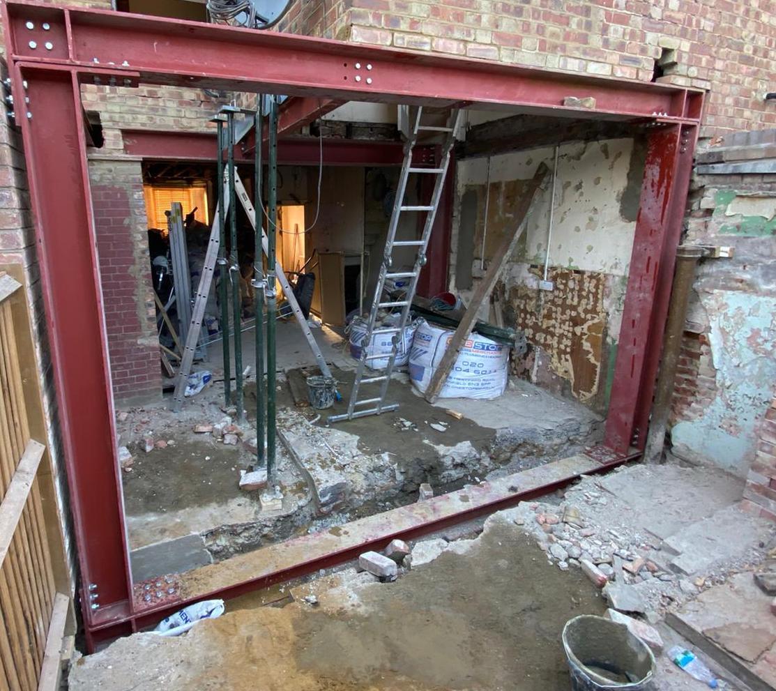

Mat1 Posted April 21, 2020 Posted April 21, 2020 Hi, I'm currently in the midst of a full renovation on a victorian terrace house. The previous kitchen area has concrete floor as you can see on the right hand side of the picture. The side return area on the left is also concrete. The previous kitchen area is about 5cm lower than the suspended floor and the side return is about 10cm lower. We'll be laying Nu-Heat overlay UFH with Engineered Oak on top throughout the ground floor, 100mm insulation between the joists. I'm unsure as to how we should be treating the concrete area so we don't have problems with the UFH, damp or the wood flooring. I'm getting different views from builders. One builder just wants to build up the concrete area so it's level with the rest of the ground floor while another wanted to demolish the whole area and lay a new solid floor to building regs standard. Nu-heat said I shouldn't worry about insulating the slab as the loss is very small. My gut tells me at a minimum there should be some sort of Damp proof membrane. What do you think?
Russell griffiths Posted April 22, 2020 Posted April 22, 2020 Nu, heat are talking out of their backsides, the heat loss will be huge, get it all broke out, new dpm and new insulation the amount of effort you have gone to already don’t skimp on getting the rest done right. 2
ProDave Posted April 22, 2020 Posted April 22, 2020 Yes you need a very minimum of 100mm of GOOD insulation so it all has to come out. Unless you want a step up as you enter the kitchen? 1

Mr Punter Posted April 22, 2020 Posted April 22, 2020 Break out the concrete. Should not be a huge job. If it is just the area at the back it should only take a day or 2 including disposal. You have spent enough on this that it is not worth cutting corners. 1

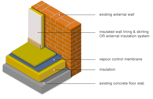

Mr Punter Posted April 22, 2020 Posted April 22, 2020 Is this what was originally specced and quoted? My favourite would be to take out the concrete, boards and joists. Level the sub base to, say, 320mm below finish level. Blind with 25mm sand. Fit plastic DPM. Lay 100mm concrete. Fit 100mm insulation with additional 25mm wide x 75mm high perimeter strip . Fit UFH manifold. Clip UFH pipes to insulation. Lay 75mm screed. Fit floor finish (20mm allowed for). You will also need to allow for any electrics and other services. You could do a lot of the work yourself. It is fairly unskilled. Leave screed and electrics to others.

Mr Punter Posted May 3, 2020 Posted May 3, 2020 You don't need ventilation with a ground bearing concrete floor. You do need at least 100mm of insulation if it is Celotex type, 150mm min if expanded polystyrene. Lovely and warm and dry.

Mr Punter Posted May 11, 2020 Posted May 11, 2020 There is no point in having any void. It will just make the floor cold and it cannot be properly vented as you are mid terrace and the rear section is concrete. The floor make up depends on what finish you want and if you want underfloor heating, but it should always include min 100mm insulation.

Mat1 Posted May 23, 2020 Author Posted May 23, 2020 Bit the bullet, now we're replacing the entire ground floor with concrete as was suggested by you guys way earlier. Sometimes you just have to come to things in your own time ?? Just trying to figure out the ufh screed situation so we're not waiting months for it to dry but that's another thread! 1
