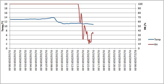

MJNewton Posted October 31, 2020 Author Share Posted October 31, 2020 3 minutes ago, joe90 said: back during that heatwave in the spring. (RH just dropped to 60%) 20% RH is pretty exceptional but, granted, I suppose it can happen. With it being seasonal however it shouldn't affect rate-of-rise detection, or was/is the issue that you've only got absolute RH detection available? Link to comment Share on other sites More sharing options...

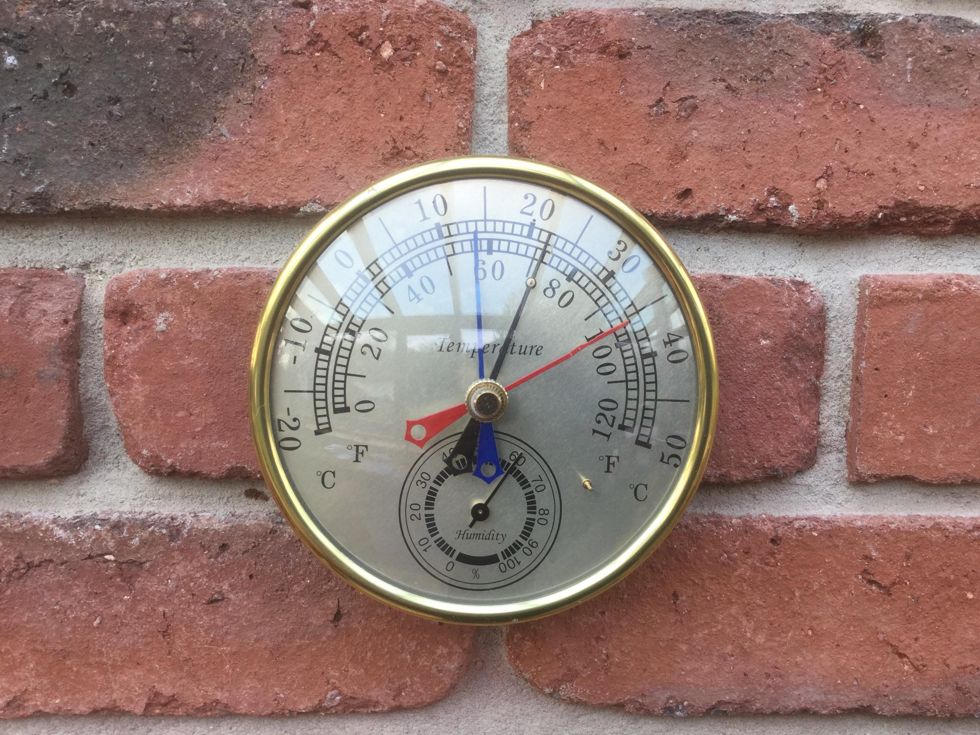

Gone West Posted October 31, 2020 Share Posted October 31, 2020 4 hours ago, joe90 said: you don’t live in Devon next to the Atlantic, just looking at my RH reading in the conservatory (during storm Doris or whatever) and it is 80%. I'm only three miles from the English Channel and it's been raining now for a couple of hours and it's 96% outside and it's gone up 2% inside to 52%. The inside RH always seems to track the outside value but it's never extreme inside. Link to comment Share on other sites More sharing options...

SteamyTea Posted October 31, 2020 Share Posted October 31, 2020 Here is today's outside data. I think my sensors has got flooded. 1 Link to comment Share on other sites More sharing options...
Gone West Posted October 31, 2020 Share Posted October 31, 2020 24 minutes ago, joe90 said: I might hang my conservatory temp/Rh thingy in the bathroom whilst I have a shower later, be interested to see what it does. I've found in the past that type of hygrometer gives readings that vary quite a lot depending on the type of surface they're on. If it's on an absorbent surface the readings are lower. 1 Link to comment Share on other sites More sharing options...
