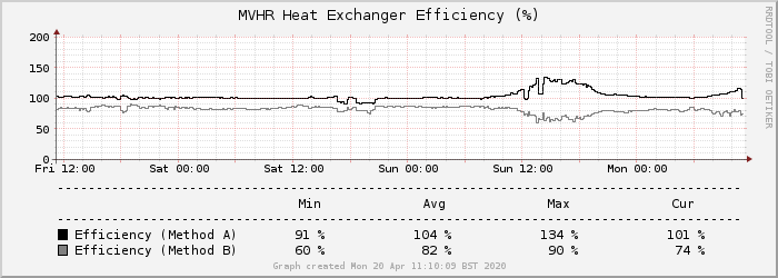

As things currently stand, the attached script (capturetemps.sh) reads all the sensors every 5 minutes (trigger by cron) and records their values, and various calculated ones too, to an RRD round-robin database using rrdtool. I've always been a fan of graphs - not entirely sure why - and so via creategraphs.sh (and rrdtool again) it also produces some charts for whatever time periods are required, examples of which are shown below. Speaking of time periods, it currently stores - and produces graphs from - readings at 5 minute intervals for 3 months, 30 minute averages for 6 months and hourly averages for 5 years in a 12MB database.

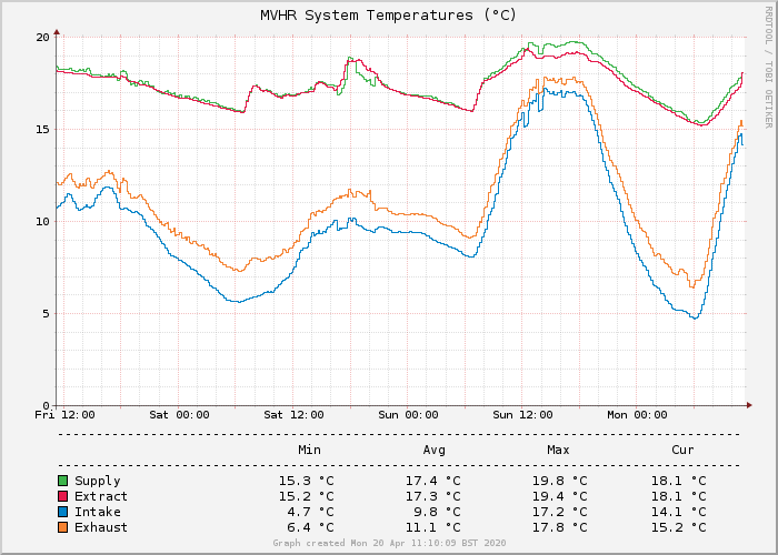

First off, system temperatures are recorded for all the ports which has been very reassuring in terms of the actually knowing this MVHR malarky actually does what it purports to do in terms of providing a supply of air at a temperature near to that being extracted (sometimes higher!) despite what's going on outside:
These temperature readings are also used to calculate the efficiency of the heat exchanger which again appear to show it broadly working as advertised:
The two calculation methods are as described by Paul Heat Recovery, the second of which (Method B) aims to factor in heat losses (or indeed gain) through the unit itself and hence be more accurate.

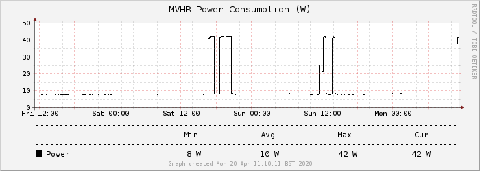

I also measure and graph instantaneous power consumption (figures obtained from the Shelly 1PM 'smoke alarm' relay I mentioned that the MVHR is powered through):
The system isn't yet fully installed (10 vents out of 12 done), balanced or properly configured and so the trickle (~8W) and boost (~42W) figures shouldn't be taken as necessarily relevant although that said we've been pleased with the performance at the current settings and so wouldn't be surprised if they don't change too much. This graph (not this actual one as it hasn't happened for a few days) also reveals when the summer bypass kicks in as it jumps the line up by ~5W.

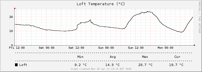

There's also the loft temperature graph which doesn't serve much purpose other than curiosity, and use up the fifth-of-a-pack-of-five sensors I bought:

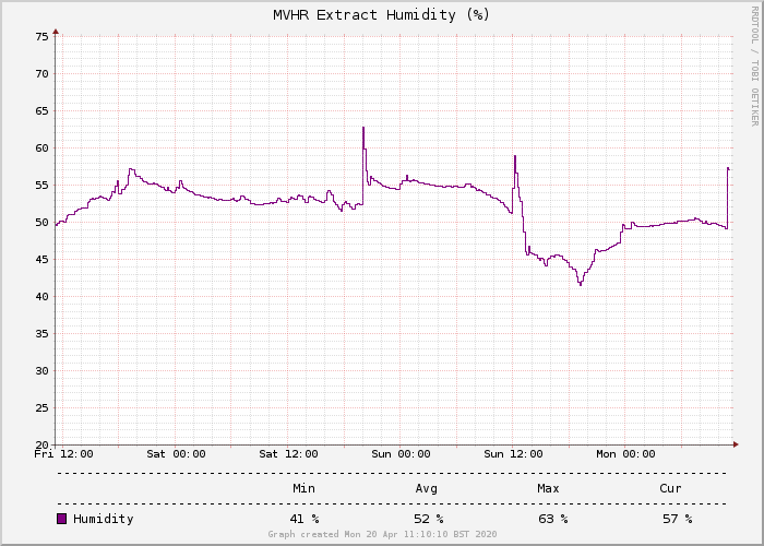

Speaking of curiosity, the novelty of looking at graphs will wear off one day I'm sure but one important reading I am logging is the humidity in the extract duct:
This one has been particularly interesting, and indeed useful, given that the large 'spikes' correspond with taking showers and so are easy for the script to detect (it currently looks for a >5% rise in any five minute period) and request a 30-min boost via the Shelly smart relay. It hasn't missed a shower yet, and I am confident it'll work well for cooking as previous experiments show it being quite easy to pick up simmering pans. The script also looks out for an absolute value also being breached but it's only been running for a few weeks and so I really need to see a full four seasons, particularly when windows are closed in winter with washing drying indoors, to determine what sort of value would be suitable for that. Given the freedom and flexibility of the script it could even self-adjust over the year if need be?

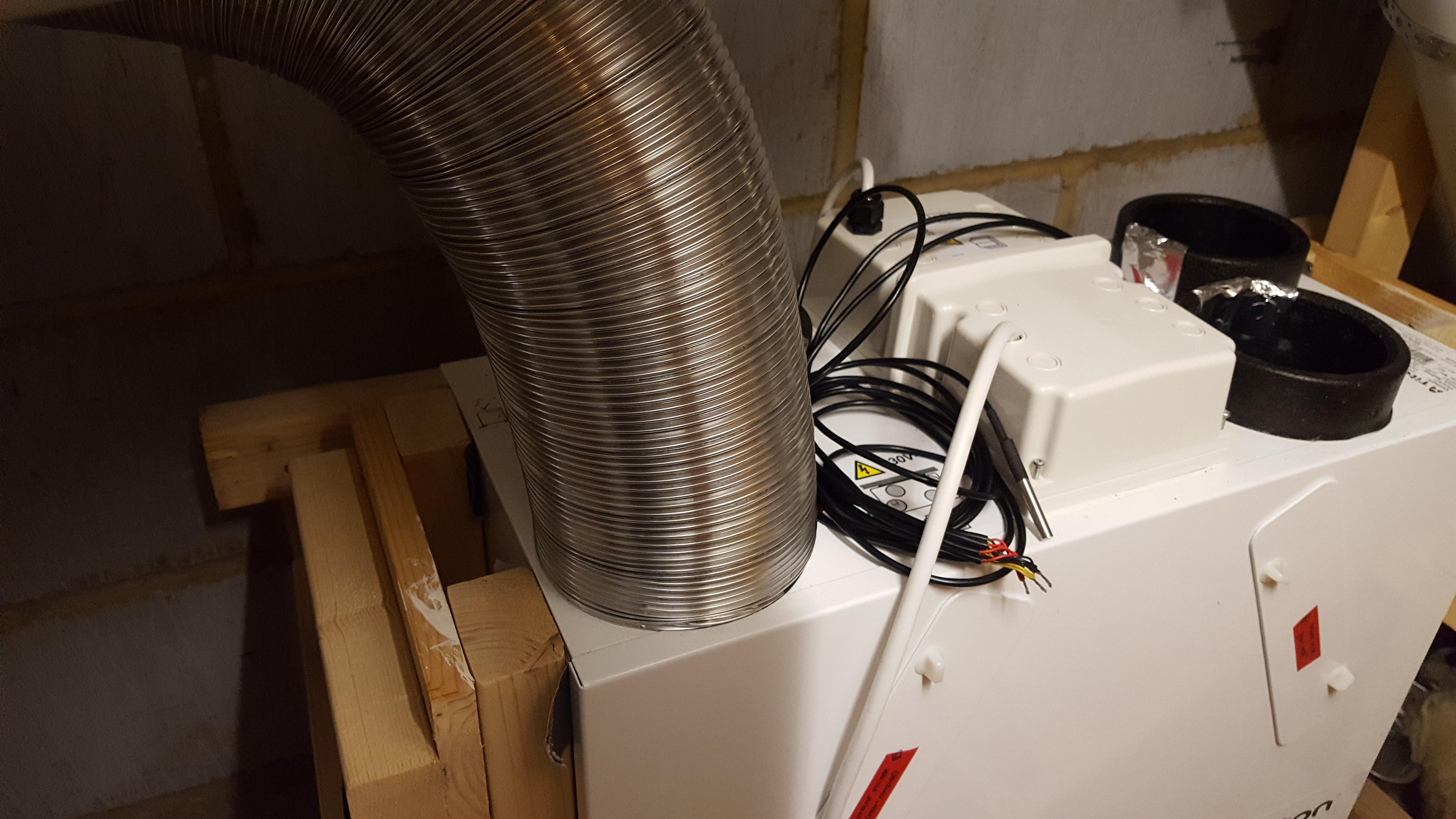

How did you get the temperature sensors inside the ducts?
Are you not worried that might create leaks in the system?

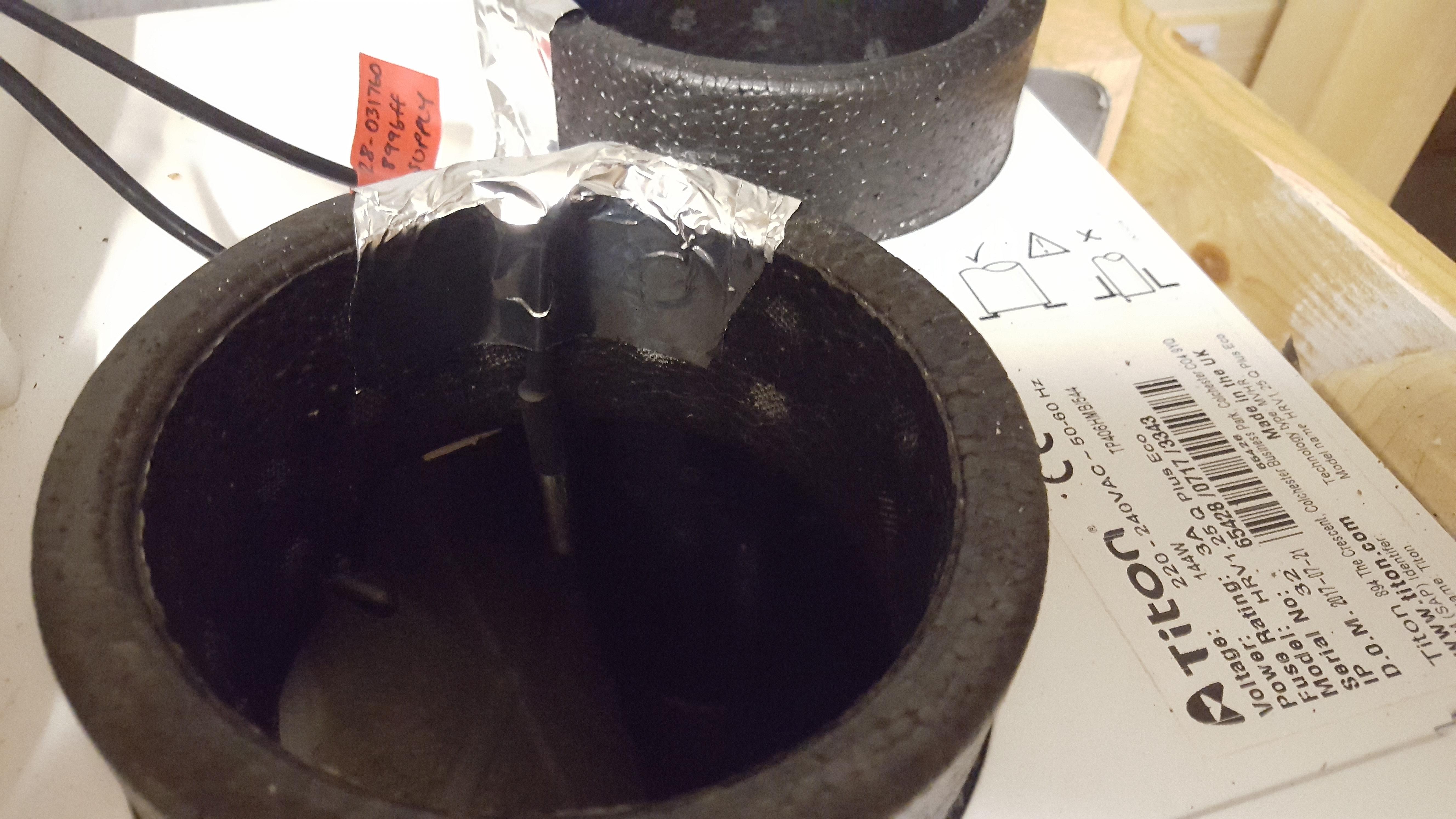

I just taped them inside the where the ducts attach to the unit:
..before then fitting the semi-rigid ducting over which I've used to attached to the rigid piping (to avoid transferring vibrations):
I will eventually tape everything in place but they were a tight fit and so I don't think there'll be any leakage.
When @Joe90 and myself set up his MVHR for monitoring, we put a small cut into the ductwork, popped the sensors in and then taped over the hole and cable.

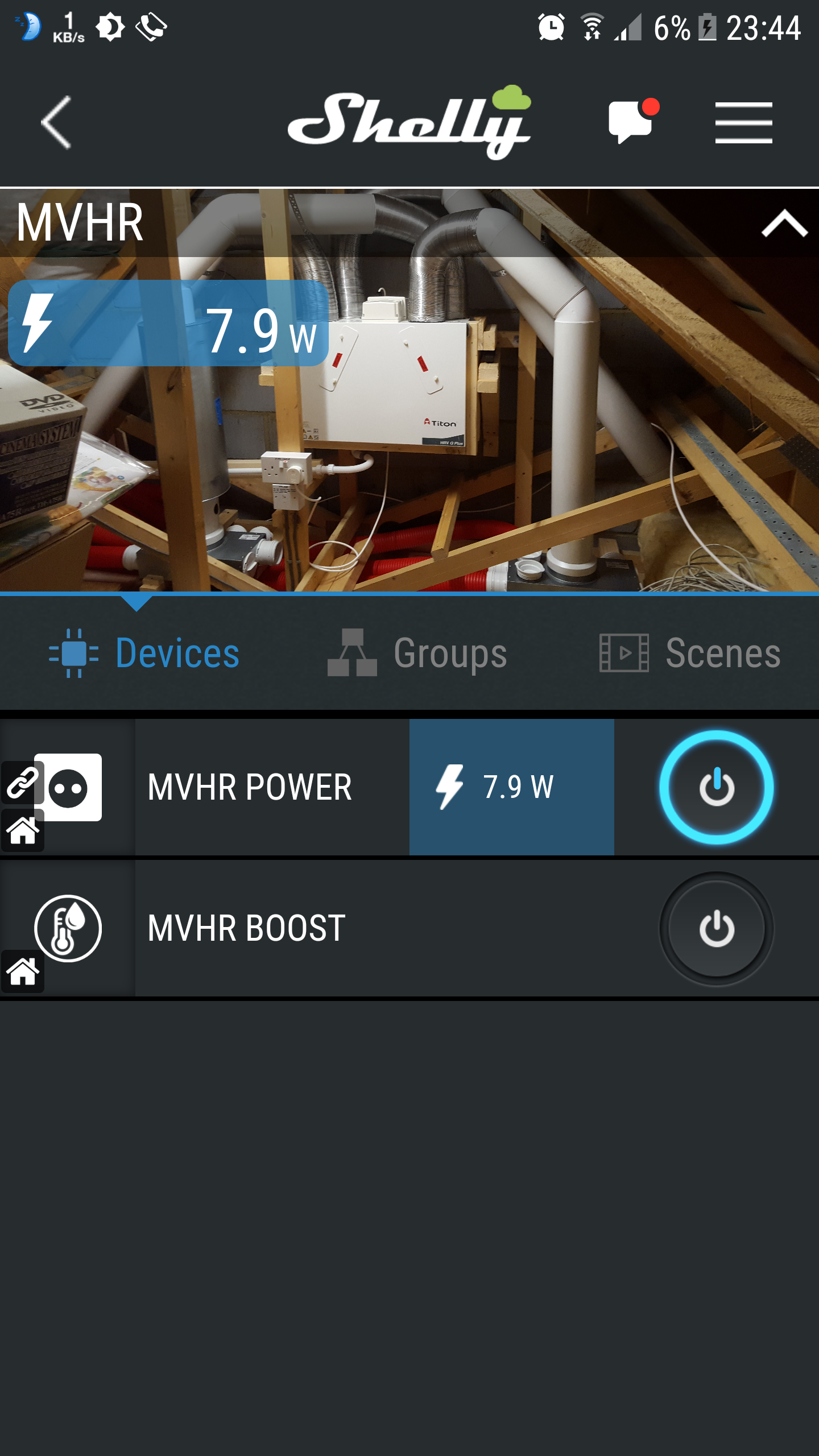

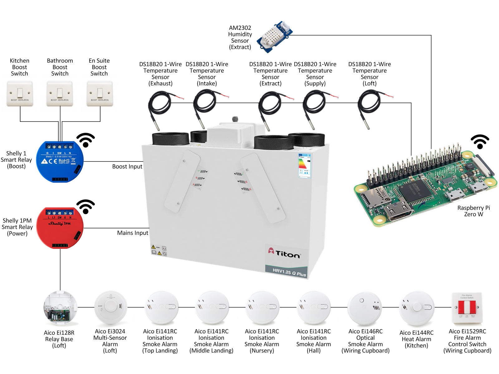

I've drawn everything out so it's a bit clearer what external components I've used:
1073014843_MVHRMonitoringControlComponents(600dpi1600x1200).thumb.png.b251ca716bb7bcdc276c3d31eb330a5c.png
...and a screenshot of the GUI interface that the Shelly relays provide for app control over the LAN or Internet:

@MJNewton How did you connect the shelly to the aico relay base?
I saw that you have boost switches for the bathroom/ensuite and you also have a humidity sensor on the extract. Do you have an automations based on humidity or do you use the swithes.
I'm currently doing the wiring for my unit, which has an integrated humidity sensor, I also have a humidity sensor in the bathroom, but I'm not sure if to use a boost switch in the wc or have in on a motion sensor?
Whilst the Shelly is a 'smart' relay (a buzzword term which in most contexts just means it is 'network enabled'), like others of its type it can also accept a physical switched input. The Aico relay base is simply just a relay that activates when the alarm triggers hence it was just a case of wiring it up to the Shelly switch input.

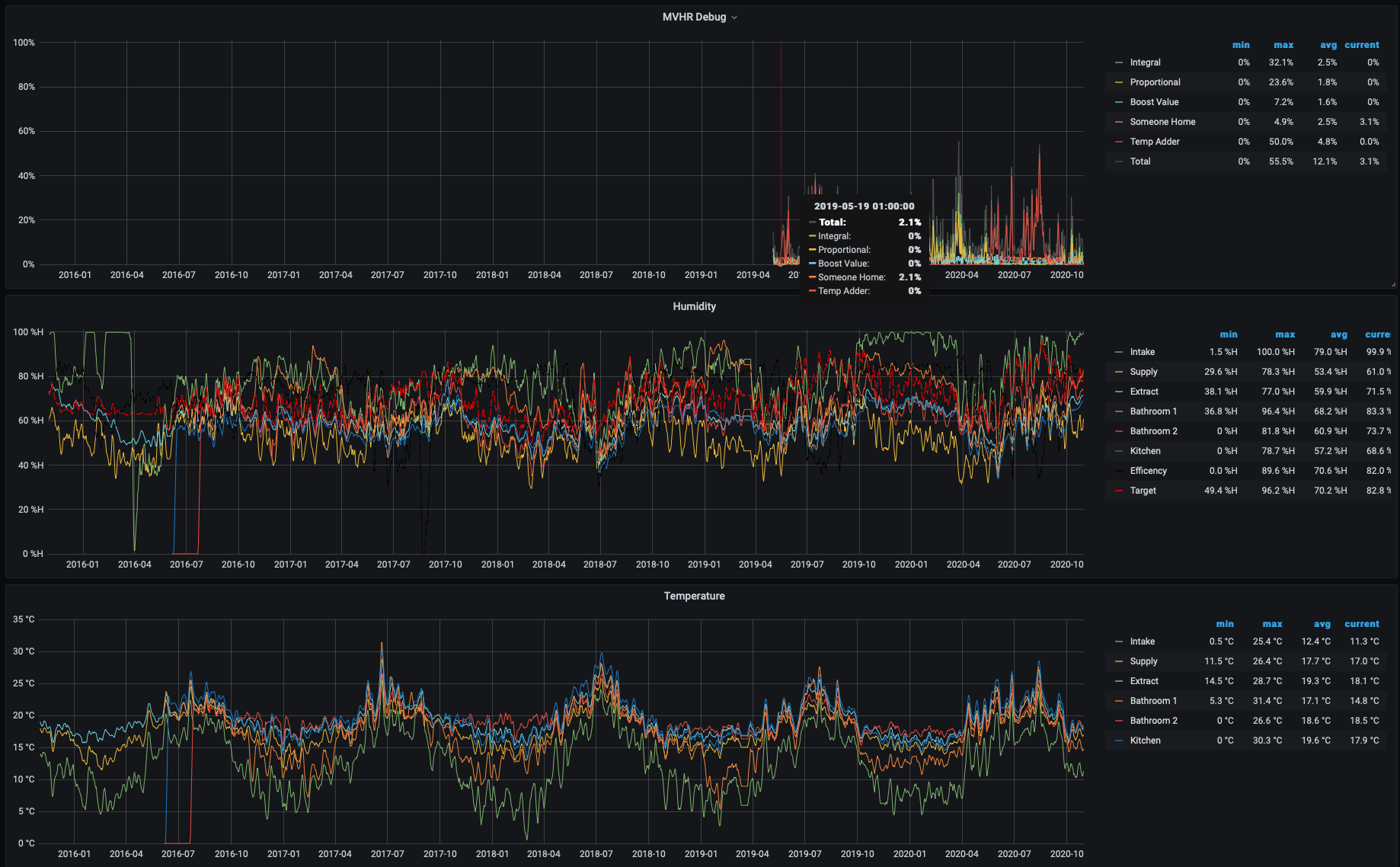

Glad to see someone has done something similar, I've taken it a bit further and my MVHR is totally proportionally controlled as the built in control is rubbish!
I designed and got some customised Temp/Humidity sensors made up as the ones you could buy at the time were £££, unreliable (had 6 all died) and poor resolution/accuracy.
  • Works to a target vs supply delta (So if the supply air is higher than the extract then it doesn't spin up as that's pointless...).
  • Target is 50% / 60% or 10% / 15% higher than supply for day/night respectively.
  • There is a shower boost detection algorithm (detects a rapid increase in extract humidity)
  • Night limits (to quieten it down) - limits in the integral and proportion max but shower detection still unlimited.
  • An increase in fan speed when people are in by 10% (disabled at night).
  • An increase in fan speed when the supply temperature in relation to the extract temperature (with some conditions) as a 'cooling' mode in summer (it sort-of works...!)
  • 10% to 100% fan speed variability.
  • Gently ramps between day/night mode.
Just need a CO/CO2 sensor, which it will in the next house!

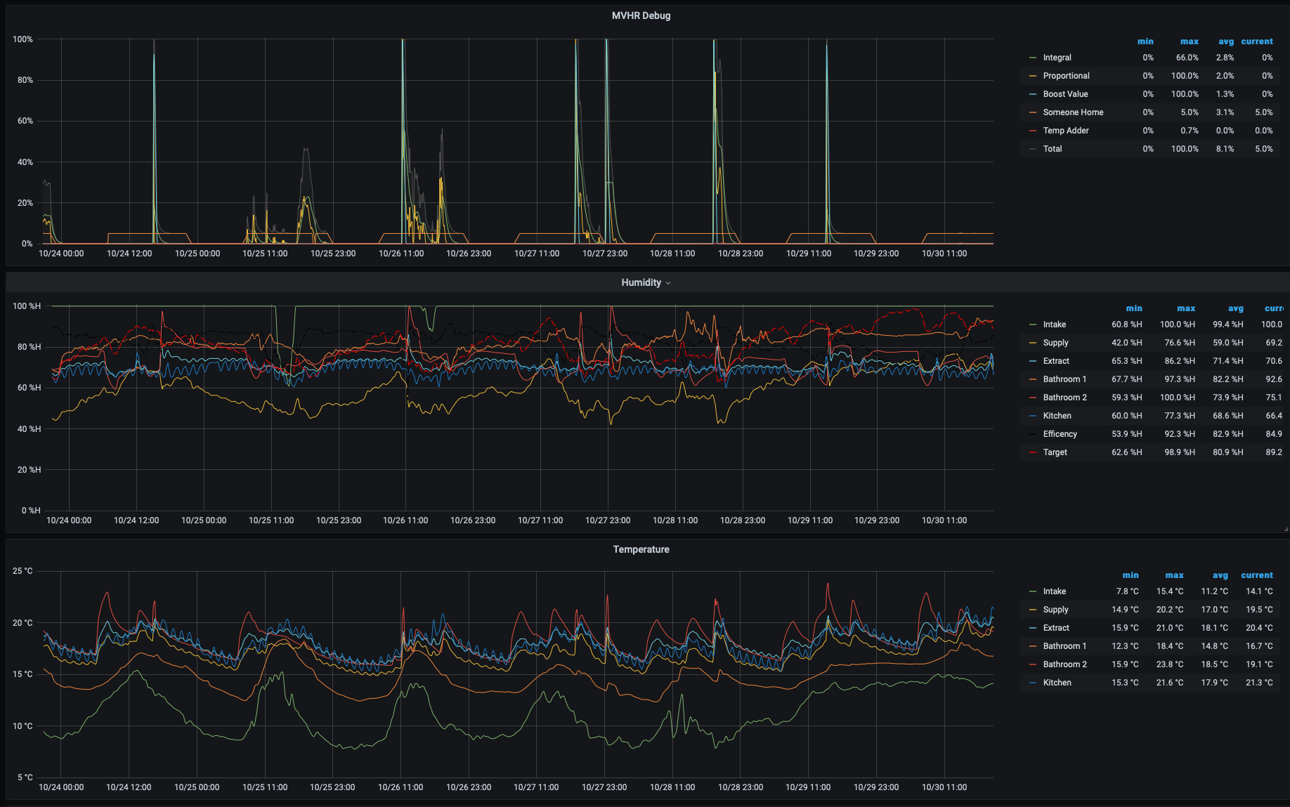

This is what our last 7 days and 5 years looks like... (easily see showers, cooking, etc!)
Very low average fan speeds recently as the supply humidity has been too close to the target humidity.
